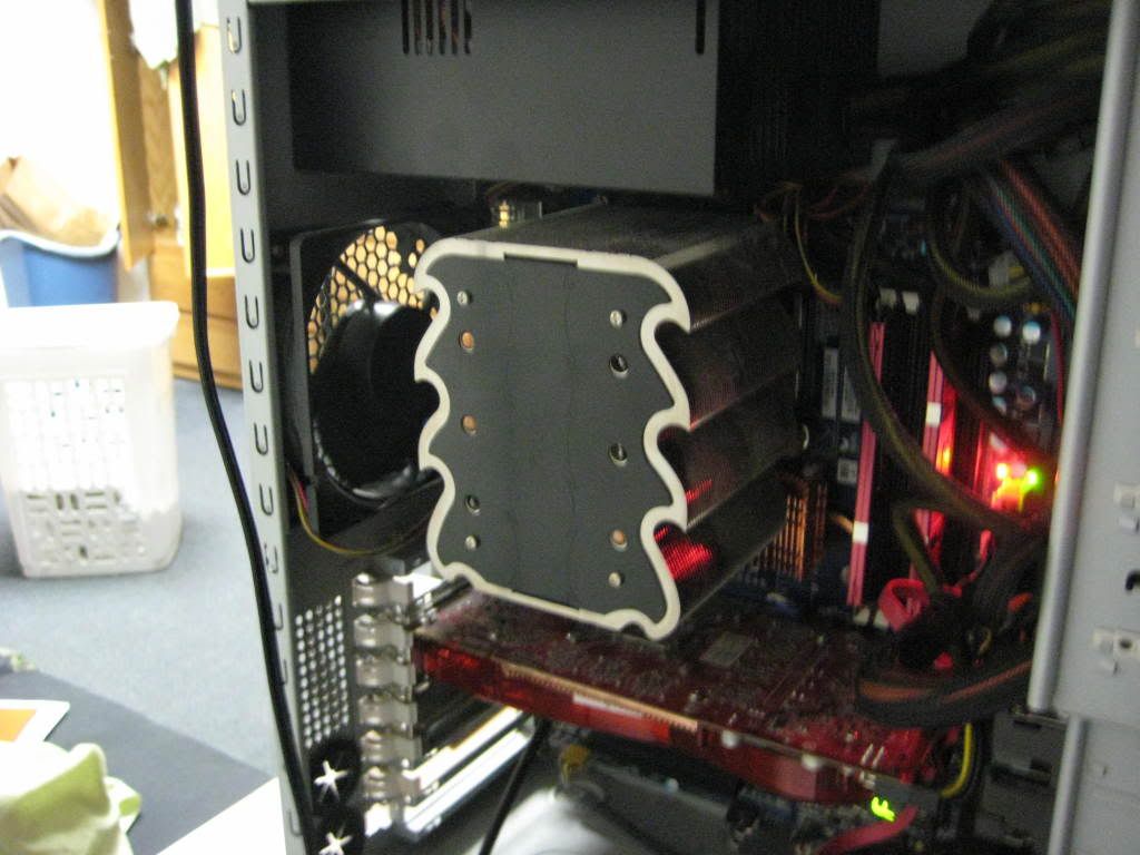

Just went to check my e fan in my computer.
Don't worry - it scared me too. The fan is fine.
My Zalman9700 is still turning from 3 years ago at 2700 RPM... smilieneenar :rofl:
