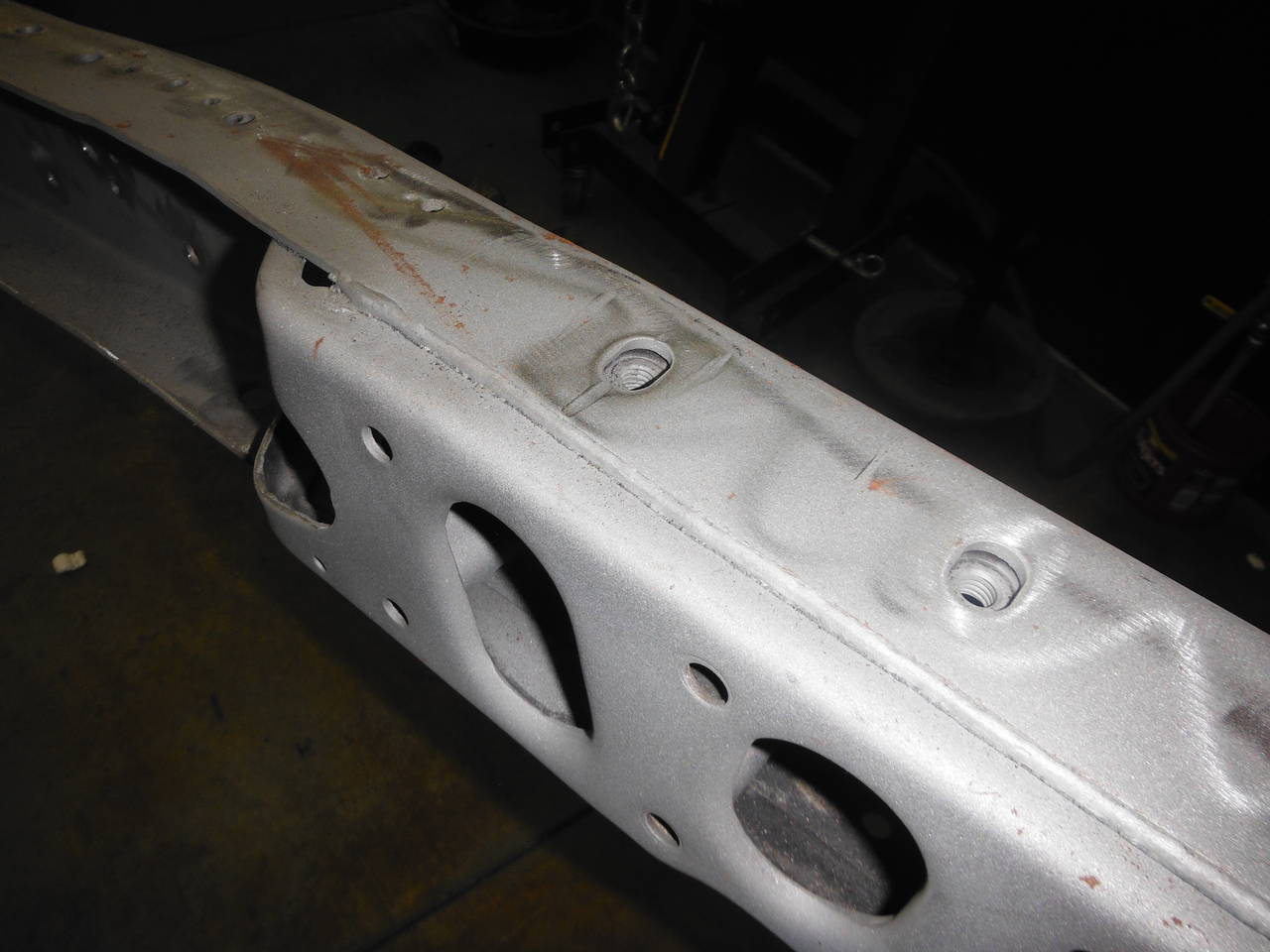

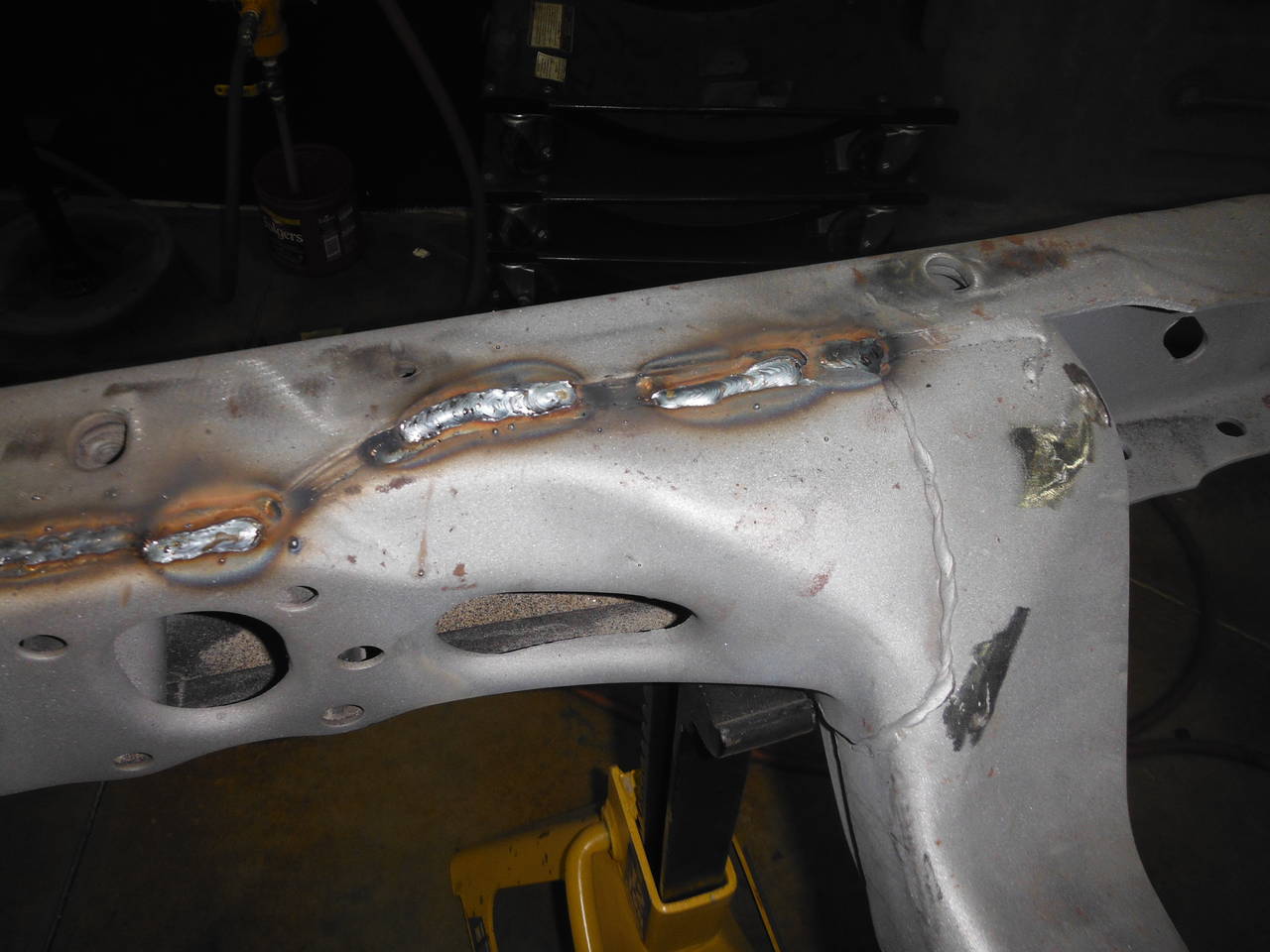

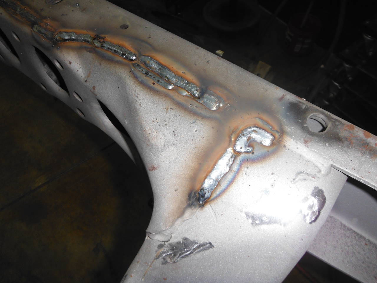

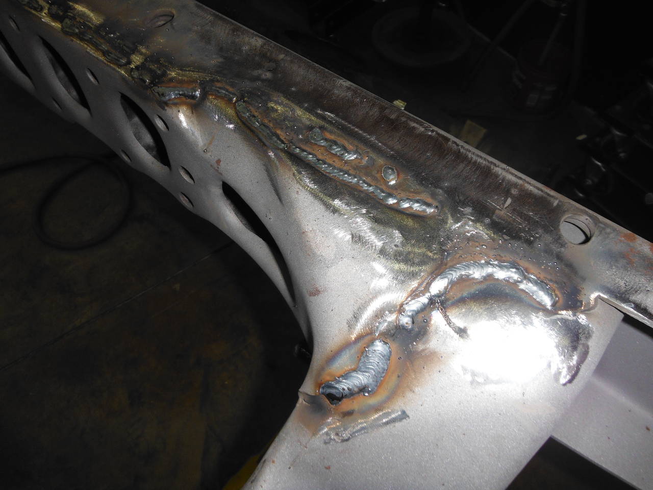

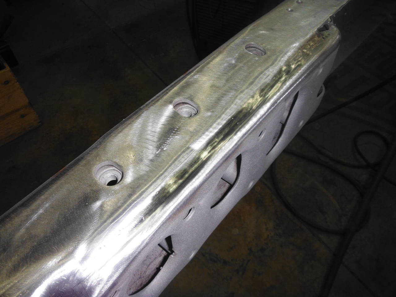

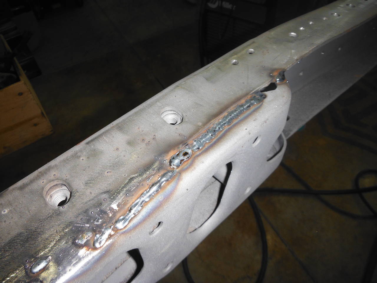

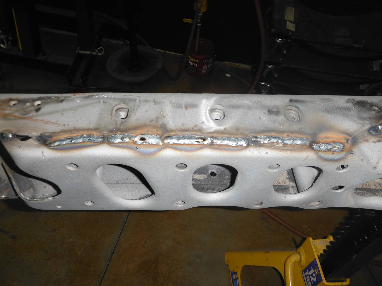

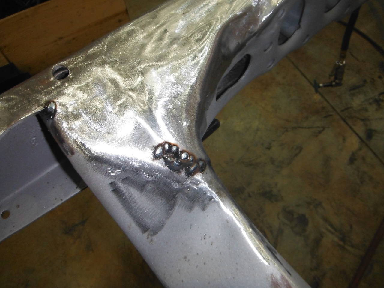

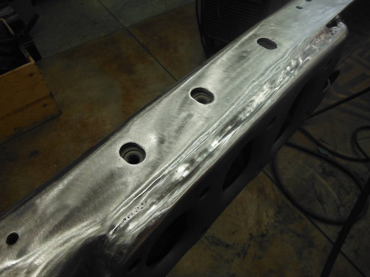

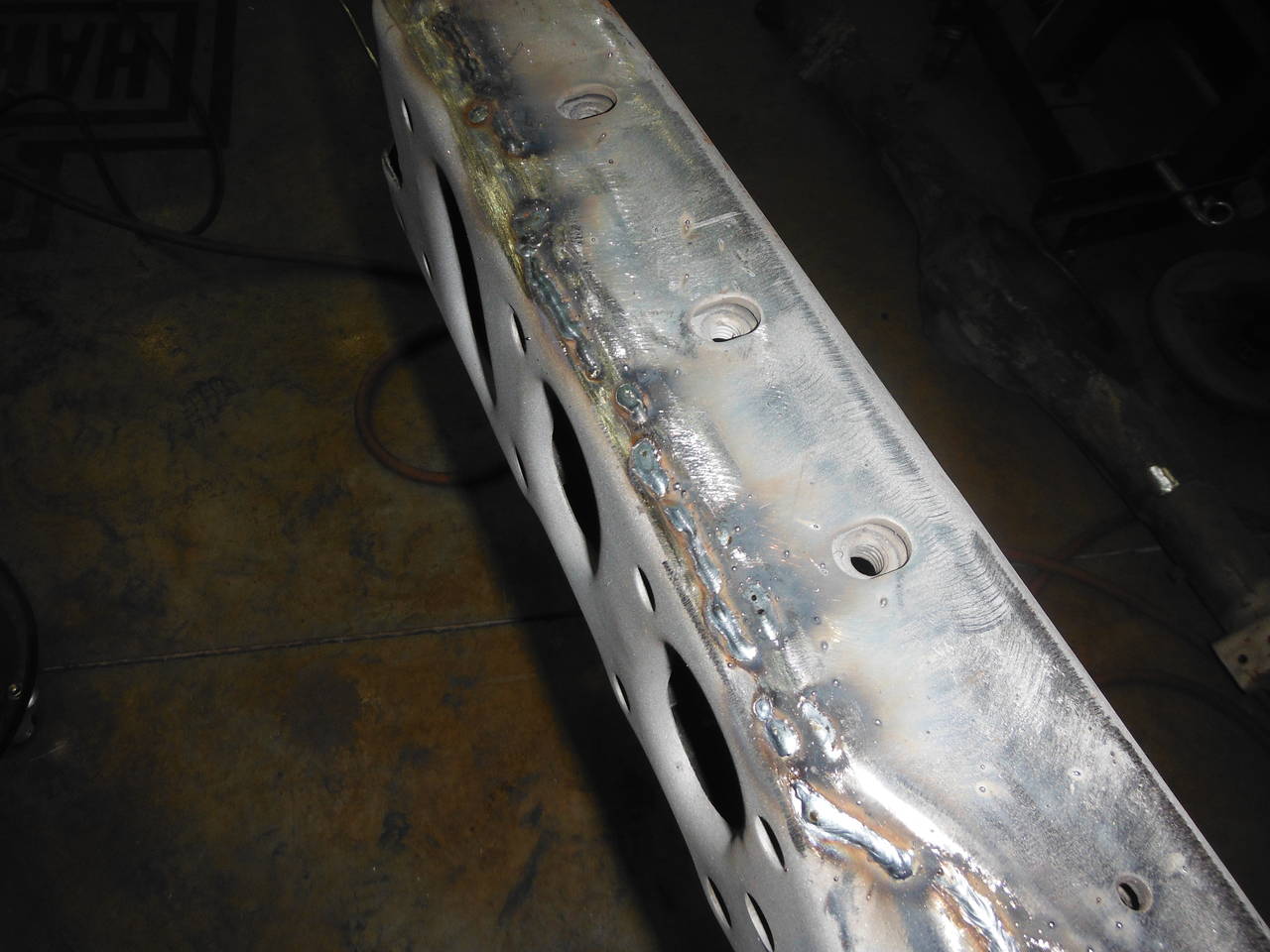

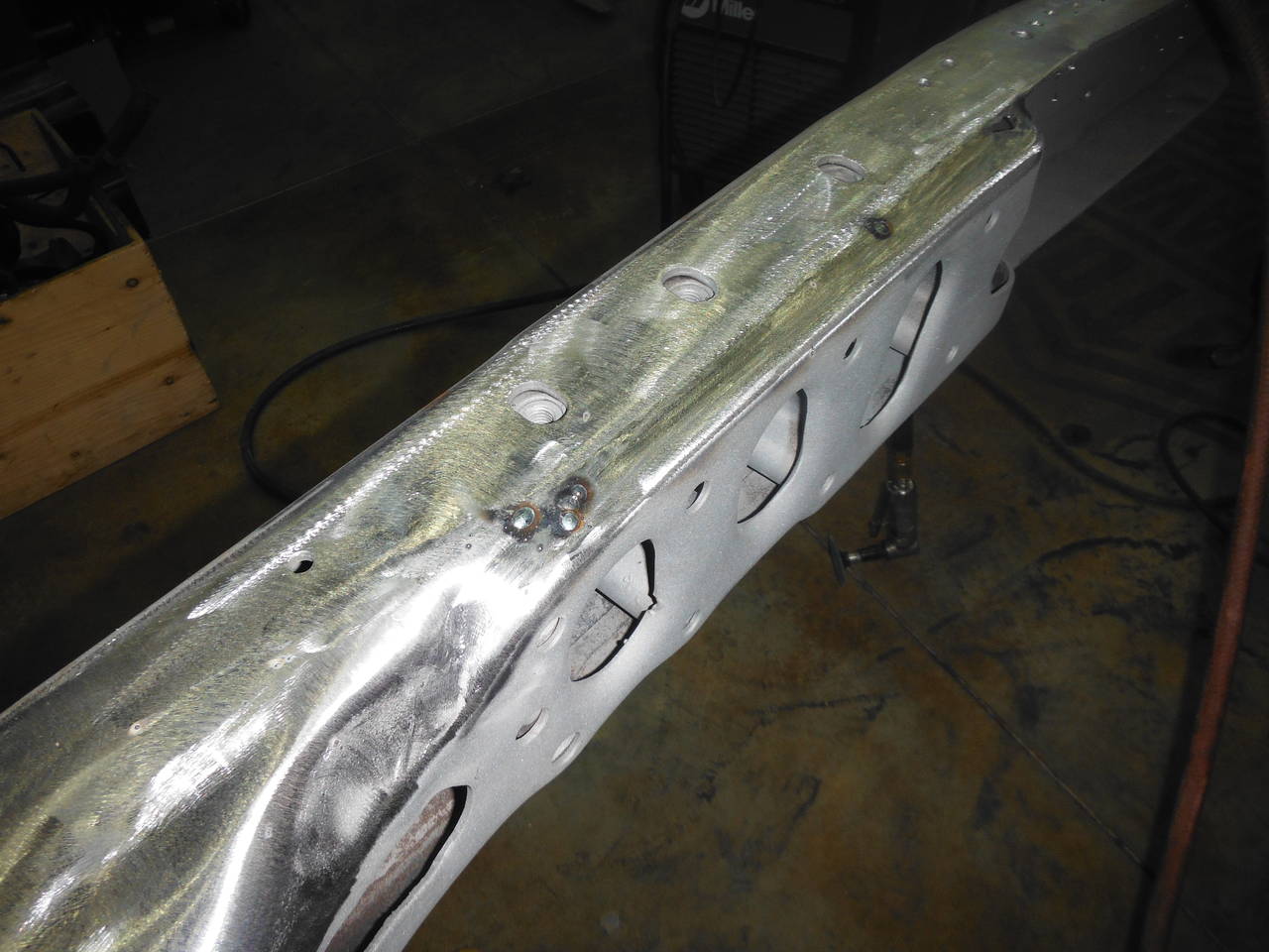

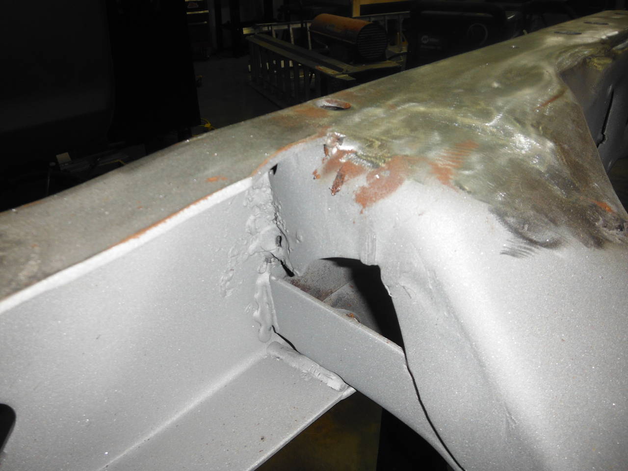

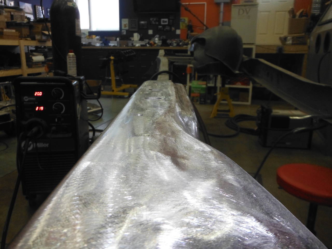

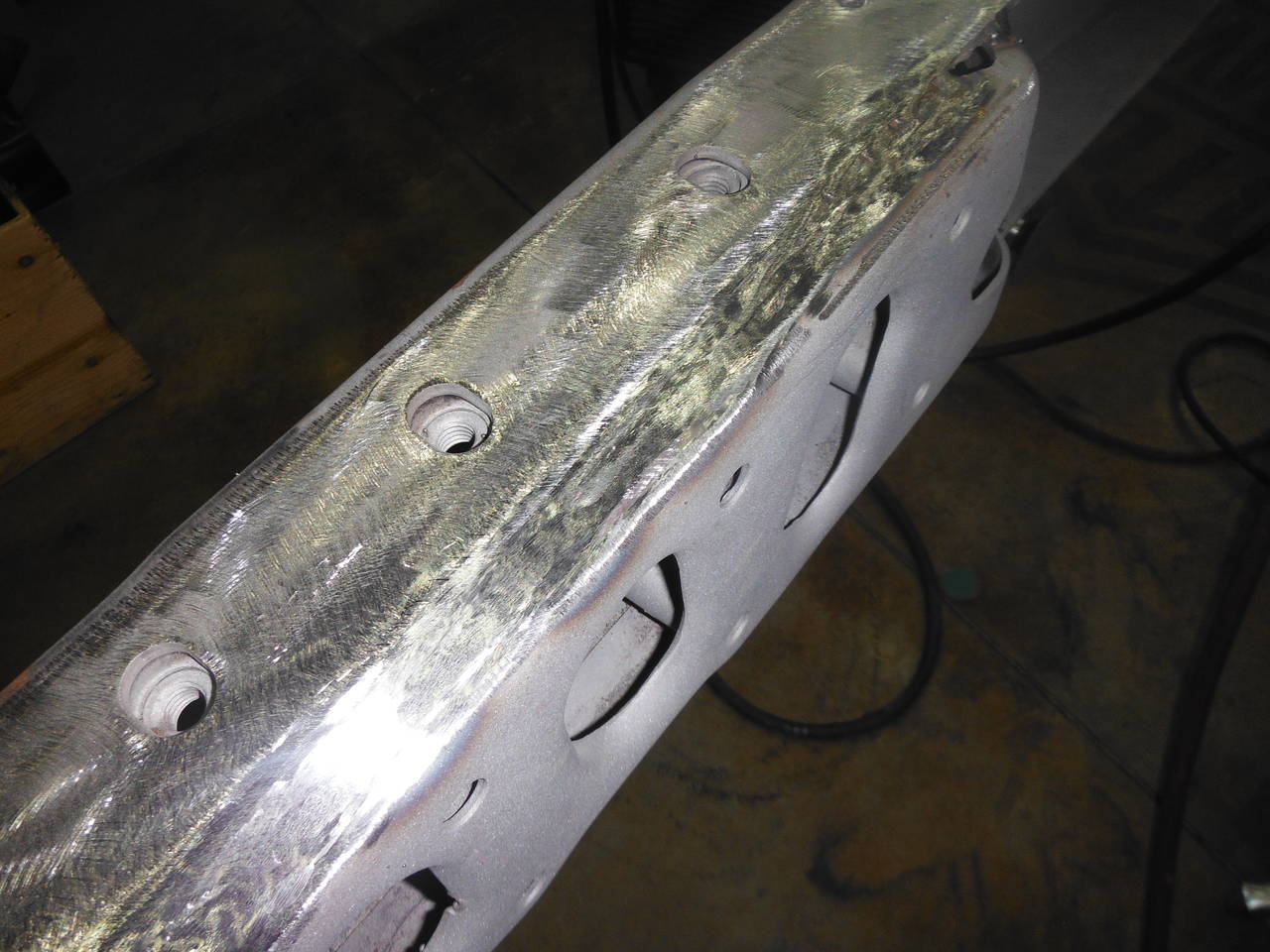

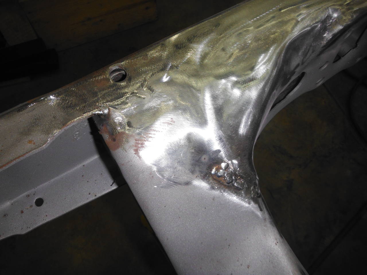

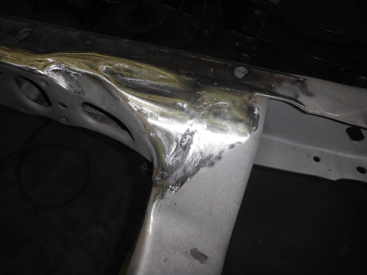

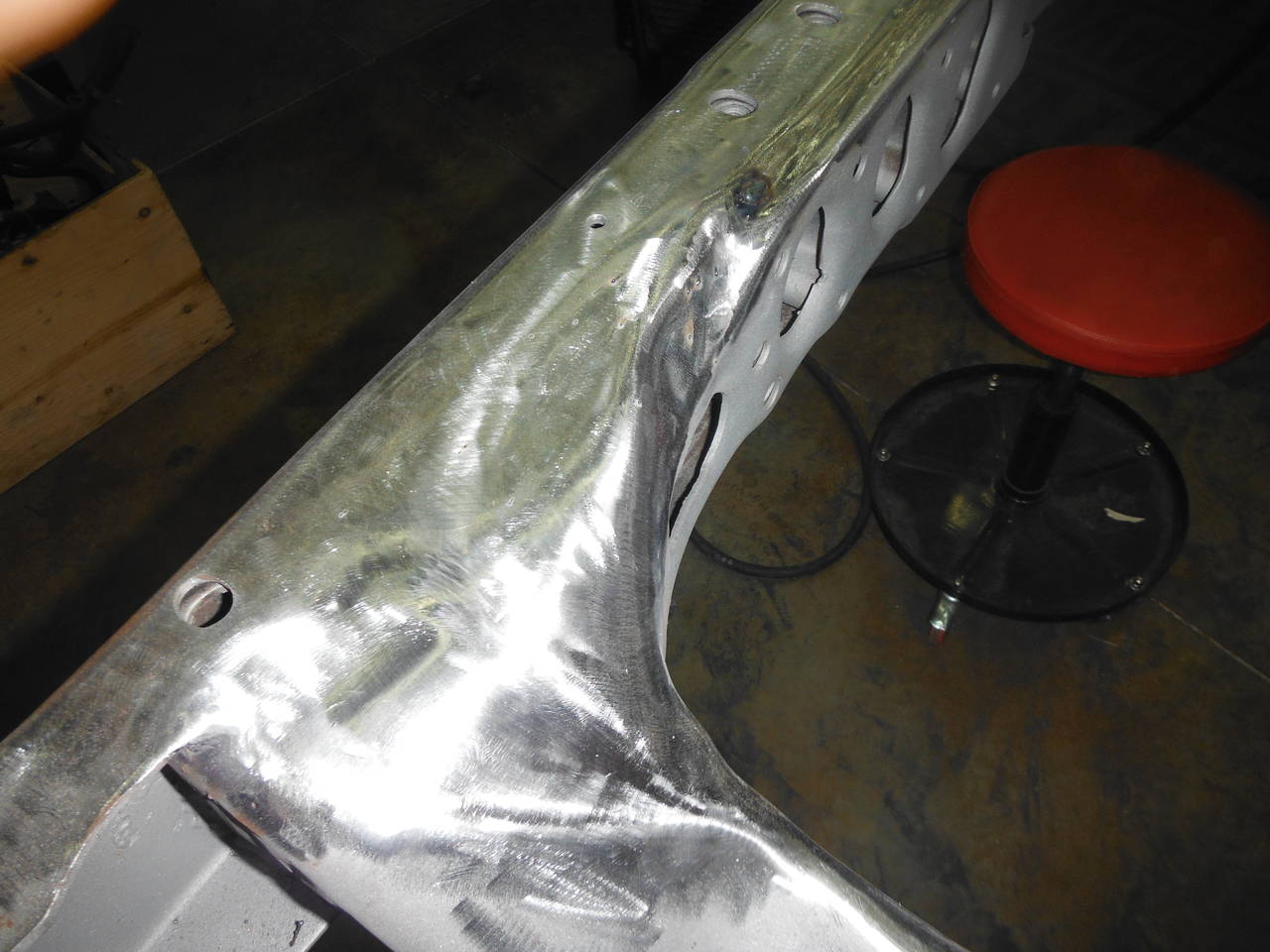

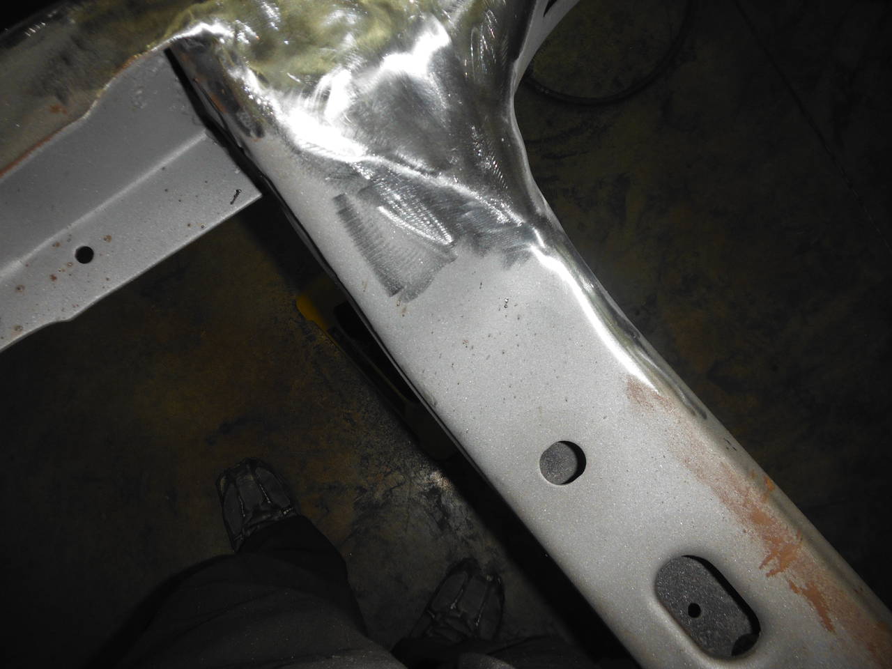

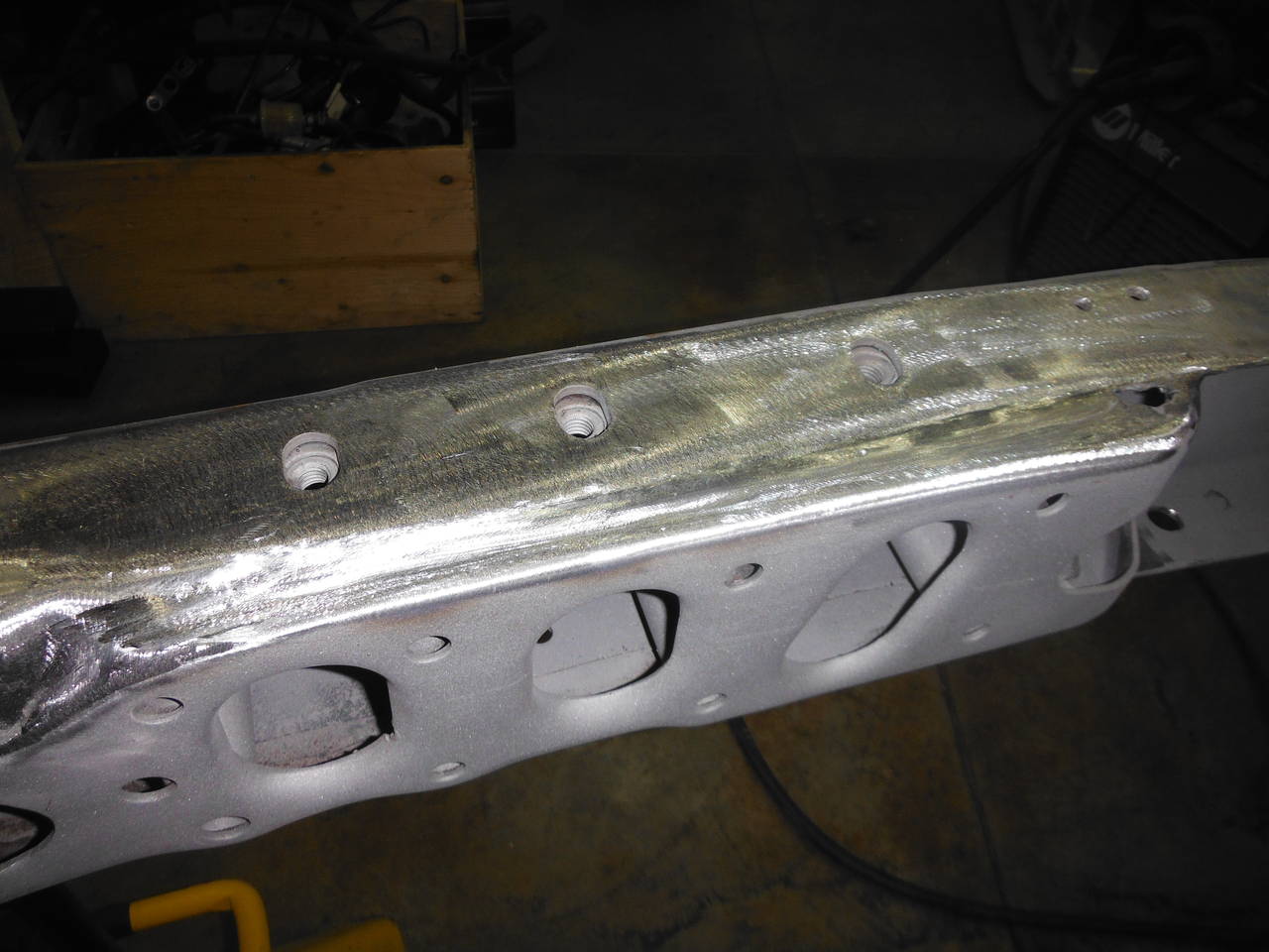

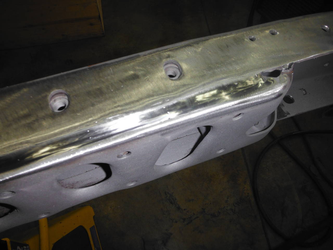

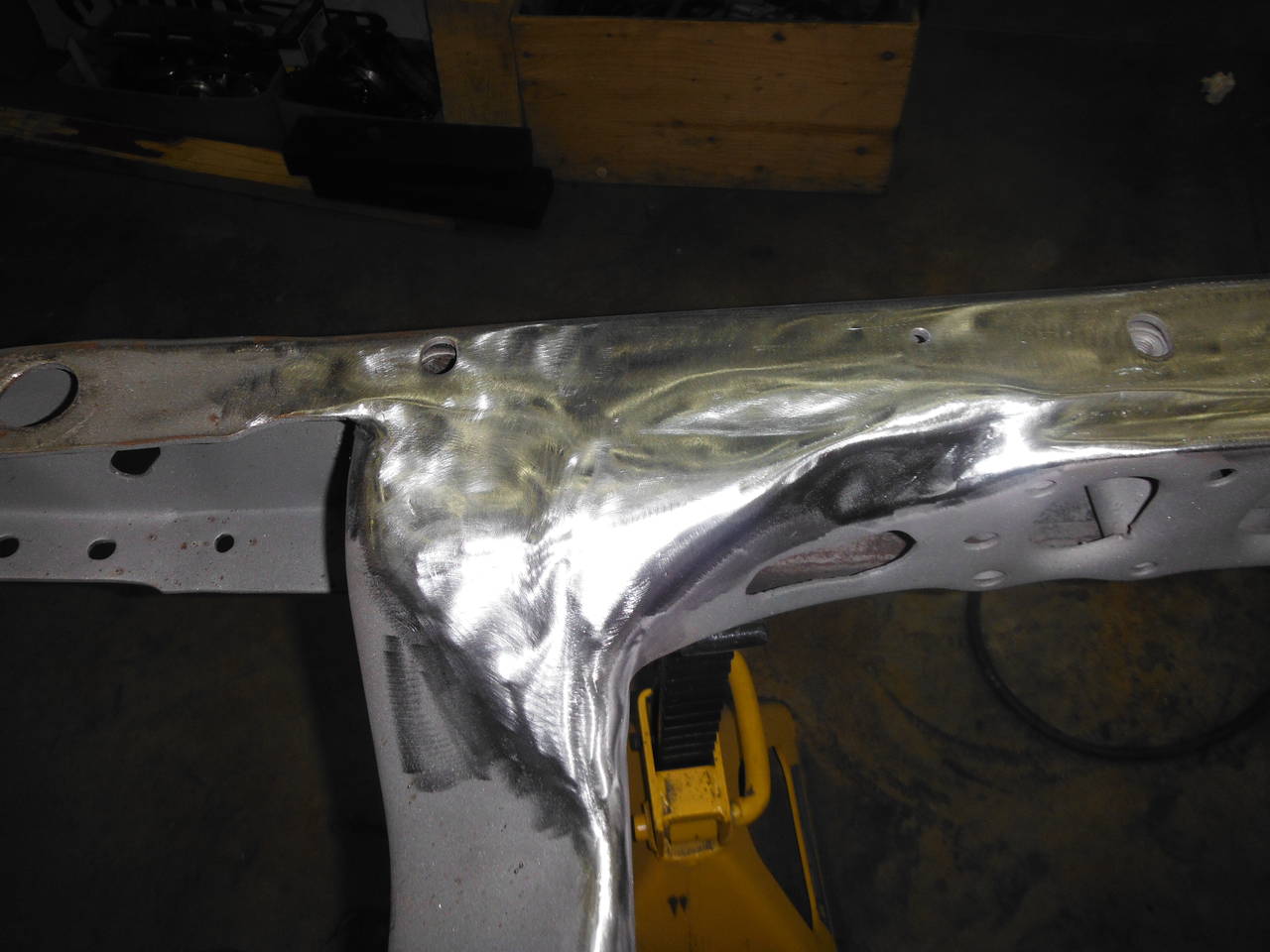

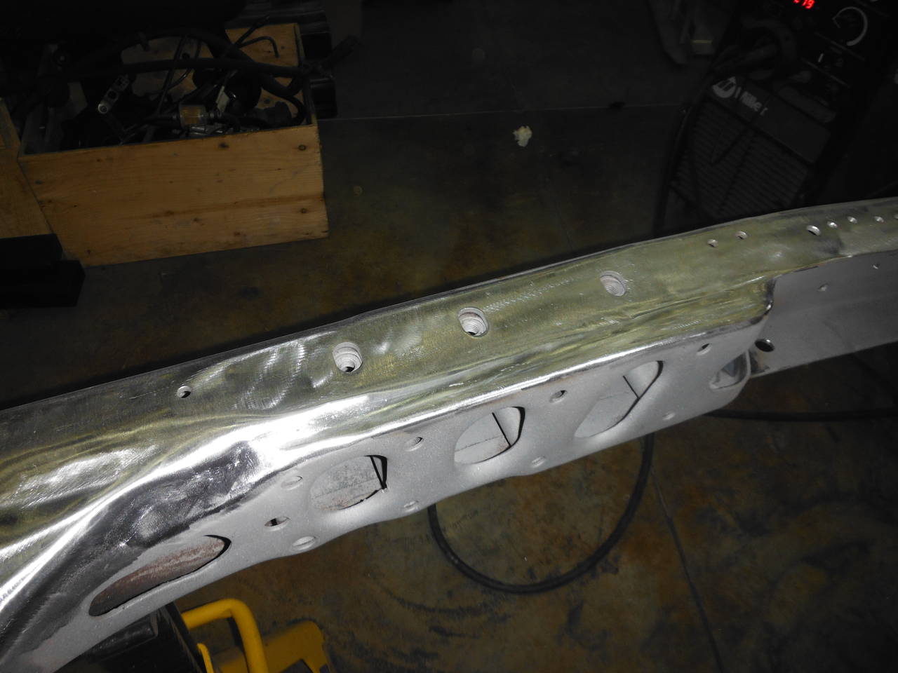

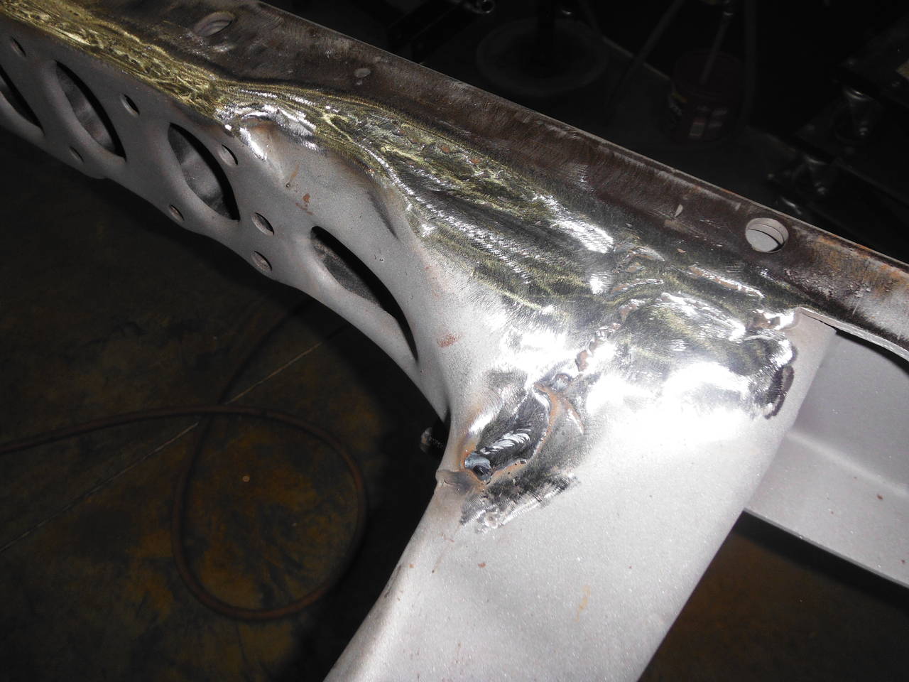

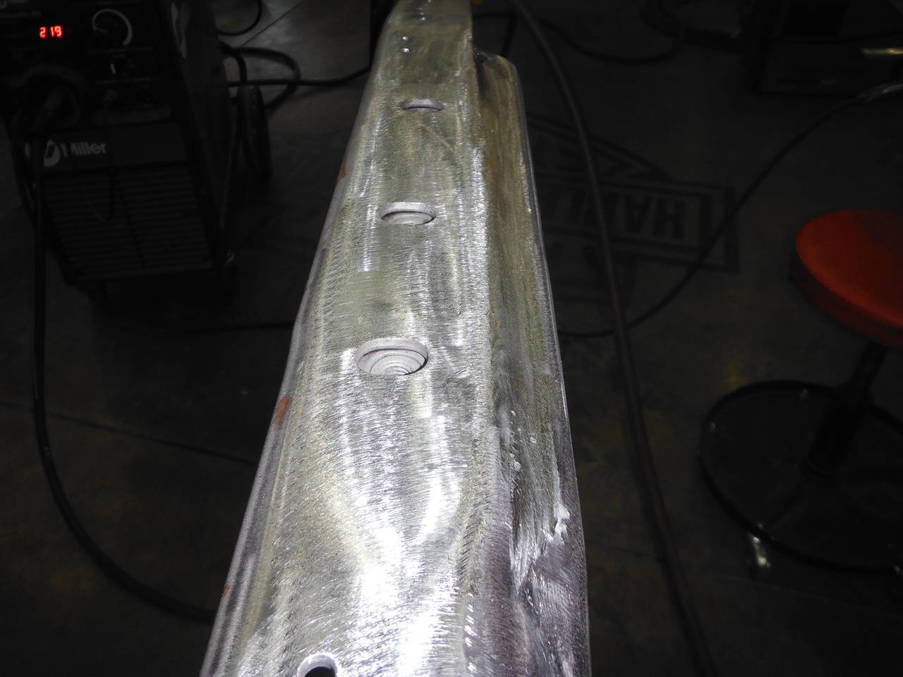

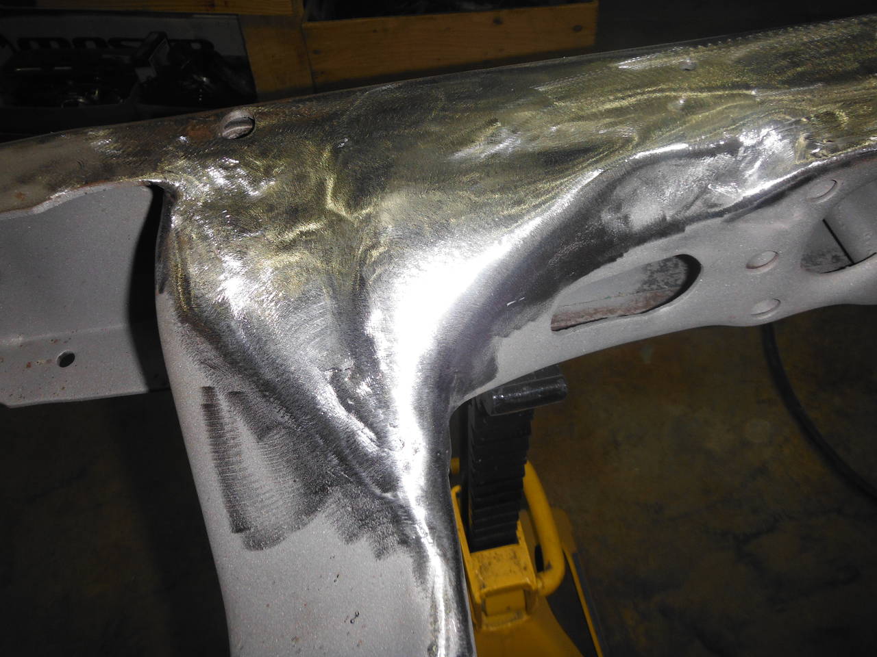

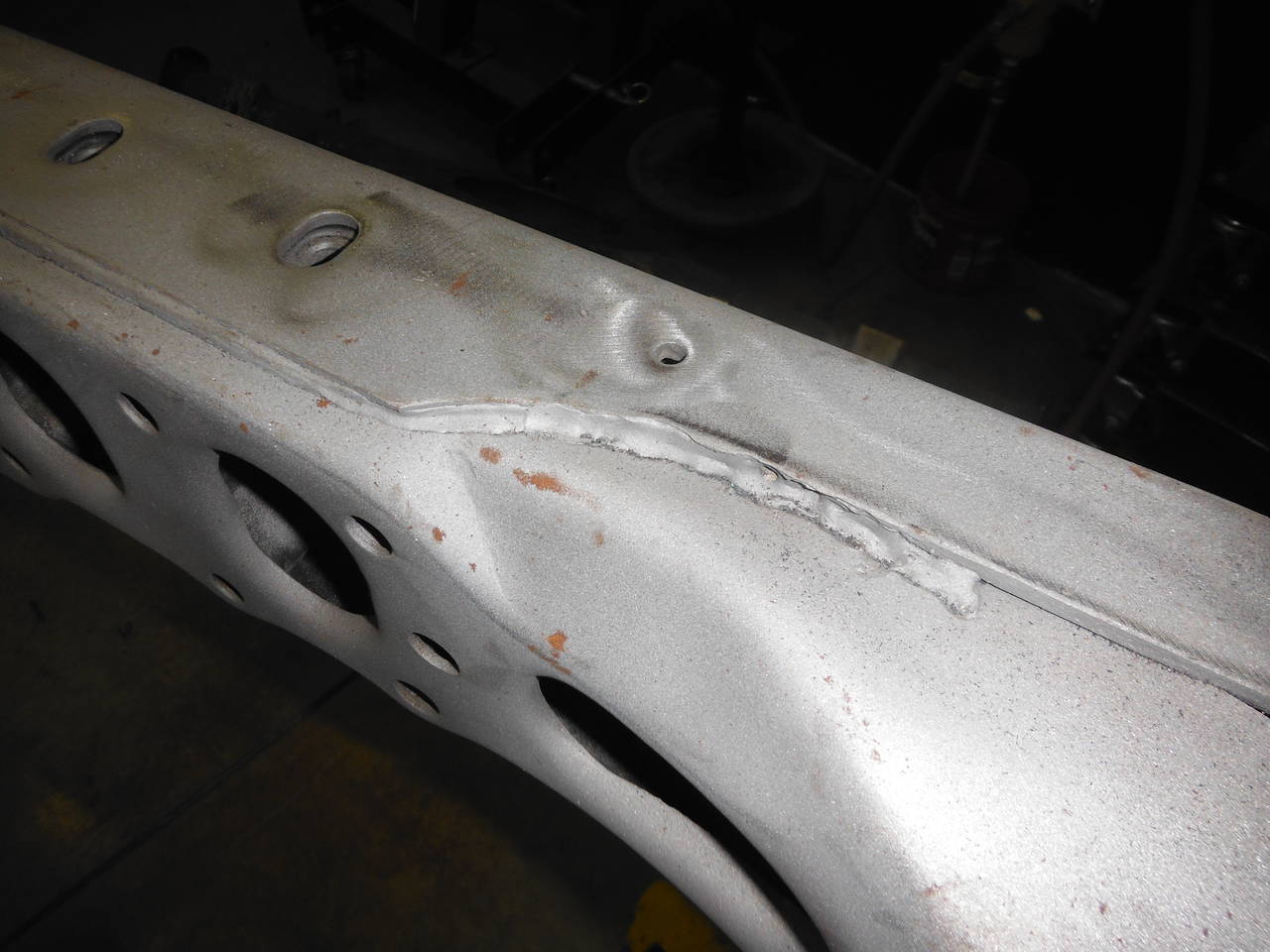

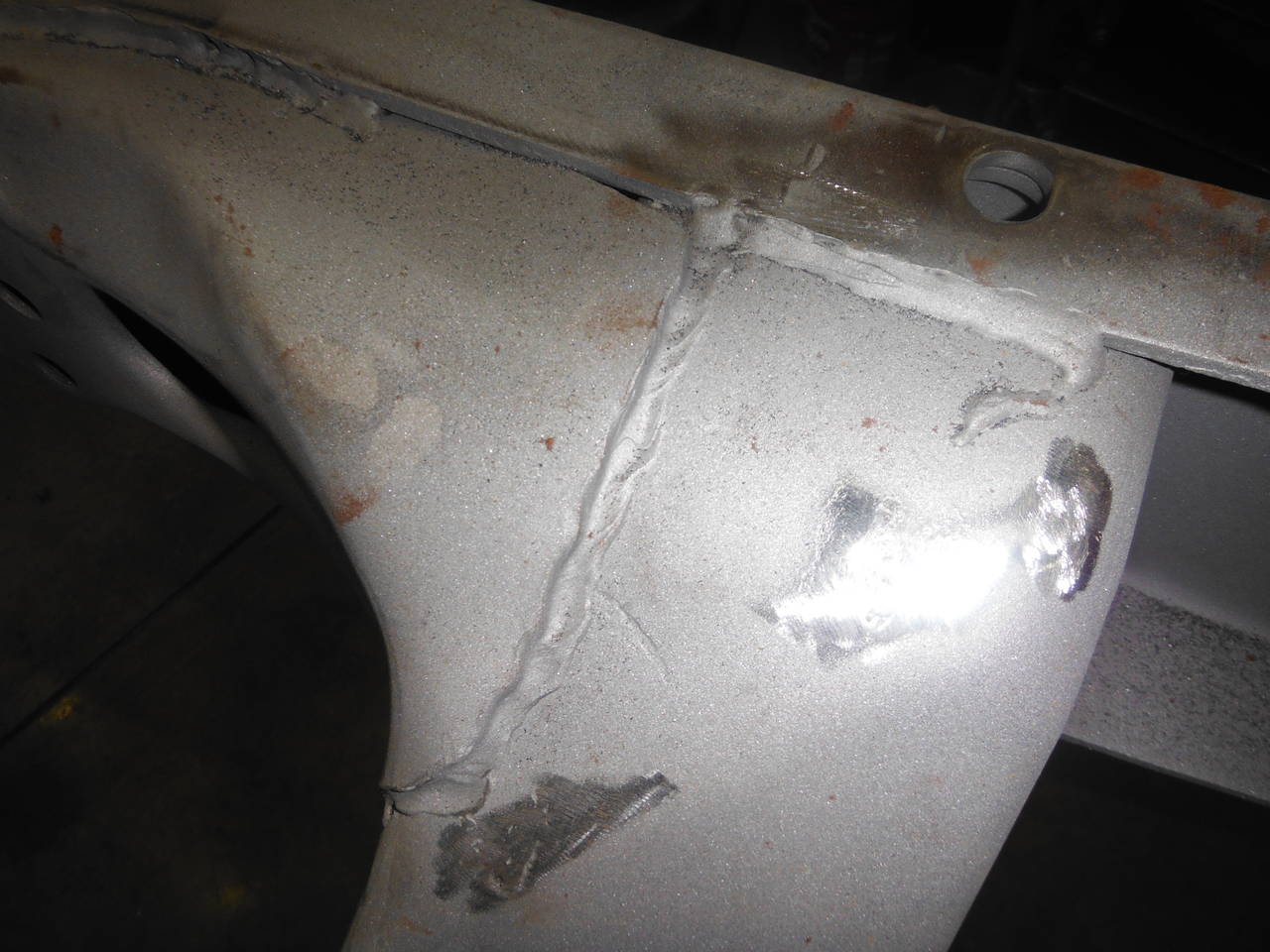

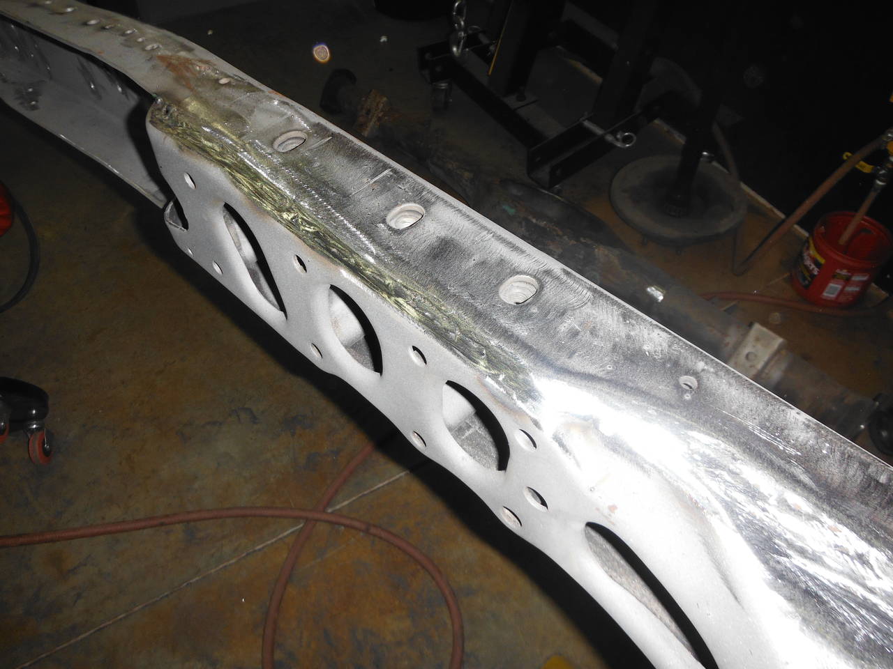

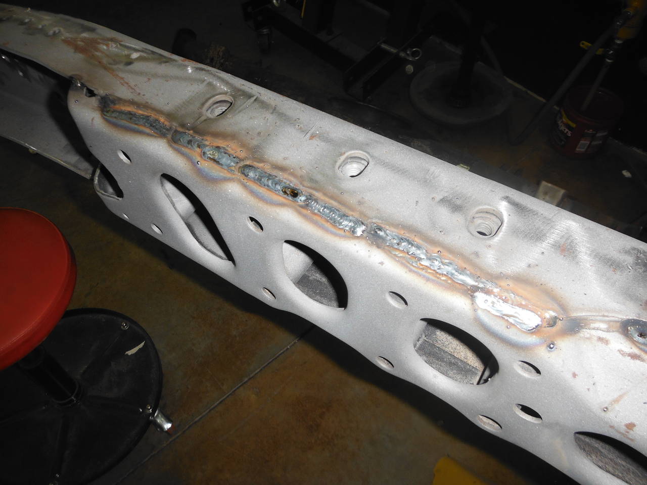

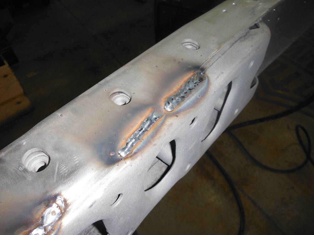

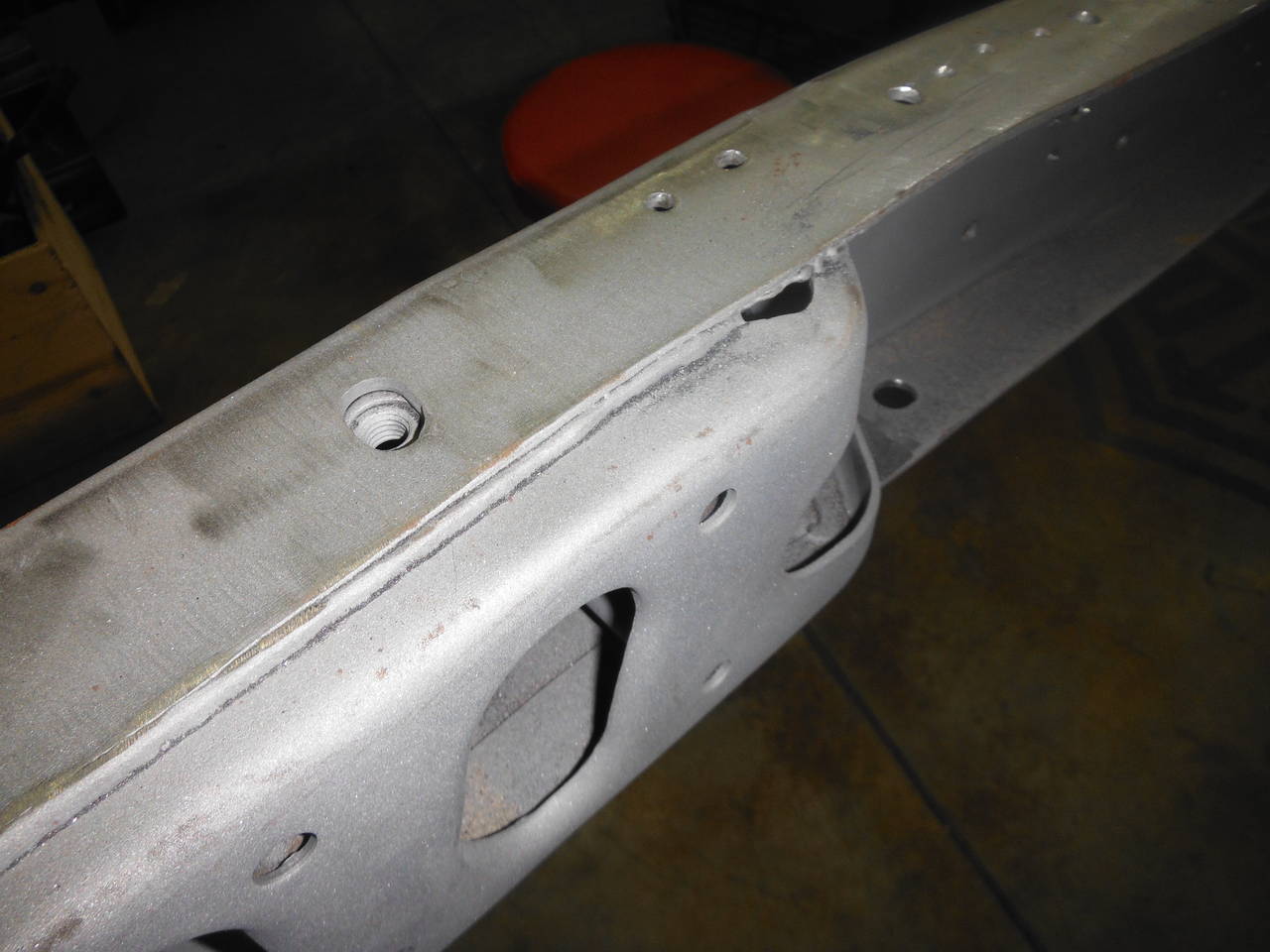

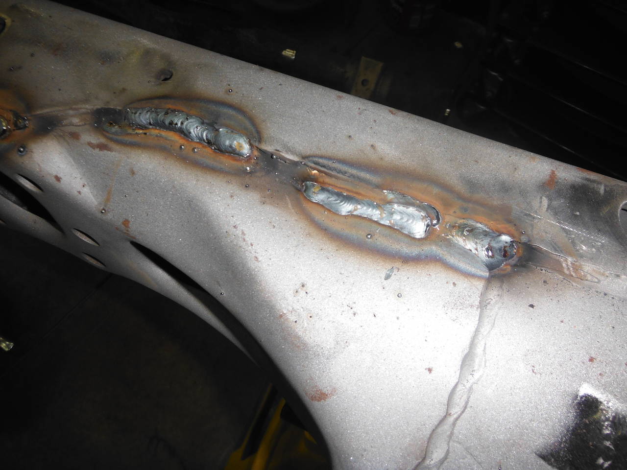

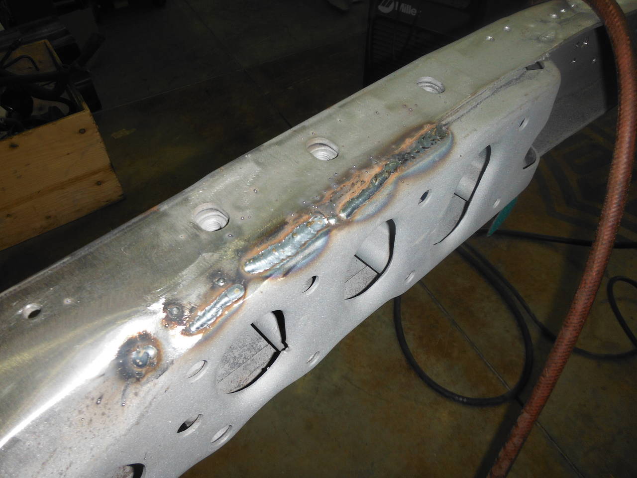

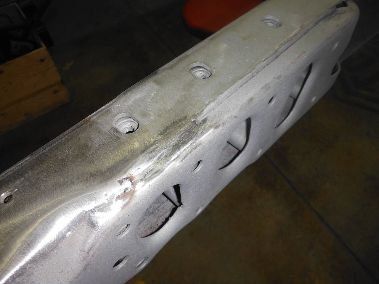

Spent the day grinding/filling/grinding the factory frame welds, quite time consuming but should look real nice once powdercoated.
It is a lot of work...hopefully the end result will be worth it.

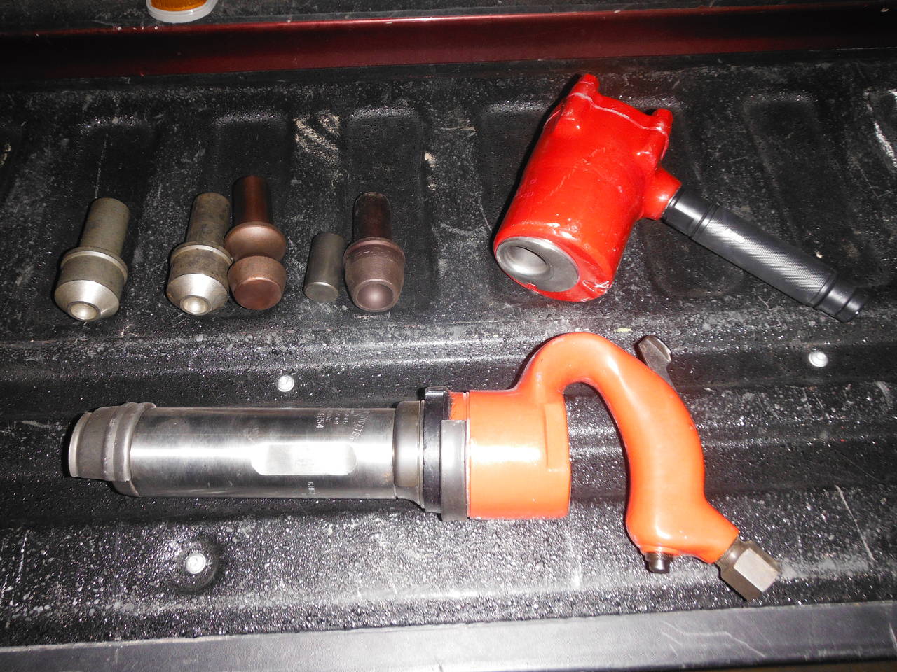

Finally got the riveting tool(s) sorted out and ordered today. Will be getting 2 units one is a standard hot riveter and one is an offset for getting in tight spaces.
Seems a panhead tool is tough to come by so I will be taking a standard flat tool and getting it machined.
Guess a set of torches is on the list now.

Got the riveters, looks like I will have to get another flat tool and get it machined to match the factory rivets.
Talked with the guy doing the bodywork/paint and he will bring his torch to my place and we will work on them here.
Only snag now might be the cfm requirement that the tools need, but hopefully with intermittant use my compressor will work...tool needs 35cfm...I have 15 available.
The shanks are over an inch diameter!
Nothing worse than the Pffttt Pftttt sound
Looks straightforward but I will practice first
