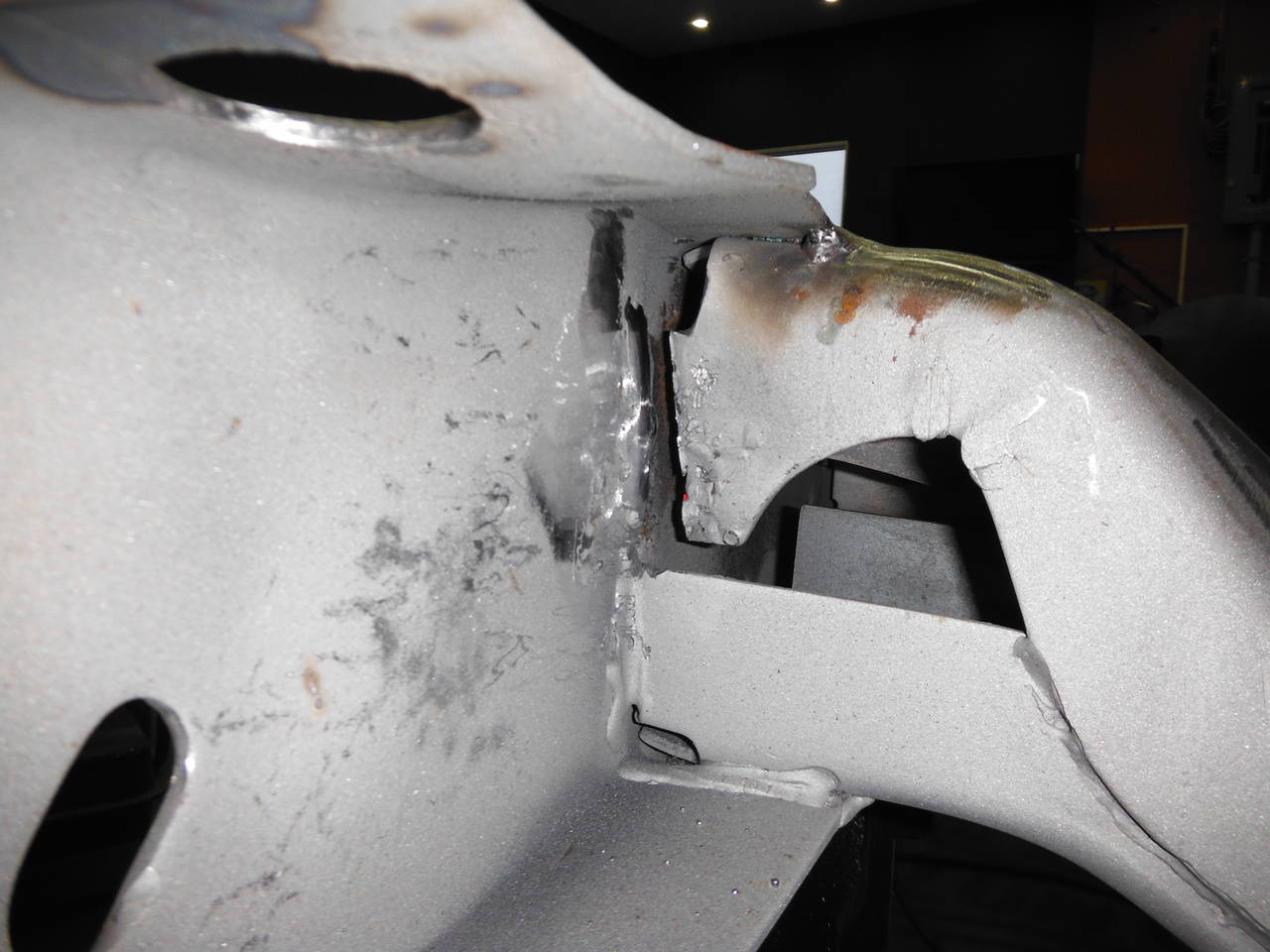

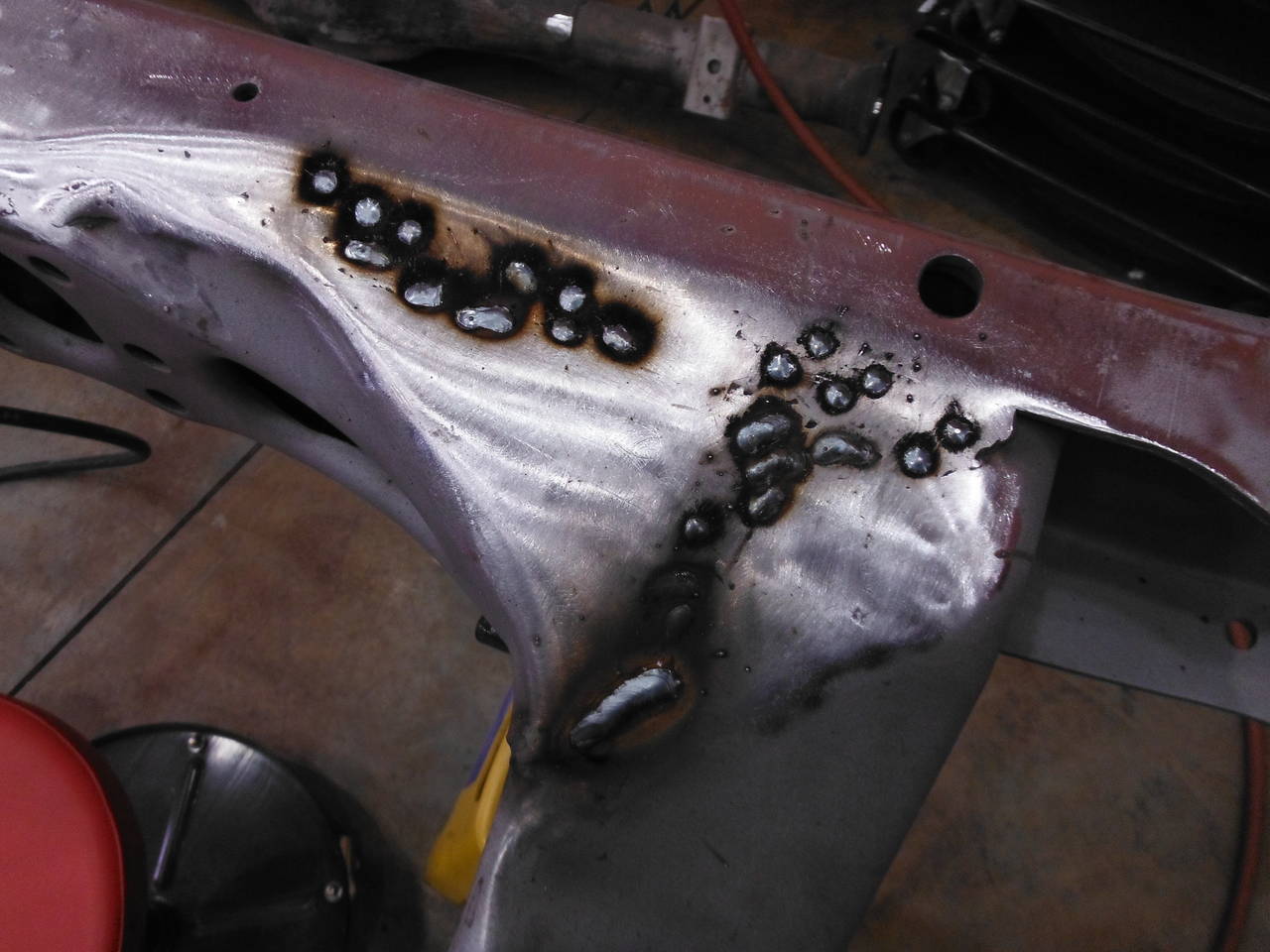

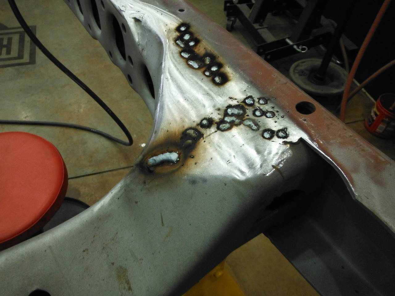

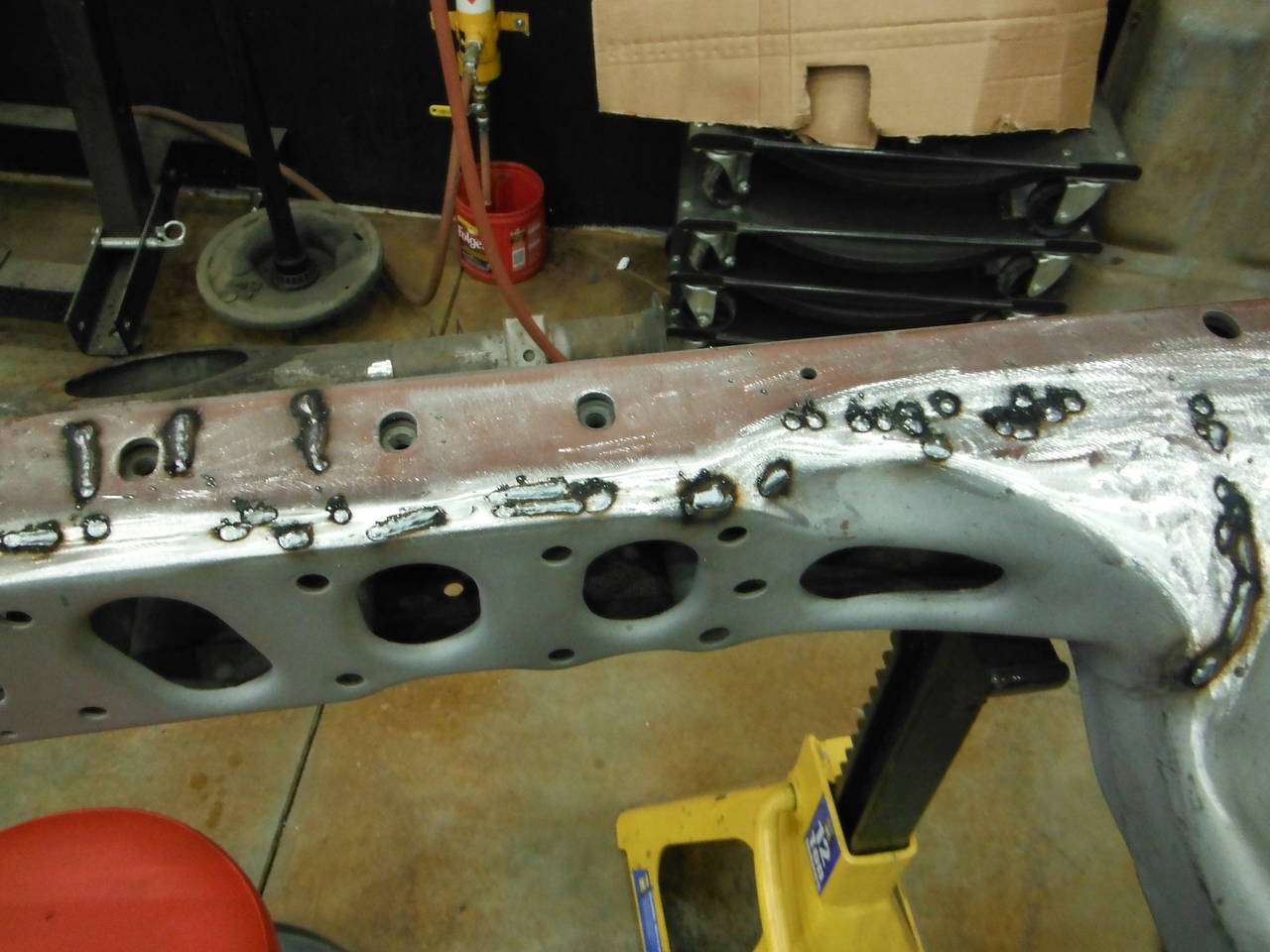

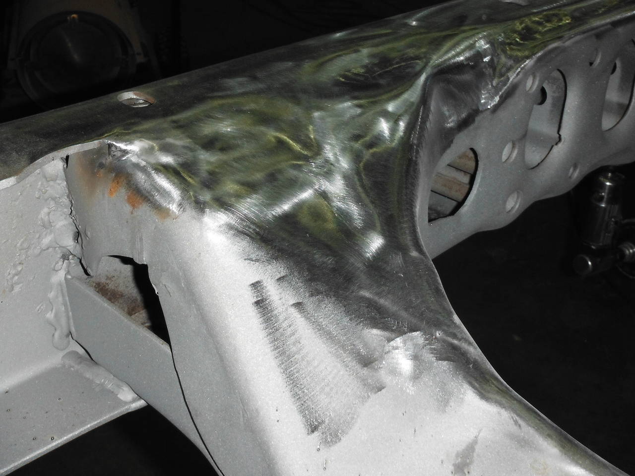

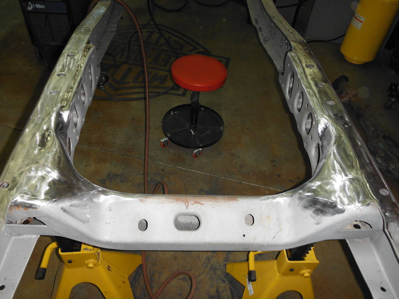

Spent the day on the frame.

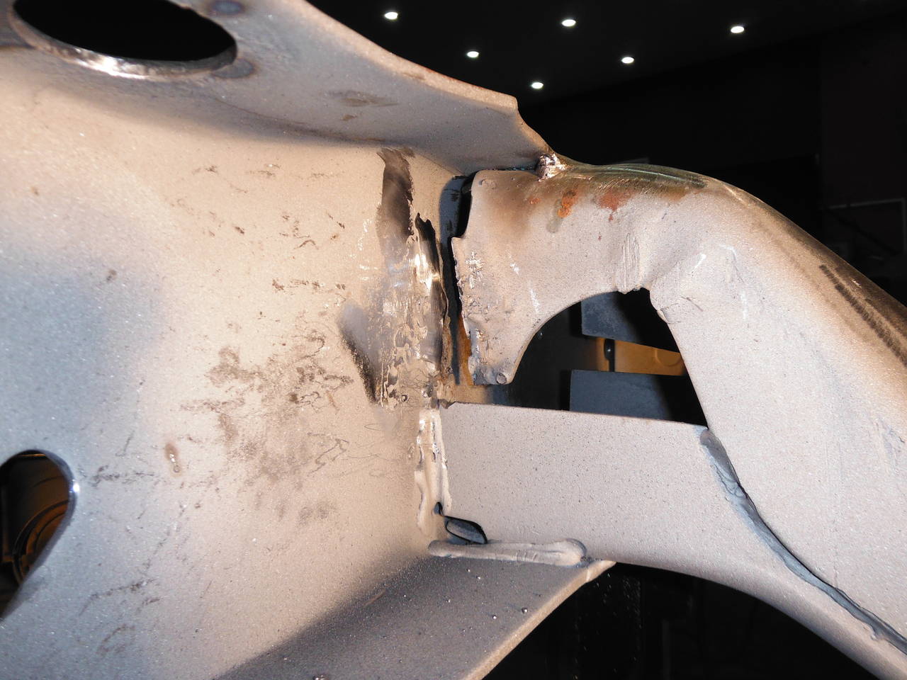

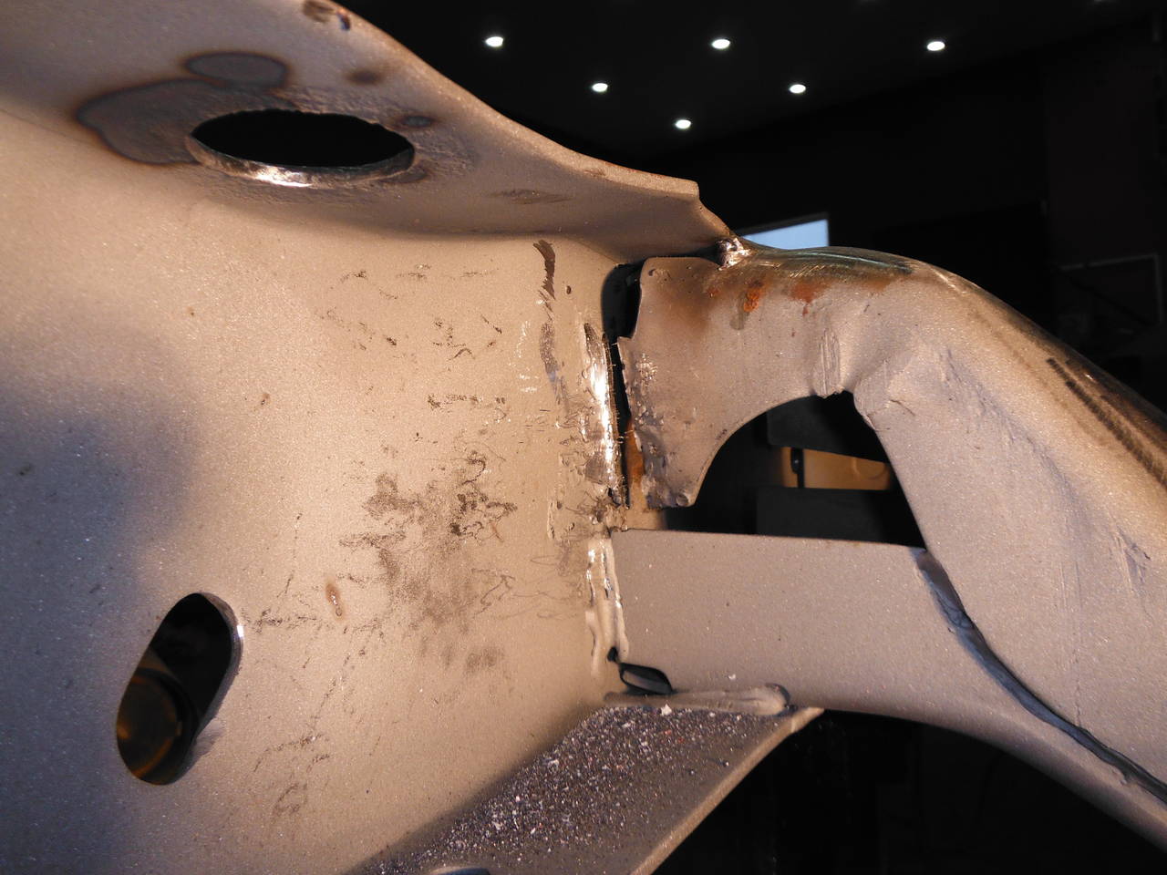

That factory weld on the cross member looks like $#!t . Was the upper part even connected ?
Yes it was, I cut it and bent it back so I could clean it up..it is a horrendous weld.
I will weld a stud to it and use a slide hammer to pull it straight then reweld it after I've cleaned up the frame rail.

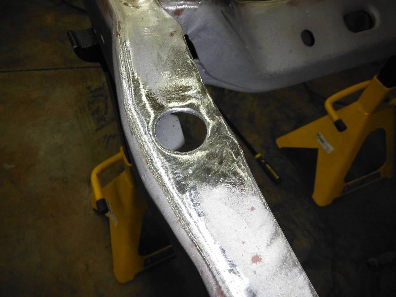

Thanks Buck...I'm damn near done the top of the frame.

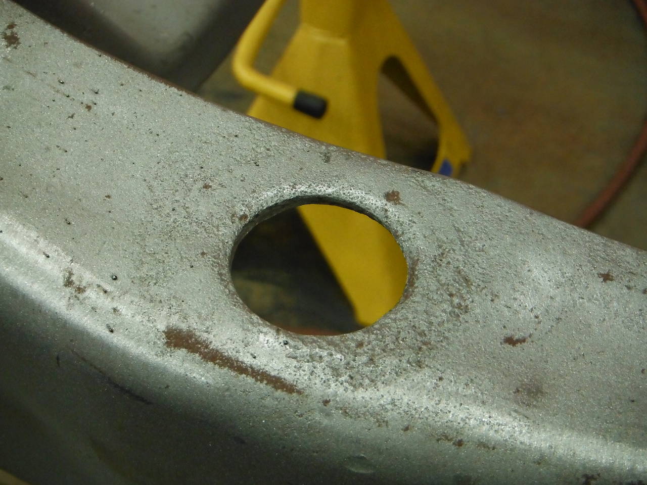

Probably so...although the idea was so the powdercoat wouldnt have sharp edges to adhere to
