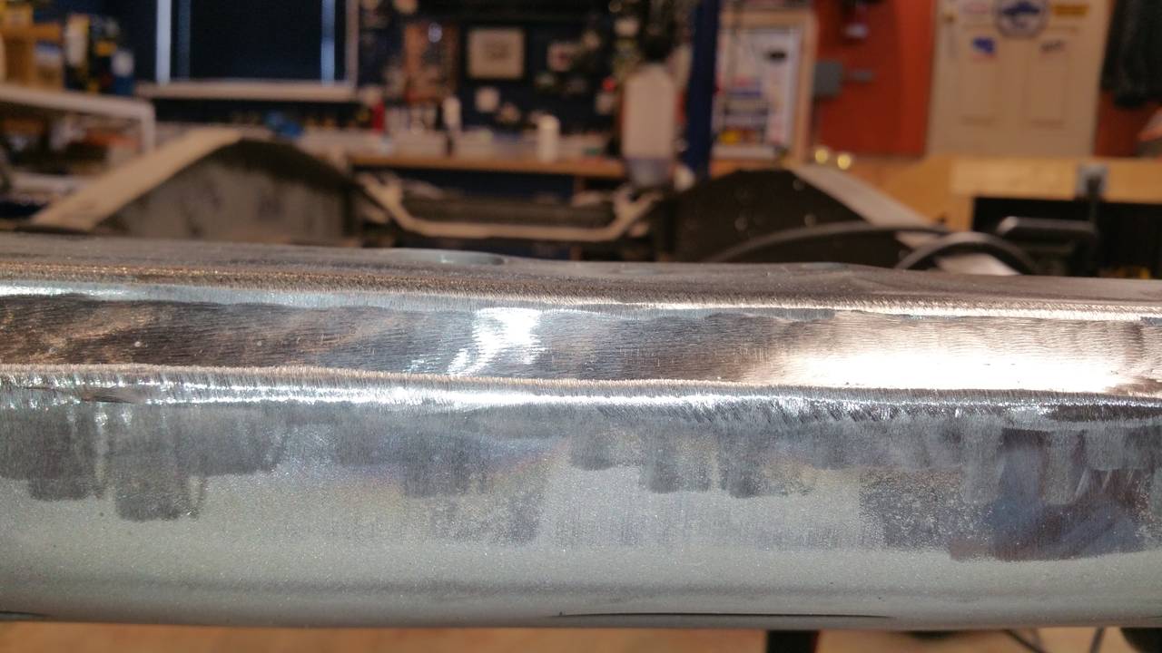

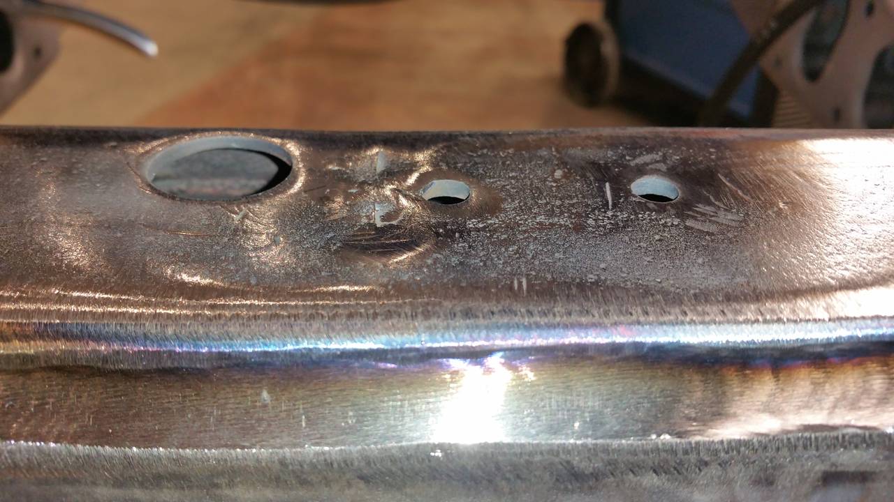

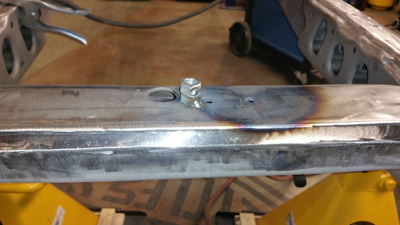

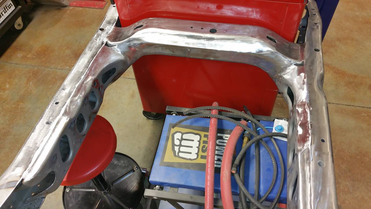

Pretty much got the underside of the front crossmember area all done. The place where the steering damper was attached was somewhat fekked up probably from tagging stuff over the years.

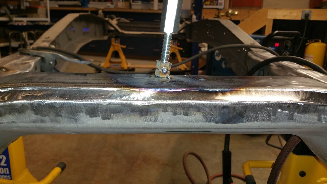

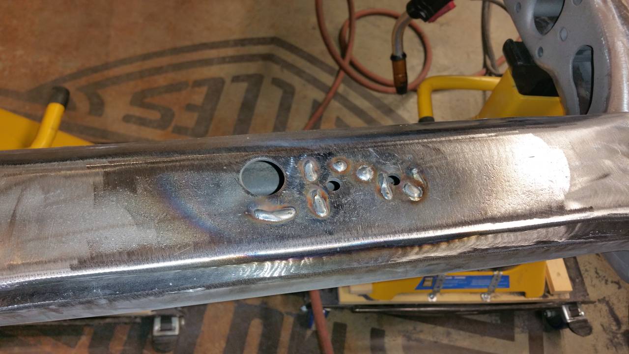

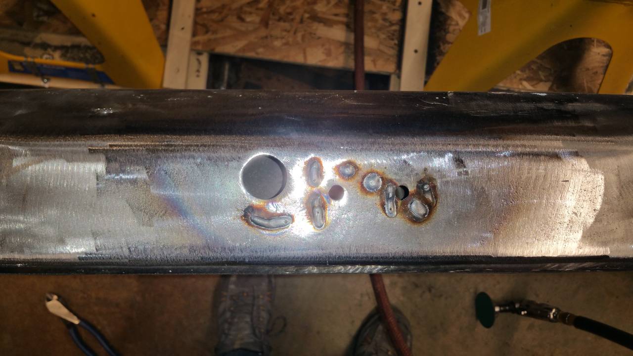

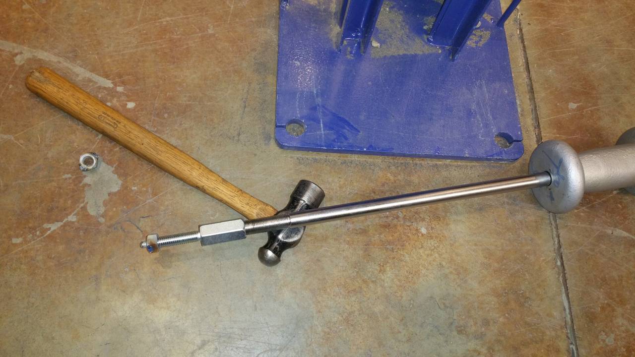

I put some heat on it and used a wrist pin and 2lb hammer to flatten the high spot and then welded a couple of nuts on to the low spot and used a slide hammer to pull it up.

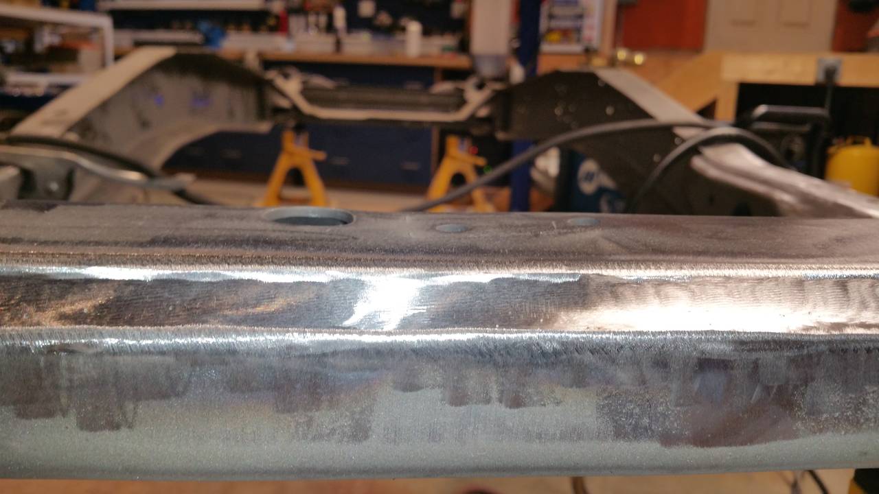

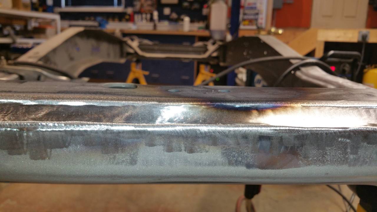

I'm pretty happy with the results.

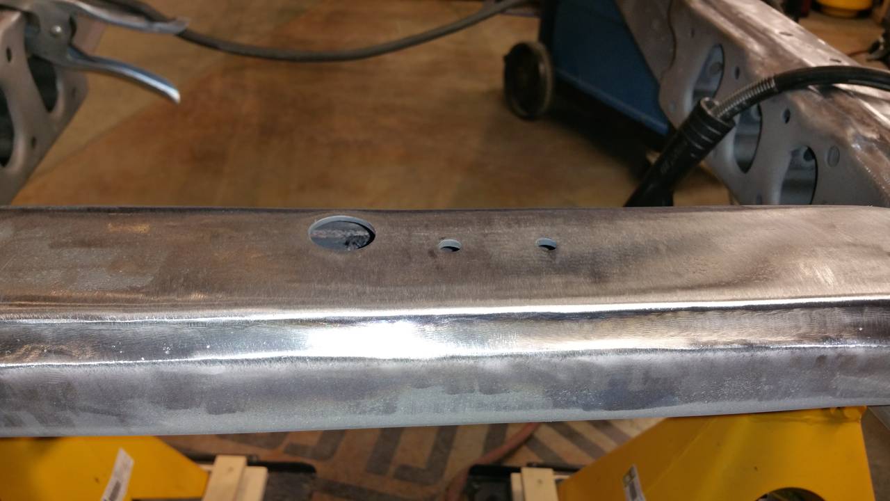

I ordered a set of carbide burrs to do the holes, sanding drum was pissing me off
