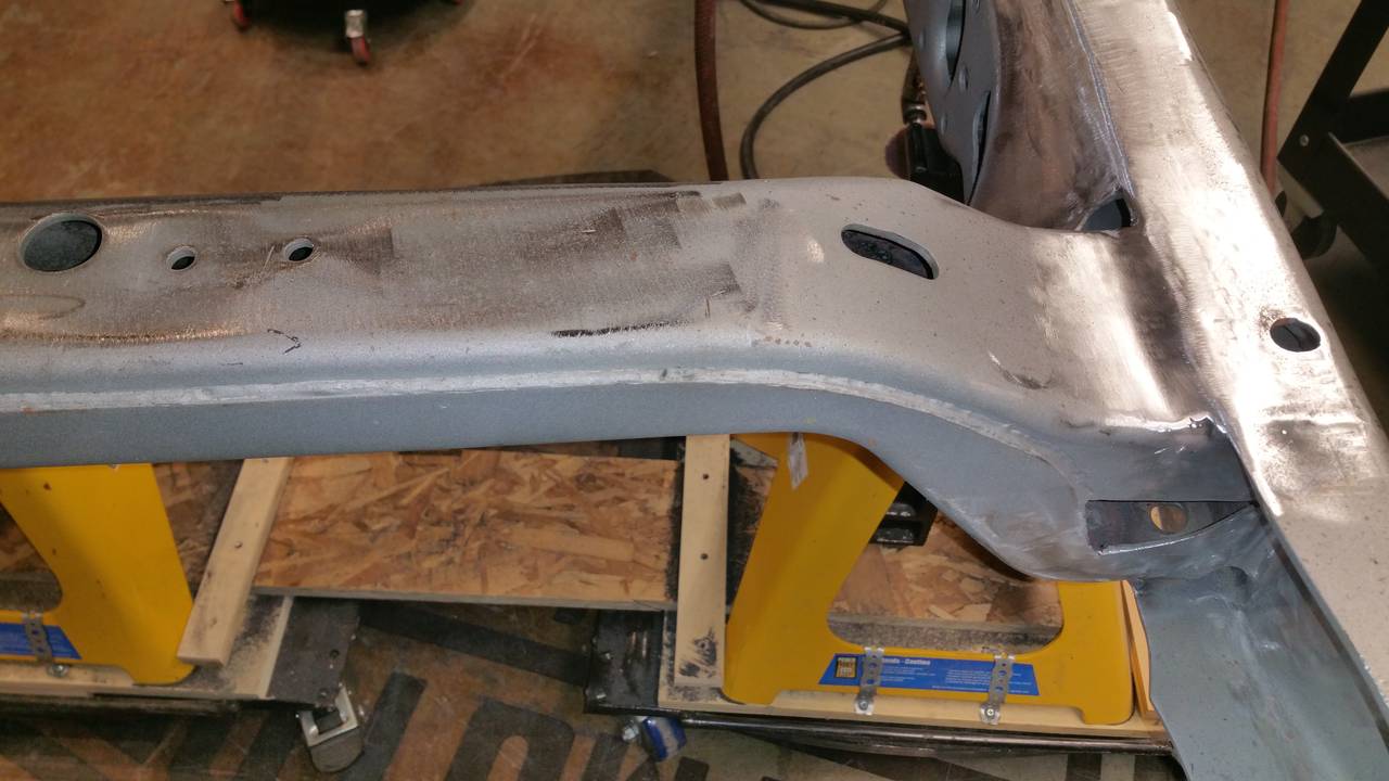

Duncan, are you going to do anything with chemicals while the frame is completely exposed like that? Like fluid film or something similar? Or is the type of paint you put on going to be enough to rust proof it?
Powdercoating and teflon dry film
I think he was going to powdercoat the frame? I might just talking out my arse, also.

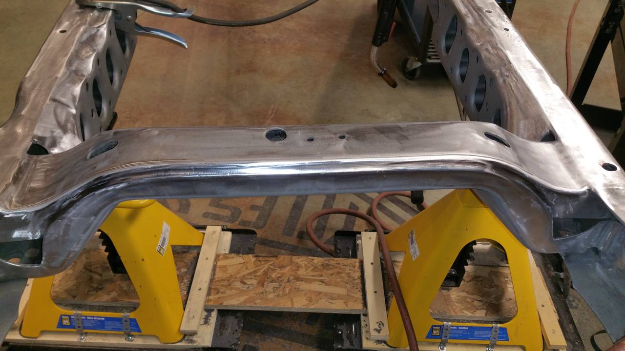

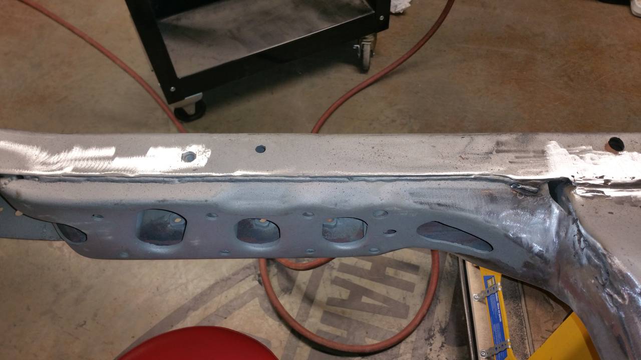

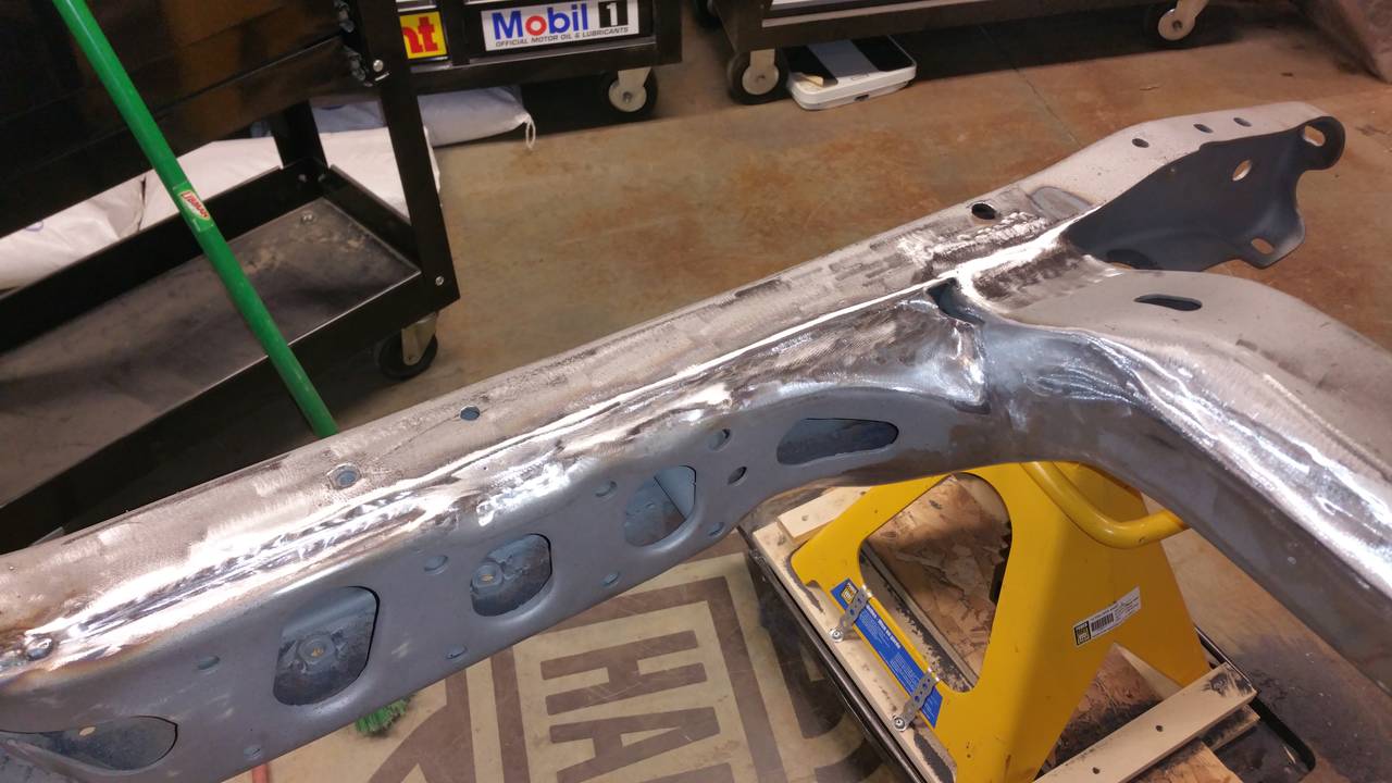

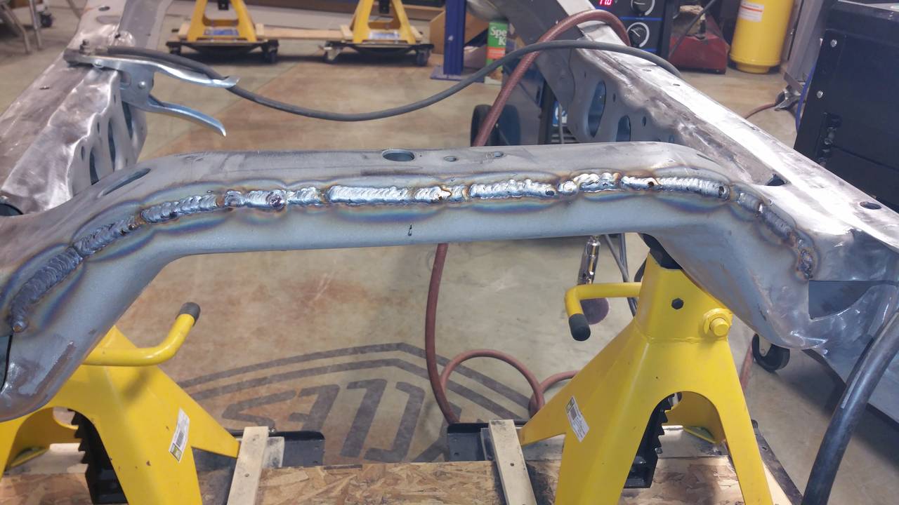

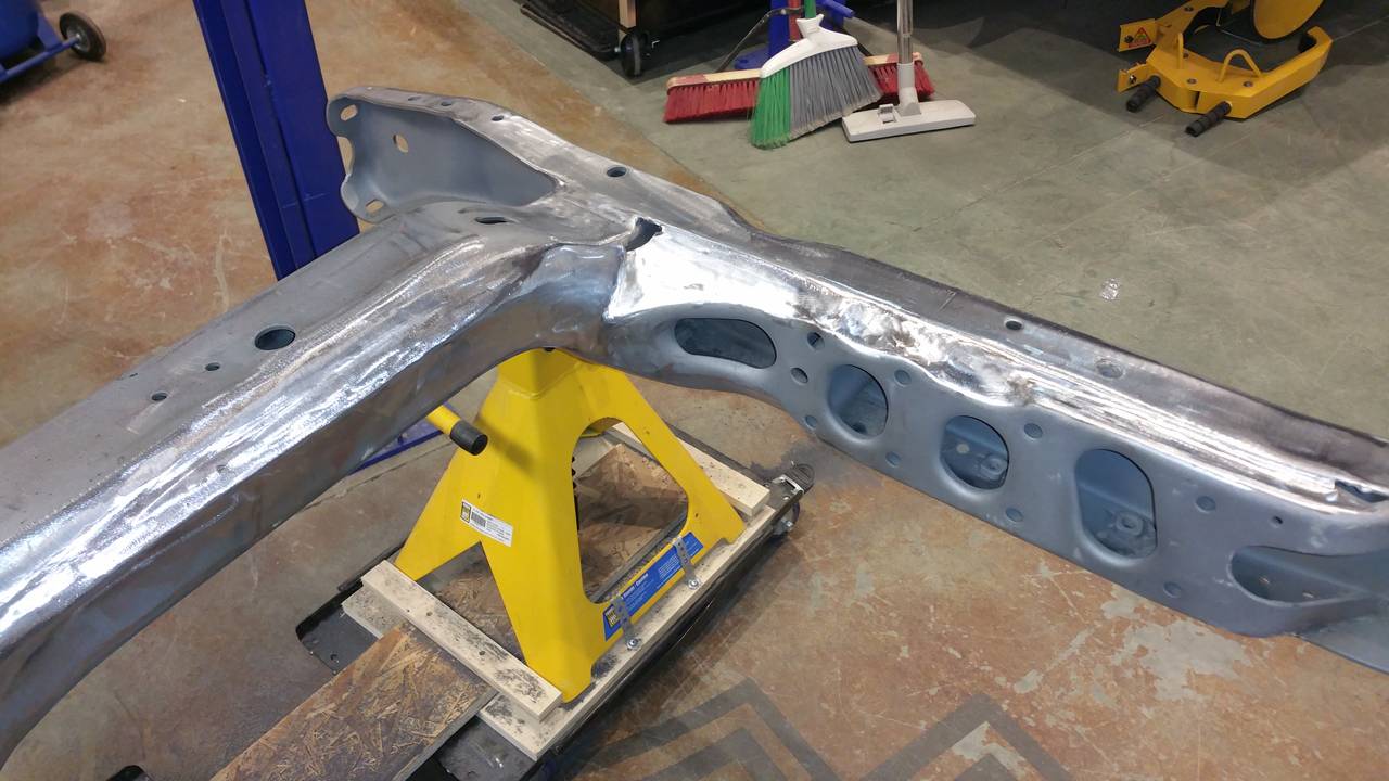

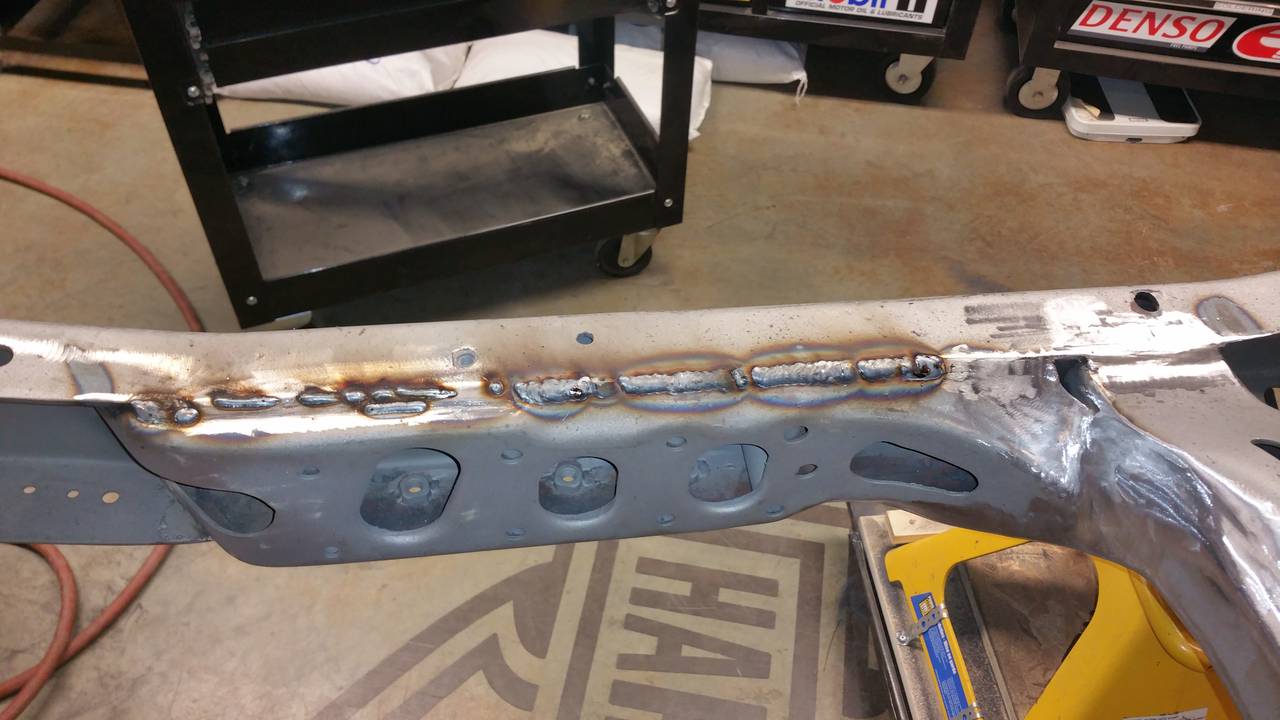

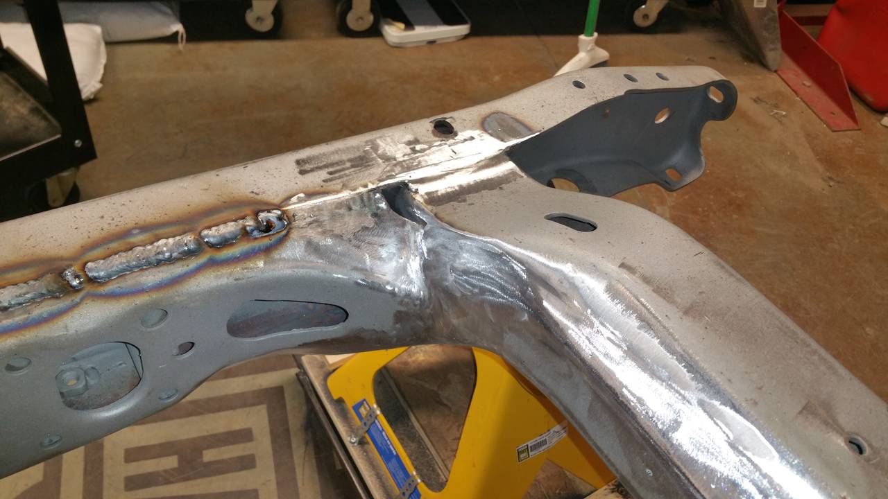

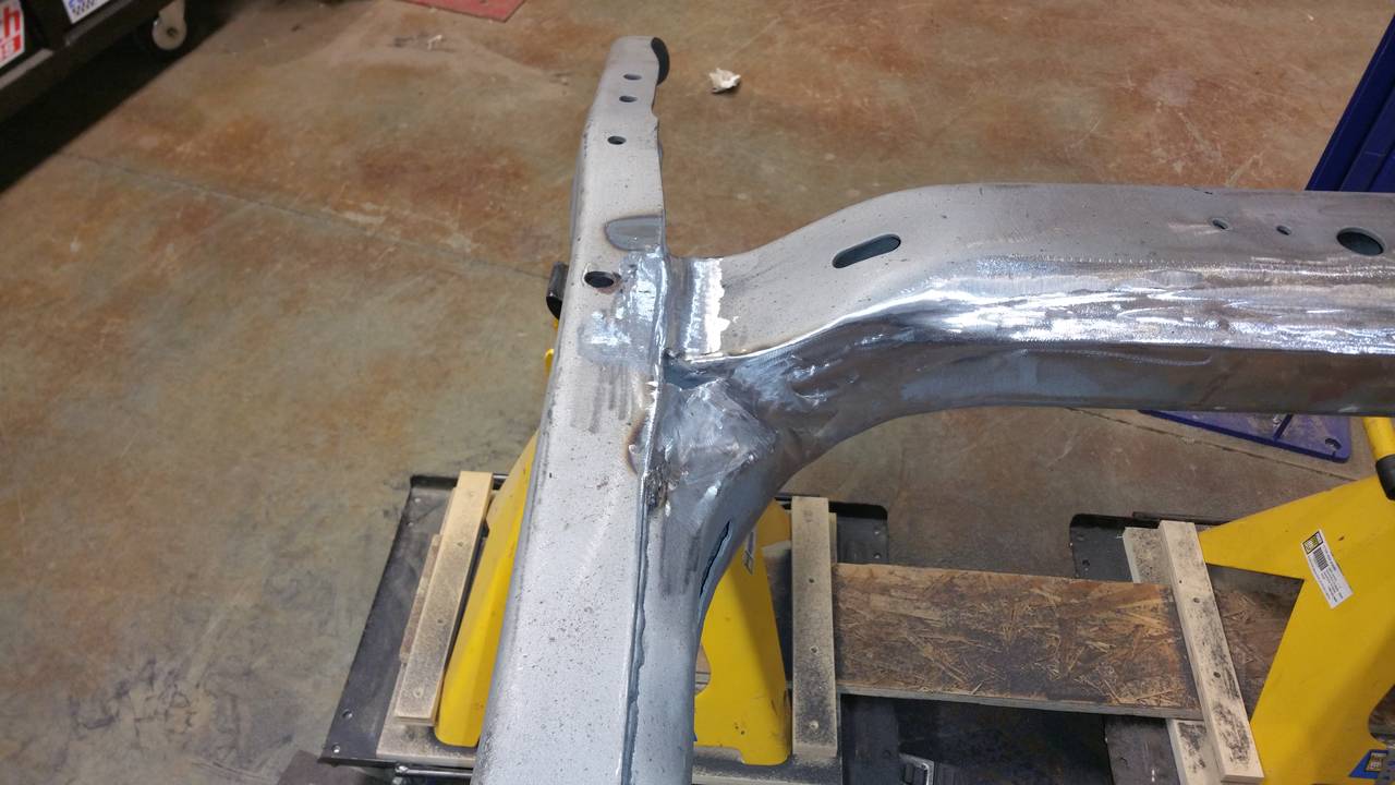

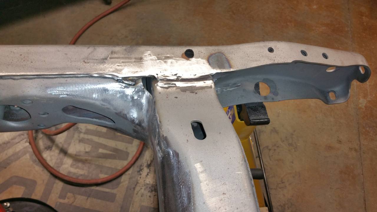

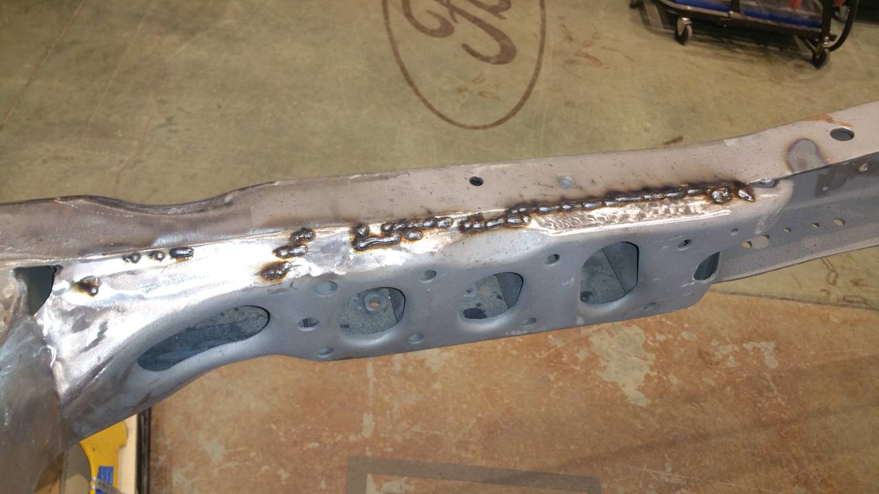

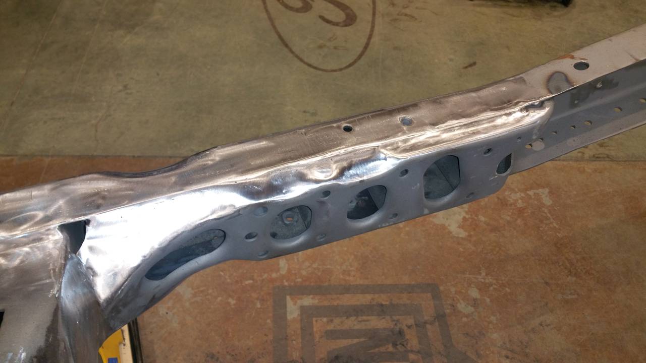

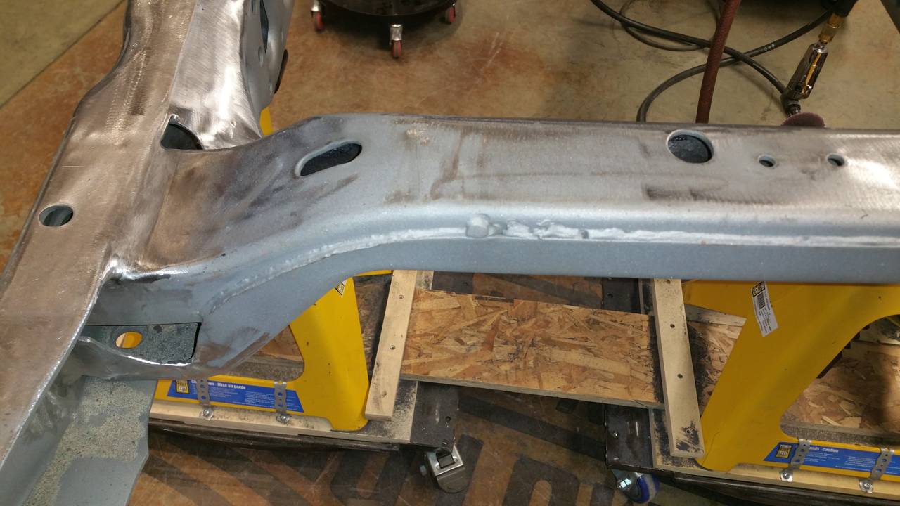

More progress today.
Beautiful, Duncan!

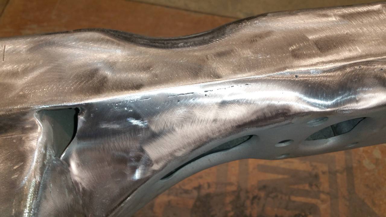

Thanks Doug...it will be sandblasted before the powdercoat by the company that does the powdercoat....the prep with the Scotchbrite pads is so I can see the lines and pinholes.
