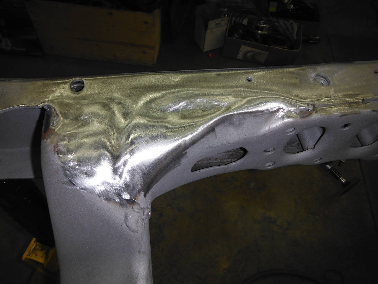

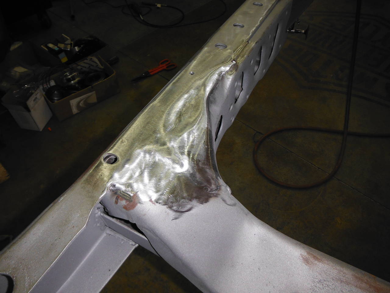

Did more grinding and filing of the frame today, nearly have it to the point of being able to be taken in for powder.
Still have to redo the factory welds and straighten the underside of the front crossmember where the steering damper mounted.

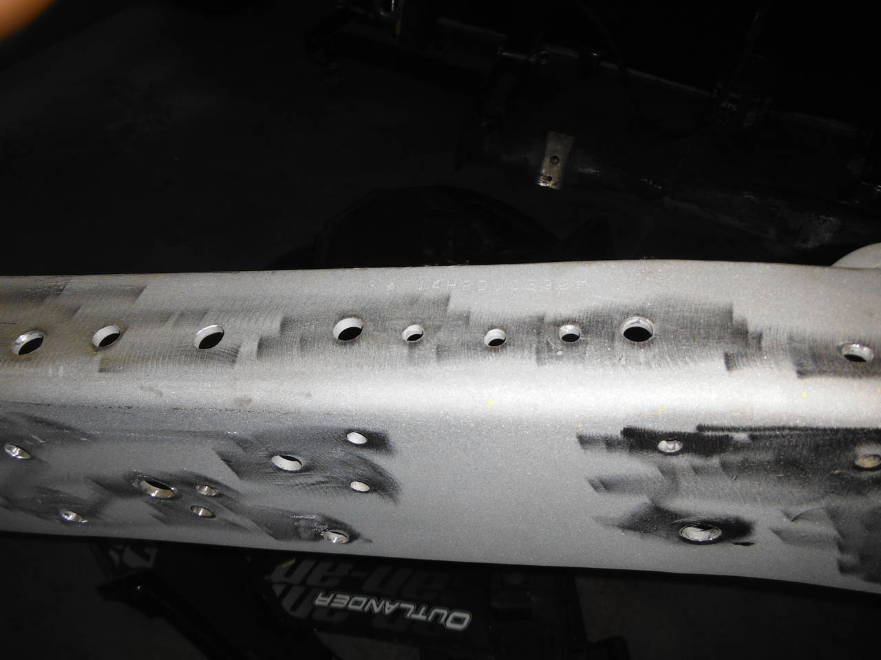

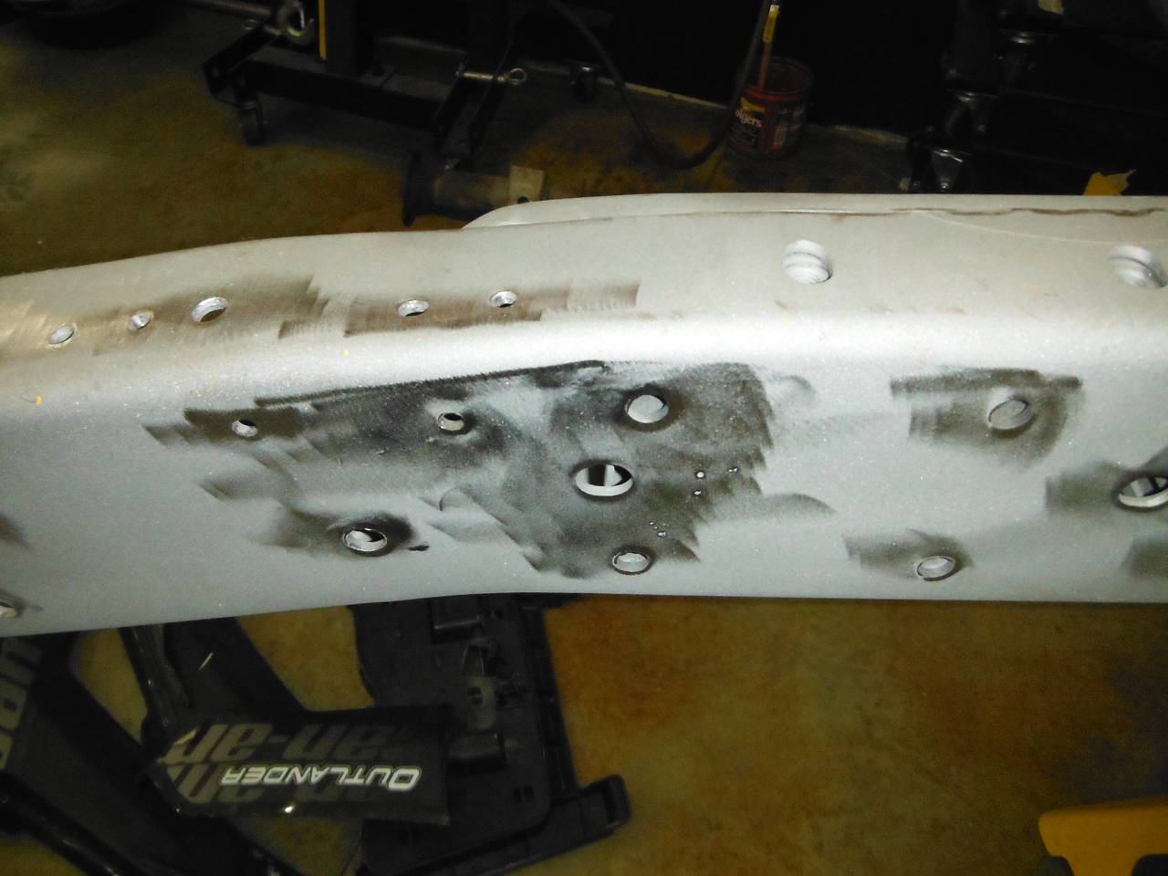

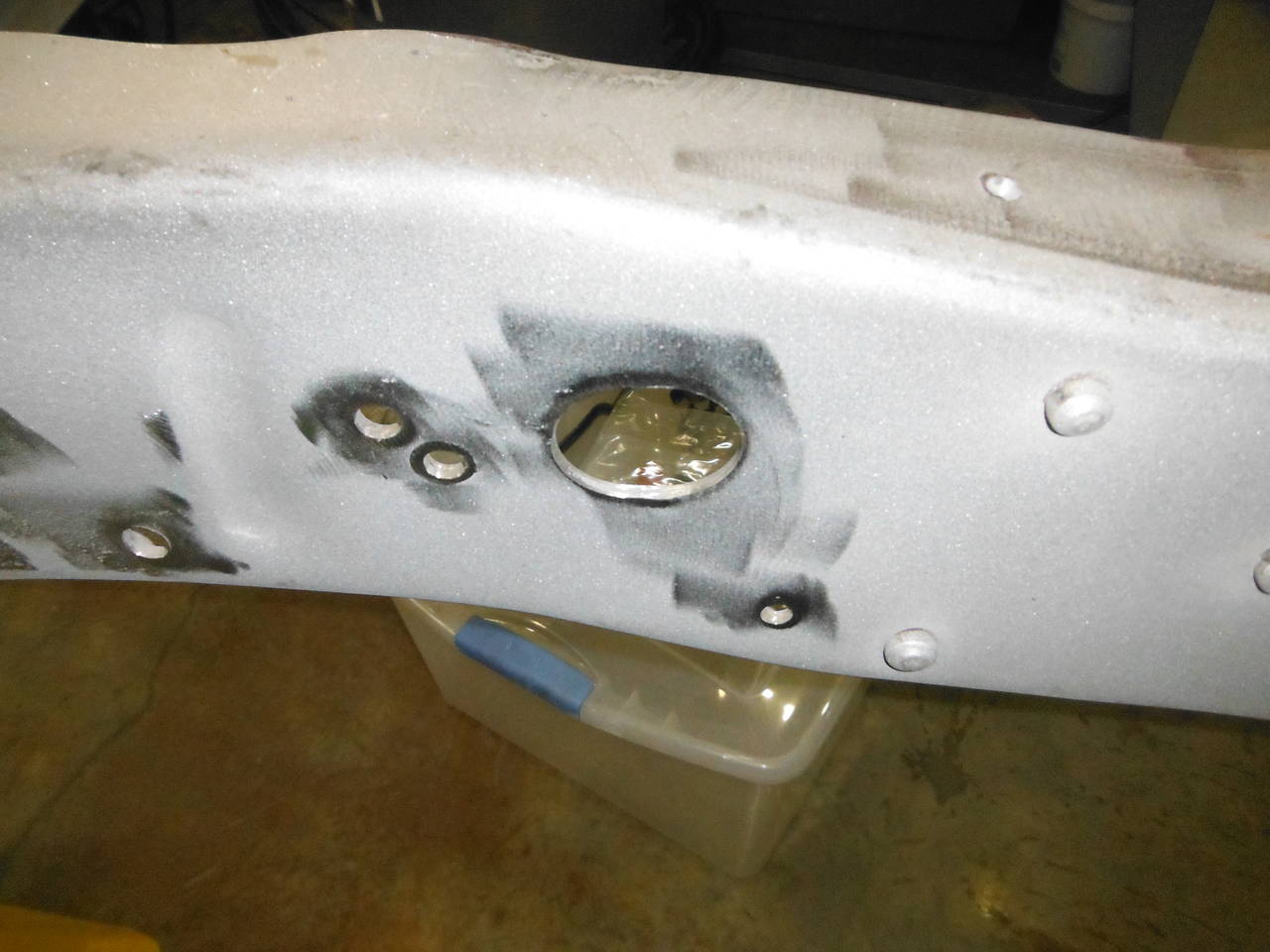

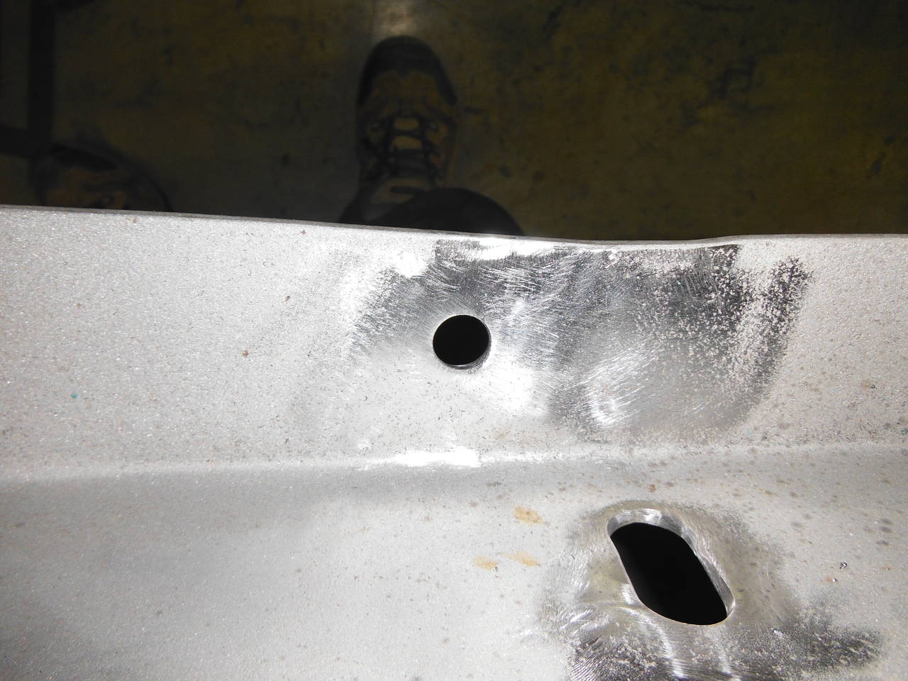

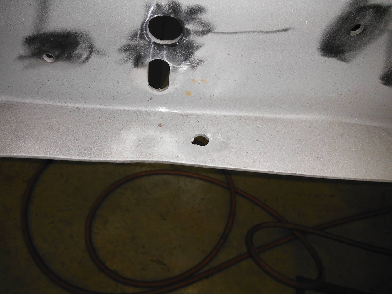

Took a break from the quad today and spent a couple of hours doing more grinding etc. Holes are time consuming, using a file on them.

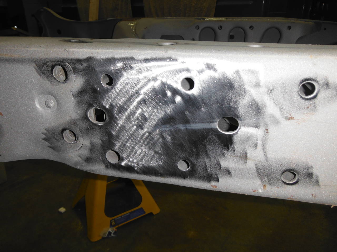

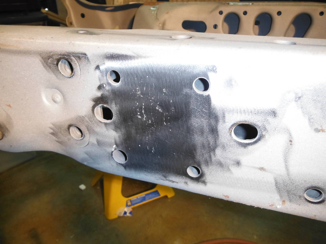

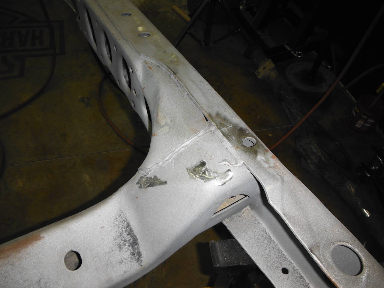

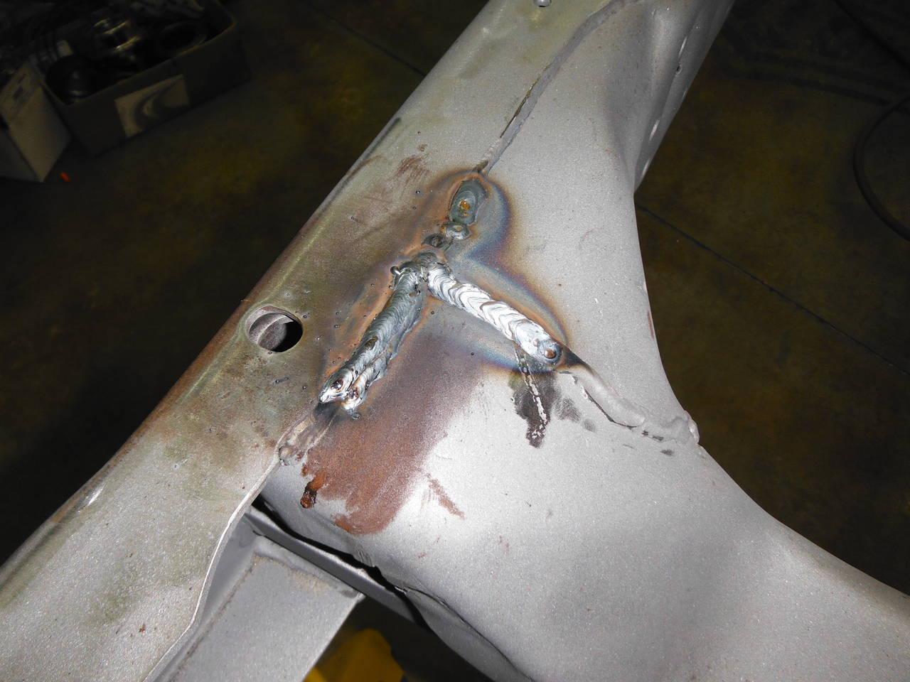

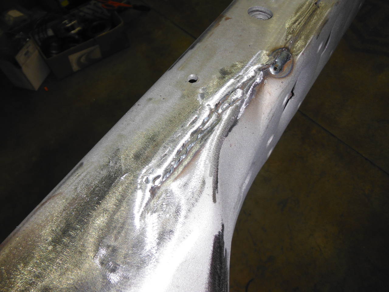

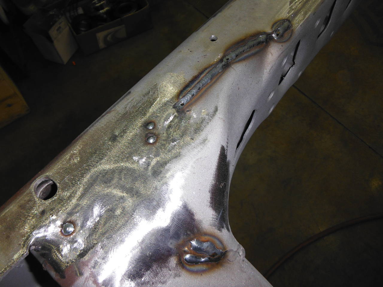

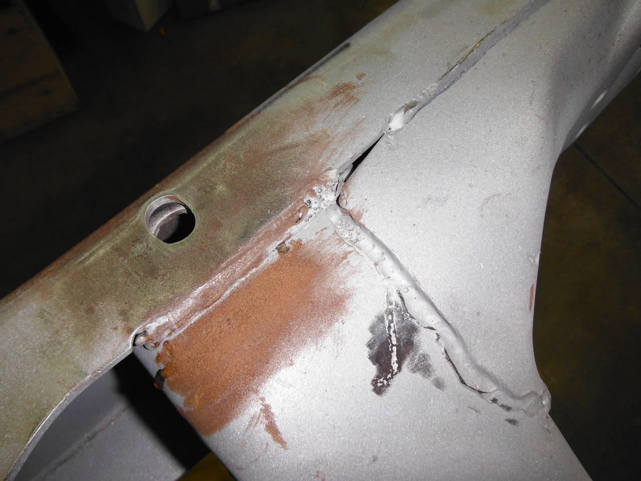

Since today's plans went in the crapper due to rain, I spent more time on the frame.
Seems there is more than I would have thought...go figure.

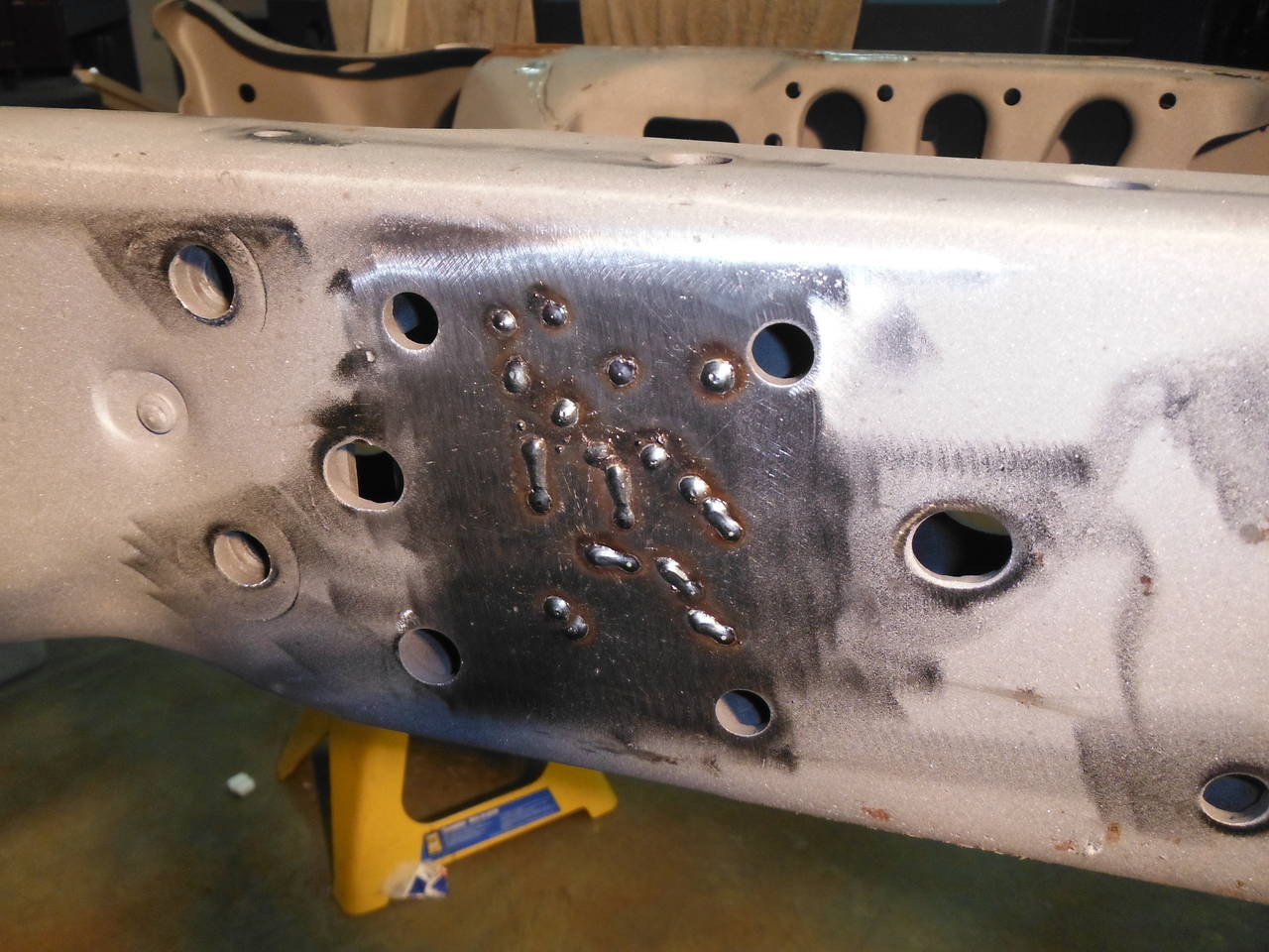

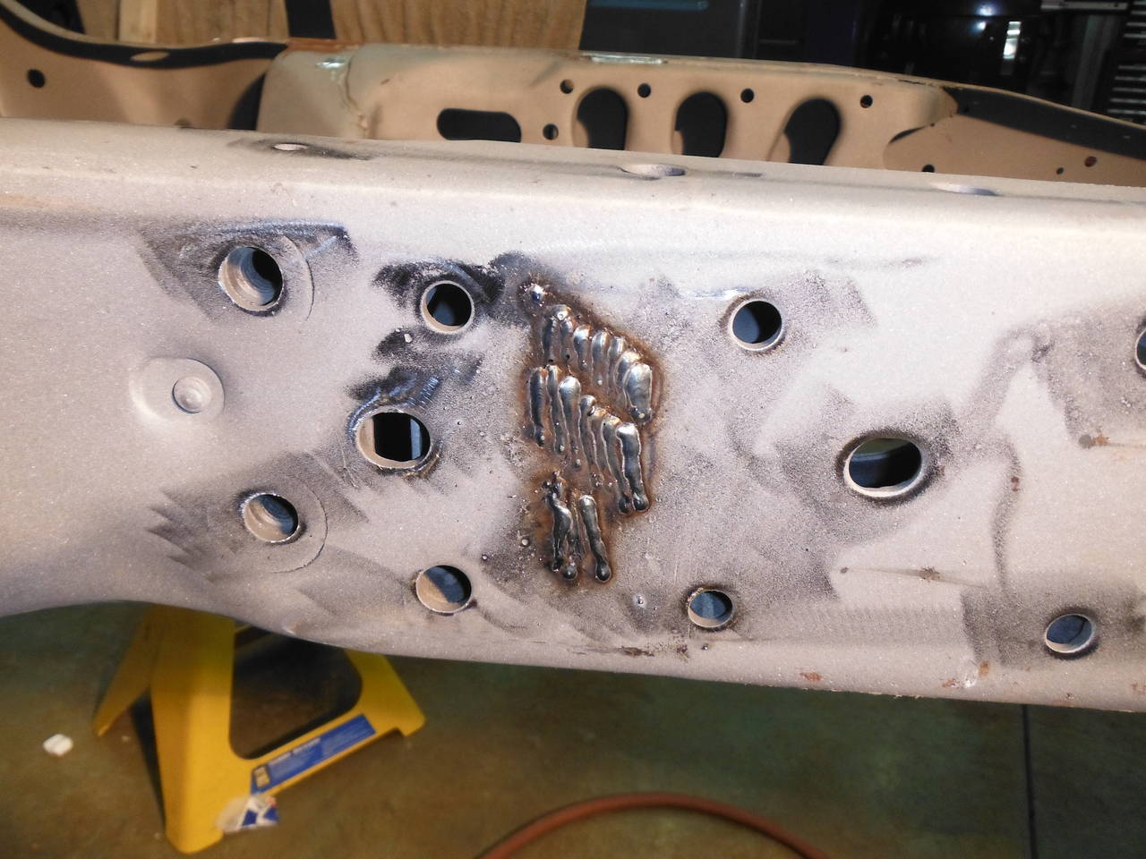

First couple of pics was where I drilled out a rivet and it wandered off center, so it had to be filled with weld.

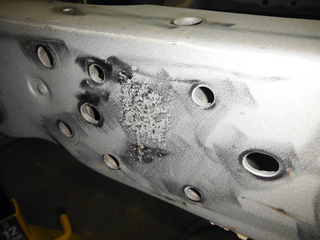

Started by filling some rough spots where mud/sand had got trapped behind the front spring mounts.
I might use urethane between the pieces when they go together to keep crap out of gap.
Started on the front crossmember welds, I was going to just leave the raw bead but then I thought that might look kinda crappy with the powdercoat...so grind and fill it was.
Could have laid thicker beads but I was being anal about trying to follow the factory contours :D
