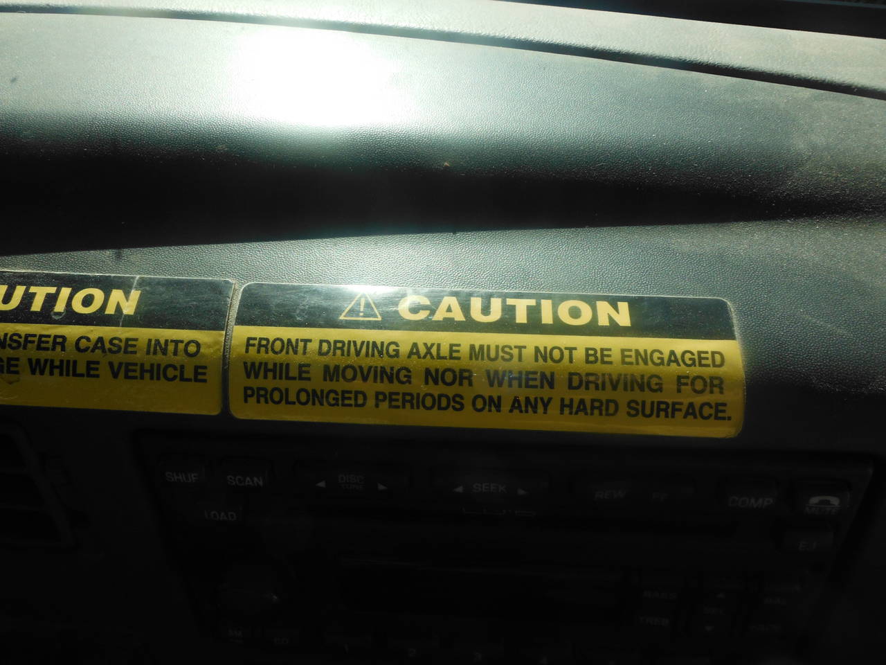

Marmon-Herrington that did my 750 conversion calls themselves awd and that would be with or without any sort of axle lockers, and it is just a full time transfer case.
In my case I have both front and rear lockers
And....just for the halibut...here are the stickers on my dash:

The only "full-time" t-case ever OEM in the Bronco was the NP203 which had an additional differential to allow for discrepancies between front and rear axle RPM's. The potential differences between front and rear axle RPM's is the critical reason for having either a t-case like the NP203 or a viscous coupler in the driveline to prevent damage to the t-case/driveline should one axle lose traction while the other has grip. This is also why it is NOT recommended to engage a "part-time" t-case on dry pavement especially in the late model Bronco's and F-series wherein the front axle ratio was 0.01 taller than the rear axle. Not a lot, but enough to stretch a drive chain if driven that way for extended periods of time.
