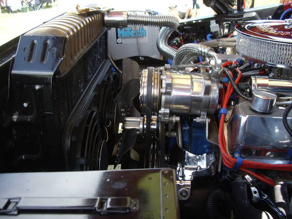

No on the thermometer. Is there a way to check the temp from top to bottom any other way? If not, I have a friend who has one I could borrow.....the only problem is it could idle and drive fine at lower speeds all day long and temp is normal.
So, just to clarify, cause I am not up to some of your guys' mechanical prowess, we are talking engine temp or water temp or both or are they the same reading or what? I have the normal gauges that are original to the truck where there is just a dial and low to high on temp readings, then I have an aftermarket gauge that is reading temps straight from the radiator. Can one of you guys set me straight on this issue? I appreciate the help. :)

Here's a picture...no shroud and the dual electric fans are pulling air into the vehicle and are wired to work regardless of whether the truck is running.
