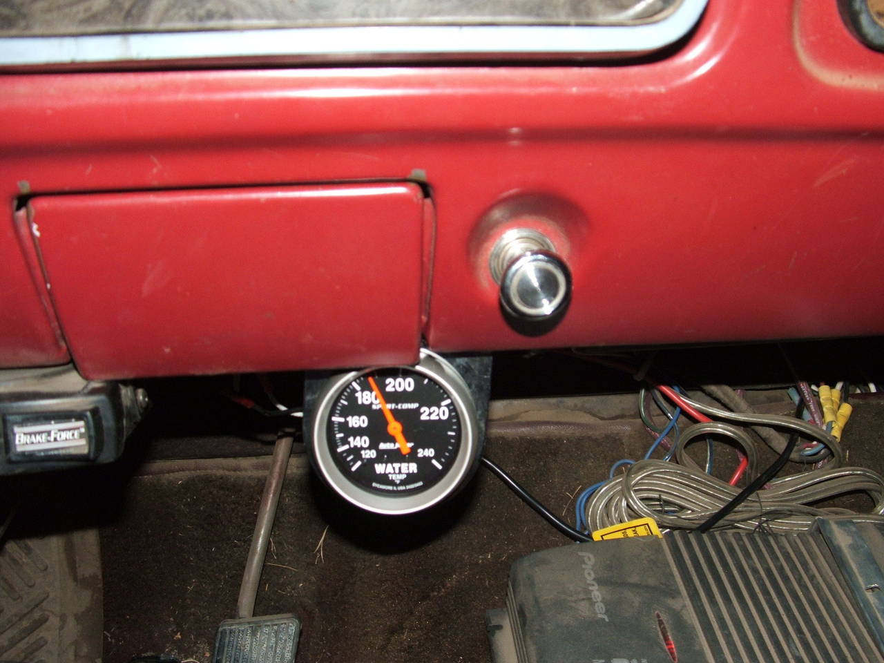

Ask, and ye shall receive. I drove the truck for about an hour tonight, with speeds up to 65 mph, and at 32 deg ambient, the temp never got above 188 deg, which means the thermostat never even opened up.
This is more in line with what I would expect to see, given the size of the radiator I have on the truck(supercooling). Can't wait to see what happens this summer. I still plan on changing the timing set this spring, for a bigger grin. :D
I changed the filter on the temp gauge light from red to green. The red light around the outside of the gauge was just too bright and distracting. The green filter gives off a nice glow, and the gauge is easier to read.
