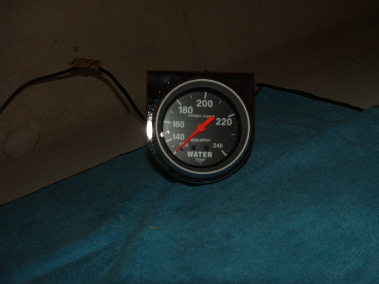

Here's what I bought. It should give me a pretty good idea of actual temp.
No problemo :D
That looks good and a nice wide scale where you need it!
Installed this guy today. Took about an hour, after I got the radiator partially drained. Looks like the temps are about 10 deg lower than the old stewart warner gauge. The UNF adapter that I ordered from Summitt did not fit into the block very well(quite loose), so I just used the old adapter.
The full sweep, narrow range(120-240 deg) is quite nice. You can actuially tell what the temp is without having to guess. We will see how things look this summer.
