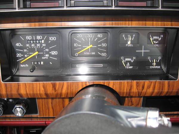

Well I found out why I had all those scratches in the lens of my dash cluster. My wife just admitted to me that she used a SOS pad to clean it with. :headbang:. Then she said you have another lens like it, I said no the other one doesn't have a button for the trip.:hammer:
Cliff, it's really easy to just drill a hole through and use a rubber cap that you use for vacuum lines for the reset button!!
I had the EXACT same issue with the donor cluster I got!!!!!!!!
See my gallery pic's, I wasn't about to spend more money and it looks great, like the feel better than the hard plastic button :) :) :)

What size drill bit did you use and how hard was it to drill through the plastic without breaking it?
I drilled the hole the diameter size of the rubber vacuum cap. I went out and bought a new sharp high speed metal drill bit with the center point end. DeWalt has these type of drill bits. I first drilled a small 1/8" starter hole so I knew that the actual size drill bit would not wander and ruin the cover, this is very important Cliff to do. I used my cordless drill, I just find there's more control than an electric, and after drilling the first hole, made sure the drill was at full speed, and drilled the proper size hole. It did not damage the plastic what so ever, as you can see in the picture. Do not try to drill the larger hole slow as this WILL cause the plastic to damage around the edges, or worse, crack the plastic. Trust me on this, I've been in the construction trade for over 24 years. It is really easy, use your damaged lens as a practice.

should have no problem drilling Cliff, but the scratches from the SOS pad should buff out, unless your wife did the He-Man to it...

So far I have the lens looking better with 800,1500,2000 grit paper. Tomorrow I will have to get 3000 grit for the last bit of sanding. And I have Meguiars headlight cleaner.
