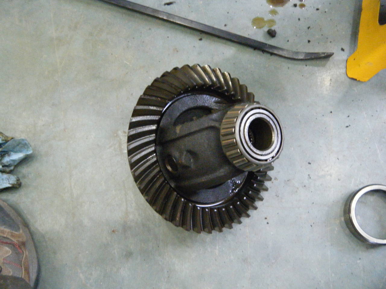

Started to take apart the diff's yesterday:

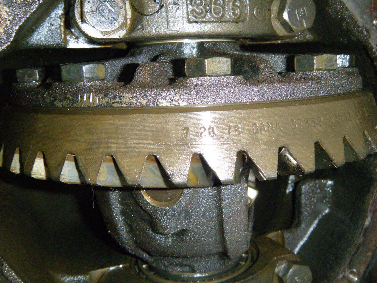

Gears dated 1978:

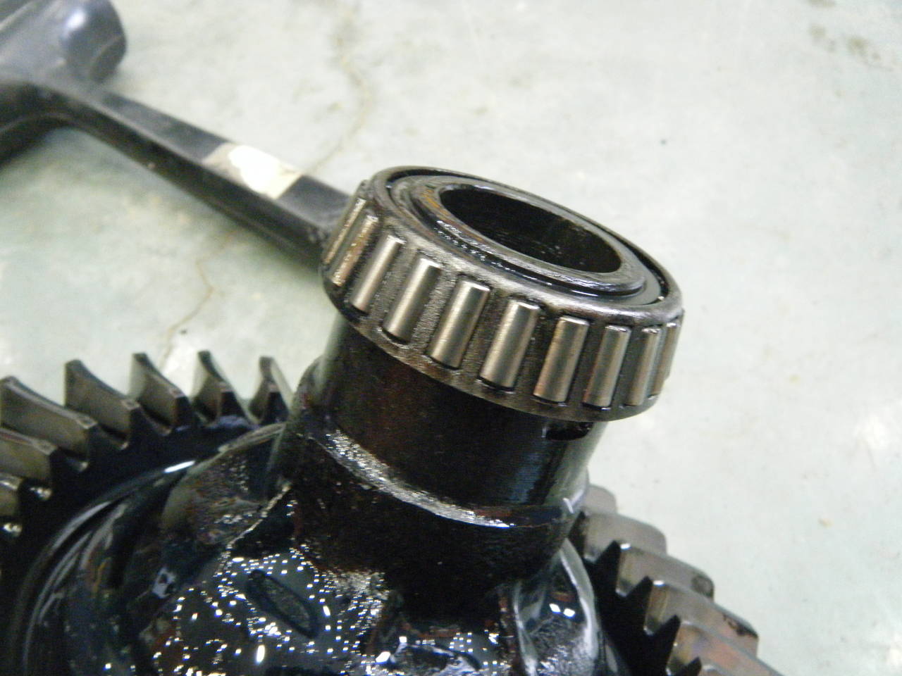

Took a bit pf prying, but the carrier popped right out:
That blob of fresh grease was on the backside of the race...I'm amazed at the condition of everything:

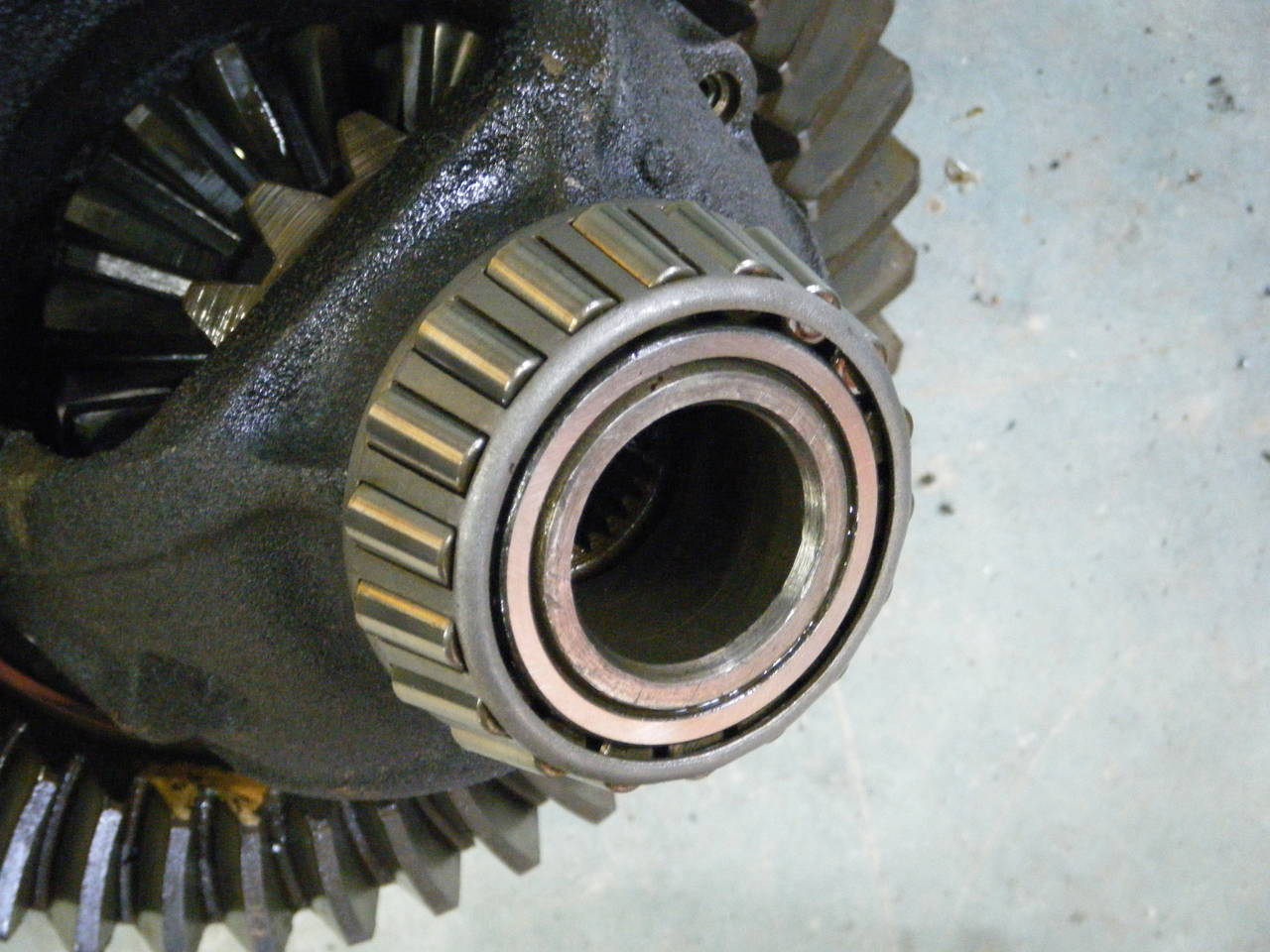

Bearings had practically zero wear, all Timken units and will be replaced by same:

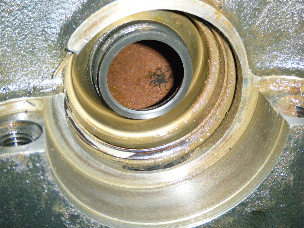

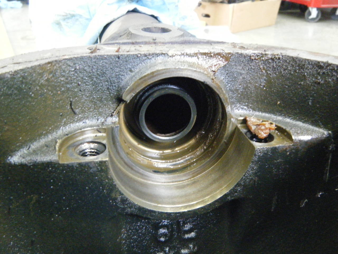

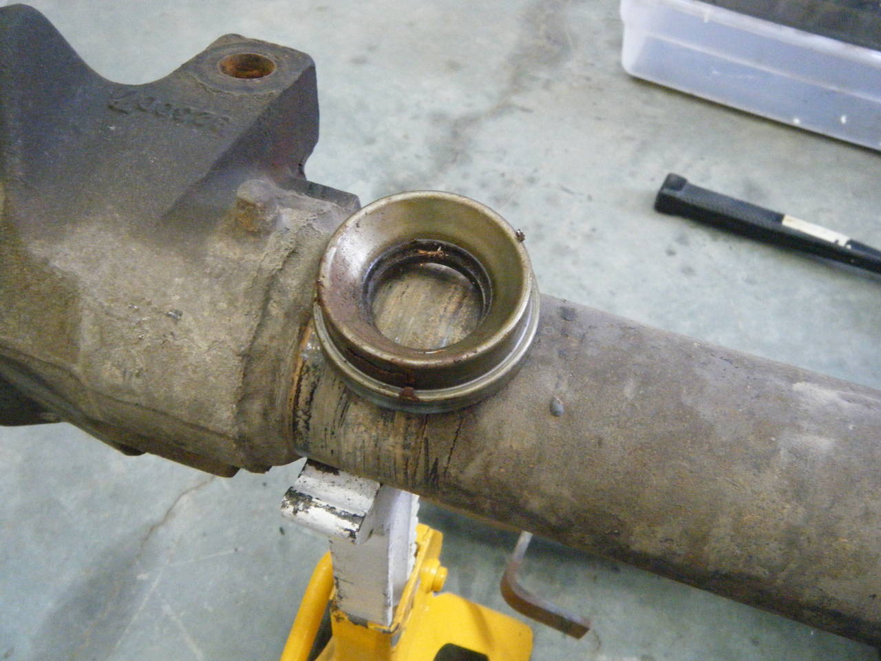

Seals didn't have any signs of leakage...no oil in axle tubes:
Popped the seals out with a piece of dowel, took a good couple of hits with a deadblow:

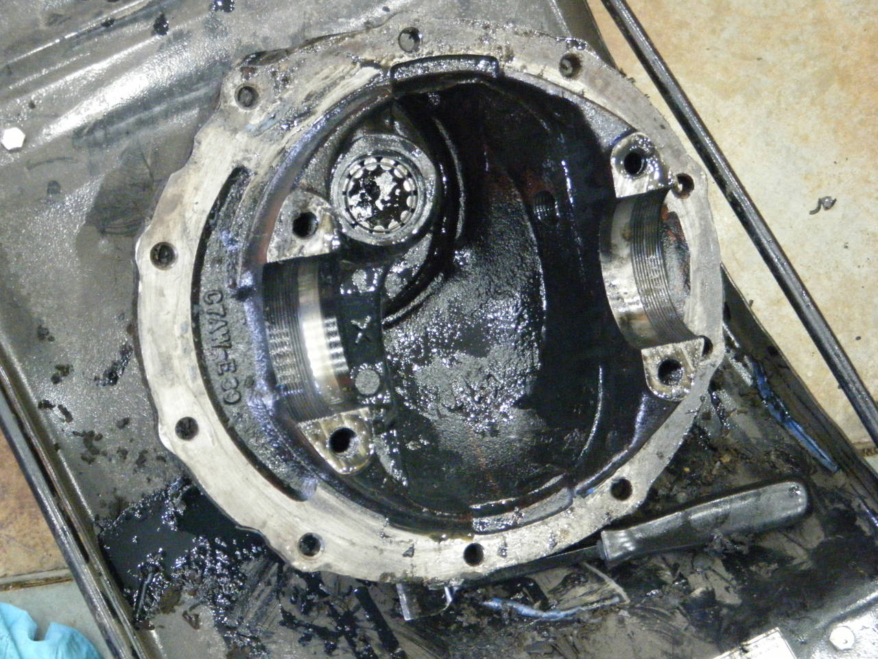

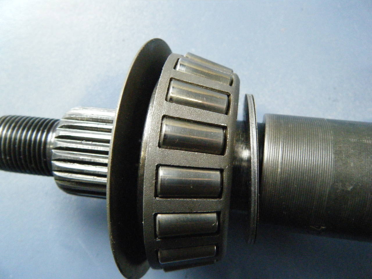

Pinion bearing had very little wear:

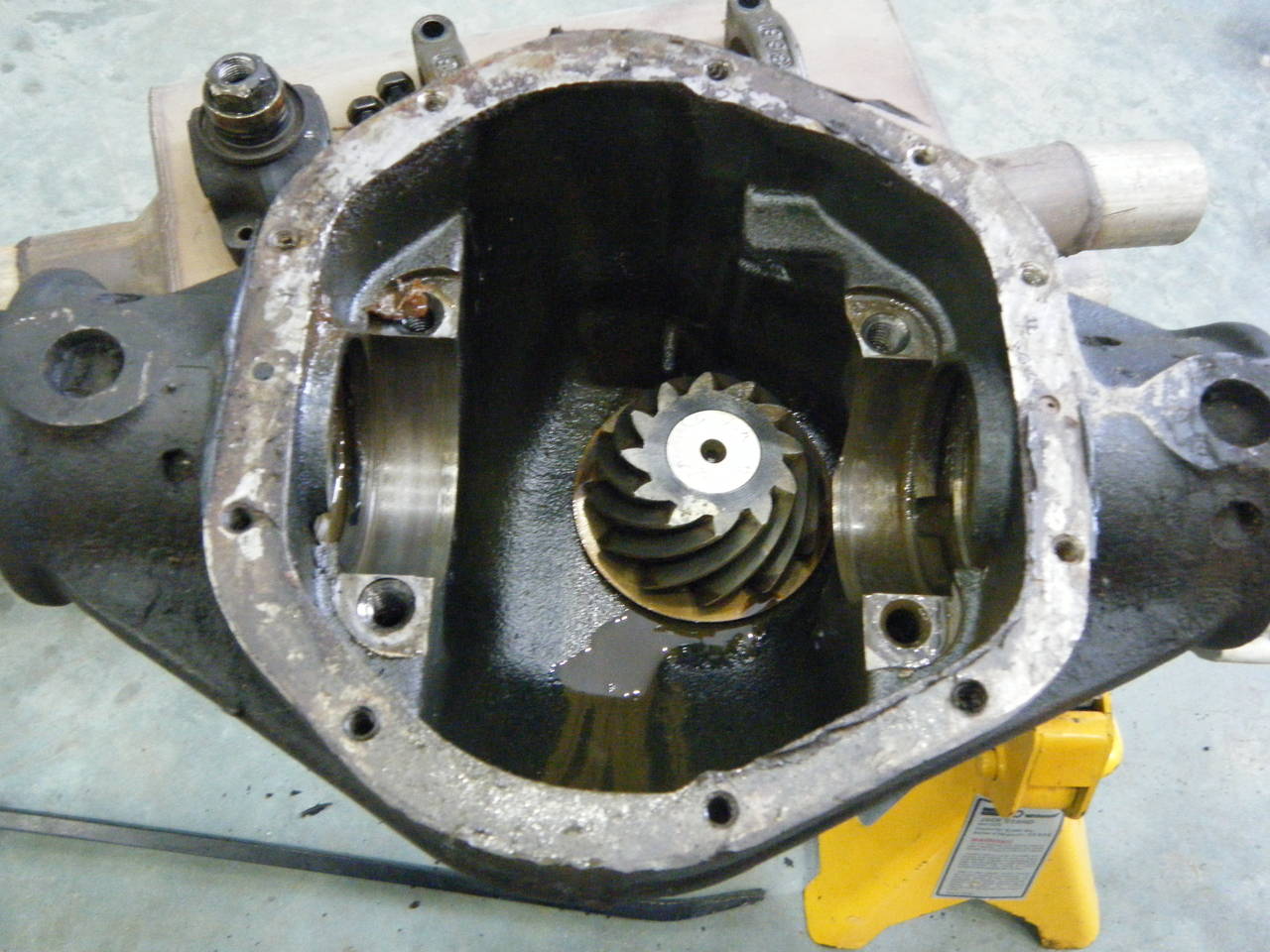

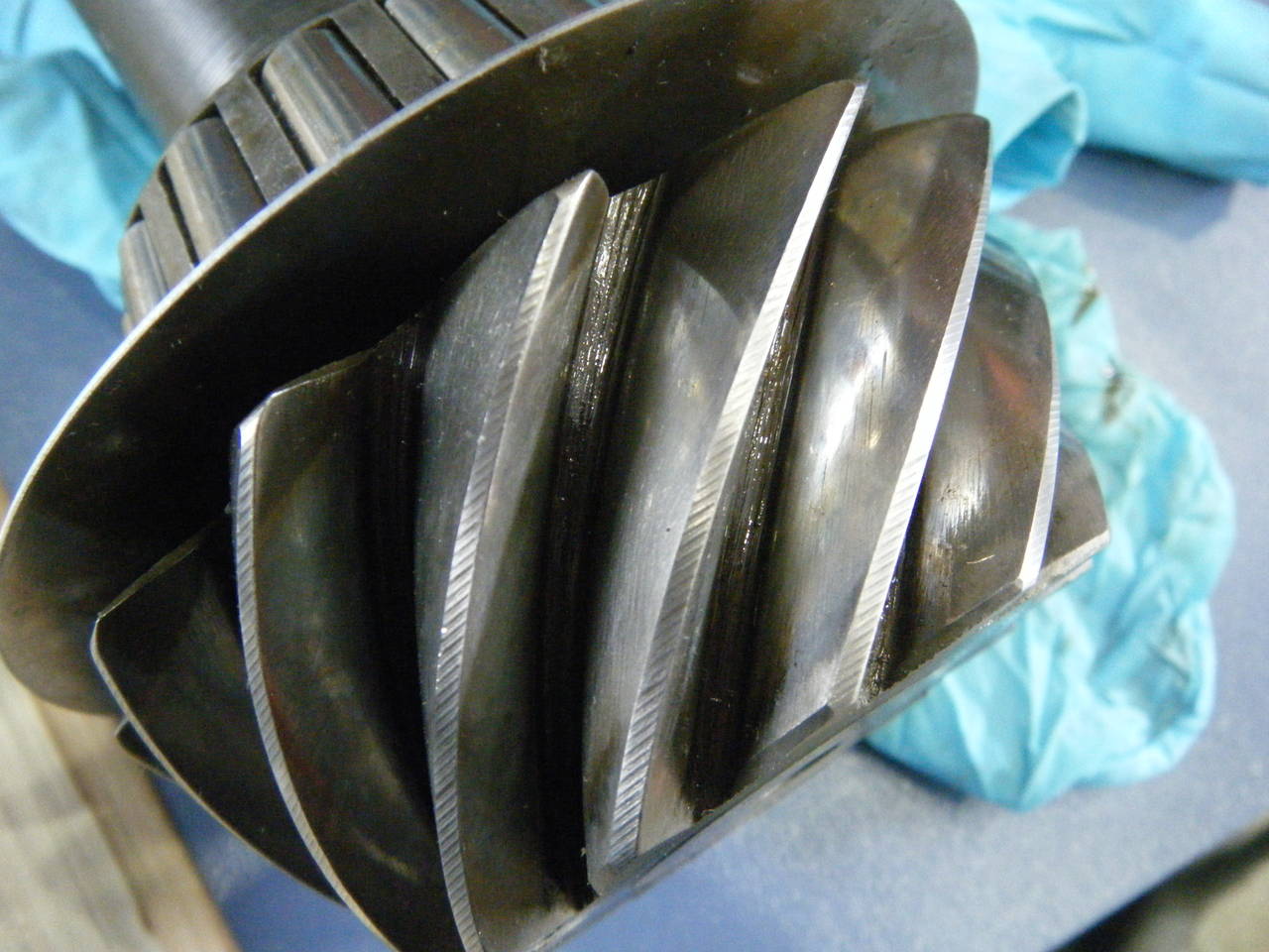

No wear on pinion gear:

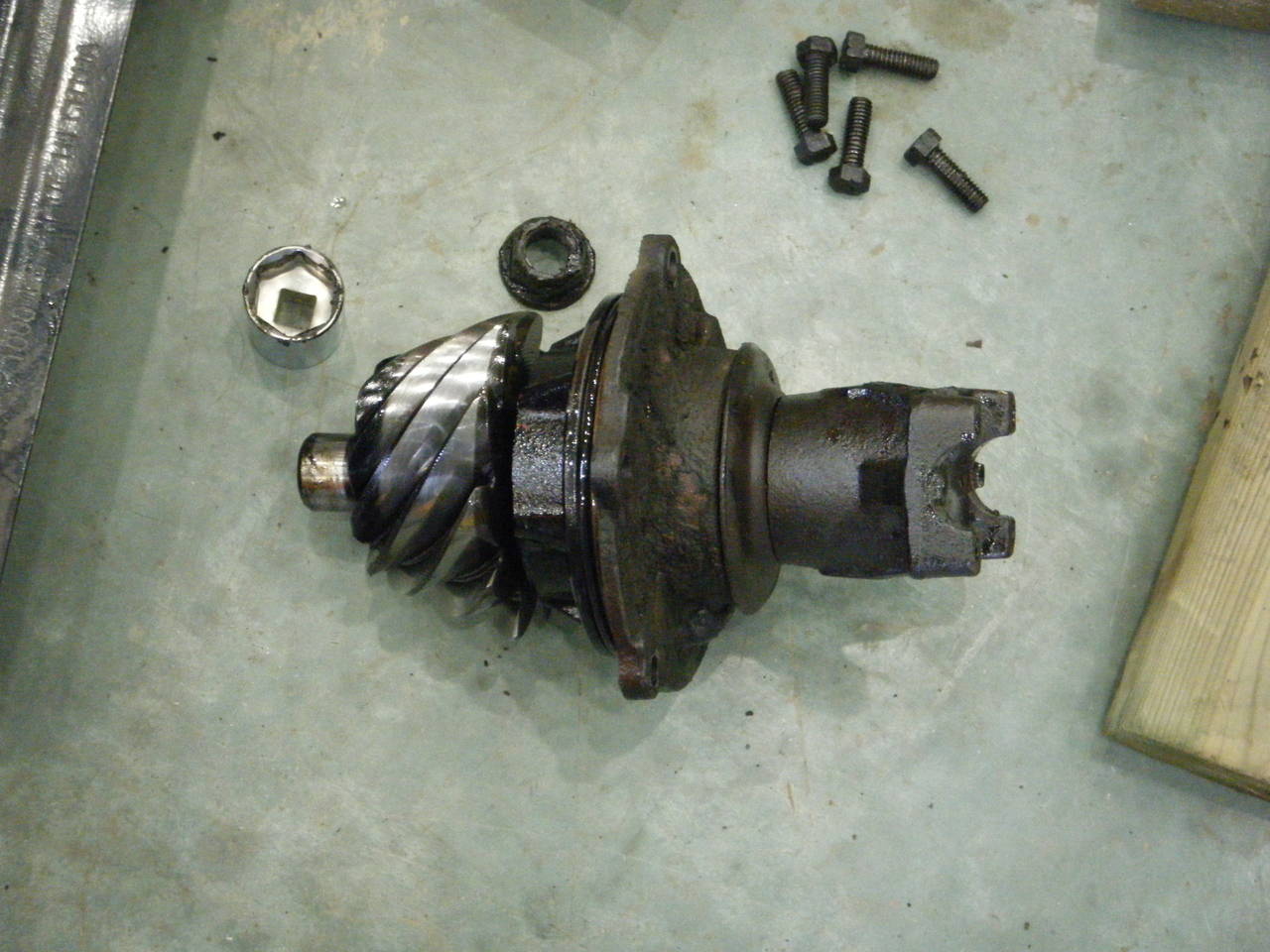

Started on the rear end:
:rofl: :rofl: It is Chris...I should have just regasketed a few things and driven it......:headbang:
