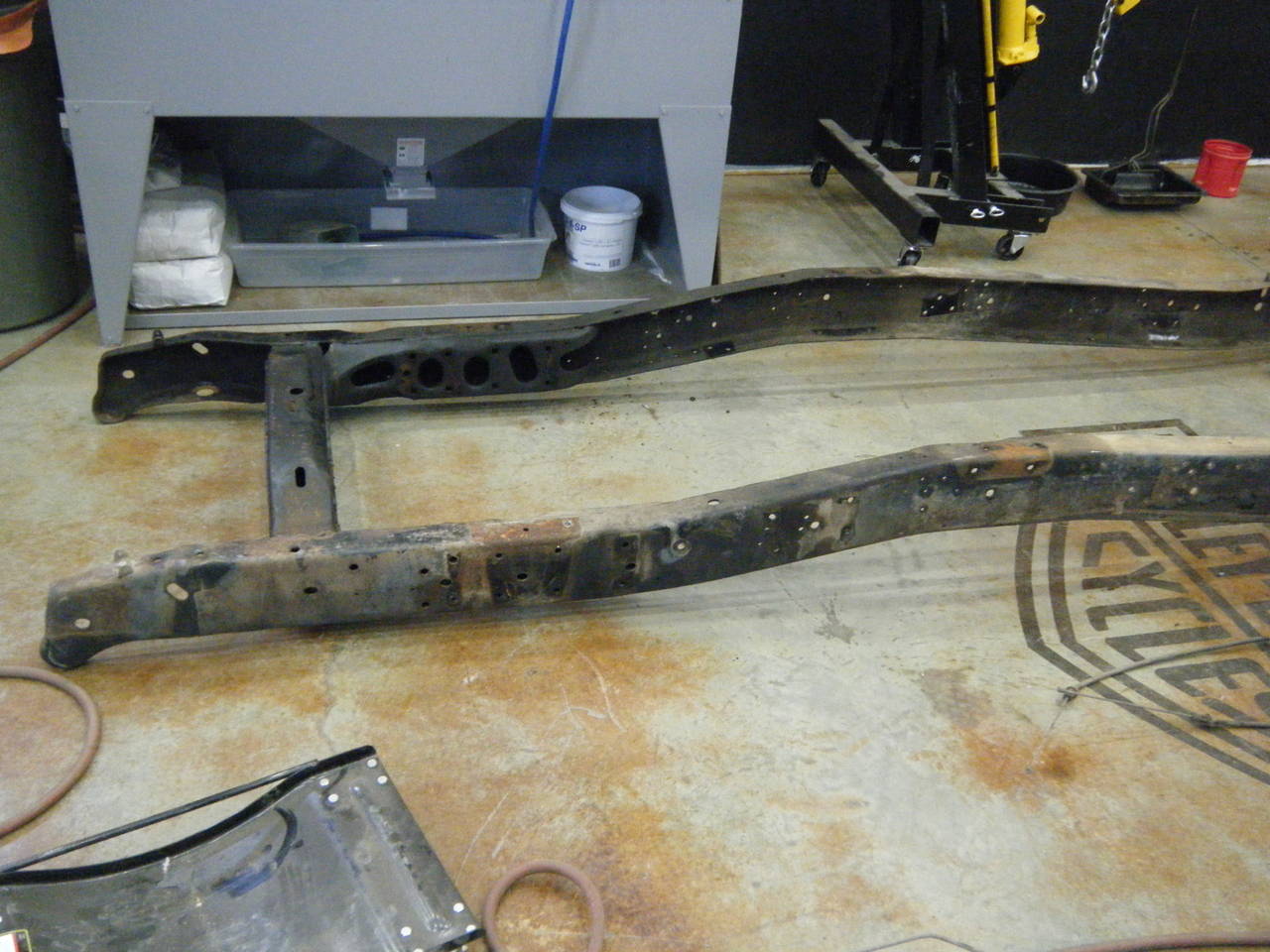

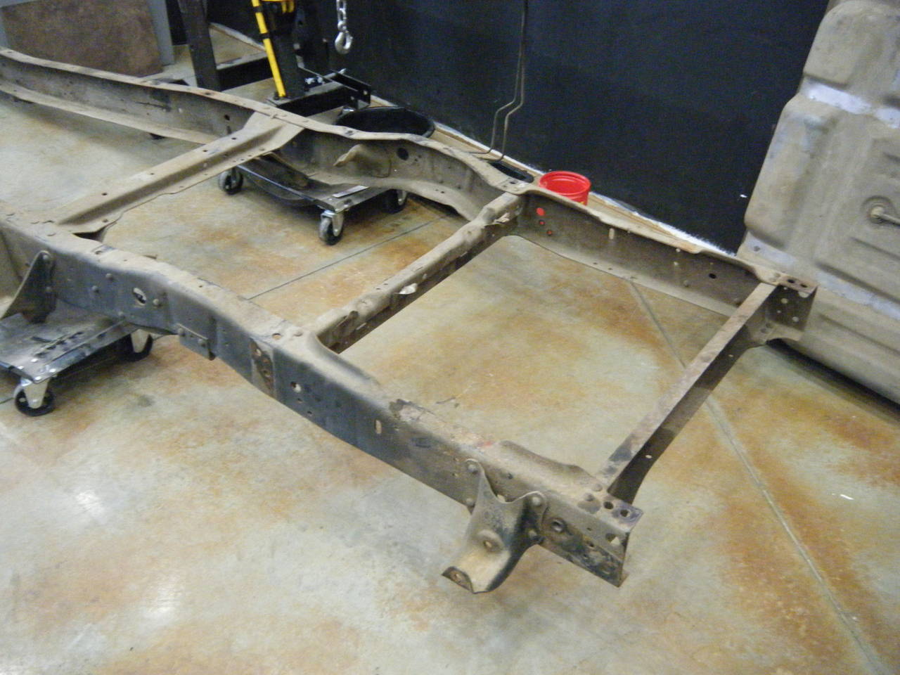

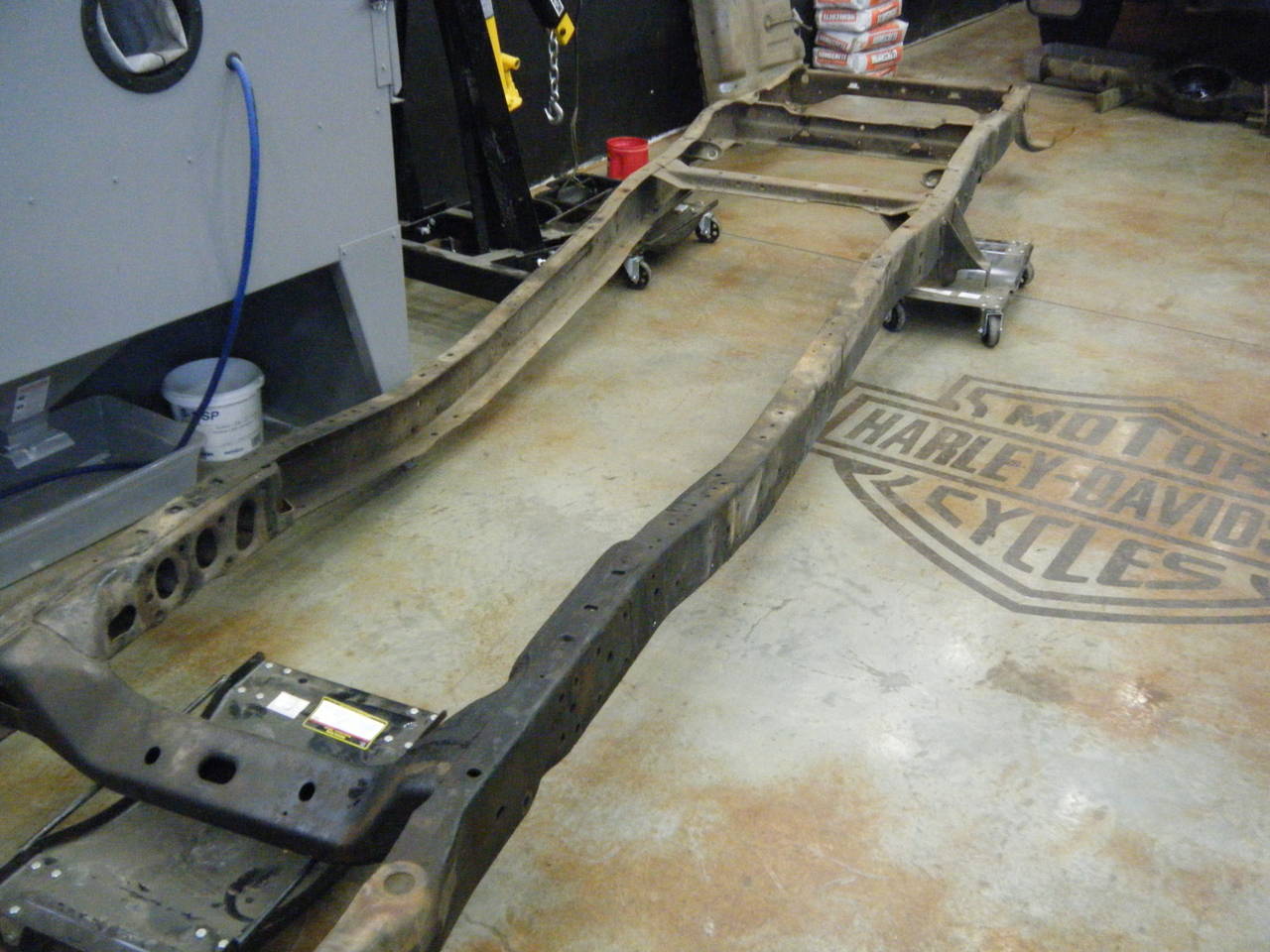

Spent yesterday looking after some details, frame is now 100% stripped (as far as it is going), front fender trim off, rear bumper disassembled , same as the rad support.

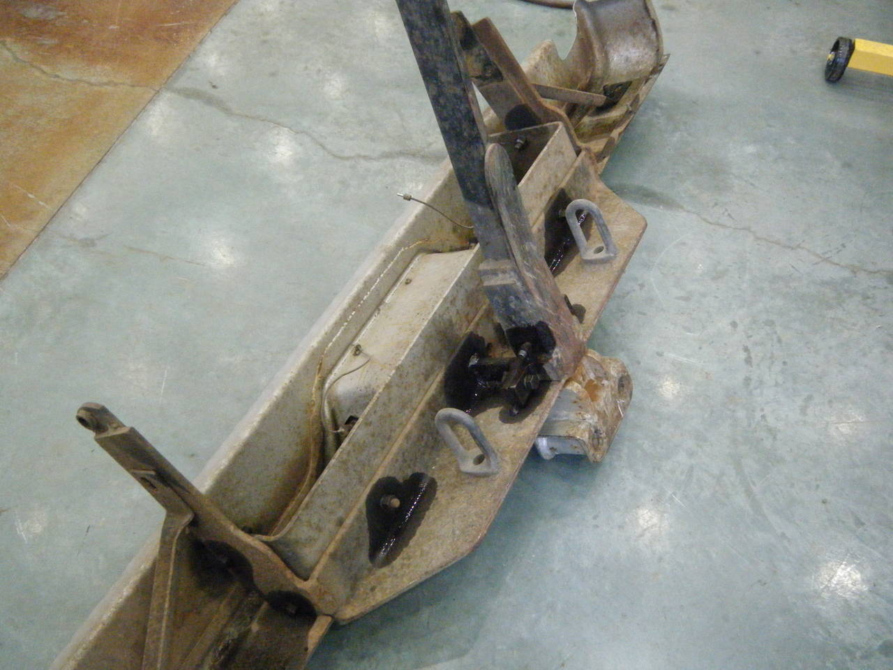

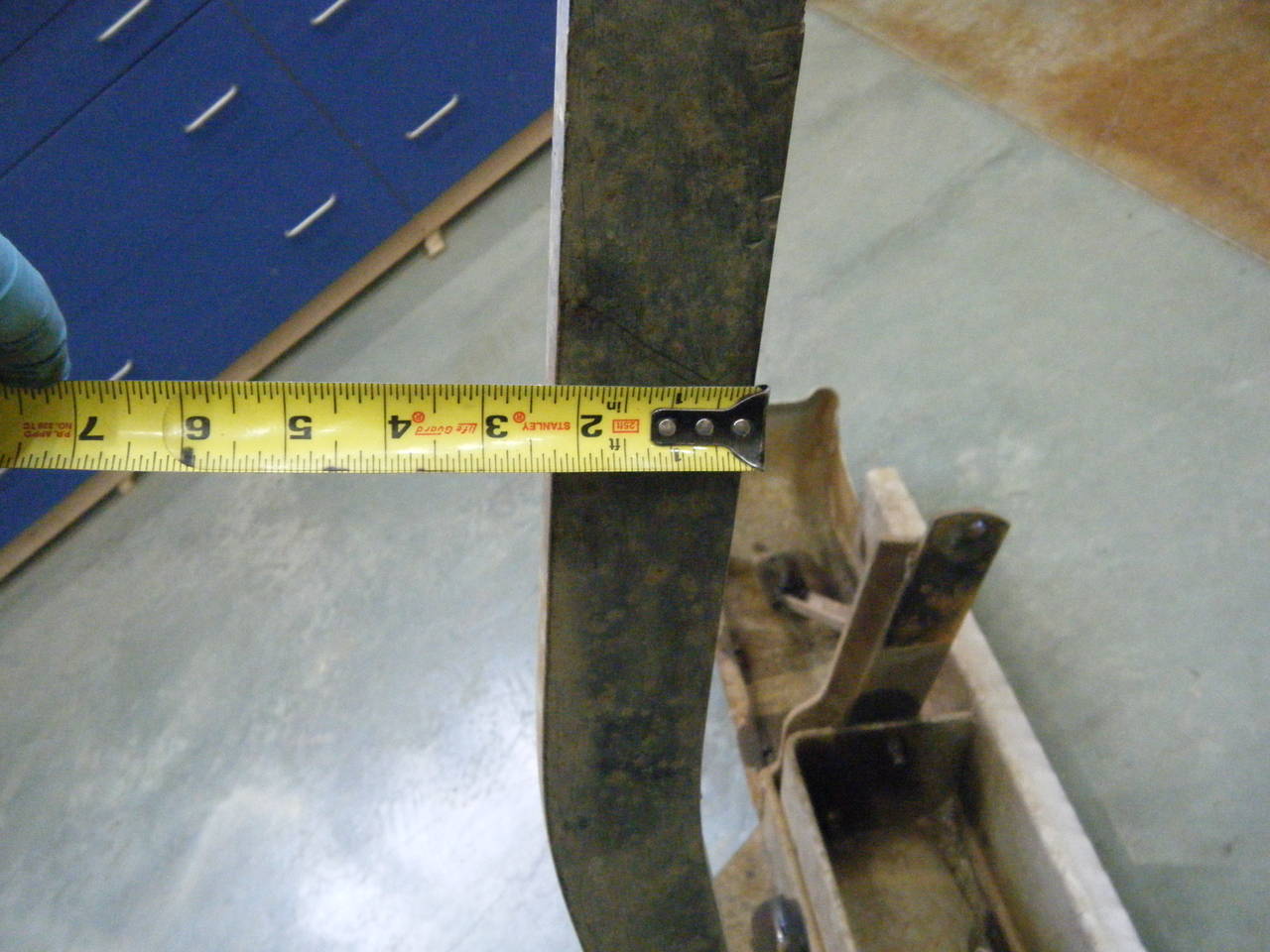

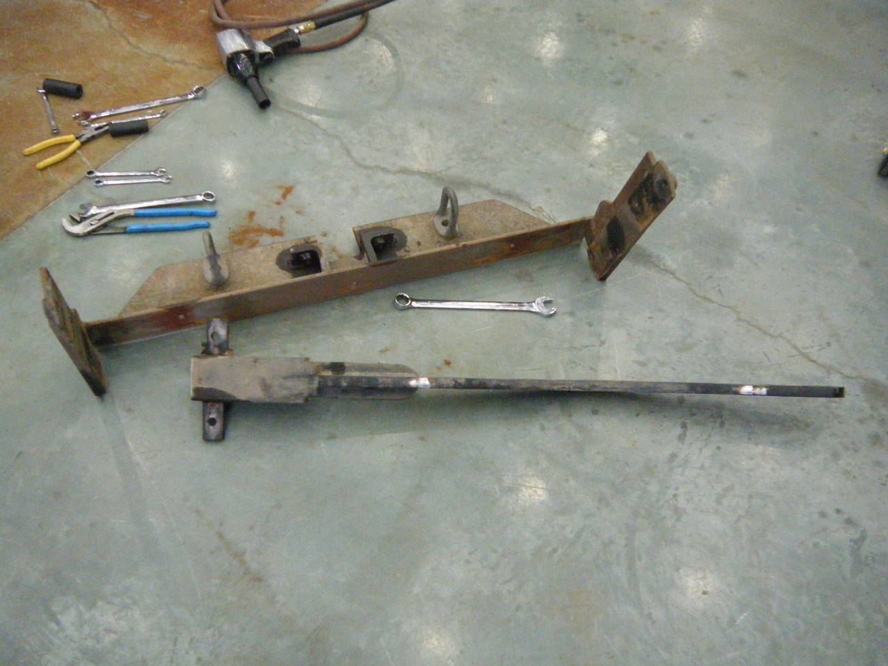

The insane duty hitch that I'm pretty sure the truck would twist in half before it did. The guy welded to the original bumper brackets, so I might have to locate some.

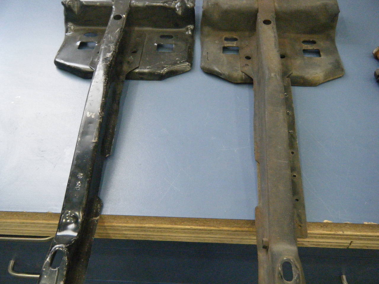

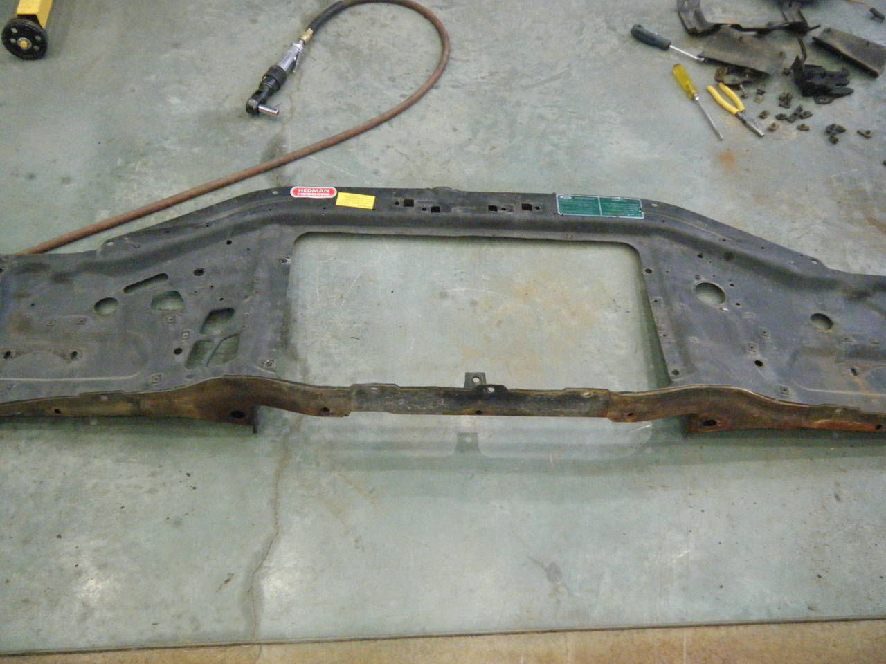

Rad support stripped:
Some prior owner added an transmission cooler and welded a piece of metal to the center support..I figured a new one would be much easier than farting around trying to grind the old one off:

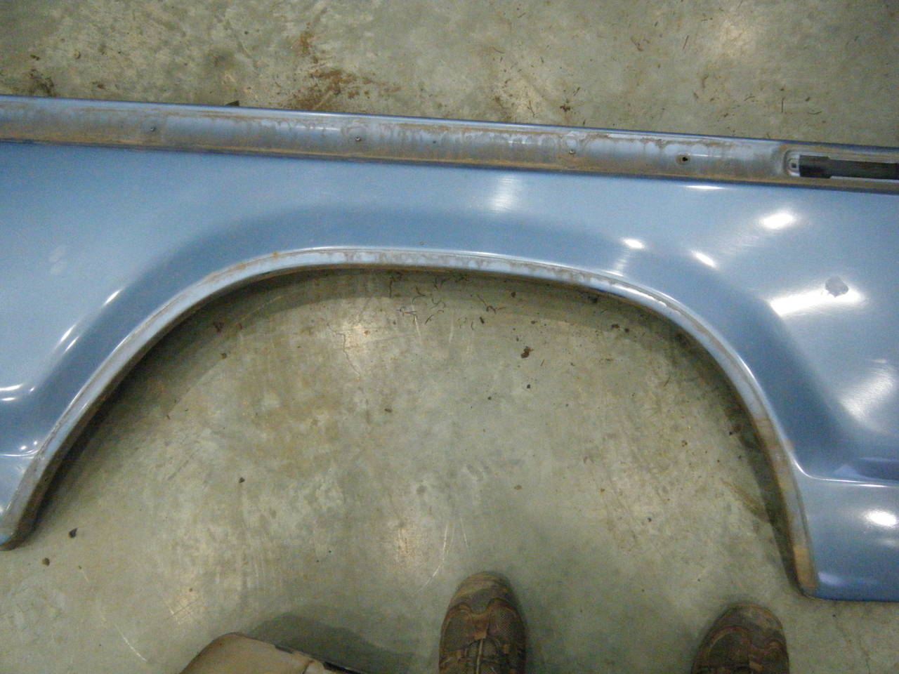

Fender trim stripped, I was surprised how much dirt and pine needles were trapped under the trim:

My frame dosn't have the boxed in area with the 3 large holes behind the front cross member.
edit: after looking at your frame more, it might be boxed to support where the coil spring would twist the frame.

Thanks Mark, the frame is like that on both sides..I'm guessing it is for the shock/coil spring mounts for reinforcement. Now I gotta figure out the logistics of getting the rest of the stuff done...axles to be stripped, then taken to powdercoat place to get the oil/grease burnt off..then rear axle down to place to get checked...then back to the powdercoat place...then both to the axle place for assembly. Engine to machine shop...then to powdercoat place, then back to machine shop...there is going to be some driving!

Maybe you should keep that hitch in case you want to move your house or something.
I can look for some bumper brackets next month for you if you want. Are they pretty much all the same?
Bwahaha...but zero towing with this truck, we decided to keep the 350 for that.
Thanks for the offer..I will let you know!, and I'm pretty sure they are the same although maybe the hiboy ones are different :confused: I'm going to investigate how much of a PITA it will be to gring off the existing welds as well.
Absolutely not!
1979 F150 Styleside pickup w/factory installed step bumper:
1) D3TZ-17787-B .. Right Inner Bracket
1) D3TZ-17788-B .. Left Inner Bracket
Both fit Stylesides: 1978/79 F100/350 with a step bumper except with step bumpers used on 1978/79 F350's on the 140" wheelbase.
1973/79 F350 140" wheelbase with a contoured rear bumper.
1) D3TZ-17795-A .. Right Outer Bracket.
1) D3TZ-17796-A .. Left Outer Bracket
Both fit Stylesides: 1973/77 F250/350 on the 139" & 155" wheelbases-Use with step bumper.
Confusing, ain't it? Lookin' this jazz up in the parts catalog, then finding the correct applications for the brackets...is a confusing PITA. I kid you not!
Besides these correct brackets, there are FOUR other right/left inner brackets and TWO other right/left outer brackets that are not the same.
