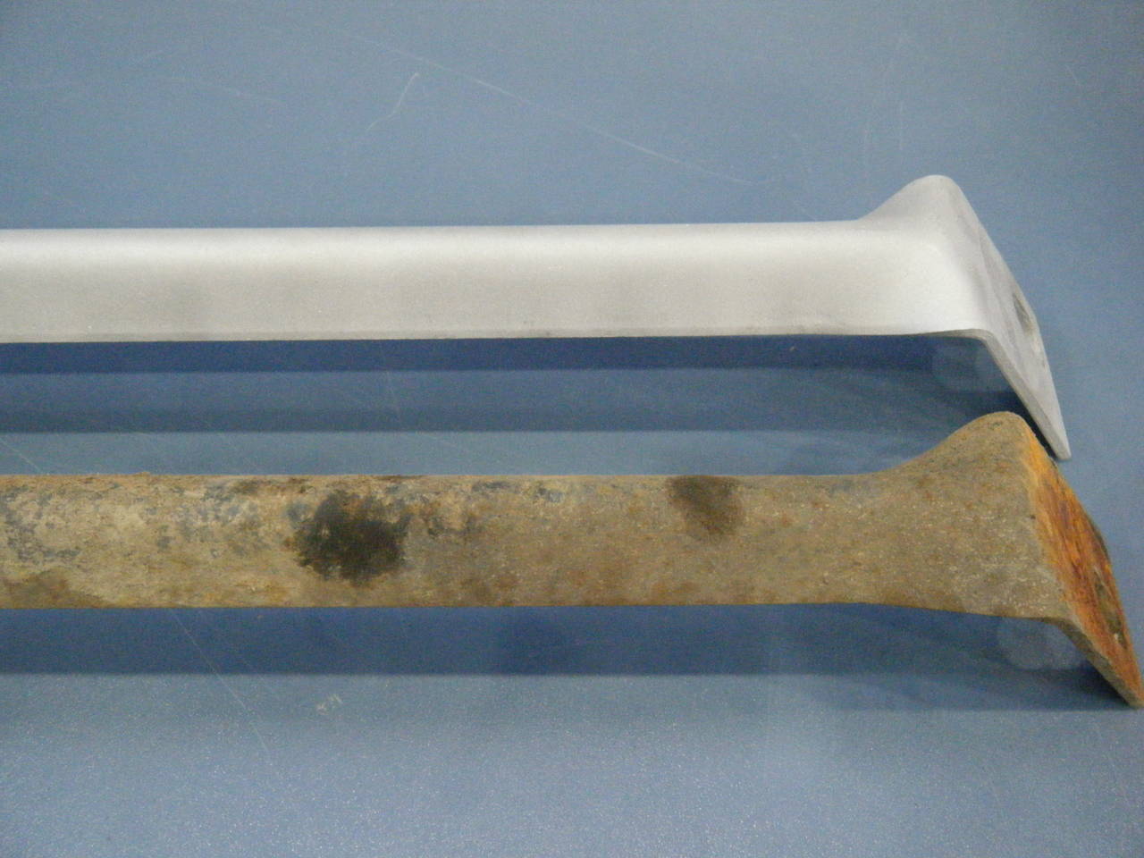

Did a quick blast on the rear bumper brace/support, going to go have to pick up some files as I want to chamfer/radius corners where I can...nice and therapeutic :D

It is..and I'm using glass actually...nice satin finish. Some parts are going to have to be done at the powdercoat place as they need to bake off the oil first.

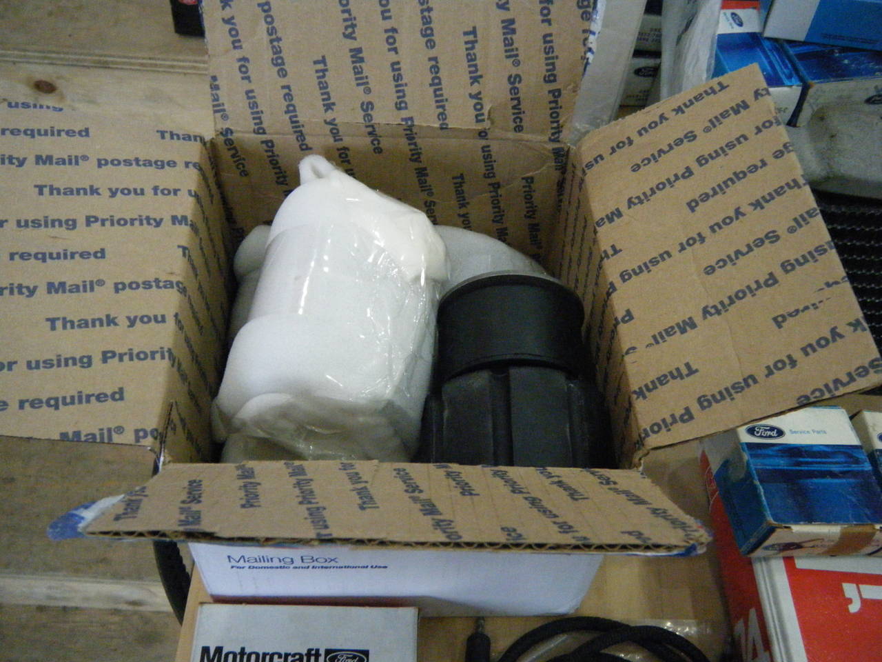

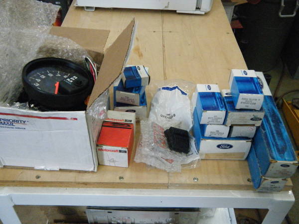

Picked up a bunch more NOS stuff and have more on the way:

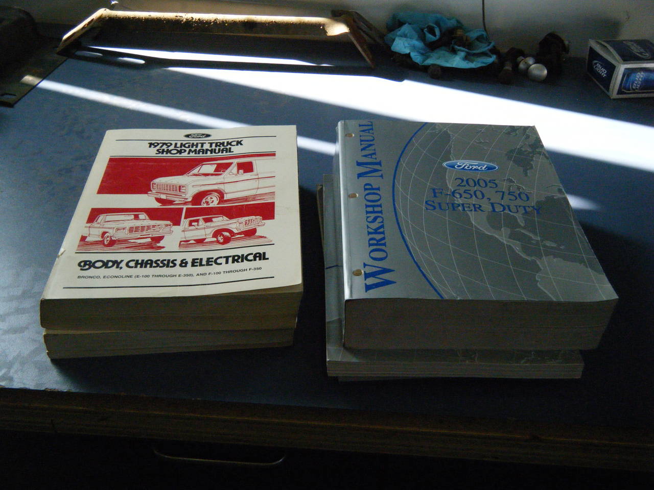

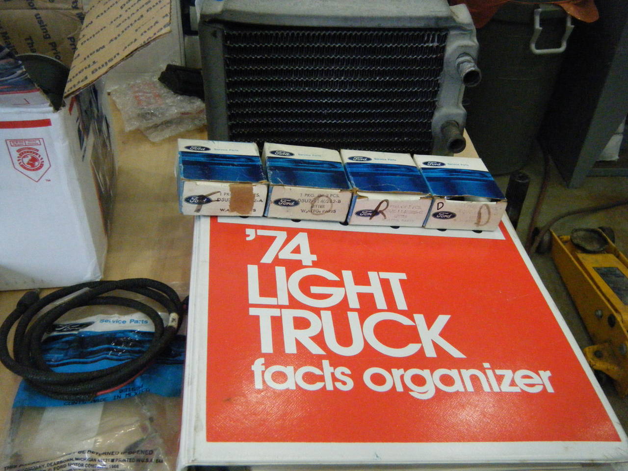

2nd set of shop manuals for throne reading :D
Motorsport tach, hoodsprings, hood letters, int wiper switch, e-brake pad, turn indicator arm, bezel/marker for transmission:
Complete set of body/rad support bushings:
Another set of FORD letters (don't ask), heater core, data book, ignition resisitor cable, body ground strap:

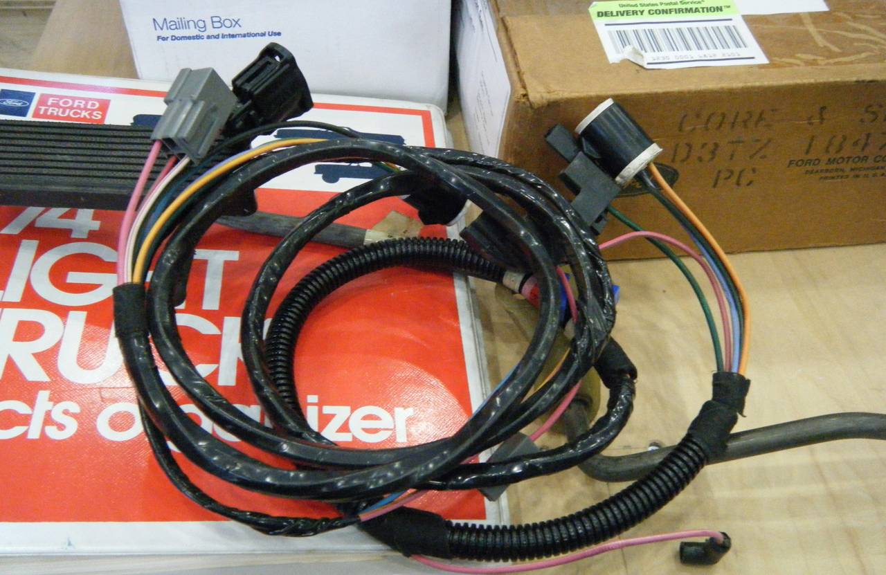

Misc. servos and mounting brackets...bought them for the brackets only...if one or more work, great..if not, no biggie:
Coil wiring harness and gas pedal:

Another set of FORD letters (don't ask).
Did'ja know the following inre to these D5UZ letters?
D9TZ-16606-A (replaced D5UZ-1142528-A / D8TZ-16606-A / EOTZ-16606-A) .. Letter F.
D9TZ-16606-B (replaced D5UZ-11425258-B / D8TZ-16606-B / EOTZ-16606-B) .. Letter O.
D9TZ-16606-C (replaced D5UZ-1142528-C / D8TZ-16606-C / EOTZ-16606-C) .. Letter R.
D9TZ-16606-D (replaced: D5UZ-1142528-D / D8TZ-16606-D / EOTZ-16606-D) .. Letter D.
Fits: 1978/90 F100/350 hood / 1975/90 Econoline hood / 1978/90 Bronco hood // 1975/90 Econoline right (passenger) side back door // 1978/90 Bronco tailgate.

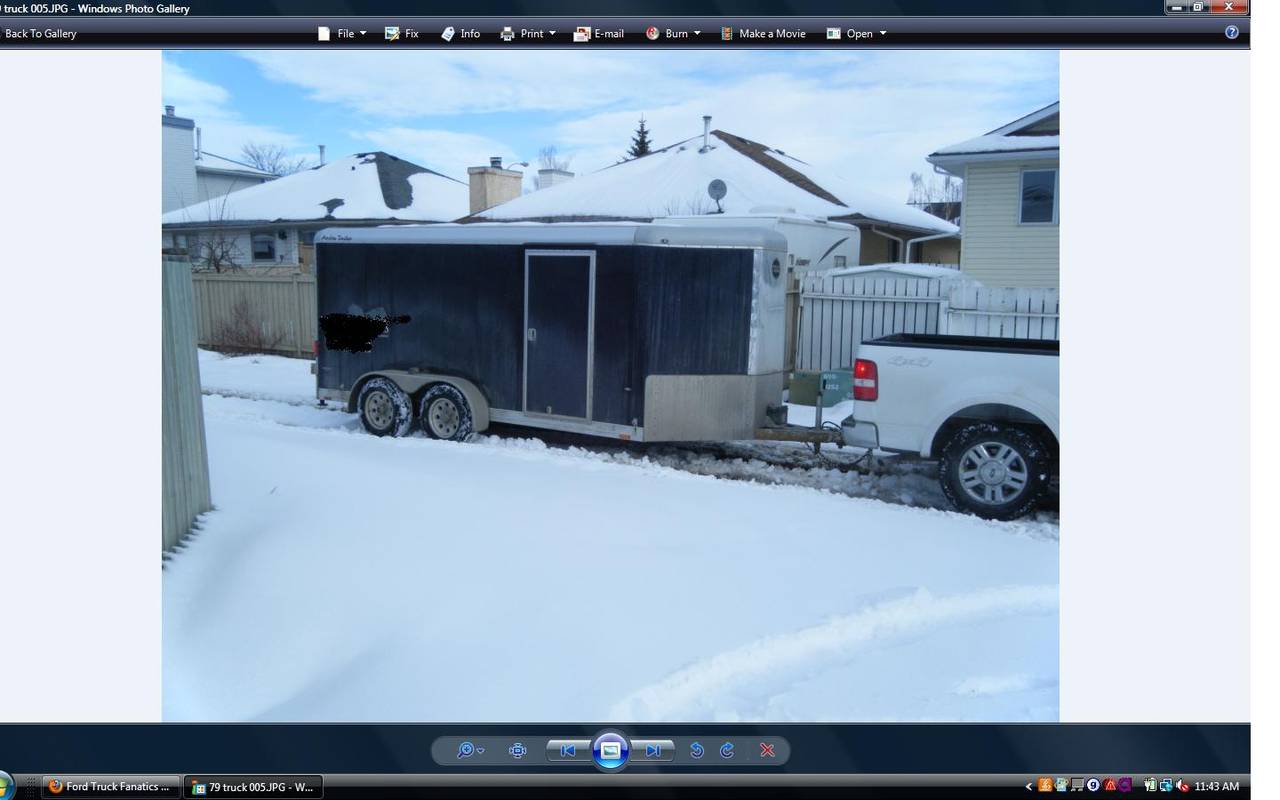

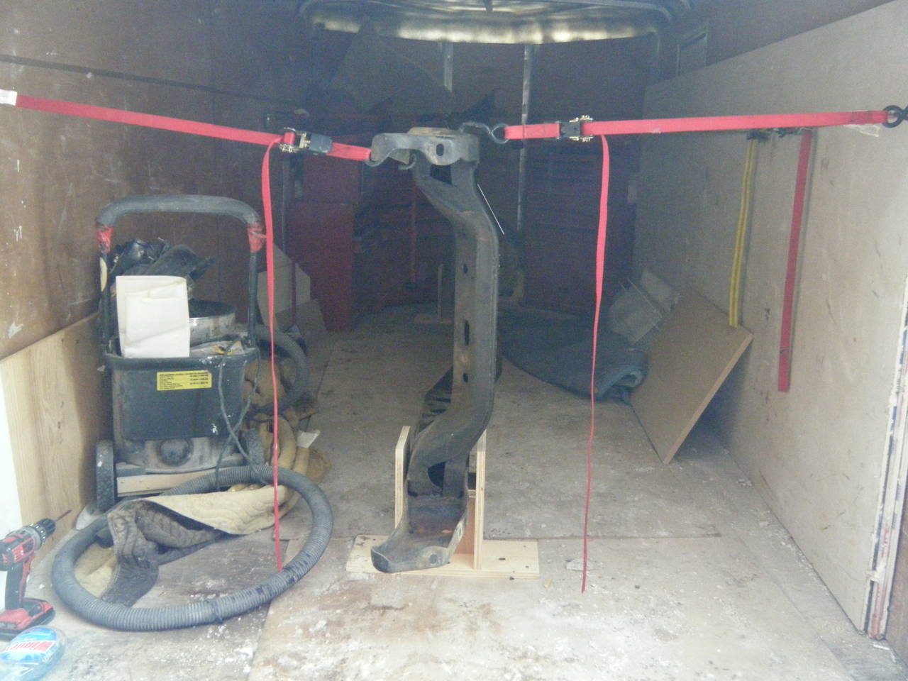

Went to load the frame up yesterday....damn thing wouldn't fit!, the spring perches were too wide so I have a trailer coming Monday morning and the frame is going in for a check.

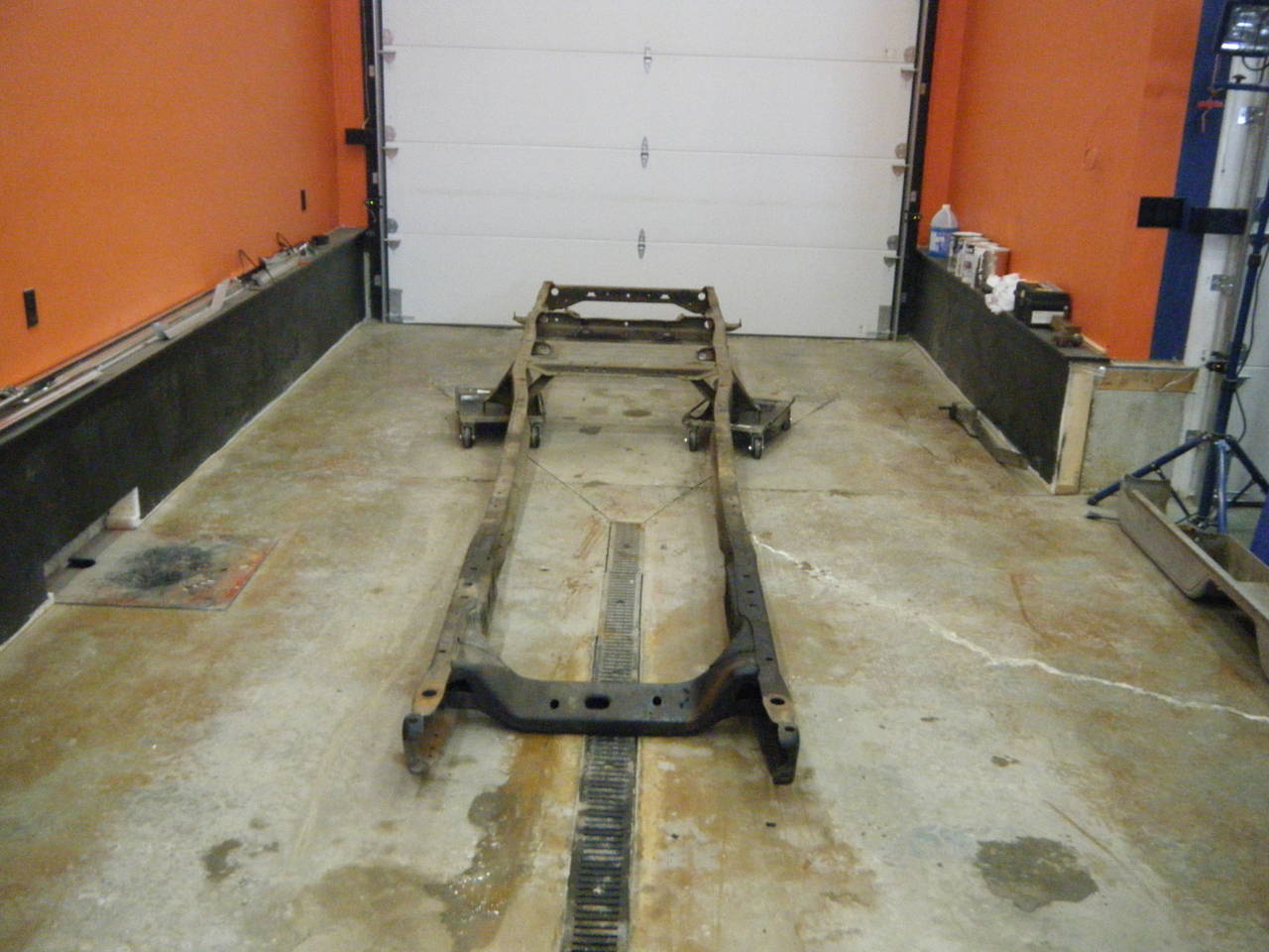

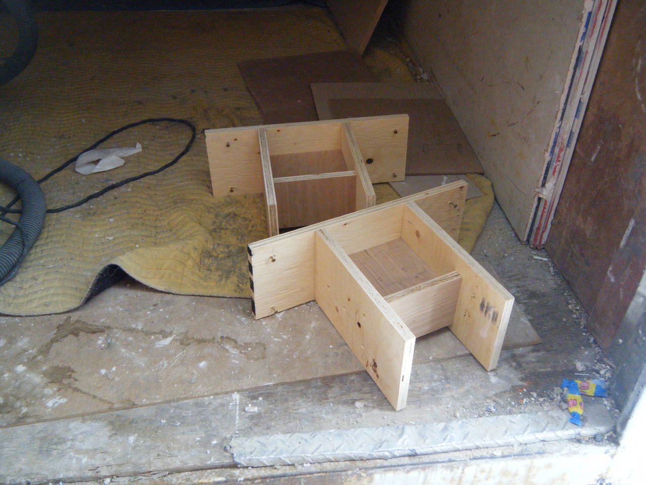

Loaded up the frame and took it to the bodyshop, carpenter buddy made a couple of brackets to slot it into. Bodyshop guy is going to TIG the rivet holes back so I can drill them out, I was going to MIG them but then the harder steel would have been a beotch to drill out without the bit wandering. The same guy is also going to do the diffs and epoxy coat the shafts and inside the axle tubes.
Ready to load:
Jigs which we screwed to the floor:
Secured in place:
Wouldn't fit flat, that is why we stood it:
