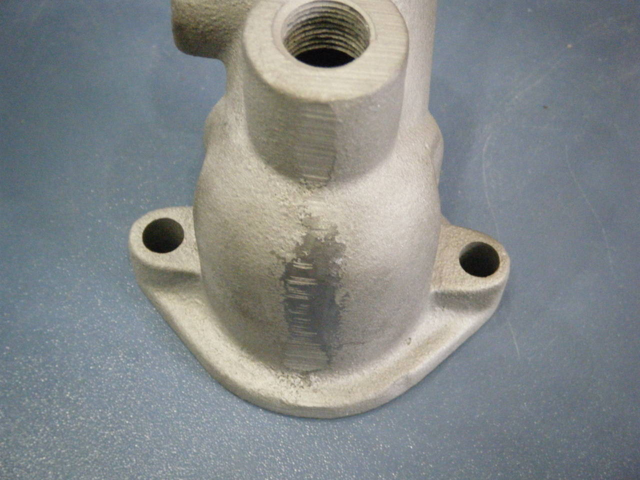

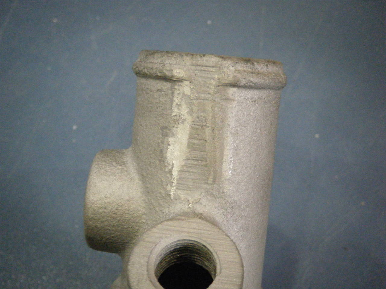

Started on the thermostat housing with a file, will finish up with a Dremel. Also noticed that the base of the housing is not perfectly flat.
I'd take that thermostat housing to a machine shop and have them hone the base flat.
That is the plan :D
Good call. Those aftermarket O-ringed chrome housings always leak!

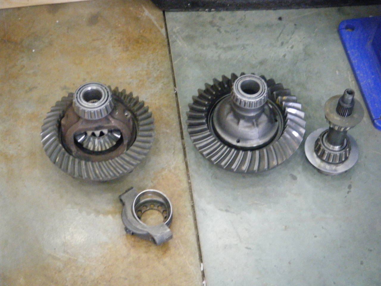

Just finished talking with Moser Engineering....ordering all the shafts plus the lockers today through TMeyer.
LockerS...as in you're putting one up front as well? 4 wheel burnouts?????
Detroit locker in rear, truetrac in front :D...and alloy axle shafts..so yes, 4 wheel burnouts!
