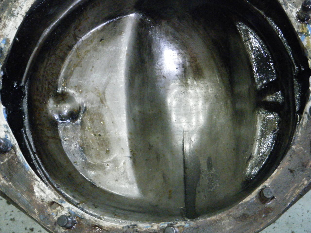

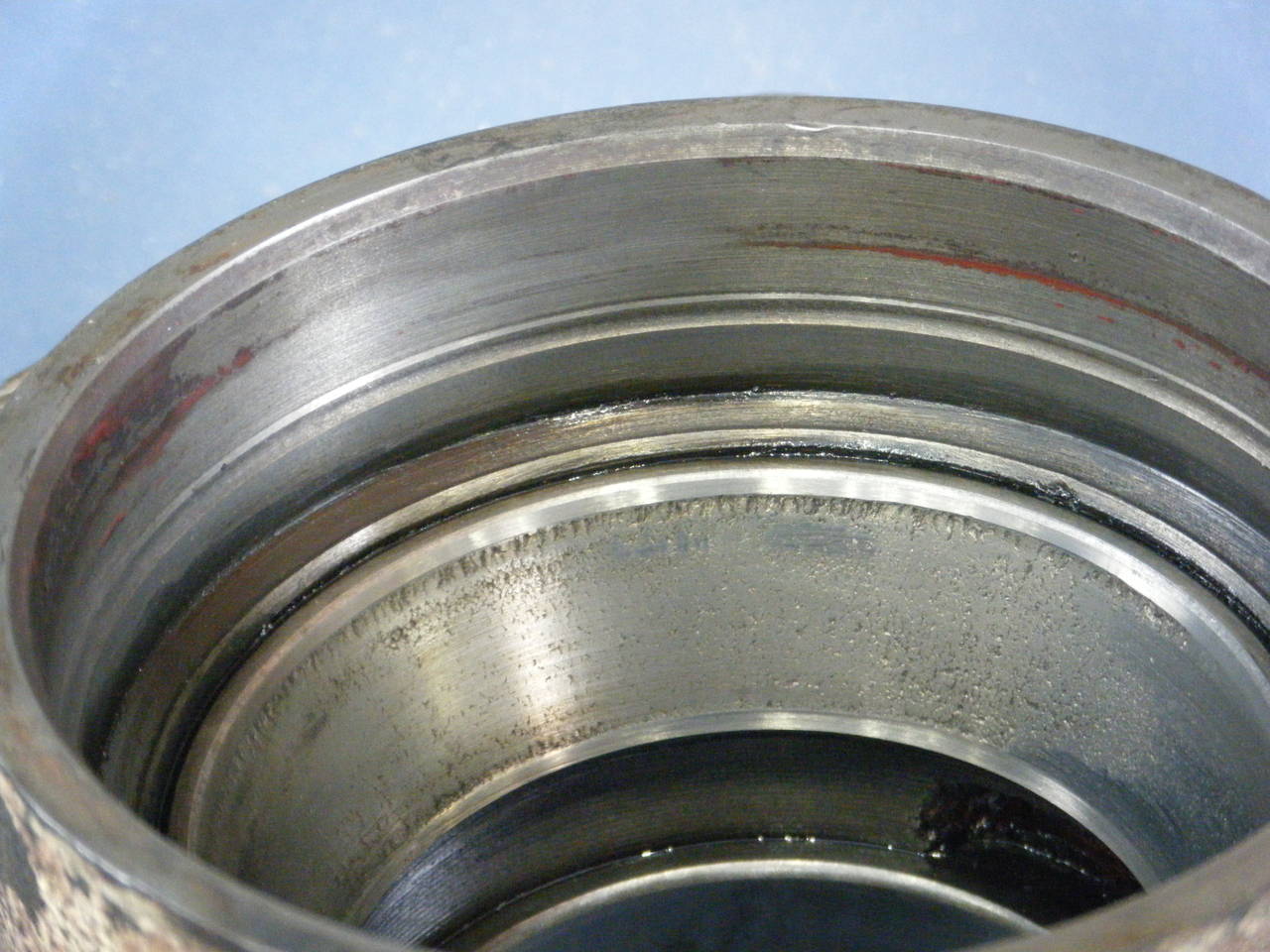

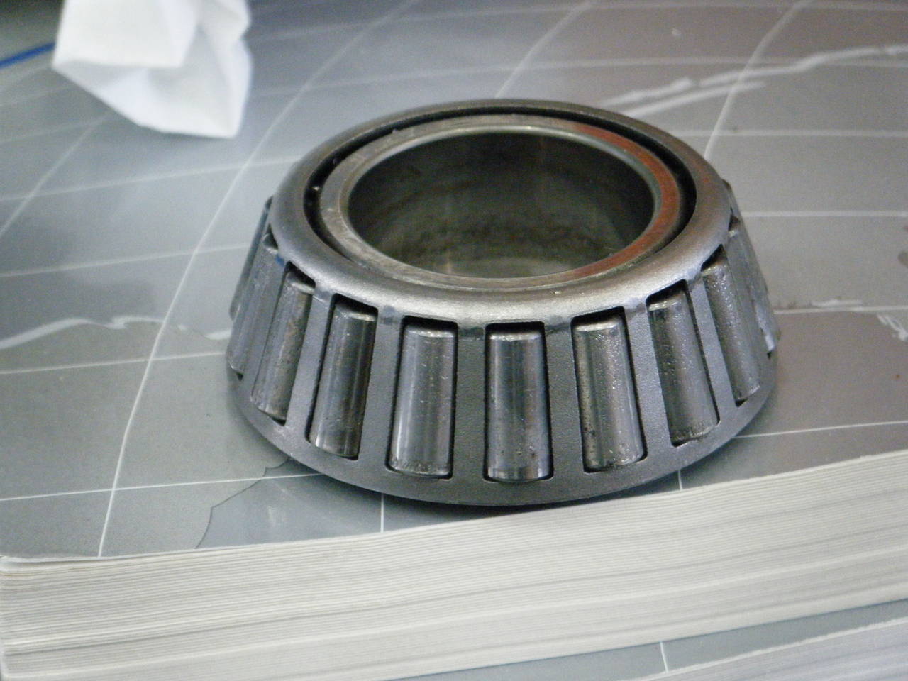

Did more cleaning/prepping today...kind of made a grim discovery...at one point I would guess a bearing failure in the pinion as the case has a nice gouge in it. The front pinion bearing is a non OEM type and the race is galled. The ring gear looks original looking at the stamping on it and didn't get damaged. I'm thinking that it happened at low speed and the owner at the time stopped right away.
Going to go and pick up the transmission case tomorrow as well to start cleaning it up.
Pinion race:
Bearing:
Fits the ring gear nicely :D

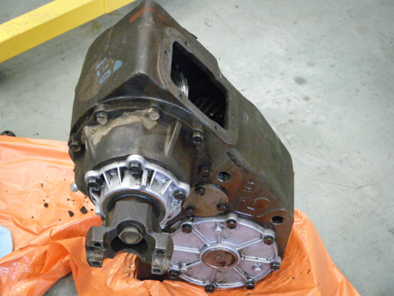

The 205 is easily capable of handling that kind of power...and with that converter, driveline shock load should be minimal...don't forget, I'm only going to run a 31''-32'' tire...no bigger.
The 1980 CJ-7 I had , had a 300 transfer case. Its similer to the 205. It handled the Chevy 350 & muncie 465 that I put in it just fine. I did spin axles, spun up both drive shafts and broke in two, broke several yokes.

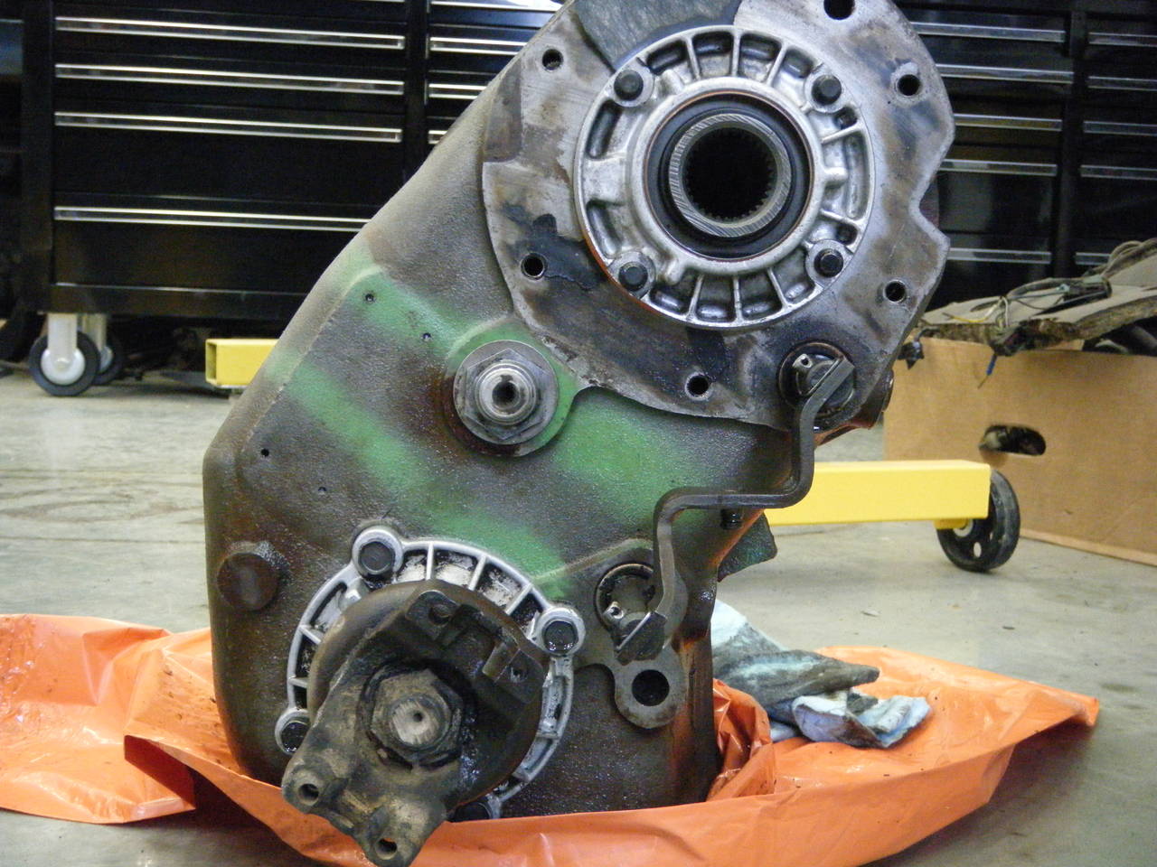

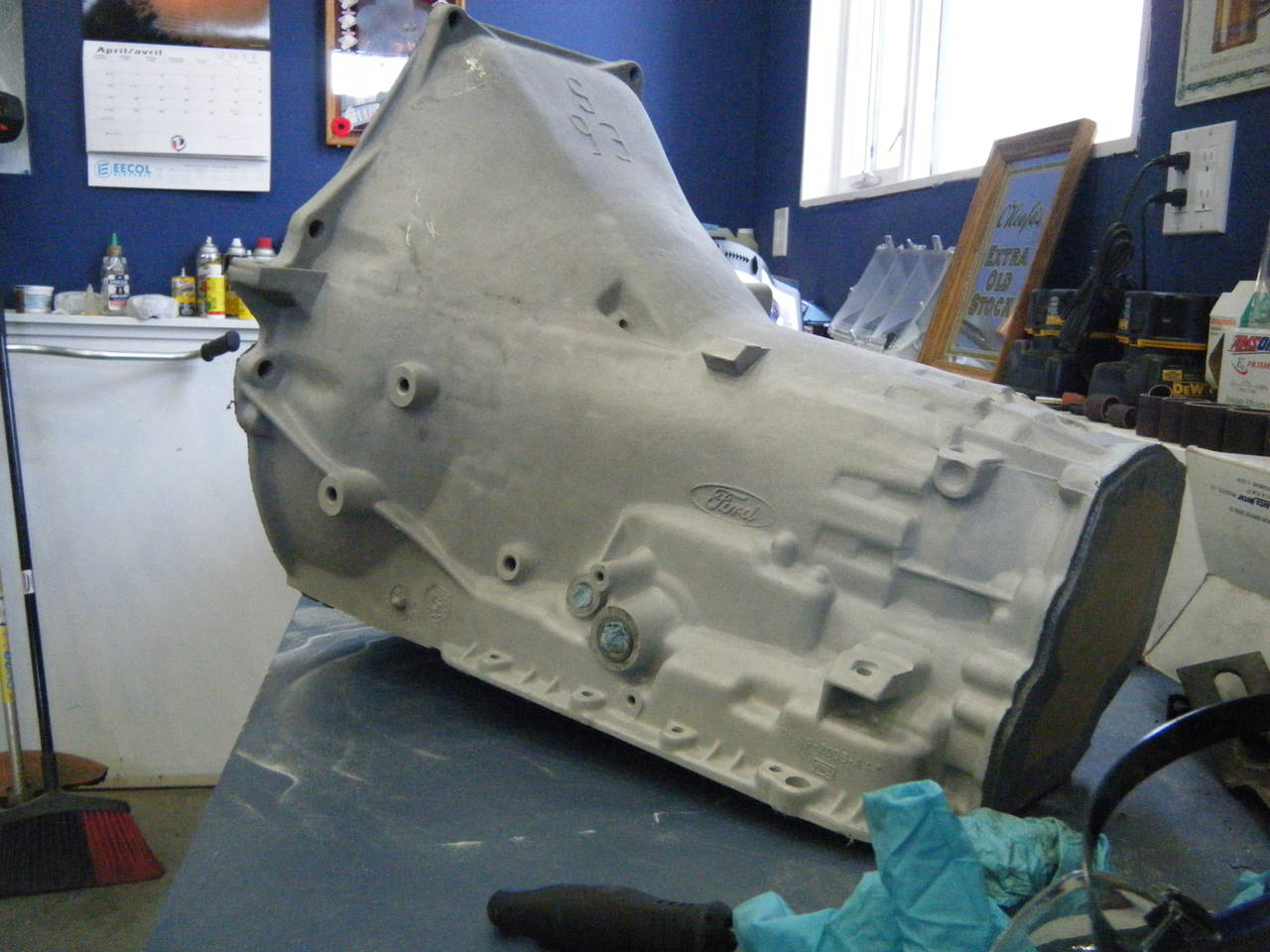

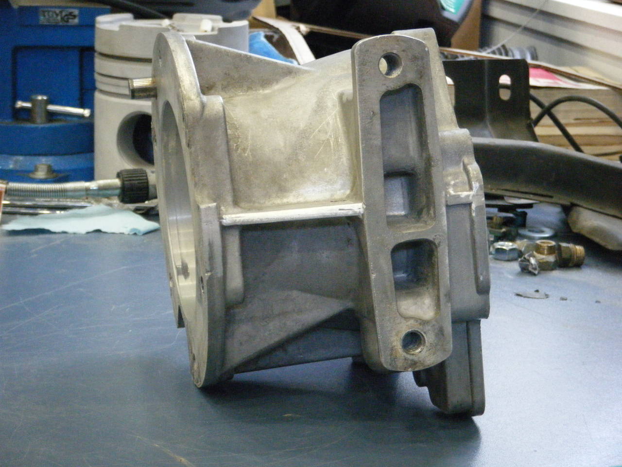

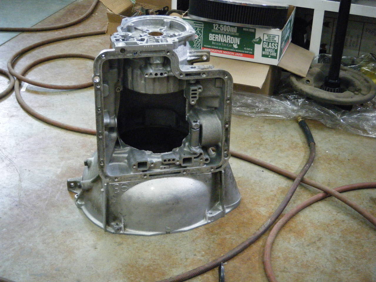

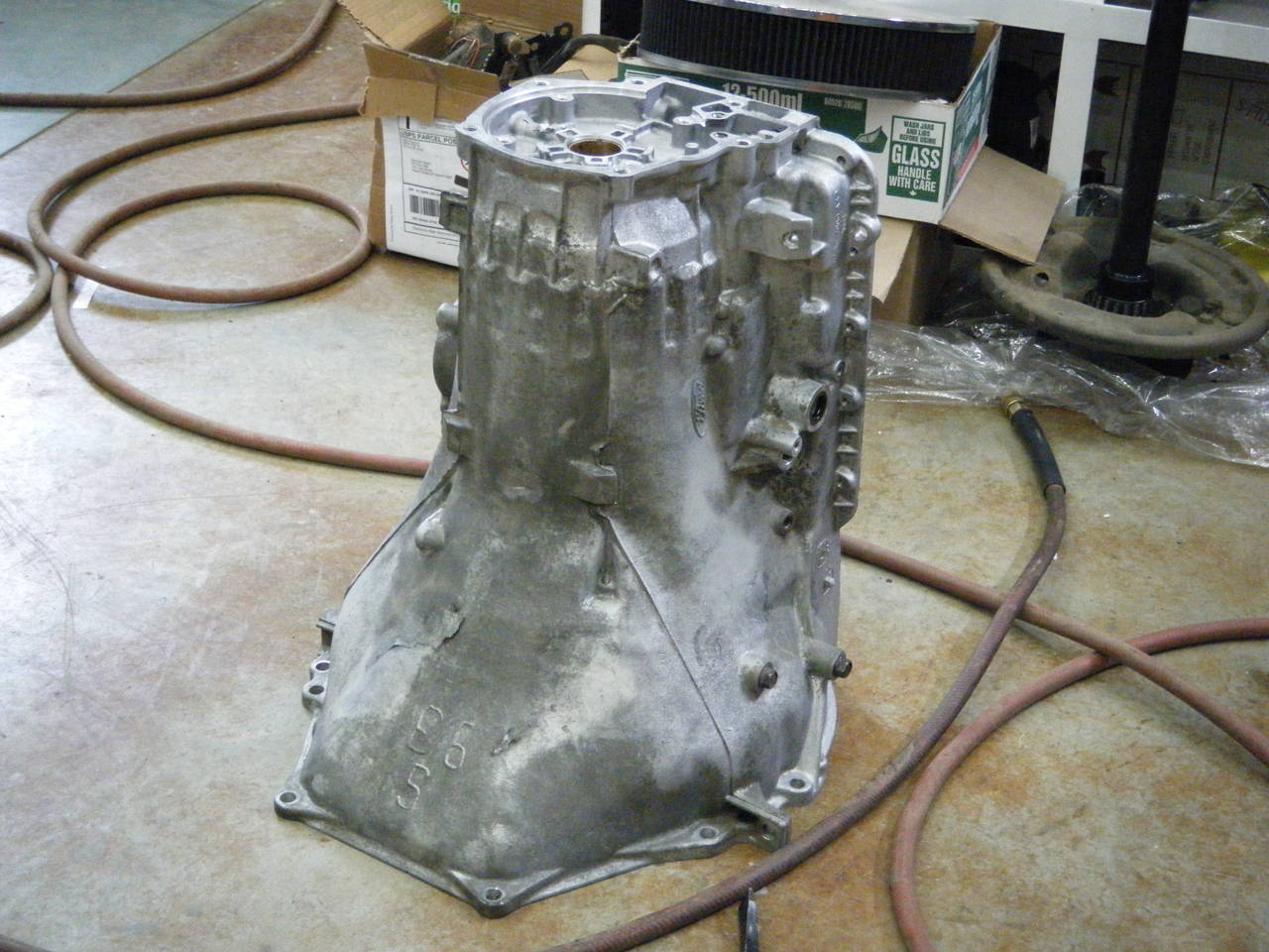

Got the transmission case back, started to clean up the case castings:

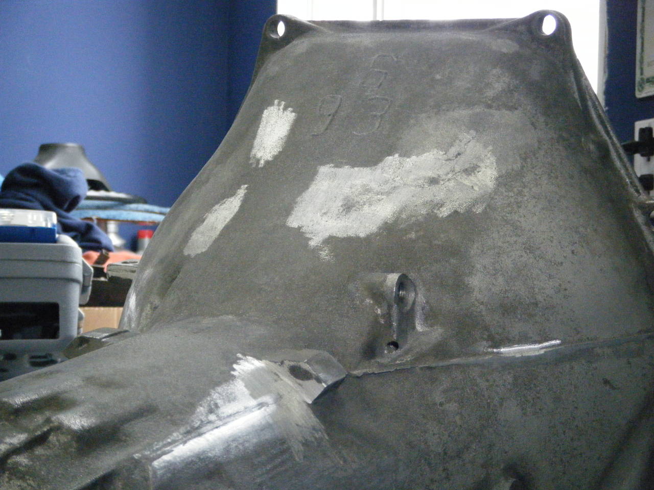

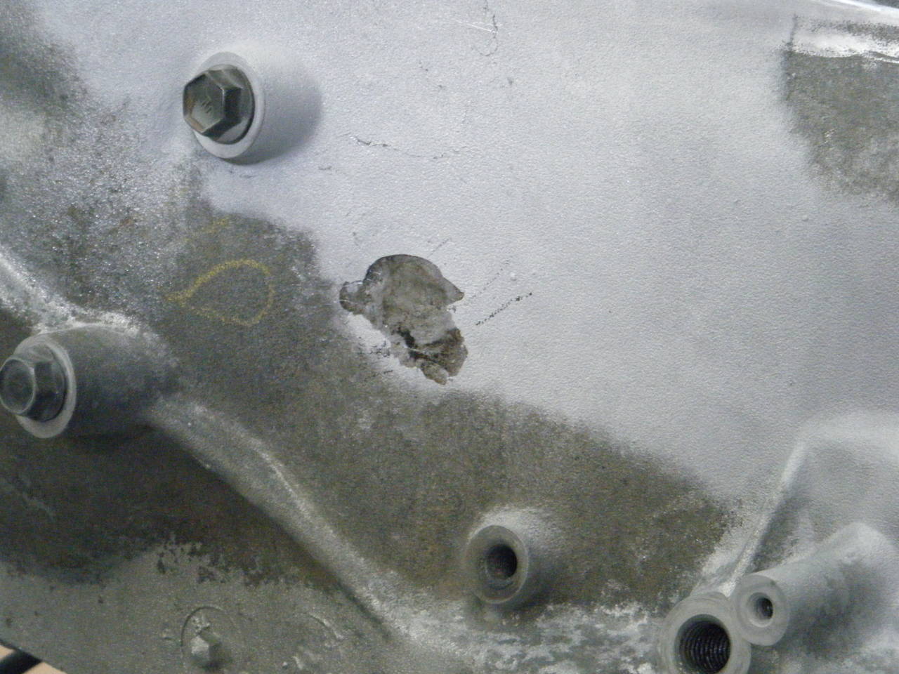

Damn crappy castings...got pieces flaking off, but best to catch it now before powdercoating:

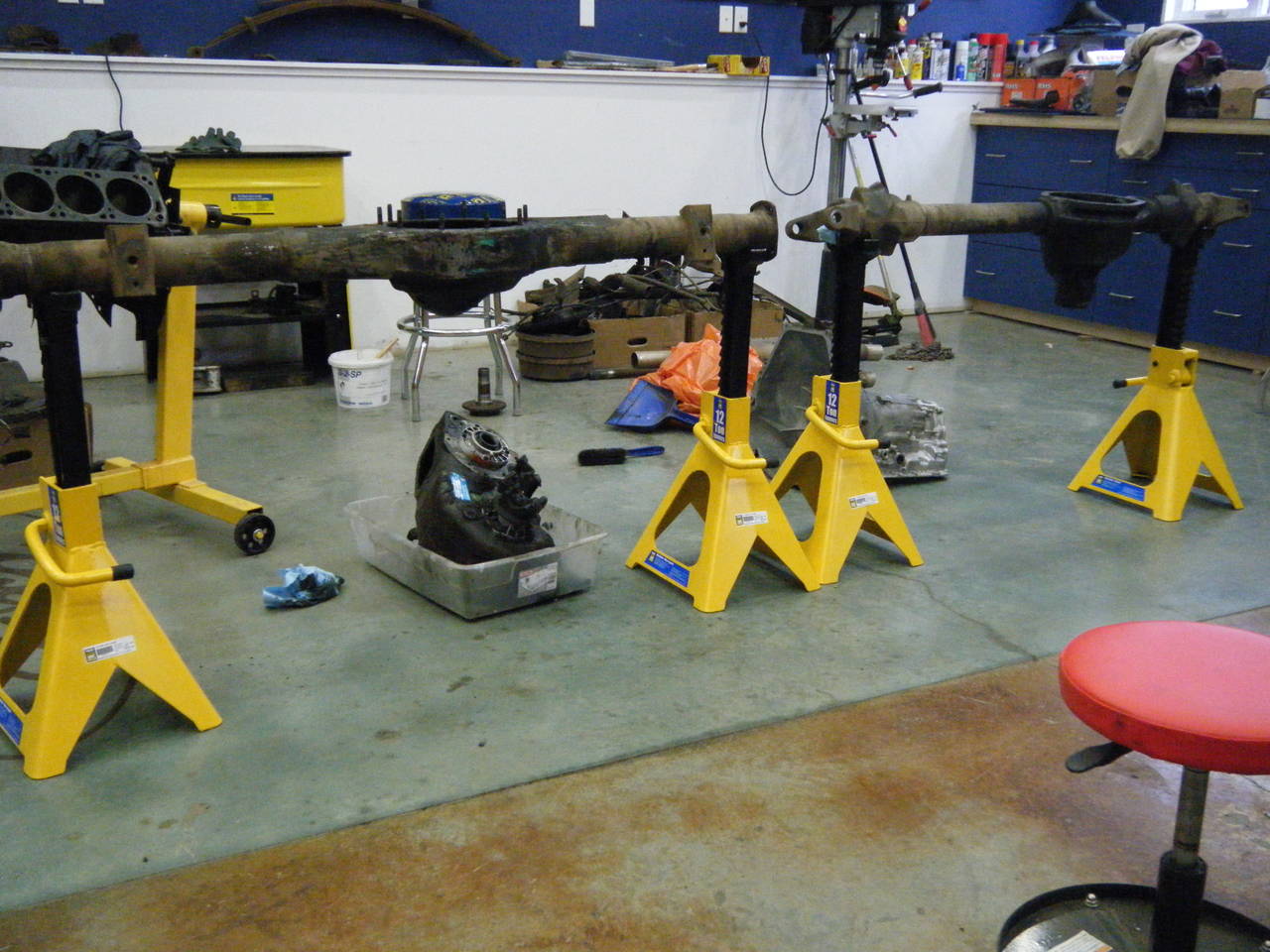

Still cleaning up the axles:

Is there an easy way to fill those casting holes ?

I have filed/dremeled/grinded most of the casting holes away.
Dosn't that thin out the case ?

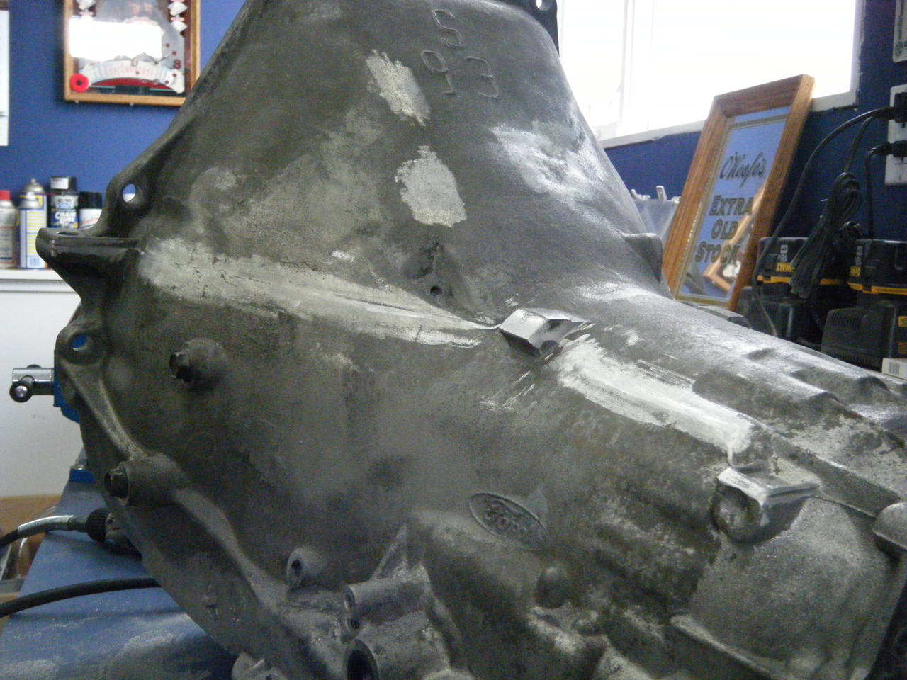

Maybe a tiny bit, but most of the imperfections have been very shallow or simply extensionso of the mold in the casting process. There is one however that is on the top just below where the converter would go that has an actual crack inside which was factory ground...I will be having that TIG'd up just in case although it's been like that since day one.

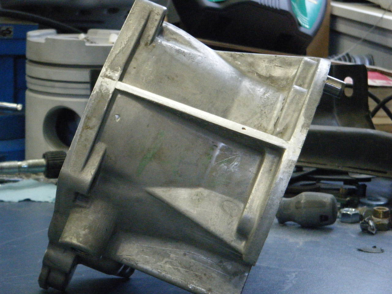

Interesting Mark!. Got the case done to the point to take it to the powdercoat place. Degreased the transfer case reasonably well, going to go drop that off so I can get the case back for grinding as well.

I have some of those aluminum repair rods I picked them up at Carlilse car show.
They work great have used them to repair many different things.
Thanks lads...still have a bit more left on the case. Picking up the frame in the morning and dropping off the case to get that little crack TIG'd up. I did look at that repair rod that was mentioned, but I would just rather go the TIG route.
