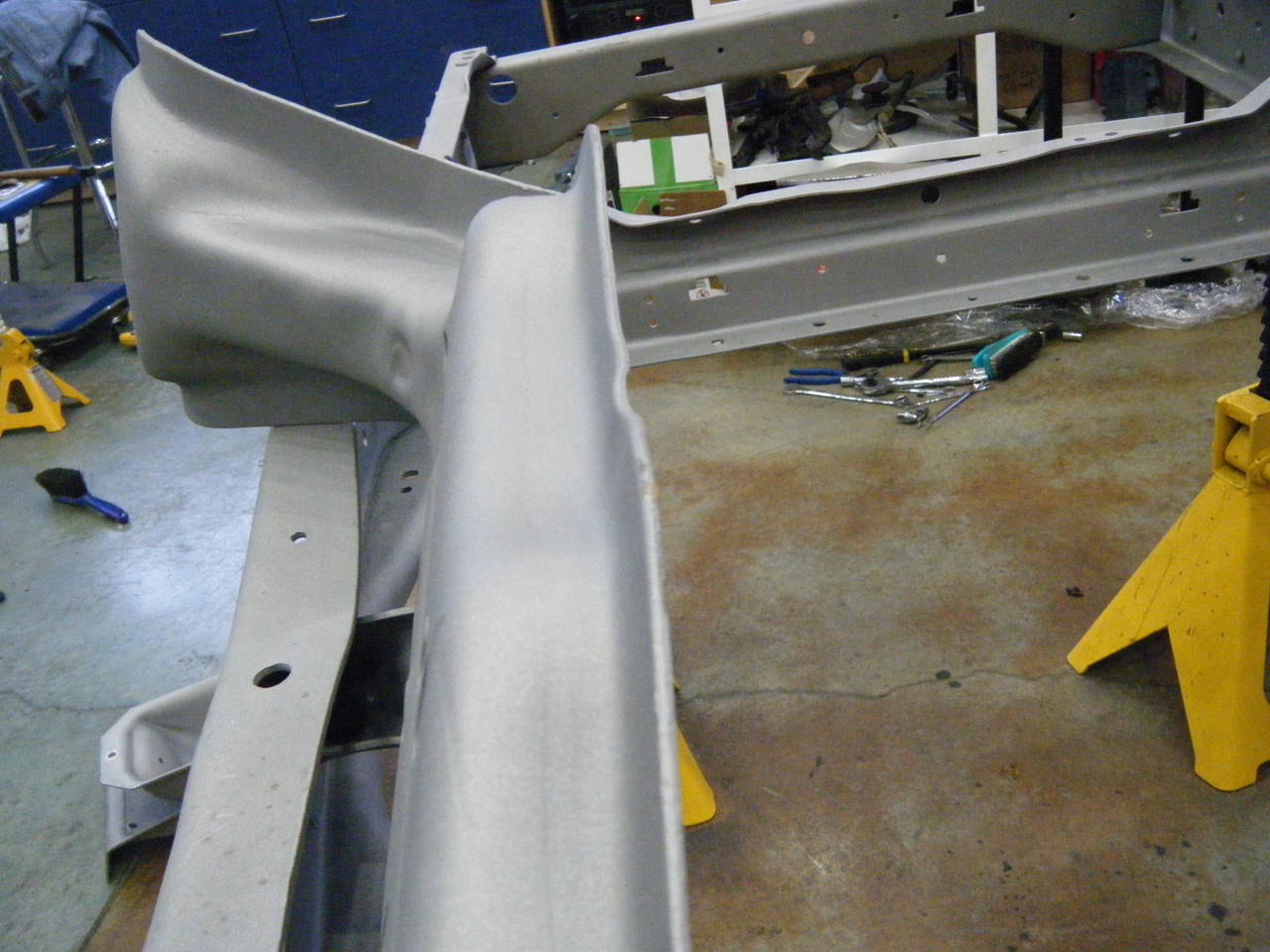

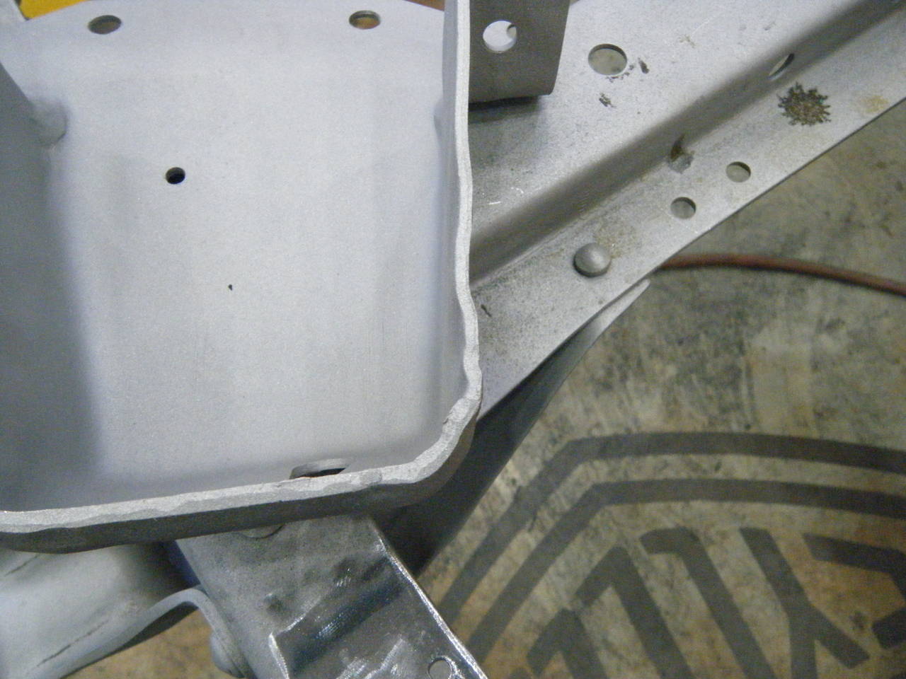

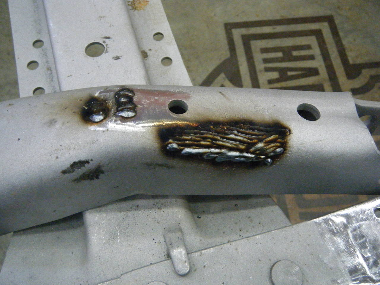

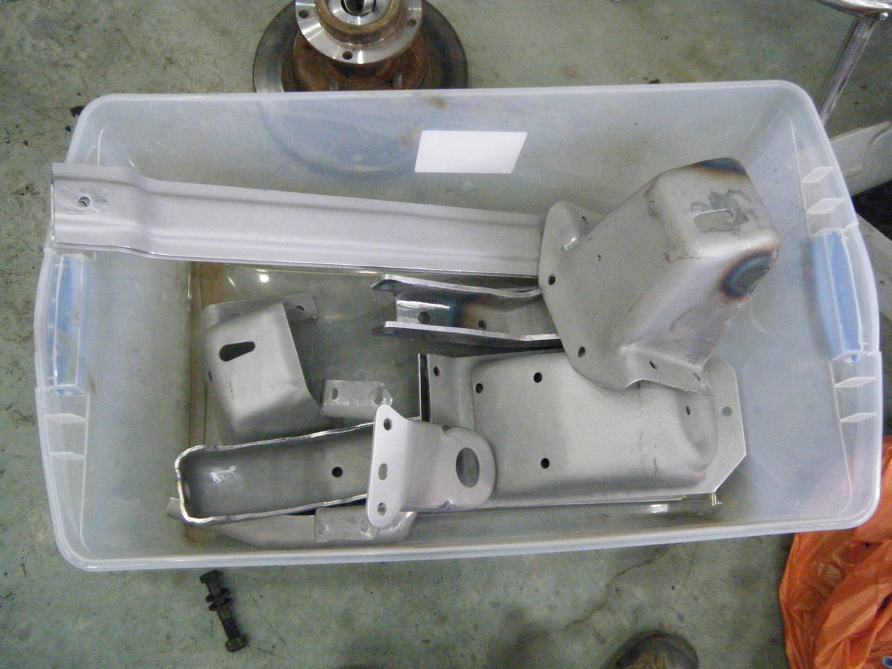

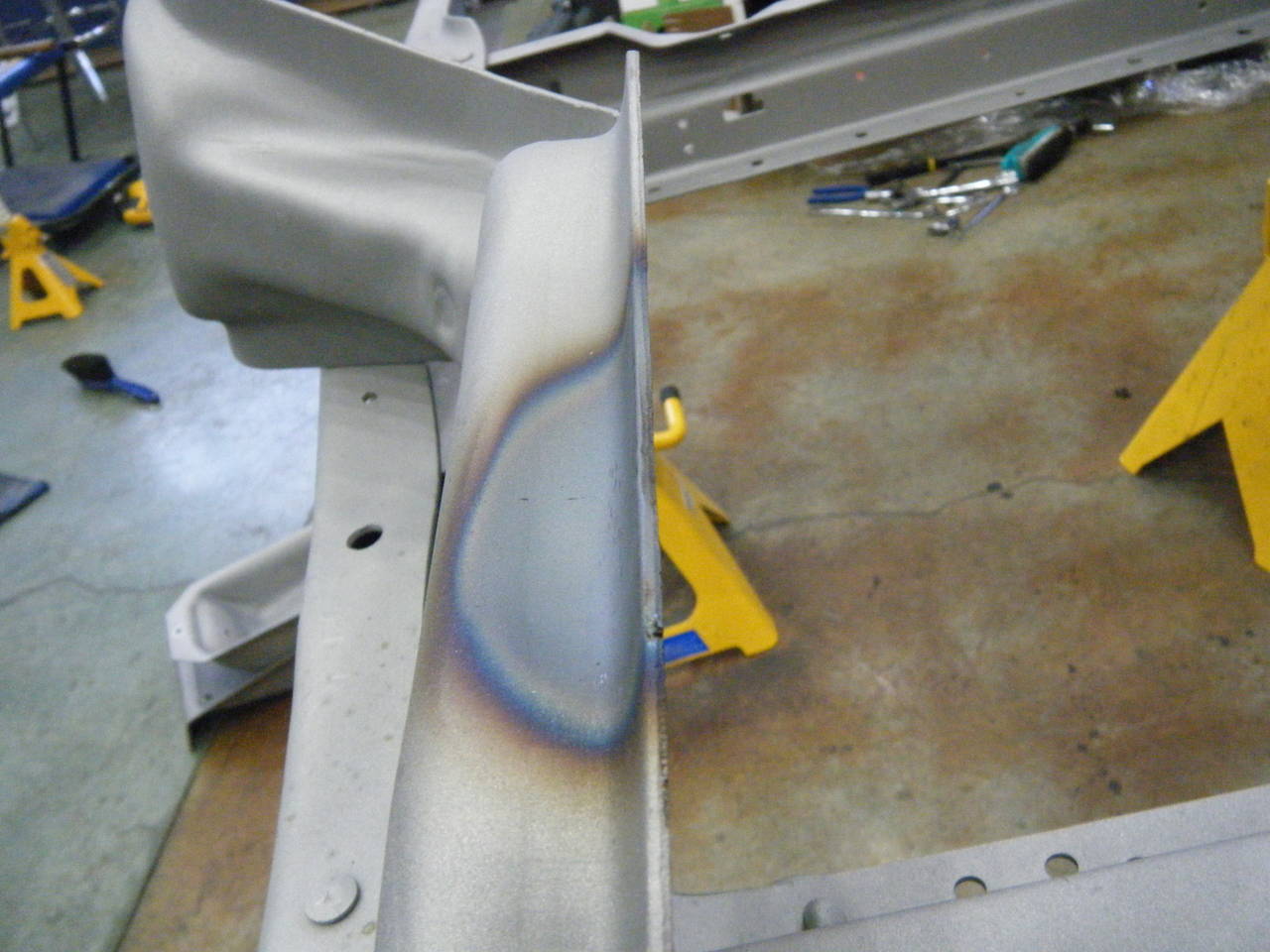

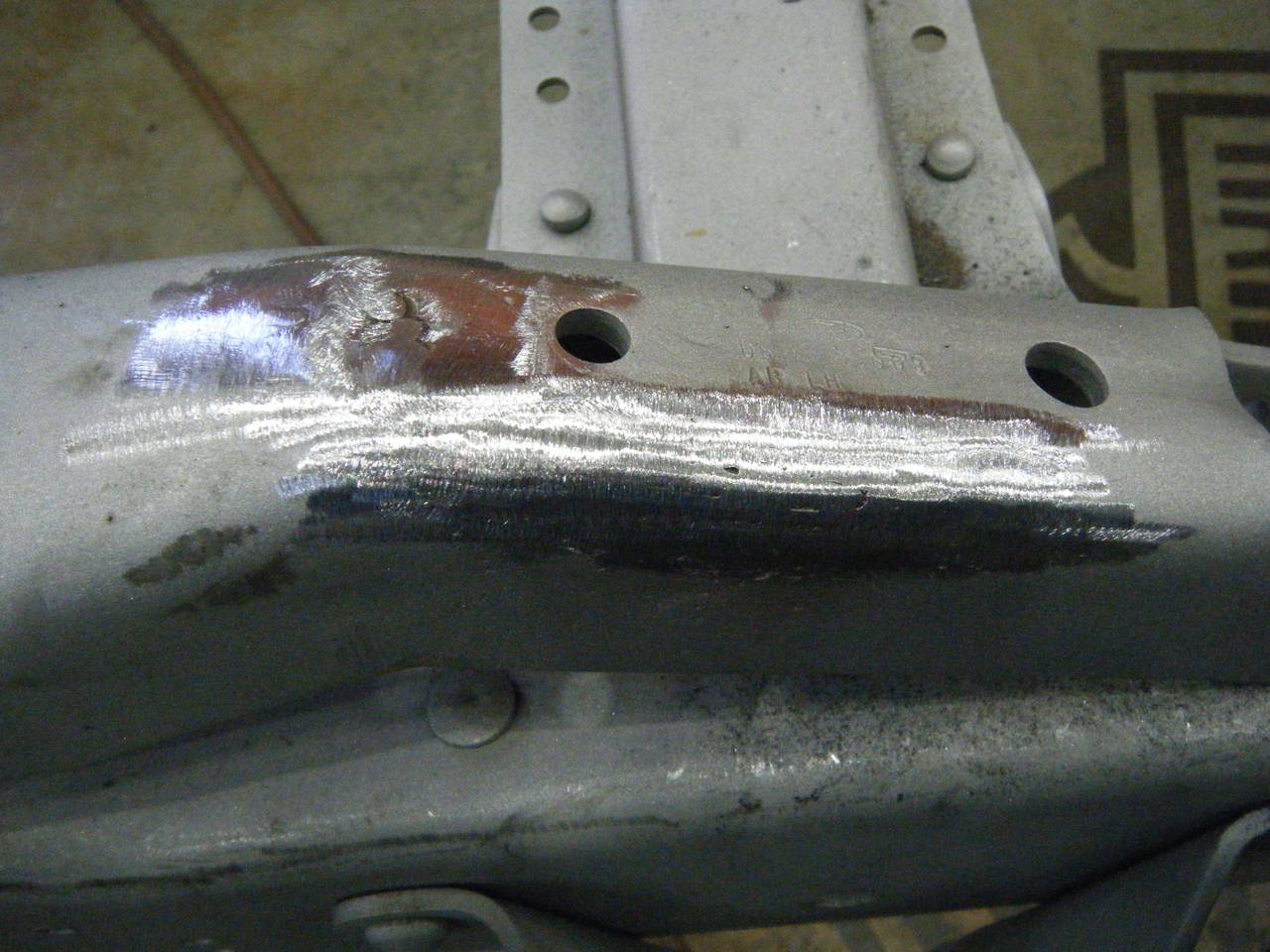

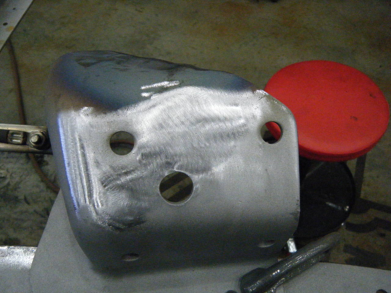

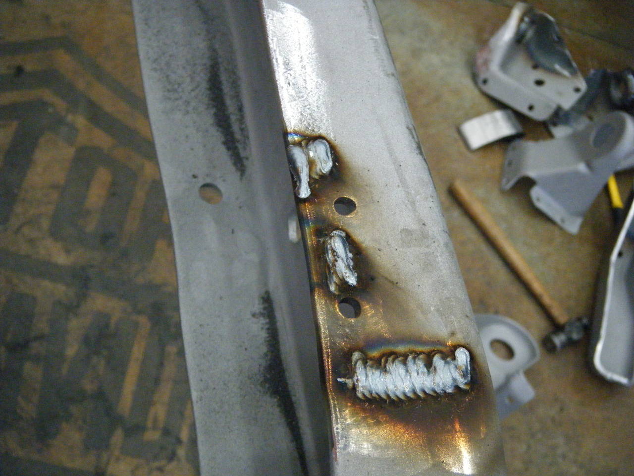

A bit more progress today, took the axles to the car wash and cleaned them in preparation for grinding/welding etc. Put some heat to some brackets to straighten out some either factory crap or things that have happened over the years.
Looks good Duncan. You can sure see the breaking point in the metal where the shear went through before it broke.
Thanks Mark, and yeah I agree....I'm going to clean as much up as I can. Thank God for beer and music :D

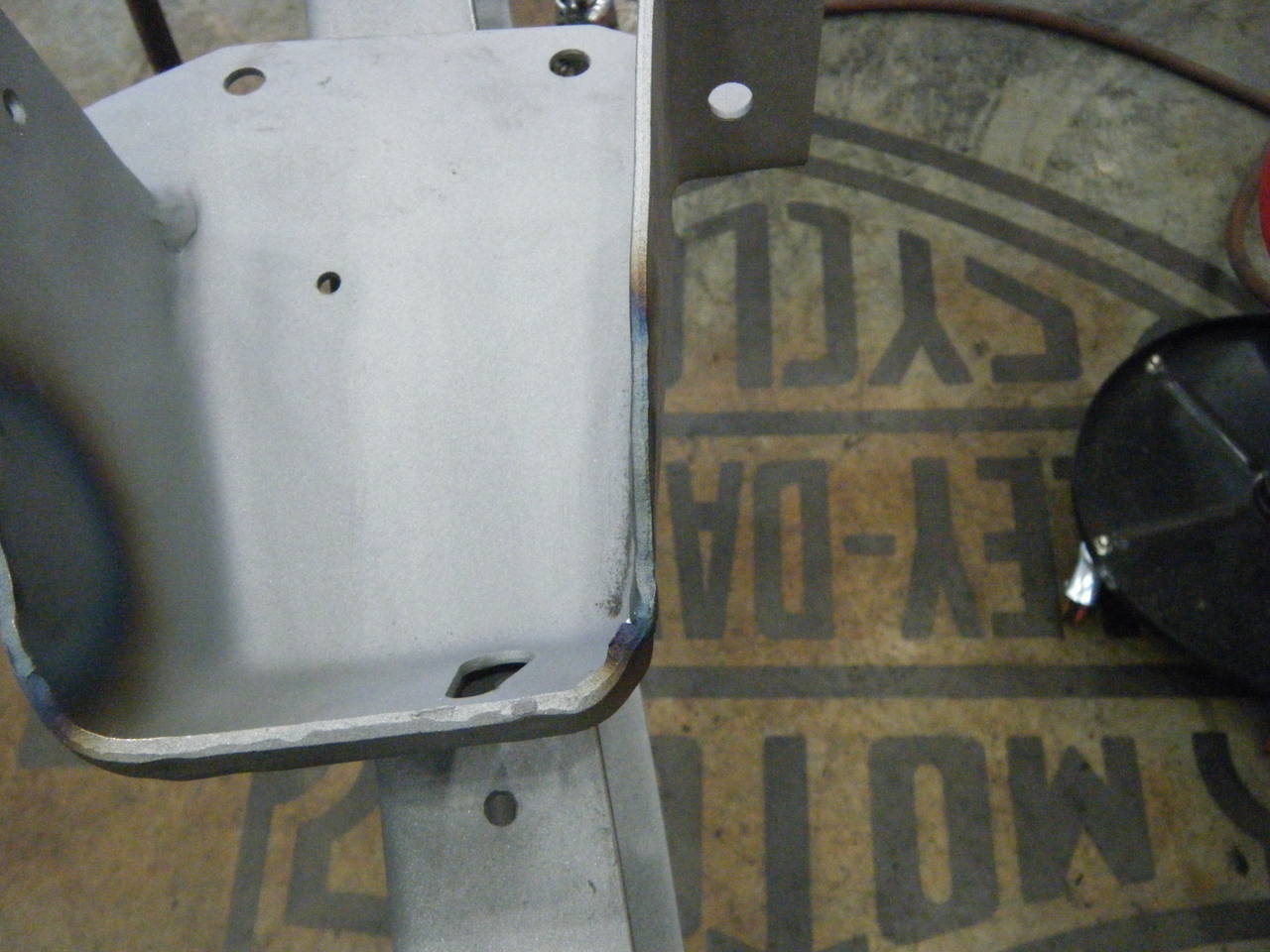

More prep...and no,they are not finished :D..back at it tomorrow.

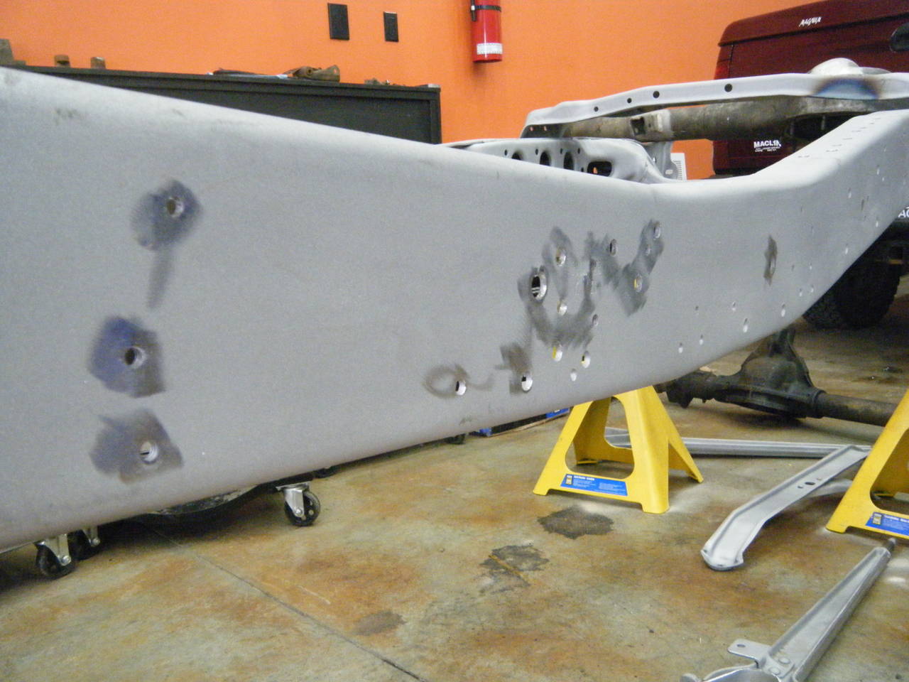

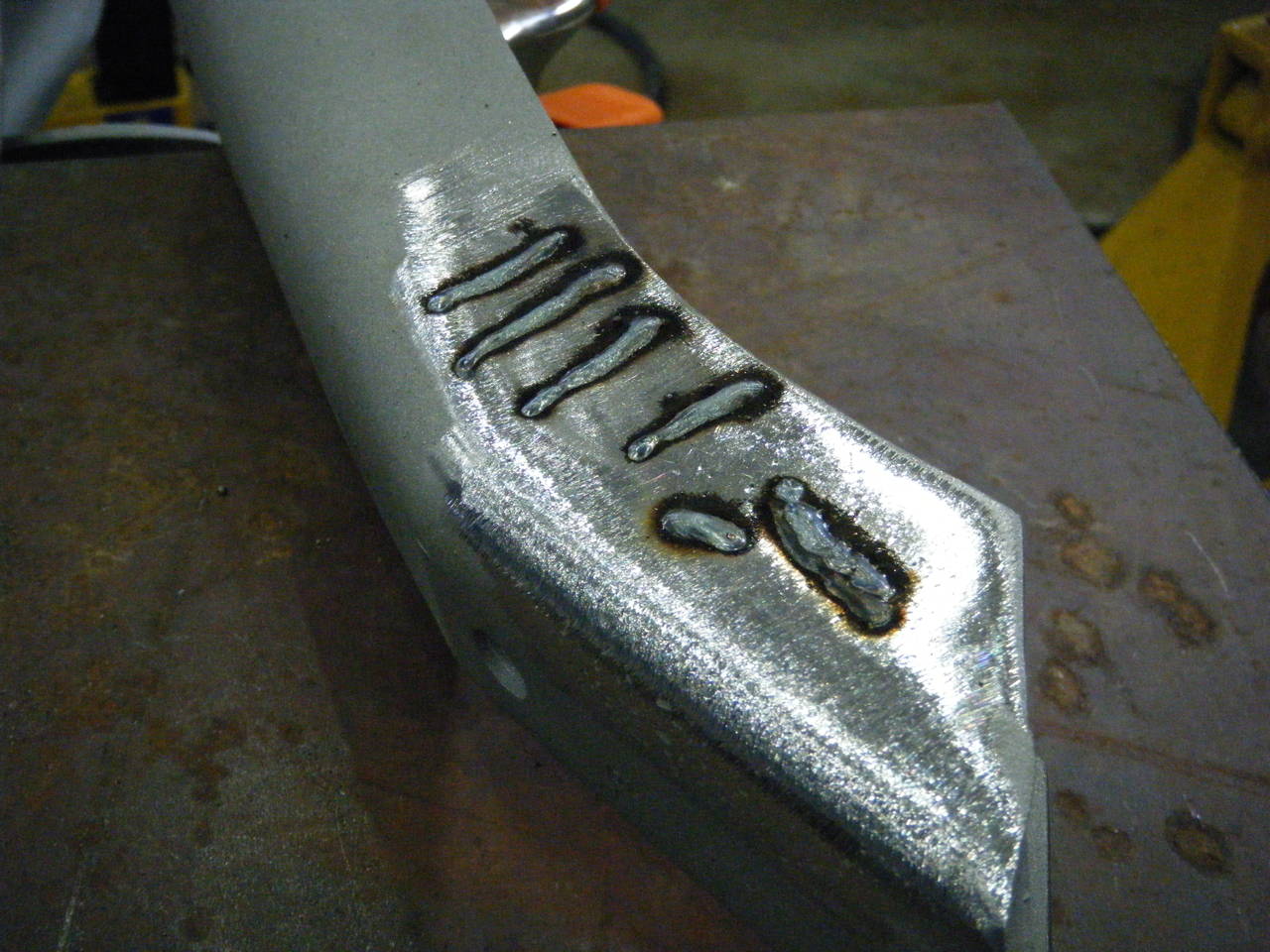

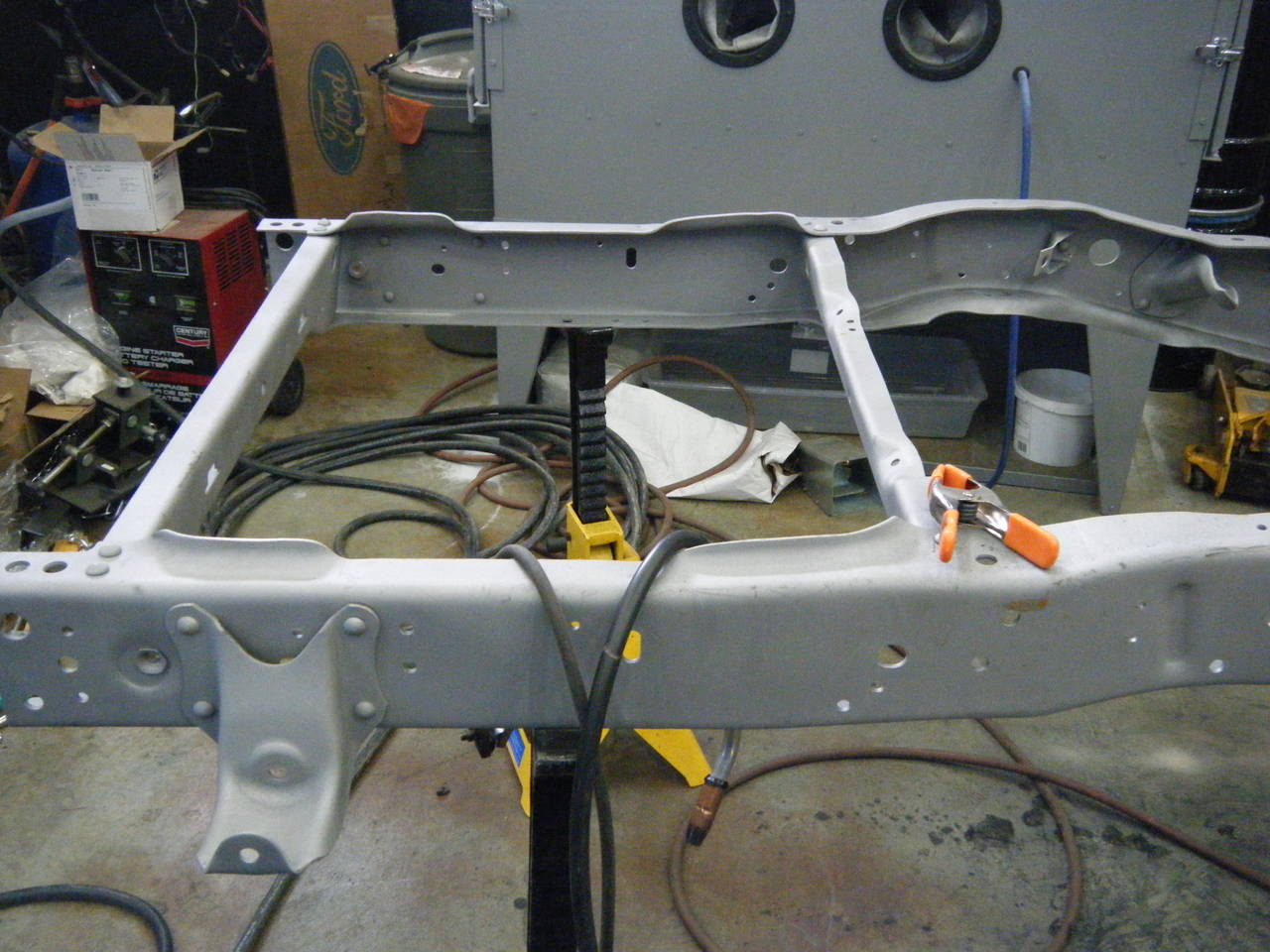

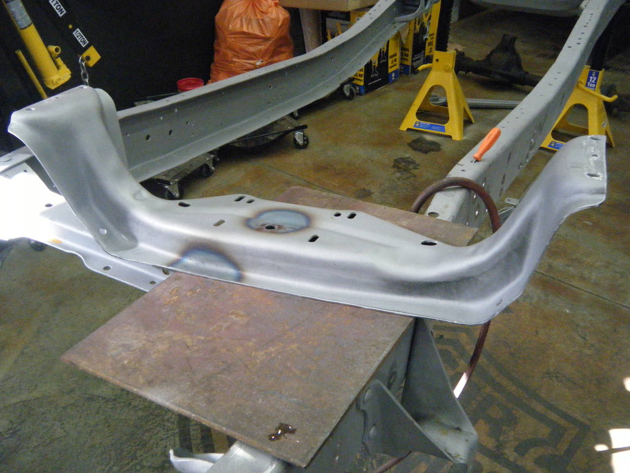

Another day at it but got a lot done, nearly finished the brackets, crossmembers etc. Radius arms and frame are next.

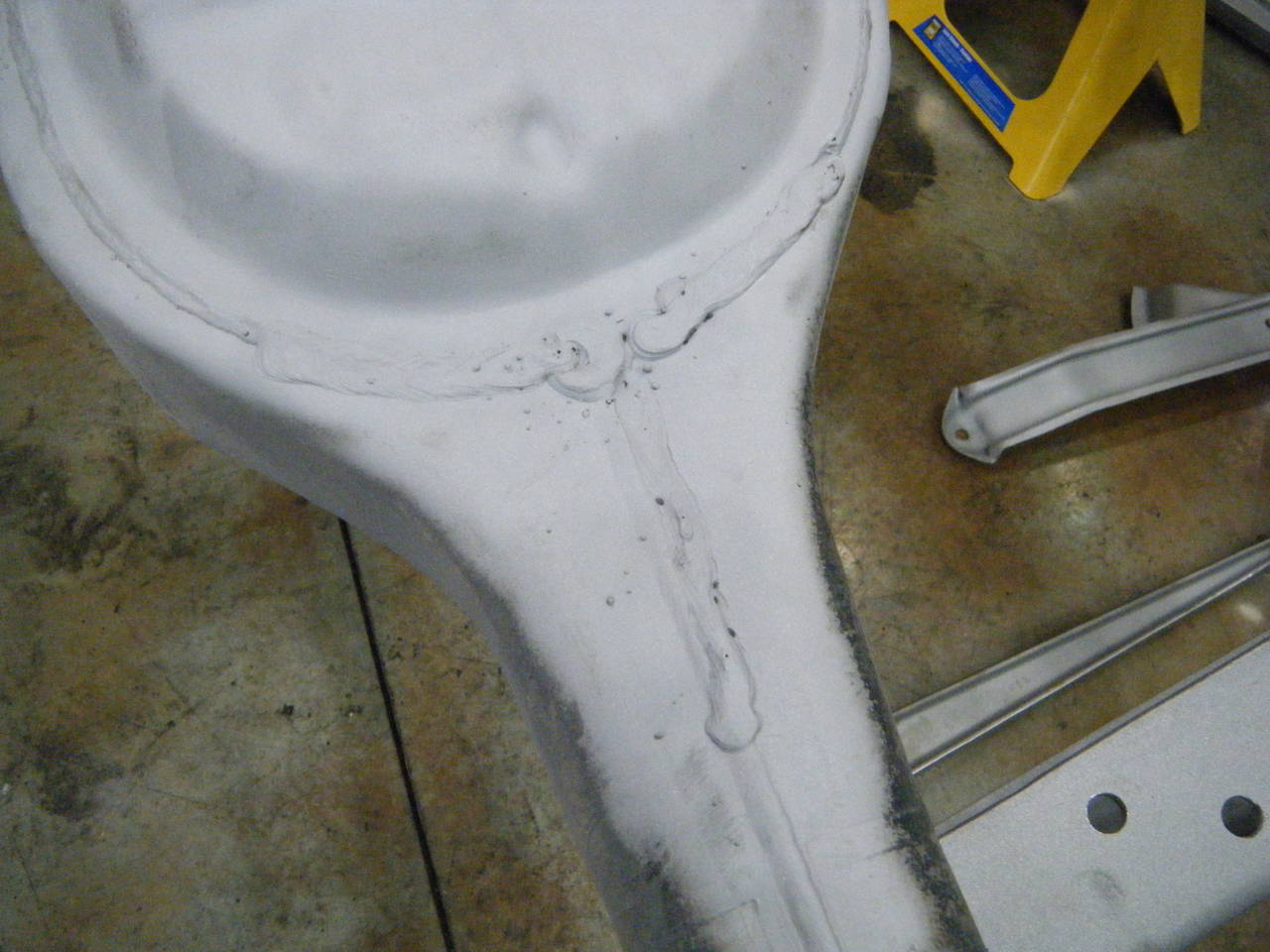

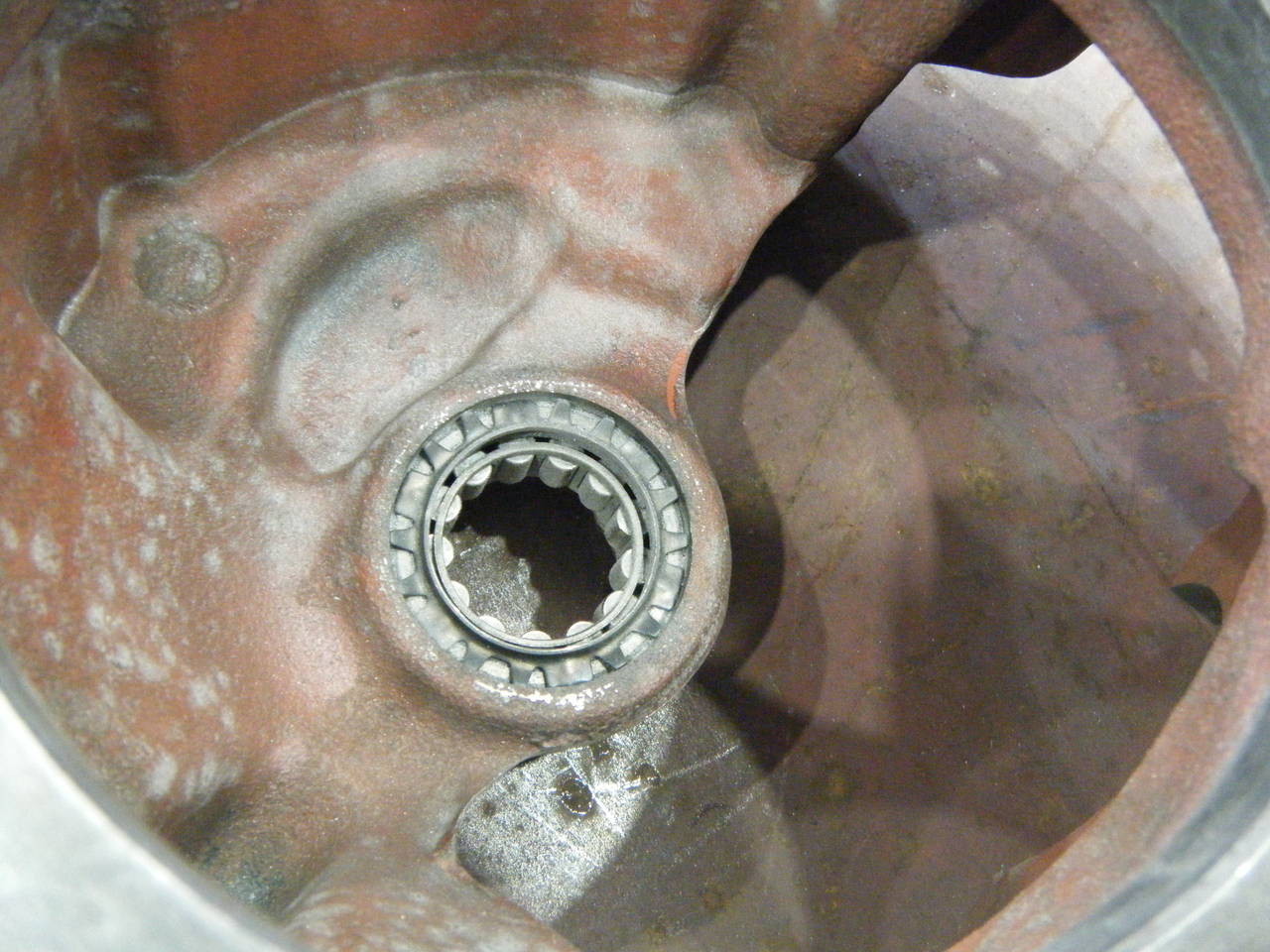

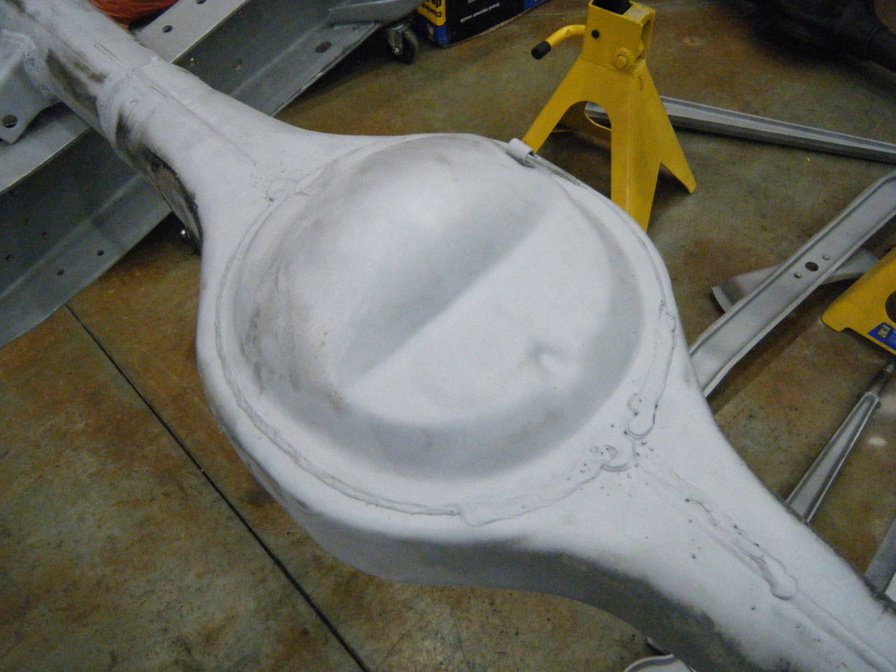

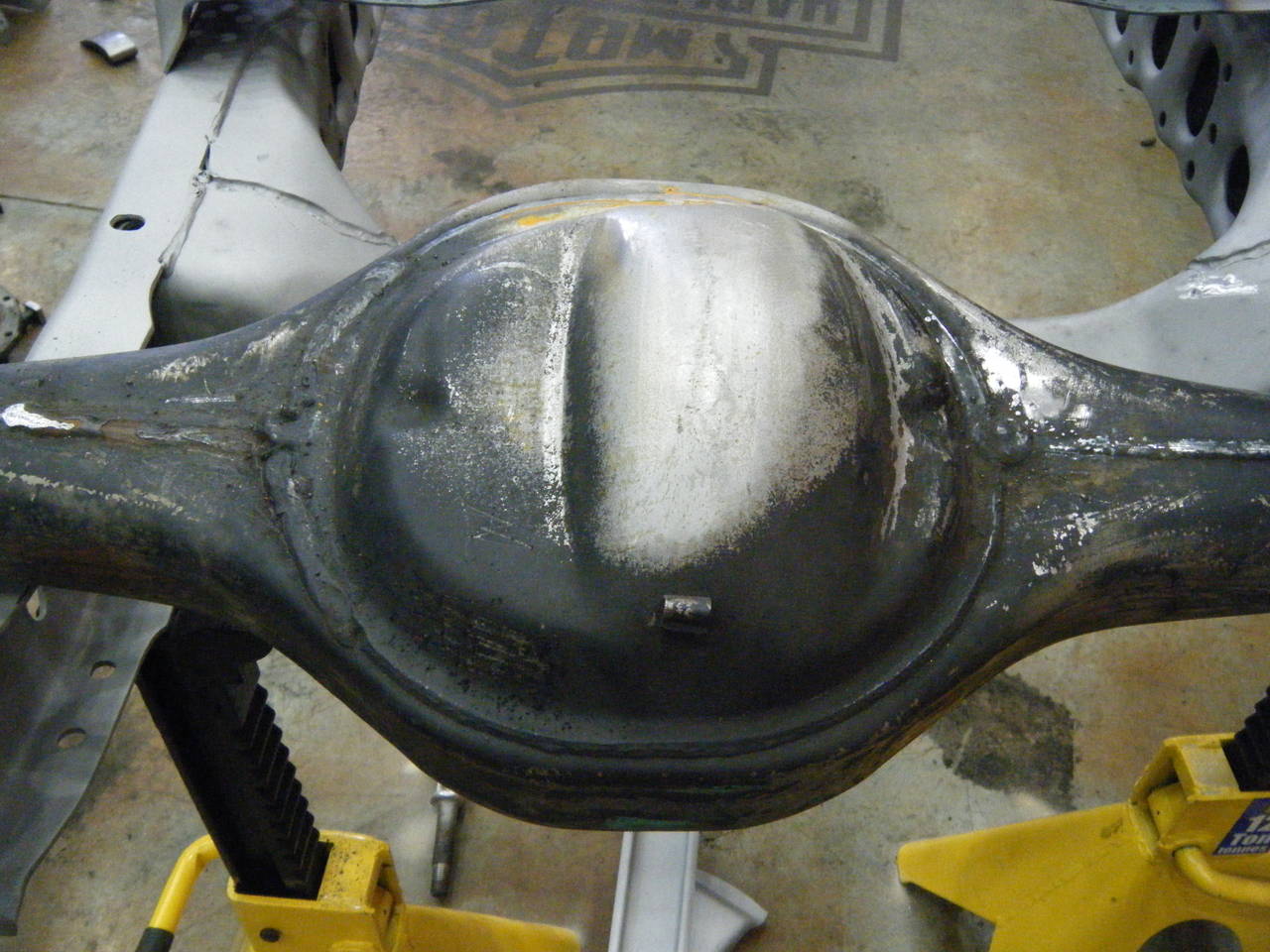

Started on the rear axle and came to a halt. I'm a bit leery that the welds on the outer housing were perhaps from that possible pinion failure..after lots of reading and asking it seems the only way to see 100% for sure if the housing is ent is to use a narrowing jig with mandrels in the center section...nothing like that where I am...so I am going to get the rear end setup and see how the axle shafts fit. I suspect I'm just being paranoid, but I figure better safe than sorry.

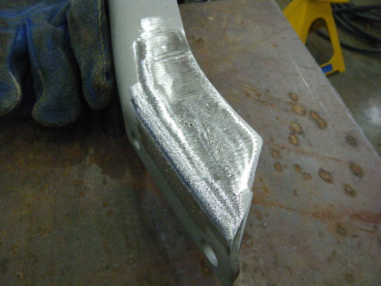

Inside patch where the ring gear made contact, I thought he was going to TIG it, had I known it was MIG, I would have done it myself.:headbang:

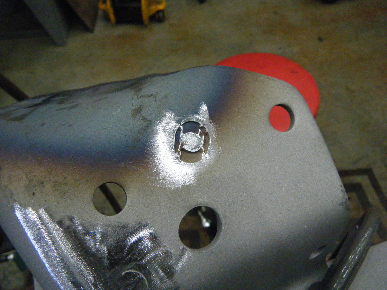

Better view of what has got me in a lather this time :D

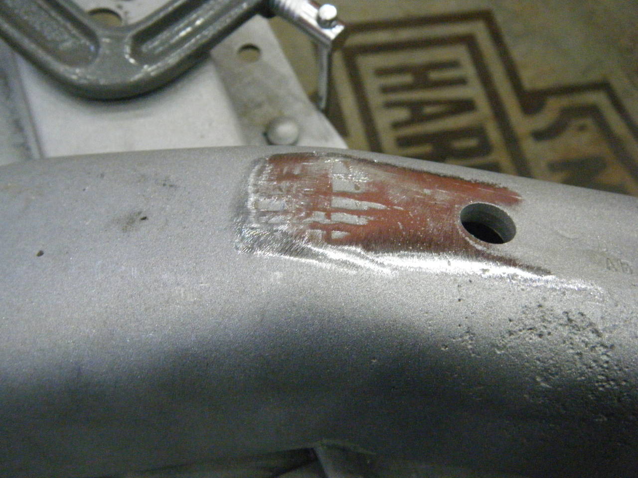

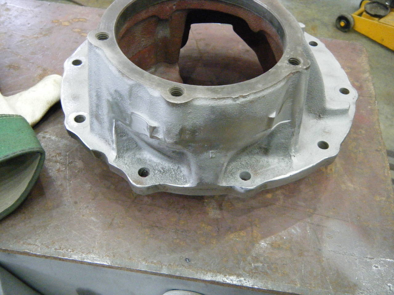

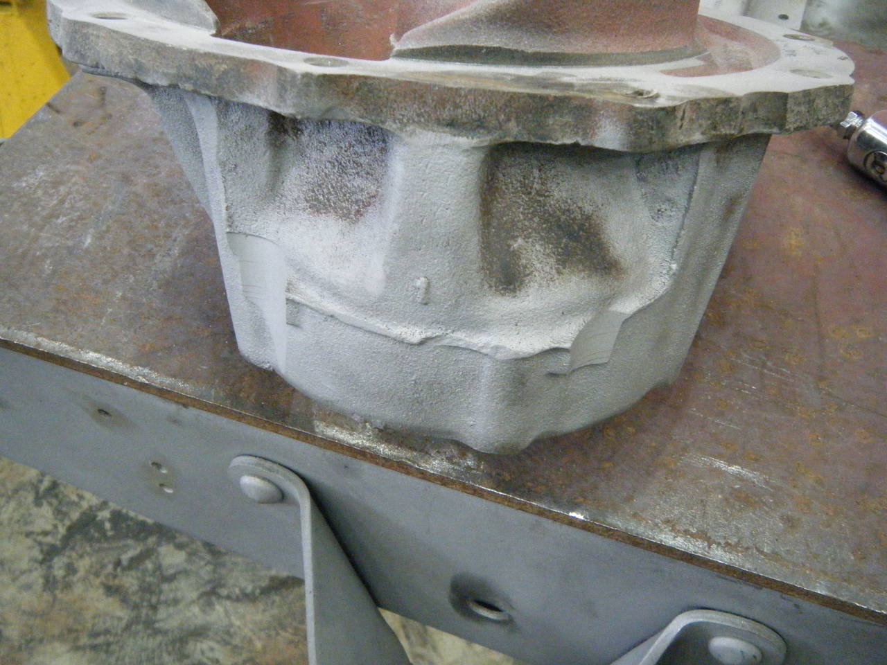

Also cleaned up the jagged castings from inside:
