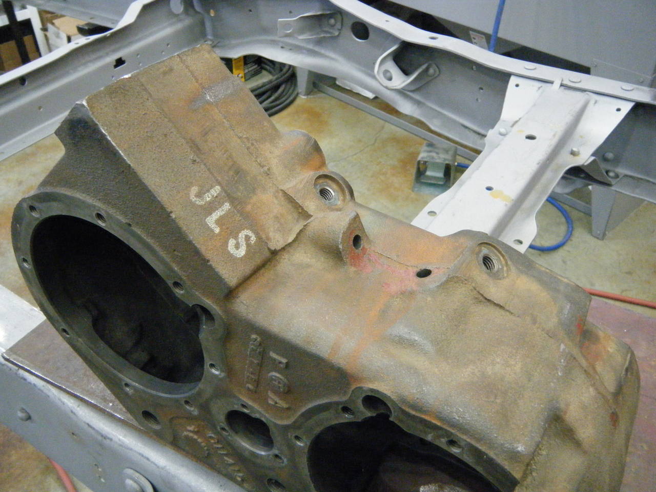

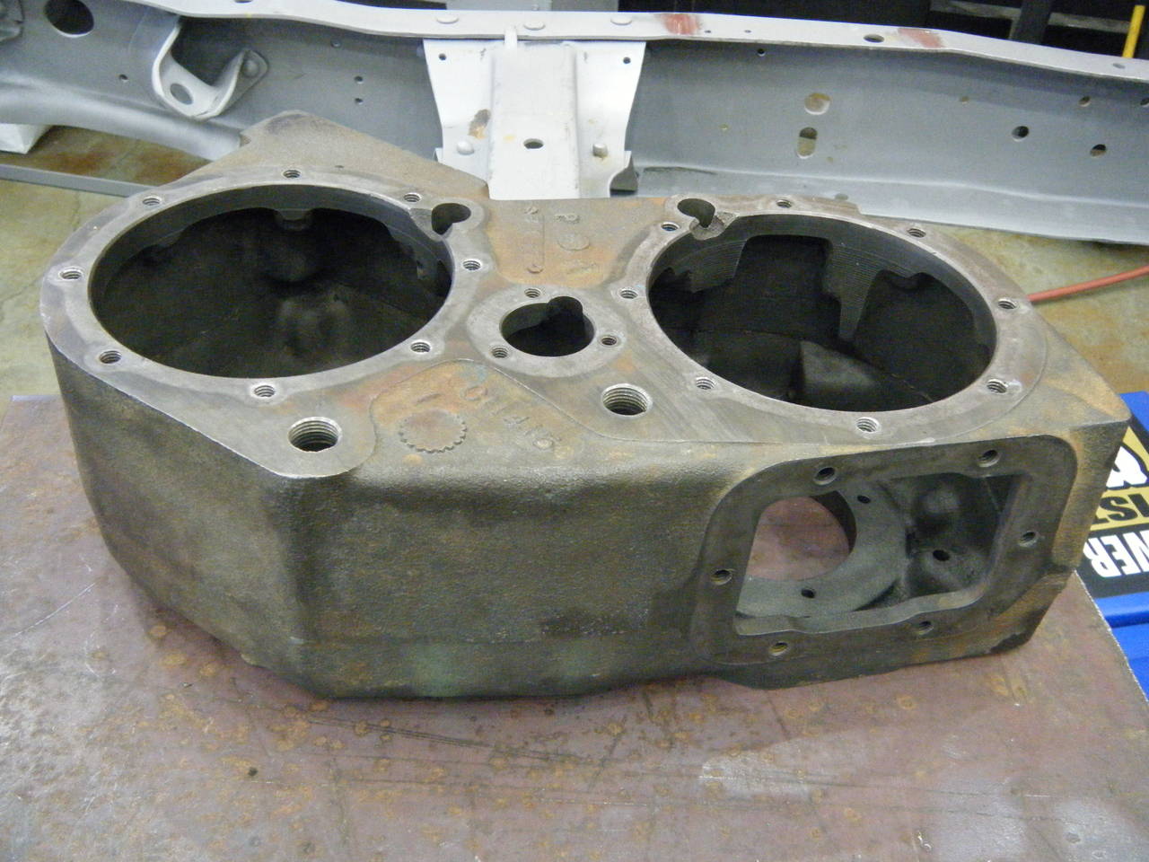

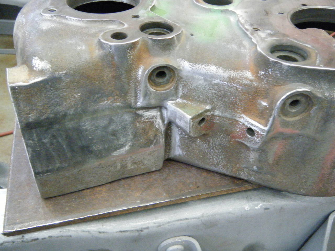

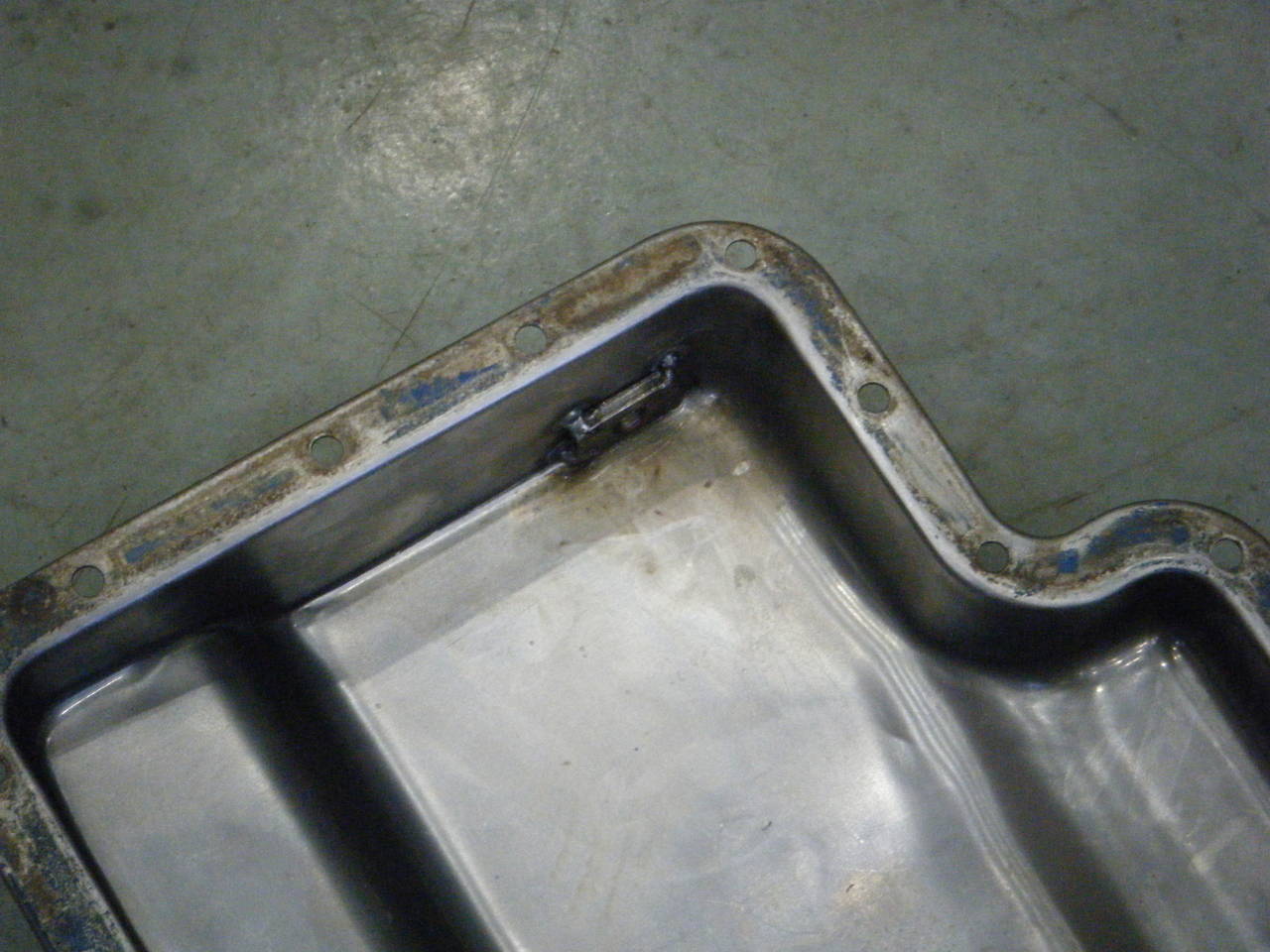

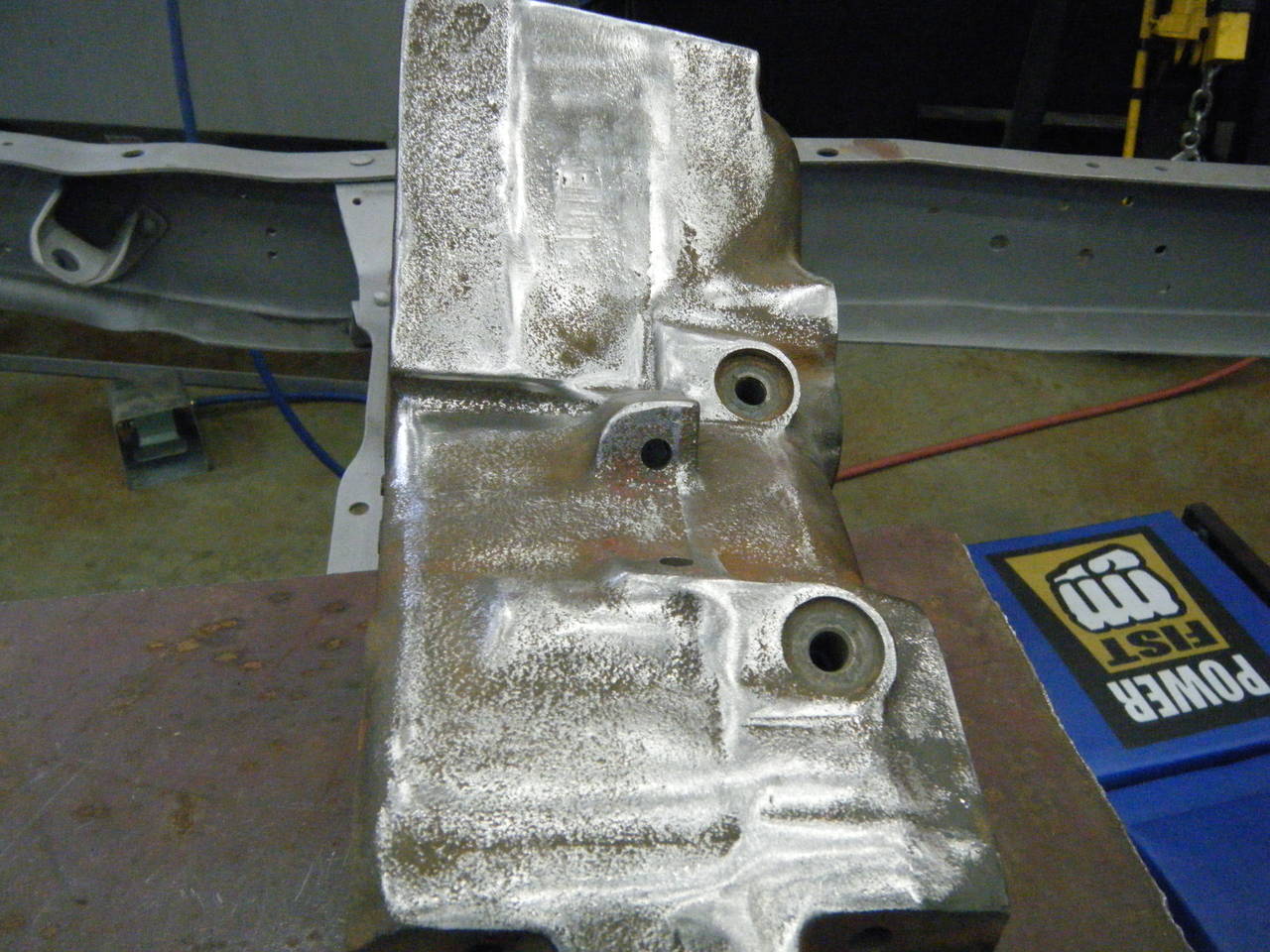

Got the transfer case housing back and started to grind down the casting lines etc. Had a drain plug installed in the transmission pan to make life easier down the road.
Thanks Mark...and I don't know why they didn't either, the aftermarket pans have them!

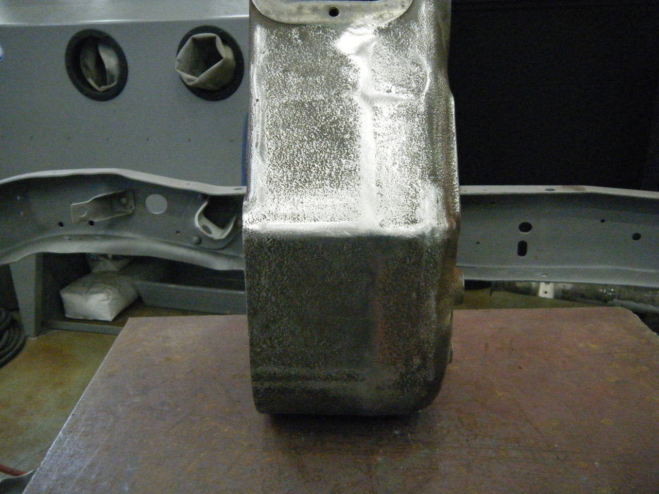

Another day of blasting, grinding etc. Gas tank straps gave me some thinking to do...to get the "t" bolts out a person would have to drill out the spot welds...no big deal but reassembly would be impossible (welding) after powdercoat and bolts/rivets will not work for both clearance and looks...going to go with dry film instead...same as the nuts and bolts.

I can't change a fluid filter through a drain plug hole...:wasntme:

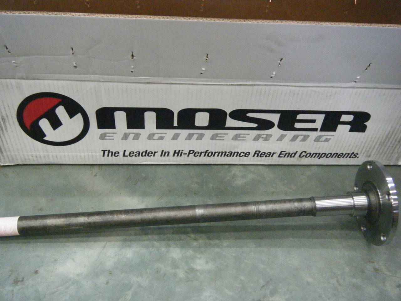

Moser rear shafts (2):

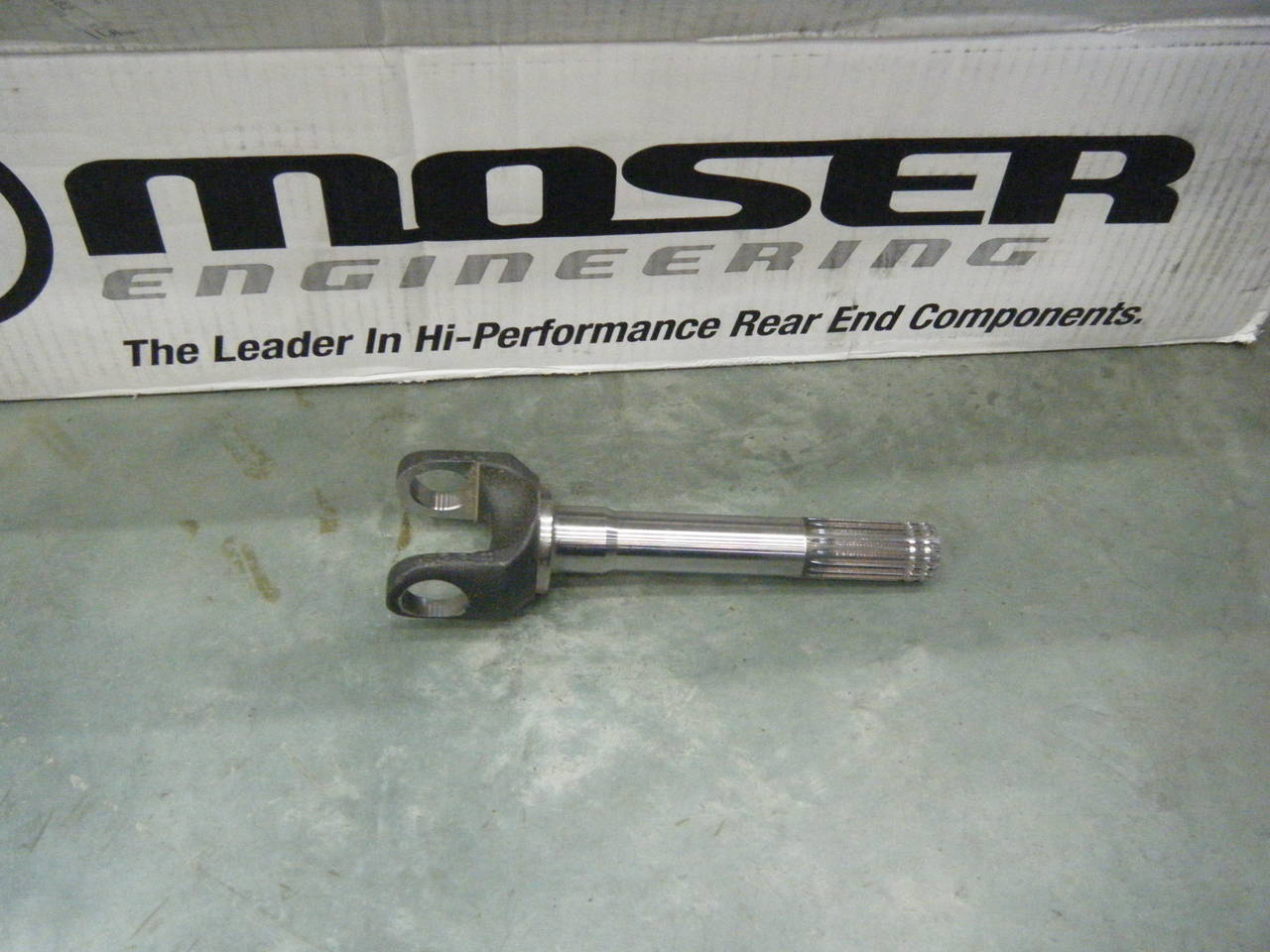

Moser front shafts (4) :

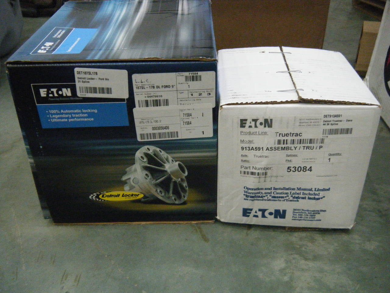

Detroit locker for rear, truetrac for front:
Mmmmmmmm...twins :D

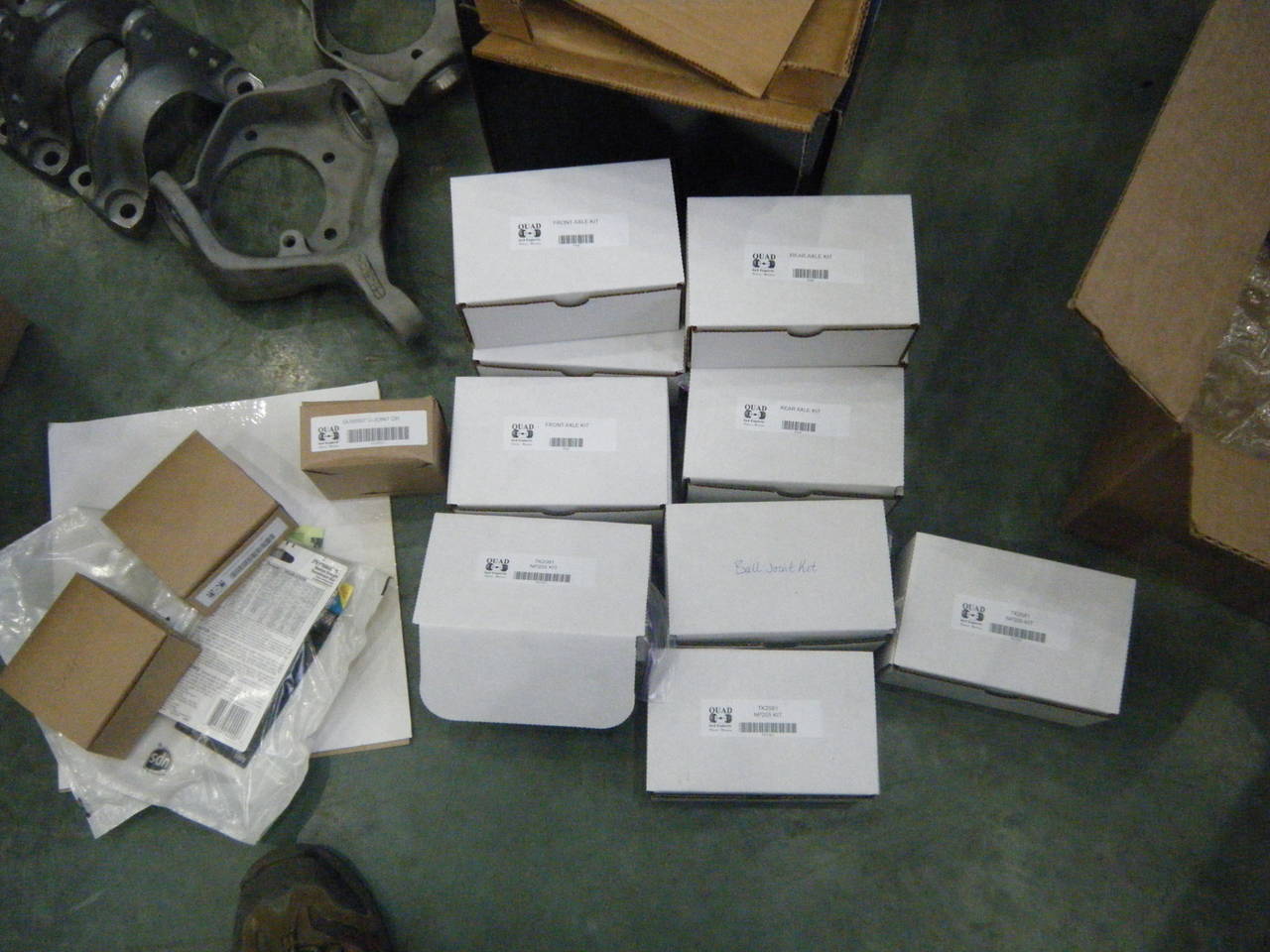

Rear axle, front axle, transfer case, balljoints package:

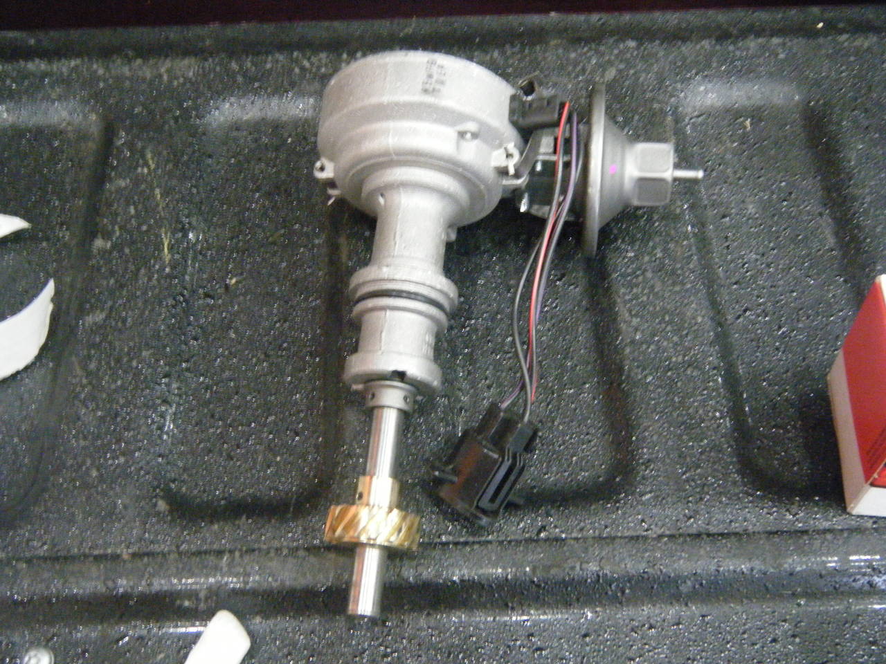

Reman'd distributor with bronze gear..recurved as well, will use an MSD box and the OEM connectors:
