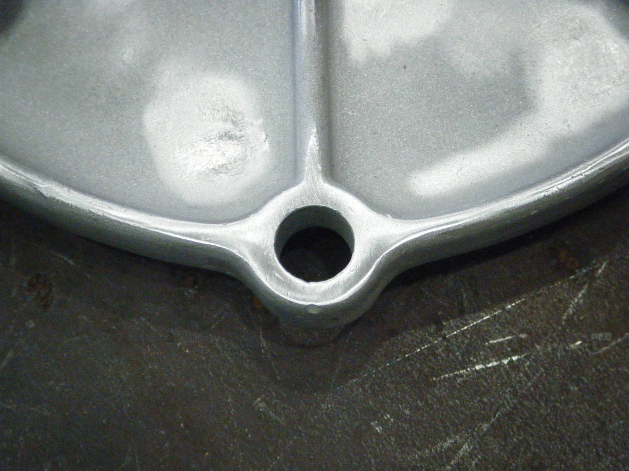

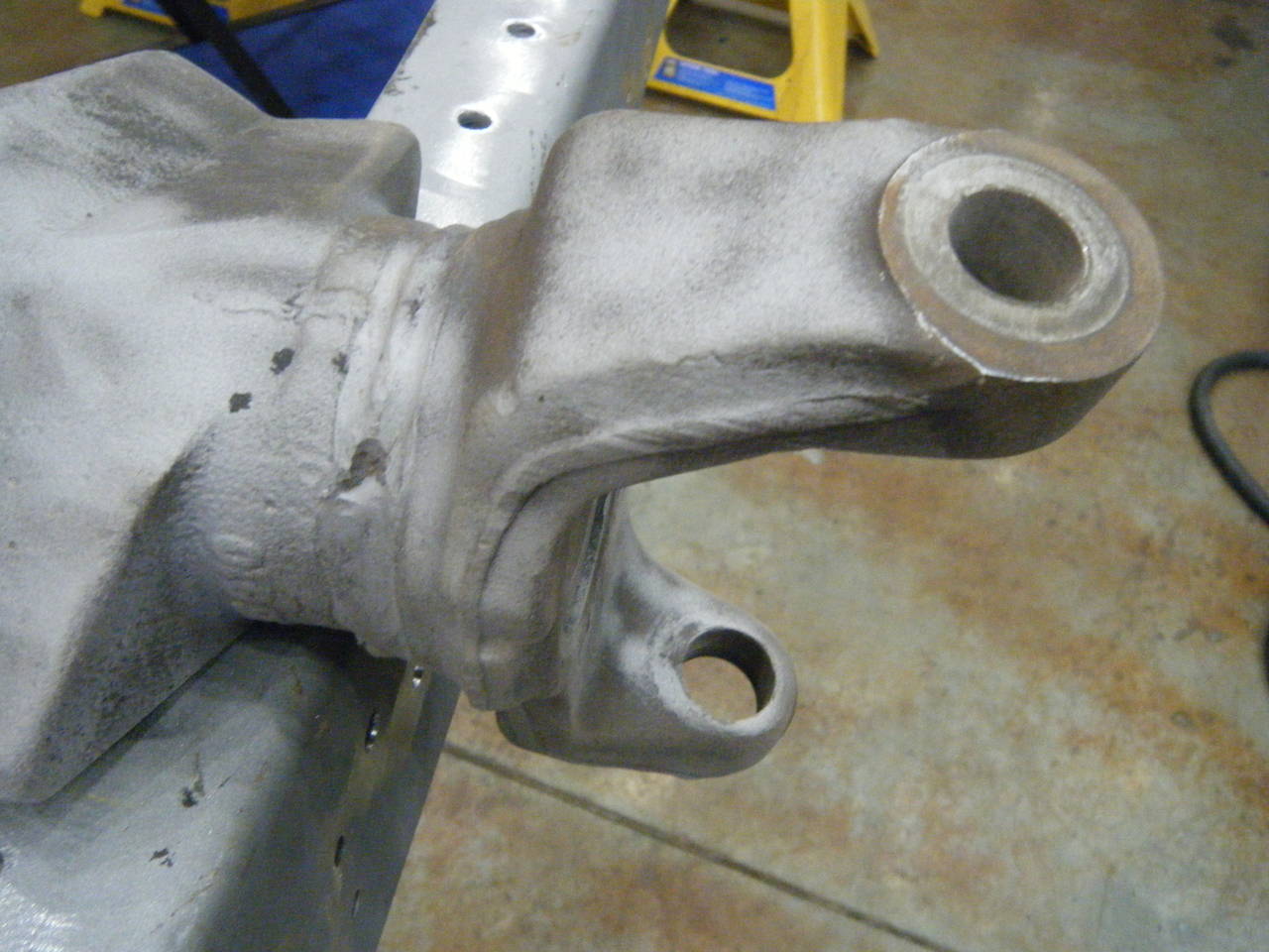

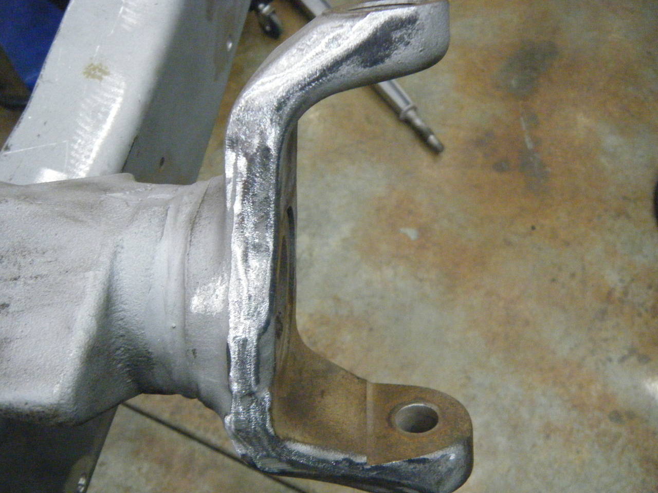

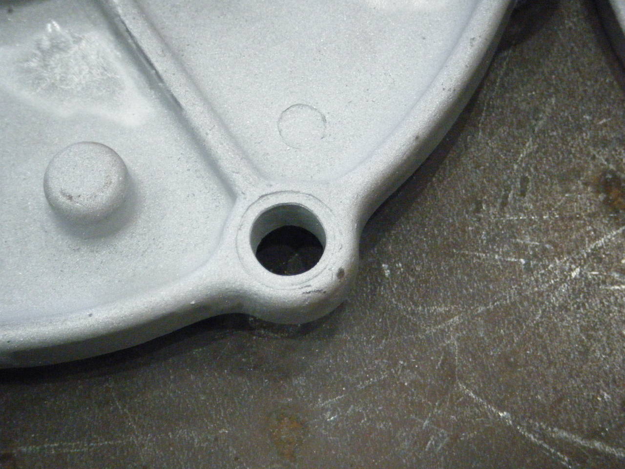

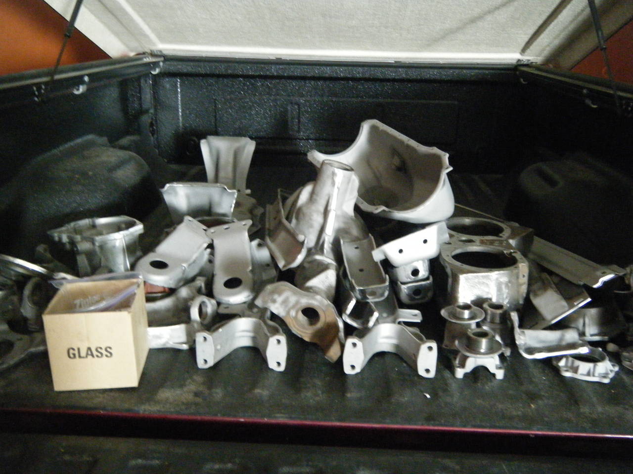

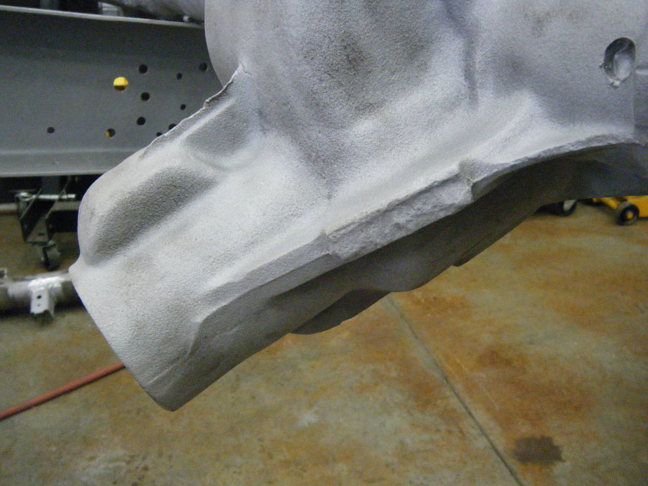

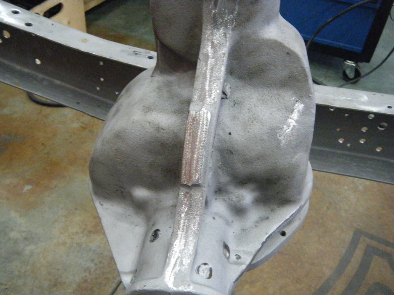

Speaking of grinding..some pics before the first pile of stuff went to be powdercoated. In case anyone is wondering why there are still marks from the grinder....the powdercoat place bakes everything in an oven for several hours to bleed any oil or crap out of the metal, then they sandblast all pieces...so any grinding marks will be erased and I did finish everything with a 50 grit Roloc disk and surface prep pad on the corners.
Only used the surface conditioning pads on any aluminium...got rid of all the previous bolt markings:
First load of stuff, plus other pieces in cab:

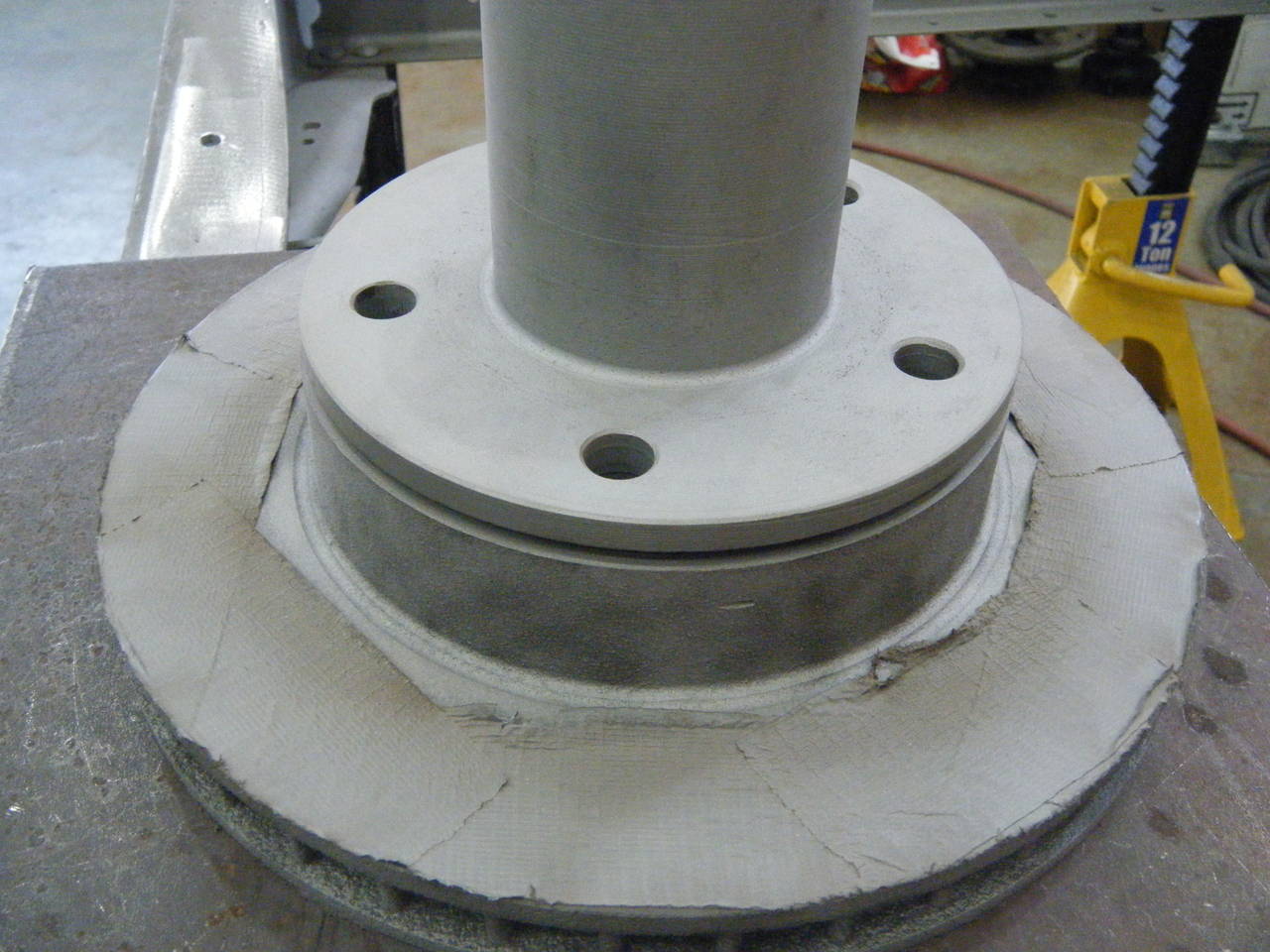

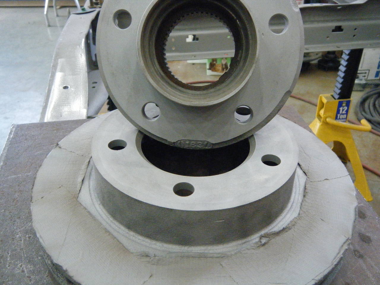

Started on the rotors/hubs/spindle:
Thanks Randy!..sure going through the grinding disks!
I said screw it to the electric grinder and got 2 air units with 1\4'' collets..one 90 deg and one straight..I've found them much, much easier to get into tight spots...also got a 2'' and 3'' Roloc backing disk and by using the 3'' ones on the 2'' backing plate it can flex...same as the conditioning pads. I also picked up a set of rubber expansion drums as well...there have only been a few spots that I couldn't get at and had to use the Dremel.
