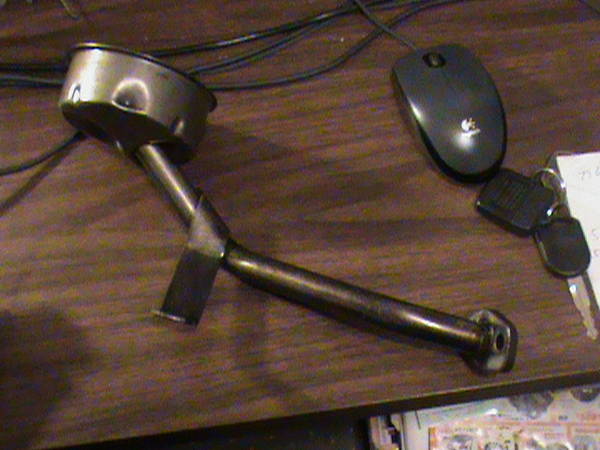

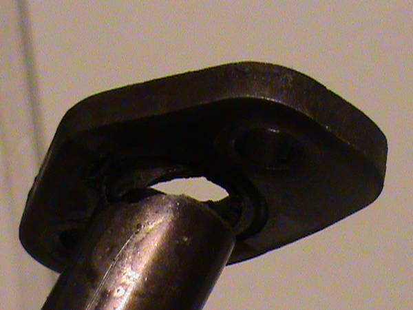

Well as in any build or project there is what is called the "Unexpected" Be ready for it. I just found this while cleaning...Other than metal fatigue/engine vibration..I honestly have no explanation of how this happened....Maybe it IS a good thing i run a high volume oil pump..
That's just to make the oil look like an Aero chocolate bar Bob
:D
Factory option, I'm told....:wasntme:
I agree 100% Chris...and in some cases they can build too much pressure with cold oil and blow seals out.
It always seemed to be the "defacto" standard with hi-perf builds...then an old guy (prolly 50) when I was 17, :D...had a talk with me about them and what he said made sense.
Even Tim Meyer who supplied my 434 stuff stayed with the standard pump, although with a different diptube....and that is 30+ years later.

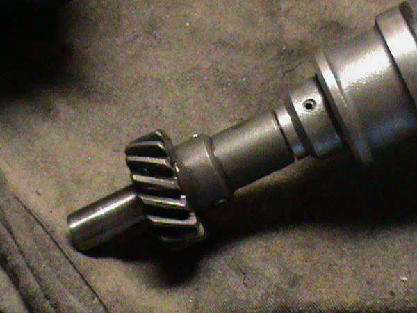

On a Ford with a high volume pump I would insist on an upgraded oil pump drive shaft. They will also put more load on the distributor and drive gear and can contribute to spark scatter. Top speed racers tend to use standard volume pumps because a high volume can suck the pan dry over the course of the run.
Would I worry about it? No. Do I use them? No.
Agreed Justin 100%!! Thank You!! :)

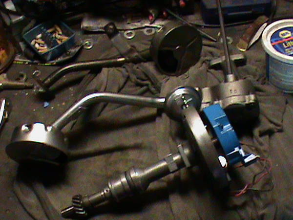

Here we have our Summit Racing High volume oil pump..the Shaft Justin has mentioned is included with the pump..and in this application a 460 HEI Conversion Distributor with the upgraded distributor gear!

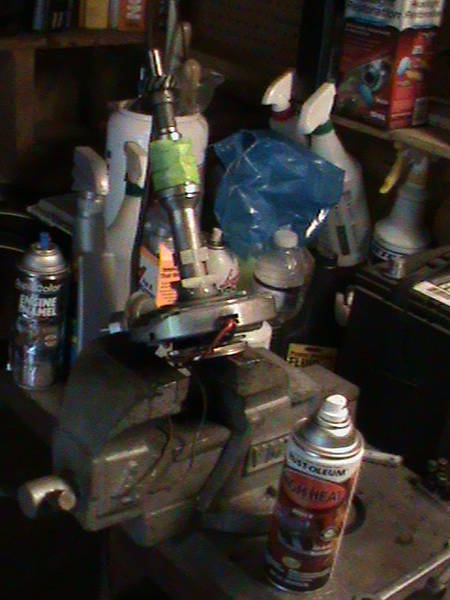

Next ive applied several coats of high heat clear to the distributors casting above the block surface..Im hoping this will resolve pitting of the repolished casting..for this truck does sit under a car port exposed to climate conditons...something i hadnt thought of in my initial installation...Sorry Austin! :)

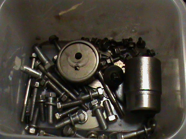

were in the final process of component cleaning it does take time and is very tedious...
Front cover,oil pan bolts cam assesories,crank spacer

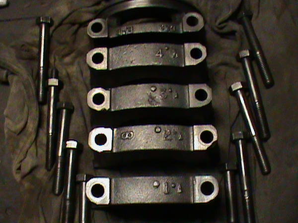

We finished up our Main caps / Bolts..Now we can see those numbers / Arrows clearly!!
Hey Bob, just a thought and maybe some others can comment, but as you know, there is a lot of chrome in my engine bay and what I do to keep it from pitting from condensation and such during the WINTER months only (my rig is in an enclosed garage, but it isn't climate controlled - we're working on building a nice two bay garage for this truck and the next rig we find for baby #2 and that one will have the lifts and heat throughout the winter and such), is apply some regular car wax to those places, even the chrome wheels. I don't wipe it off of course until it's time for it's first detail of the summer. I just put a thick coat of regular car wax on all those chrome places and the wax actually repels any condensation or liquid. Wipe it down in the spring and it's as good as new.
