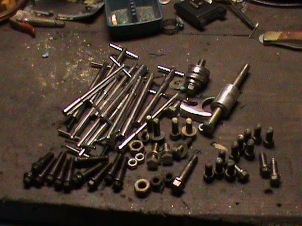

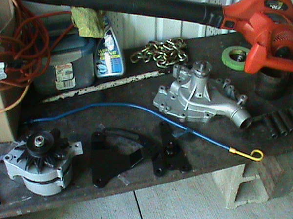

Ok Finished up buffing cleaning the Top end bolts and the header bolts as well they were pretty rusty...we will treat those with the Header paint as well...

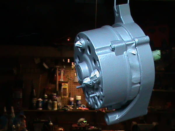

We also re detailed our Alternator then painted it with the heat aluminum look followed by 5 coats of heat clear...this time my OCD Is working overtime!
Next weve addresssed our alternator brackets,th dip stick tube,Painted and cleared our new Water Pump....Chris, I was thinking of you as far as my old one goes...so i decided now would be the time to change that.
OCD!!! That's what I'm talking about!!! I do the same, but with numbers....it's part of what makes you good at what you do (IMO).

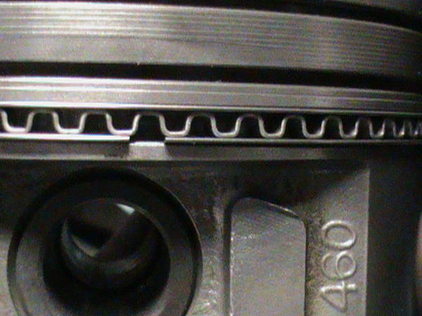

Rings...in standard size..remember we did NOT Bore the cylinders...Overbores require "Oversize Rings" Pending on the cylinder size bore..im not going to get into all that here.
First 'ALWAYS" read the instructions...I dont care how many times you may have done this..There are different proceedures for different types of rings...THIS IS ALSO A CRITICAL AREA...YOU WANT IT RIGHT THE FIRST TIME!

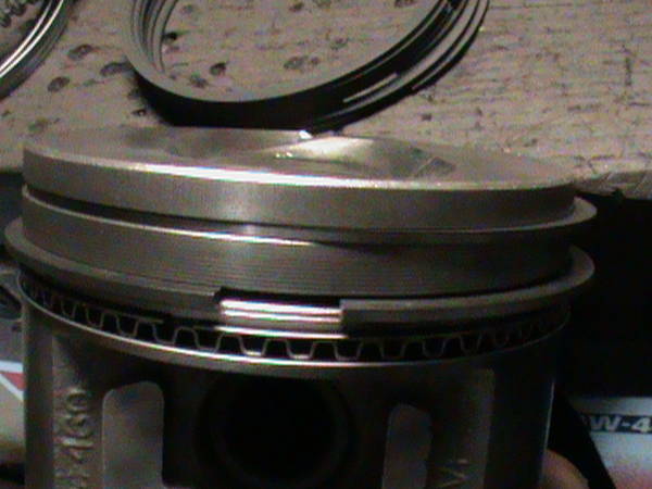

Notice the top pics on the left of the instruction sheet...our rings have a "chamfer" in them...there is also a "Dot" stamped in the rings...Top ring the chamfer goes twards the top of the piston indicated by the Dot on the top side of the ring....Secondary rings..the chamfer goes twards the bottom..indicated by the dot on the "top" side of the ring.

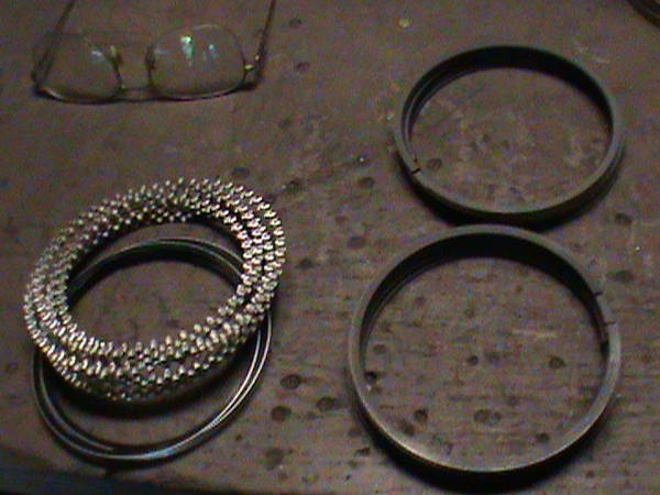

Here ive identified and seperated the rings in groups...to the left our oil control rings and expanders...Top set of compression rings at the top...secondary set below

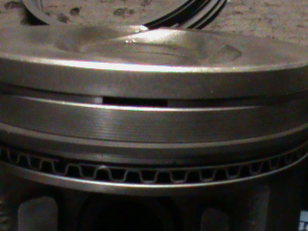

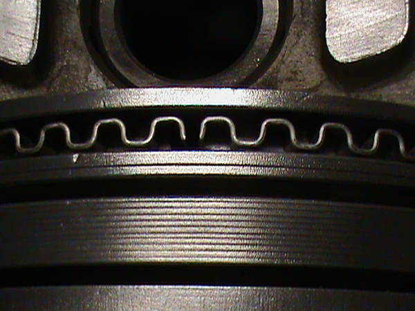

Now our instructions indicate starting with the oil control set first....First we install the expander.....you will notice a gap in the expander...these gaps will meet end to end upon ring installation ive installed the expander gap at the 6 oclock positon.....
Next we installed the top ring at the 9 oclock positon...followed by the bottom ring at the 3 oclock positon..this is called "ring stagger" it is very critical for proper ring sealing
Now for those compression rings...I do recommend use of a ring expanding tool for amature builders....these rings can break very easily...without it. I will install the rings in the same manor of the oil control..gaps at oppositte ends of each other...with the dots to the top of the piston...Are you getting all of this?.......

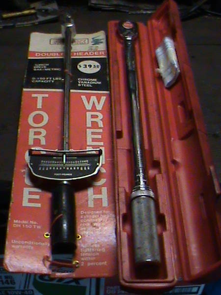

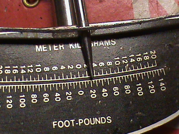

Torque wrench 101....Here we have on the left the "Beam" Type torque wrench...on the right a " Snap On" Click type..Both will work...But "I" prefer the click type in engine building for it is the most acurate imo.
Now the Beam type is read in either metric or ft pounds...when force is applied to the handle the needle will move to the desired reading indicated on the scale.....
here ive applied some leverage to the wrench handle to the 20ft pound reading indicated by the needle...remember when torquing a bolt use the two hand method...one hand on the head of the wrench to avoid slippage..the other on the handle...use slow and a steady push or pull motion with no binding of the unit...binding will give a false reading..so will the use of extensions..keep the wrench as close to the bolt as possible for an accurate torque reading.

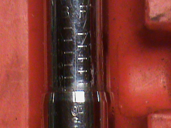

The click type torque wrench here is read in Ft pounds only....by unlocking the handle,turning the handle to the desied specific reading desired then relocking the handle...when applied force reaches the desired ft pounds set..it will give a clicking indication of that desired reading...any further action after the clicking will be an over torque situation..same rule applies two hand method slow steady pulls or pushes( my self i do prefer to pull on the wrench handle...than push it)Keep the wrench as close as possible to the bolt being torqued...

Nice post again Bob..I prefer the click type personally.

Thank you Duncan!! Me as well...Ive kept the beam around for some time now as a backup..... as you can probably tell ive never used it all these yrs..lol

I prefer click type between the two.. But I still overall prefer a digital that beeps.. For the fact you can easily change the measurement it's reading and also is easily recalibrated..

Just to add, DO NOT use your torque wrenches as breaker bars, and DO NOT store your click type wrenches with tension on them.
