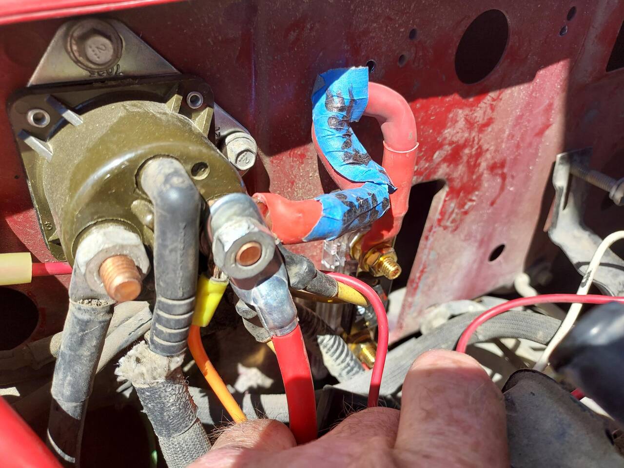

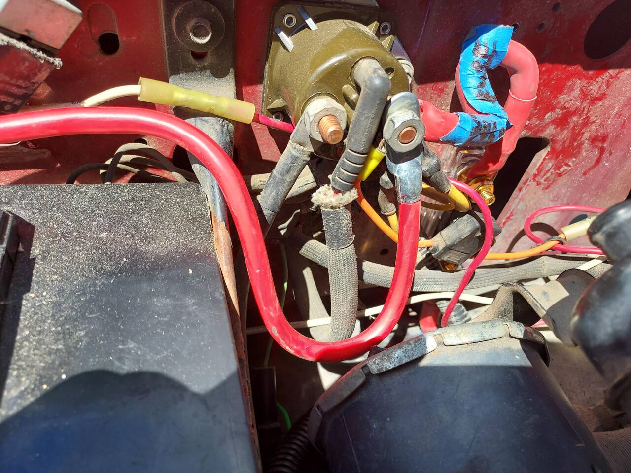

Did this upgrade today. Everything went okay. I thought I would mount the breaker horizontal to avoid hitting the jack, then realized the hood hinge would hit the breaker. :headbang: Started the truck and the alternator is charging the battery at 14.3 - 14.5 volts. Thanks to Charlie(dustybumpers) for all the help and supplies. This would not have been possible without you!

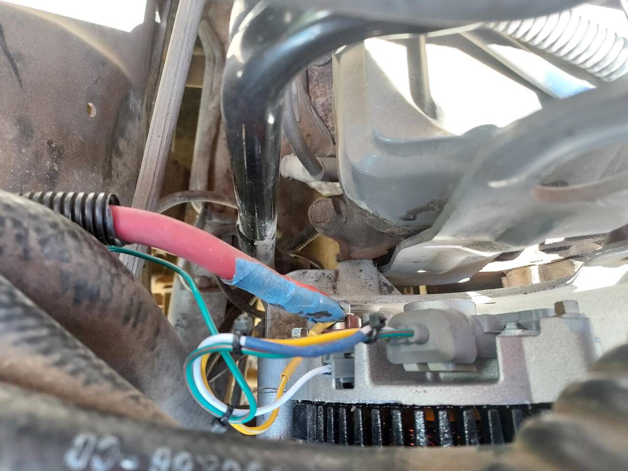

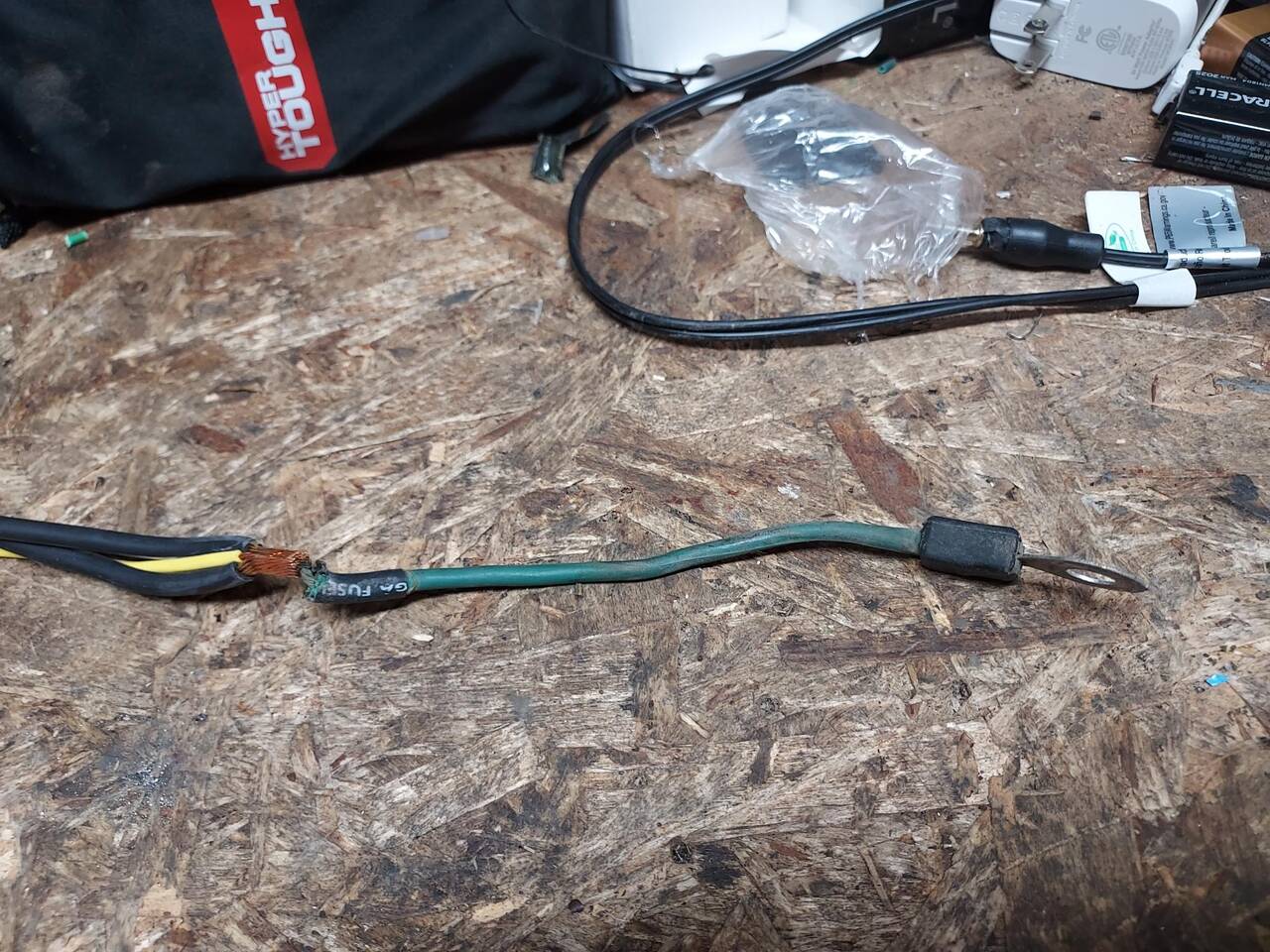

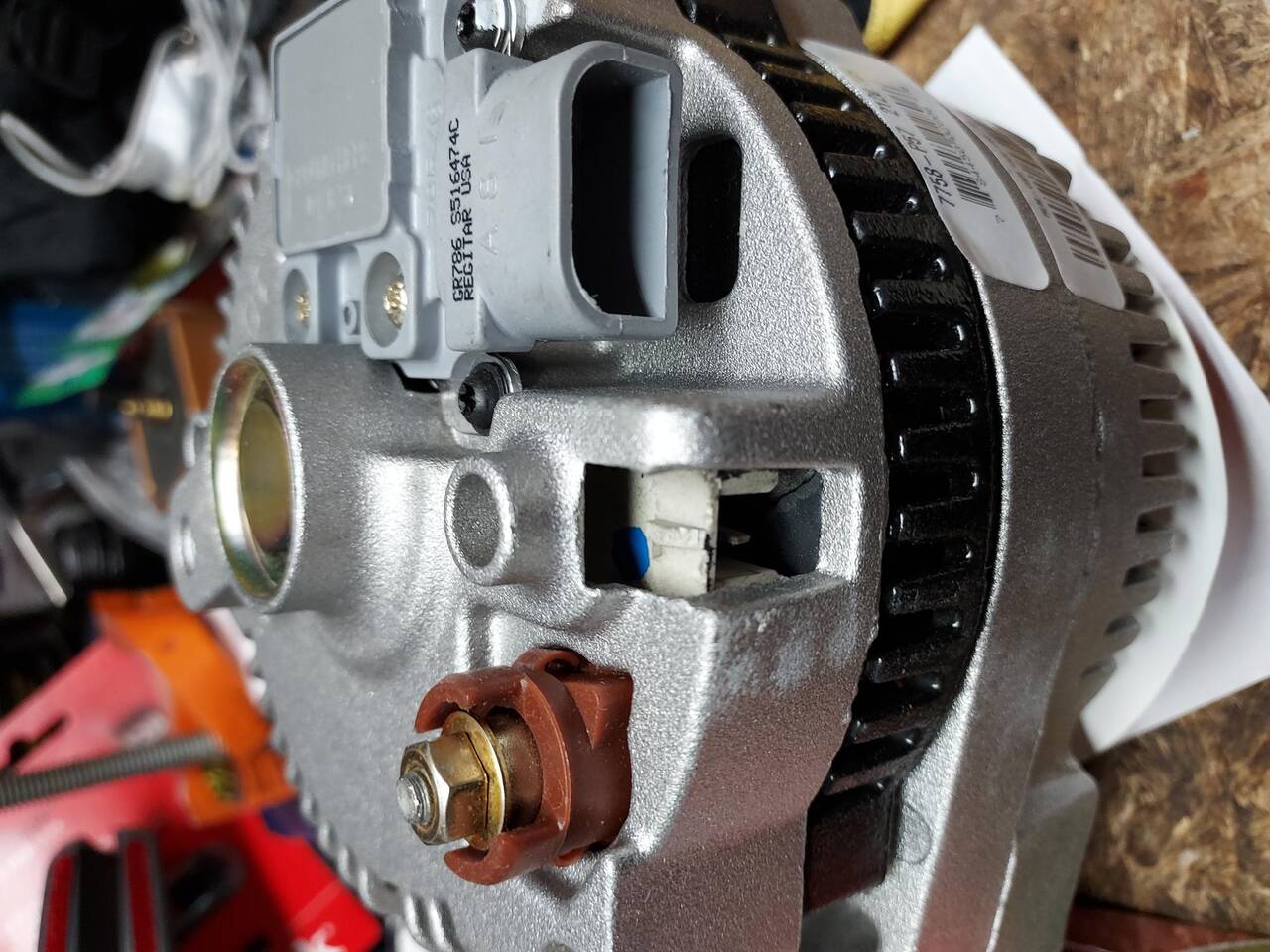

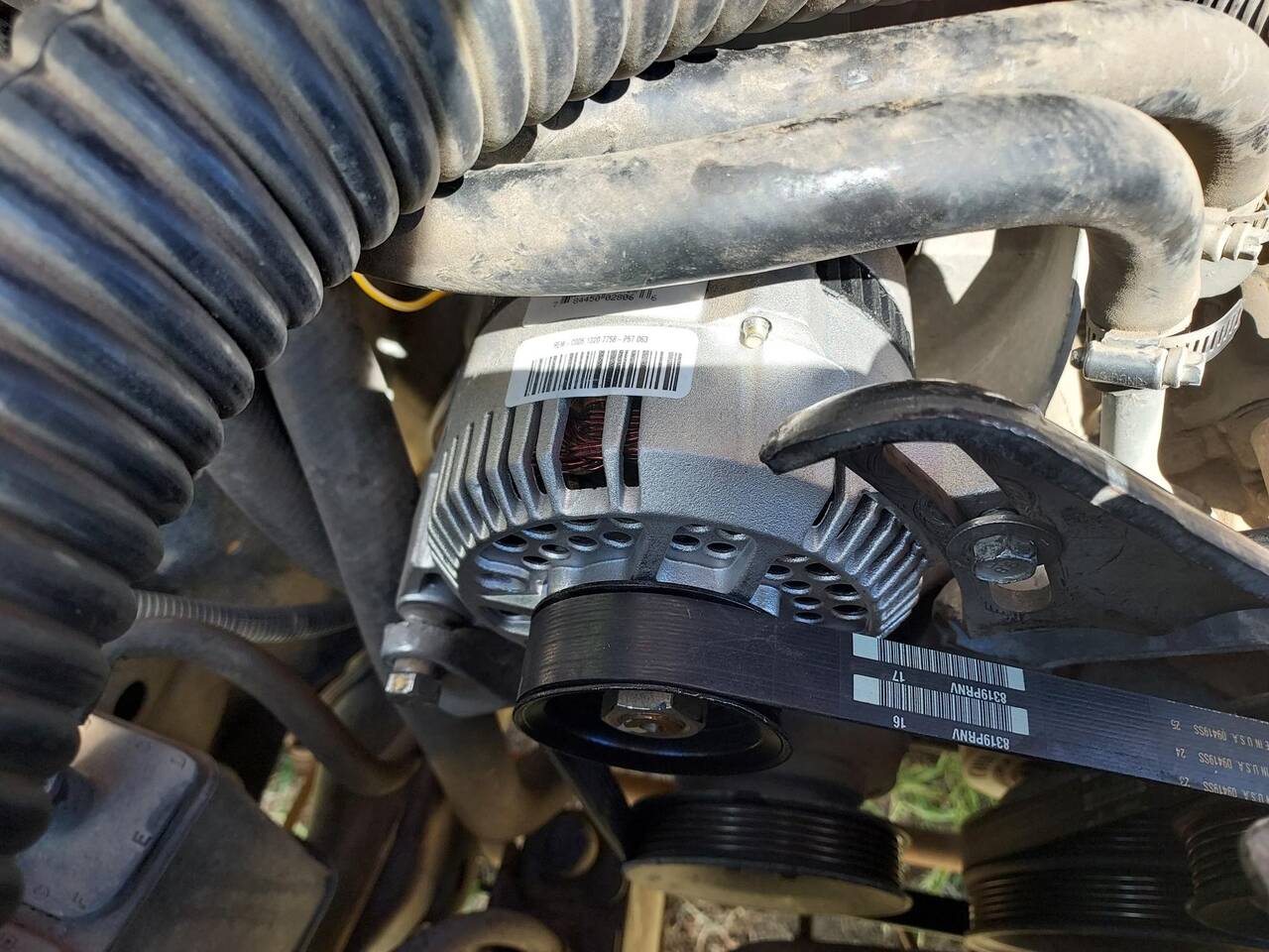

Okay, not the best, but here they are.
I can see why there was a potential fire hazard, based on the wiring configuration, 2 12ga and 1 14ga wire combined into a 14 Ga. The end wire also looks pretty corroded also. When it's all said and done, I ended up with a 95 amp alternator protected by a 150 amp fuse. Once again, credit goes to Charlie.

Also, the reason for the 150 amp fuse is to be able to handle spikes. You hit compressor kicking in same time as you pull the headlights on and turn the heat motor to high all at once, she needs to have more than a 95 amp fuse. My one plow truck has a 275 amp fuse on it
Makes sense. I'm reading a margin of error at least 30 amps.
