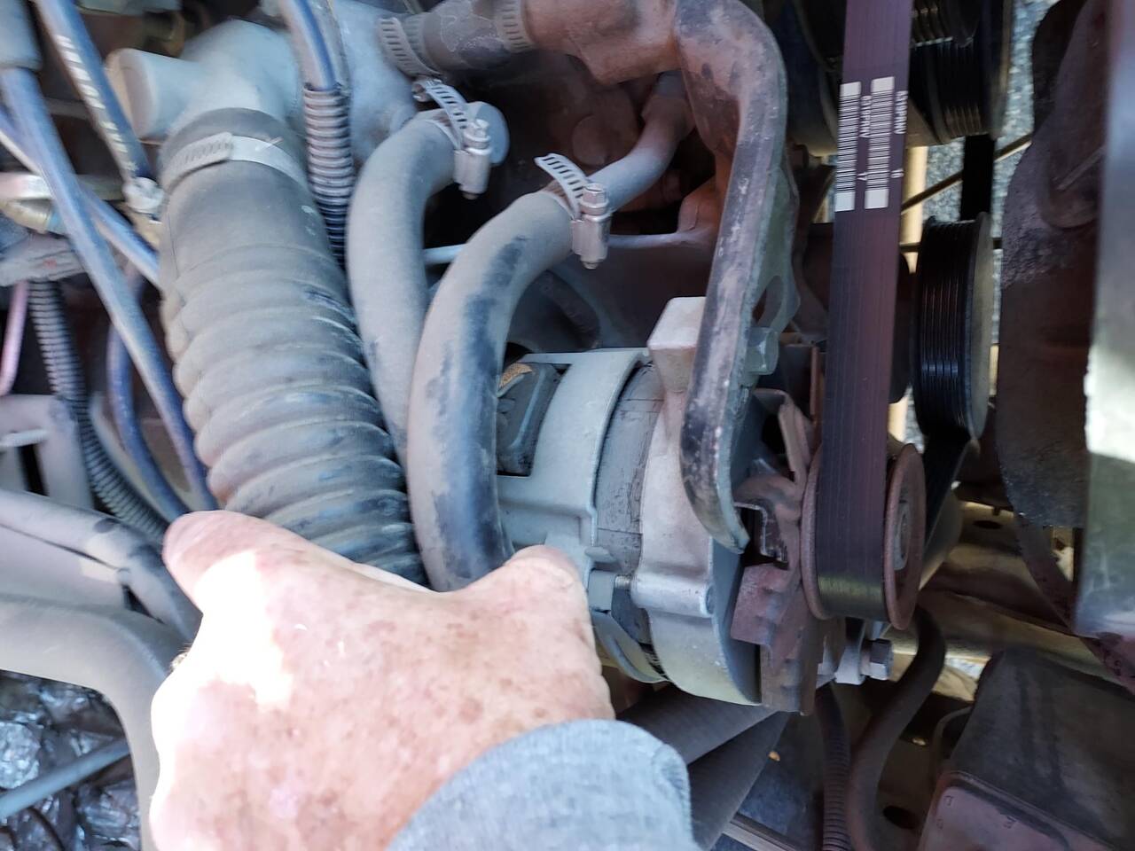

Thank you, Charlie. The heater hoses are in the way of getting a decent picture. I gave some misinformation. There are two plugs on the alt. One with 3 wires at 1:00 position in middle of alternator, and one plug at 3:00 -4:00 position on the side with 2 wires. If it's not too hot tomorrow, I'll pull the alt and grab some pics, both before pulling and after pulling. The sad part is, I just replaced the starter last year. I think it has 500 miles on it.

Here is a half-assed picture of alternator, located on passenger side.

Ok, so looks like it's top and bottom mount. 180*.
Can you get a measurement or aproxament one from bottom bolt to top bolt? I'll take some pictures tomorrow of what I'm speaking.
Then I'll get you a parts list together. Can you solder an end on a wire?
Looks like my choices of alternator size are 7" or 8.25", center of bolt to center of bolt. The one I have is 7".
