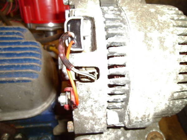

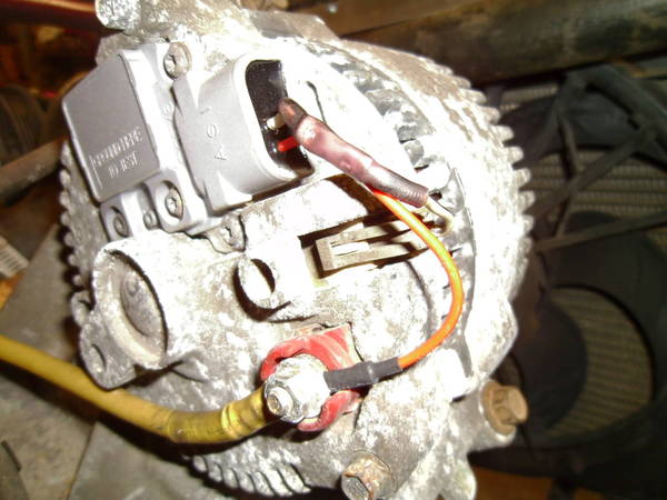

Just for the heck of it, pics of the 3G wiring on my buggy that has a self exciting regulator on it. Pretty much the same except no green/red wire.
The single wire plug would`ve come with the regulator, but one of the local used car dealers need that terminal end bad and didn`t want to go to the junkyard to get it. My rebuilder sold it to them for the price of the regulator, then gave it to me for the buggy.

Gren/red wire is the key. Sole purpose is to turn on off charge. In a pickup in needs to be there, or it will kill the battery, and eventually fry the diodes.
In your buggy, you probably have a different ignition control setup.

And correct on the green wire. With the normal truck setup it turns on via the key/battery light in the cluster, with the self exciting regulator on the buggy it`s RPM controlled, same way as the so called GM 1 wire units.
Buggy has an on/off switch for the ignition, and a push button for the starter.
I popped the hood the hood on Big Blue to take a pic of his 3G conversion, but the way it`s clocked you couldn`t see anything. Buggy was the best I could do on short notice.
