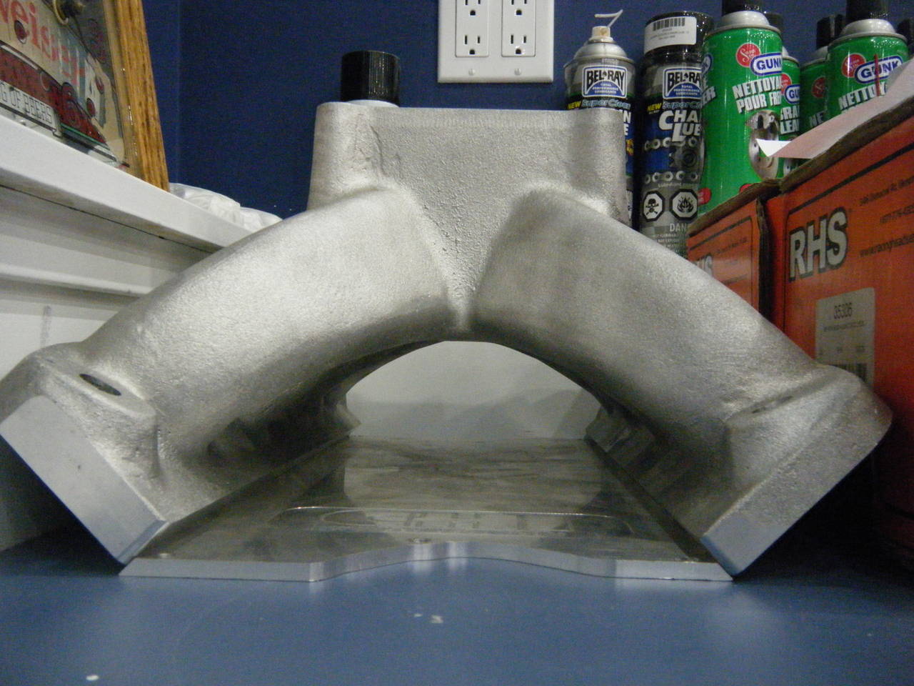

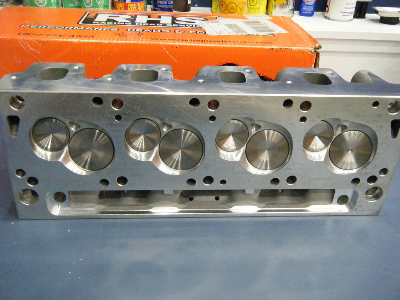

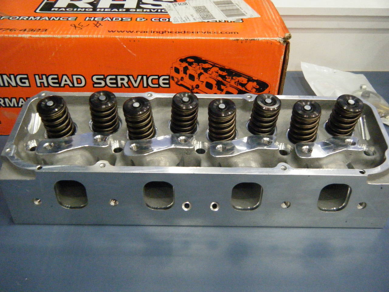

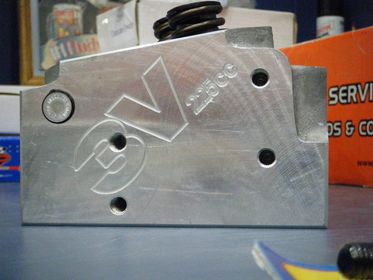

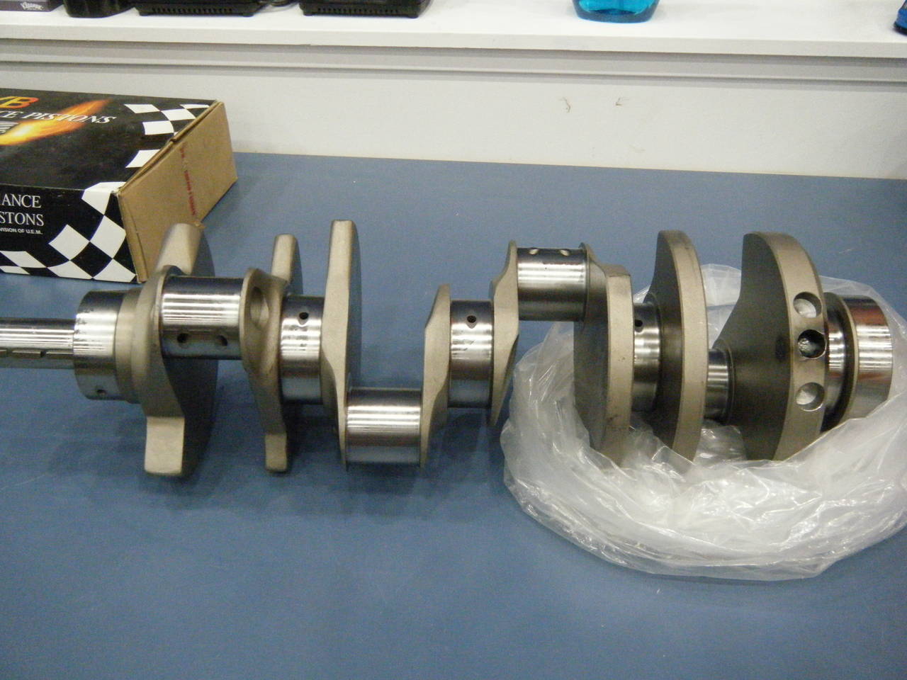

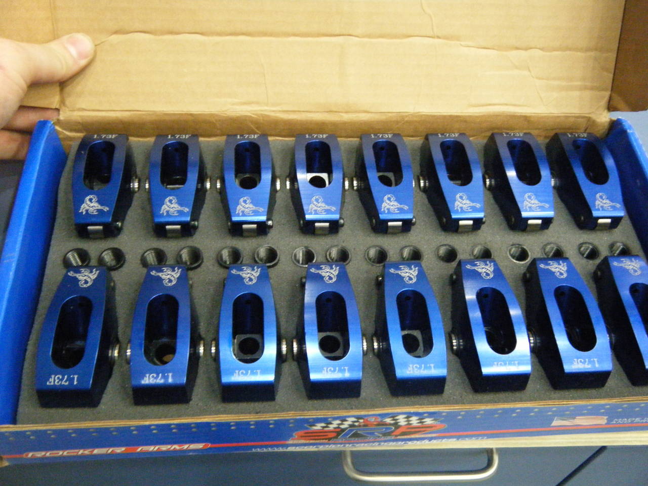

I never really did post much in this thread..so here we go :D
TMI 4.25'' Crank
Final Static CR is 11.44:1
CHI 3V heads
CHI Intake

Scorpion roller rockers

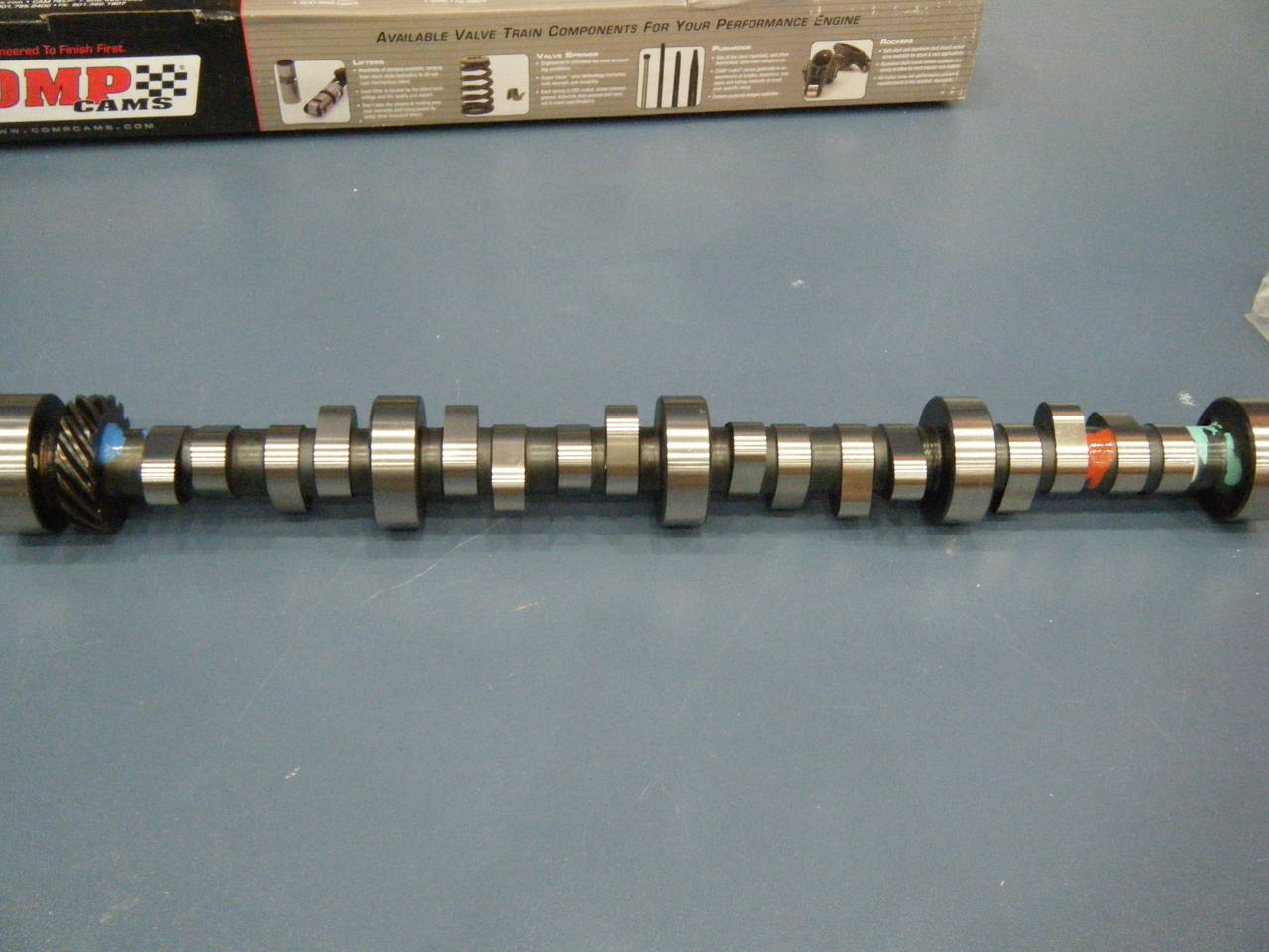

Comp Cams roller cam, custom grind. .602/.612 lift, 224/[email protected]

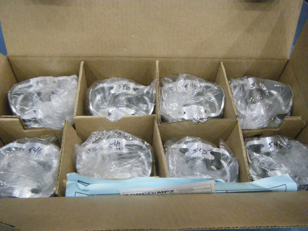

KB Forged pistons

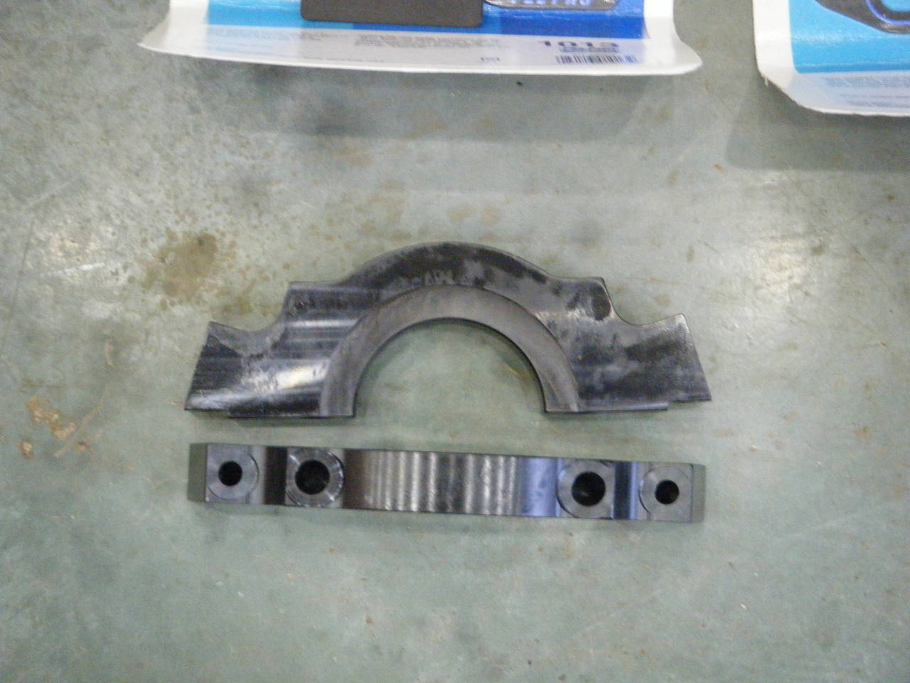

4 Bolt caps
