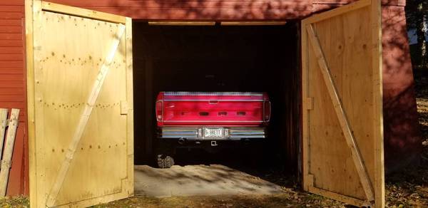

Messed up on the pictures.....here is the final one as I close the doors that will soon have 3-4 ft of snow up against them if not more!
