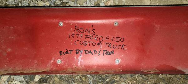

Found this when taking off the bumper that came with the truck when we bought it 12 years ago:
Contacted the original owner/builder, which was a father/son build over 8 years (and the amount of detail in our 77 really shows it!) and asked if they wanted me to either send the entire bumper to them to save or cut that piece out and send it. He was SUPER grateful for my offer but told me to keep it and hang it in my garage or man cave, so that's where it's going.
That's a piece of history, Ken.
How cool is that! YelloThumbUp
Super cool for sure Roy!
It really is Doug....super blessed to hang that in my garage. Whatever happens to the truck in the future, it'll stay with it.
Not sure if anyone remembers, but this Father/Son build took 8 years and the reason they got rid of something so sentimental was because it wasn't being used; they felt all their hard work and labor shouldn't just sit and rot away.
When my wife and I pulled out of his driveway 12 years ago, he was weeping. His son was holding on the phone until we were gone to get the final word that the truck in fact had left his possession.
Be hard for me as a dad to let something like that go, but I get it too!

I know having that part of the story sure allows you and your boys to appreciate the truck even more.
