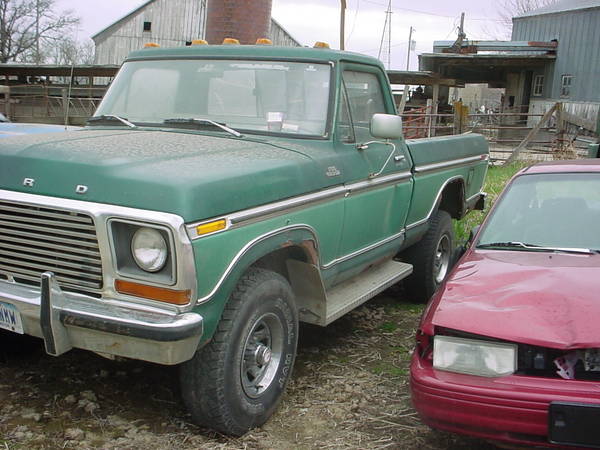

That's the same rims I have on the 78.

I like the cab lights on your truck.
I haven't decided if i want to install them on mine or not.
I have a LMC truck magazine handy if i ever decide i do.
