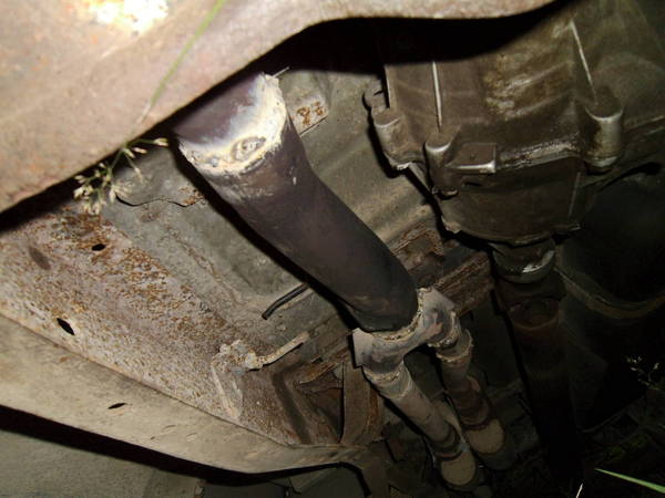

No. I built a custom conbobulation of fawktardery smiliegitrdone out of stuff I had. I used the Hedman y and extension it came with, cut the factory y off the 460 exhaust (junkyard gave me the factory stuff as far as the cat), welded those together, split into dual 2 1/4" pipes, dual Flowmaster one chambers, and 3" tailpipes that exit behind each rear tire. Dummy duals for the most part. But it sounds pretty good. I like it a lot.
This is a pic from my gallery that kind of shows it.
