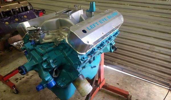

Project Cheap Bastard: LEB 70 460
^^^Oh...and a cameo appearance from some Chris Carter Amserl
Cool beans Ben!
Oh...she bad...
And these should fit nicely...
The one to the left is actually purple...and will be a 14.7:1 end result.

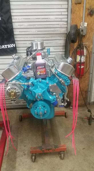

Time to do some priming...with a guest appearance from Chris Carter's amserl...
She a bad bish...

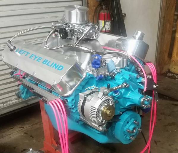

That's a cool alternator set up,never seen it done that way!...:)
That's the LEB mid-mount for the 3G...other side has Saginaw brackets.
