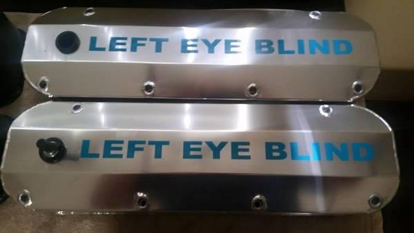

Heads are the only hold up right now. Beyond that everything should be ready for assembly. Beyond that, probably gonna opt for a rear sump pan. I'm getting some top secret valve covers built. And Kris would be a lot happier/convincing me to go with a set of Mad Dog headers. While I agree...I have cheap bastard problems.

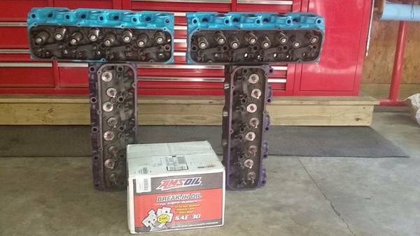

Sorry to keep you guys hanging. Project is coming along as planned. Machine shop was more backed up than anticipated. Heads should be done this week. I did stick with the d0ves and the custom cam grind will bleed off the compression to give it the manners I want, while retaining the power I want. Heads are a simple valve job and some light port work. Once Kris has the heads, final assembly can take place.

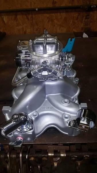

Decided not to go with stock manis and I'll be going with Mad Dogs...so splurging a little there. Decided to go rear sump pan as well. Front sump will clear with my lift, but felt it would just look unfinished. Beyond that, only other thing I should have to buy is the stall converter. So we're coming down the home stretch.
It should end up being in the 10.5:1 range. Certainly didn't want any more to do what I wanted. It was enough of a headache trying to get it to run on pump gas. Hindsight being 20/20...D3 heads woulda been fine with some work and dropped me to the 9.6-9.8:1 range. Coulda gone much more aggressive on the cam, wouldn't need a stall and would be a lot happier at the pump. And woulda left the option of flat tops on the table some time down the road.

The end is drawing near...heads are done.
