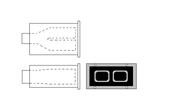

Doc I'd like to do it to my truck (although I probably won't if it involves fabrication). What kind of details can you give me about how to go about doing it?
He facbricated his. There is a kit that you can buy. It is stainless. You cut a hole in the body (draw around the part and cut) and mount it. Then have a shop run the pipes over.
Go to stylin concepts website and type in exhaust in the search. They have several different ones $$$$ (but it is ideas)
I will pm you some drawings. the only thing that is difficult is getting the exhaust hooked up. I have a 3" body lift and we are running the exhaust over the frame between the bed. I just so happen to have a cross member there to run the pipes over the gas tank.

the dimensions are totally up to you but i used borla dual tips so that kinda helped set mine.
here is a rough scetch

my exhaust is welded to the box but then I have flex hooked to the tips to let the body move a little!

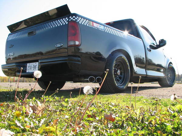

WELL.....See if this works!!!!
Looks like it didn't and I will try again!!!
Sharp lookin' truck Nascar. Any big engine upgrades from the factory with that Nascar package?
Sorry to say no enigine updates and its normal 4.6 Triton motor. This truck was mainly appearance package with decals and embroidered NASCAR headrest and on the carpet floor mats. I would to do some engines mods in the future BUT just not what....YET!!!!!
Don't forget about the upgraded window sticker. :rofl:
I LOVE that truck!!
