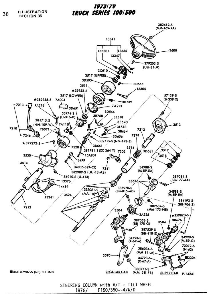

Haven't forgot about the column pics Doug...here is the exploded diagram:
Thank You very much, Duncan. I'll blow that up at work tonight on our blueprint screen.
I'm not seeing much information in the manual about that part of the column.
There isn't much in the 79 manual either...makes me look forward to working on it...hehehehe.

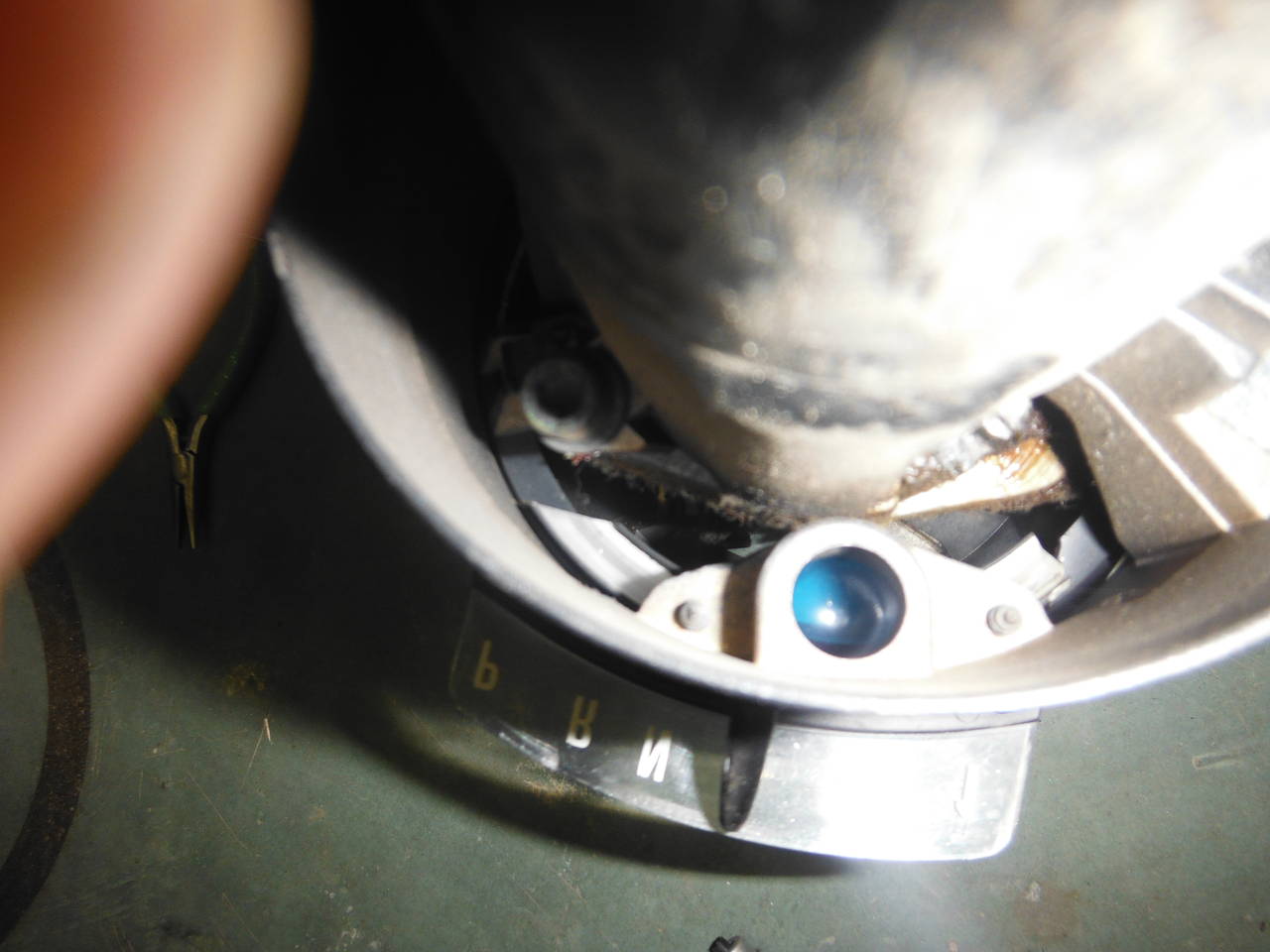

It would seem that there is a blue color shield that is probably eating up a good amount of light...so it might help to order a blue LED....the color shield will block all but blue light..just a thought.
I will try to get to disassembly of it over the next few days.
I thought these screws ran down to the bulb housing, but they don't
I had no idea that blue filter was in there. Guess you can't see it when it is mounted. That is very helpful. Can you see how that filter is attached in the end of the tunnel? Would it be possible to remove it or drill it out, although I don't know how I could get a drill and bit up in there.
I don't know...my plan is to disassemble the column while I'm off...I will post what I find.

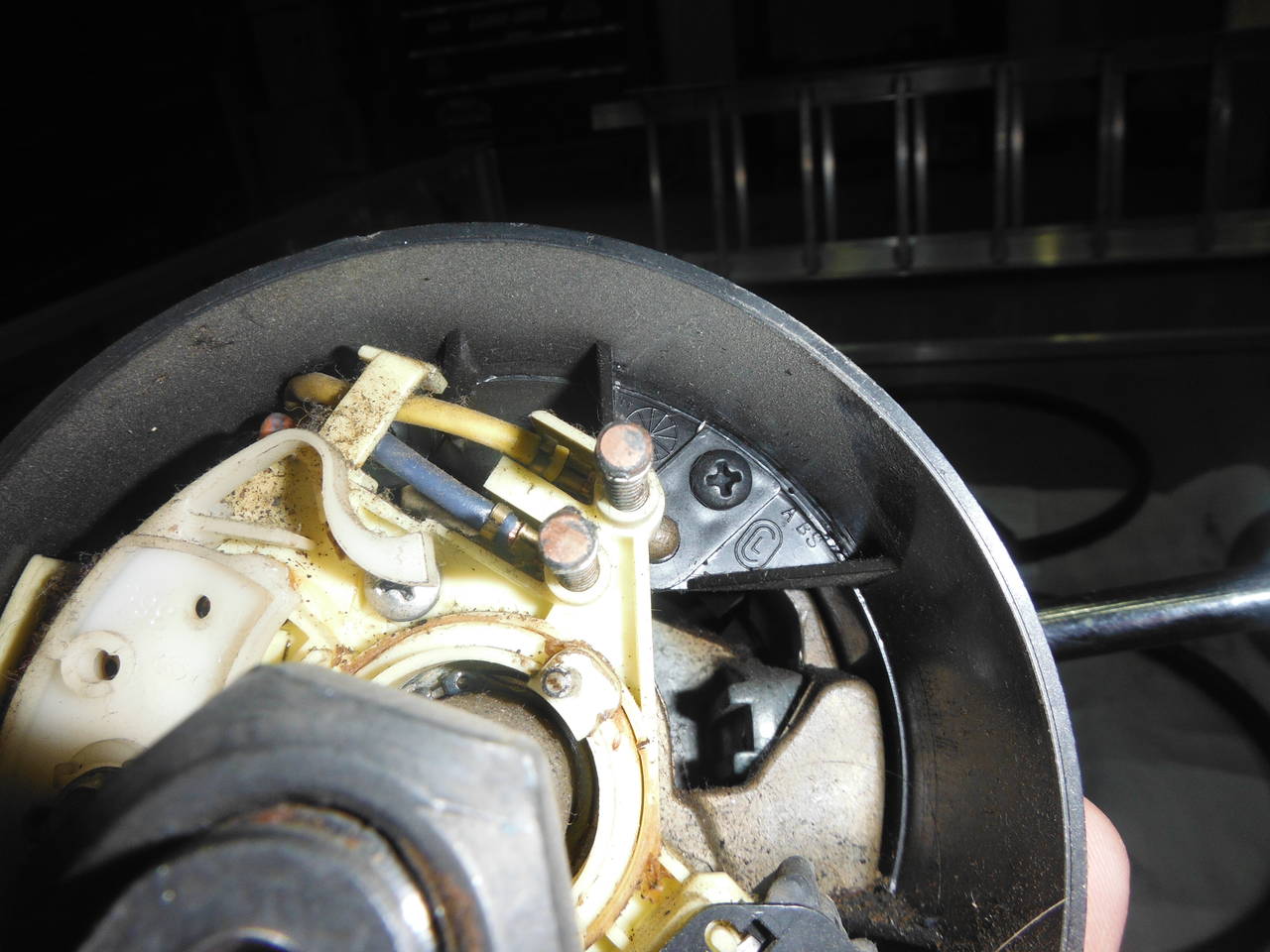

Those turn signal contacts look like they've had very little wear.
Yes...but it is too bad the plastic cam that holds the signal light on broke....I have a couple of spares.
