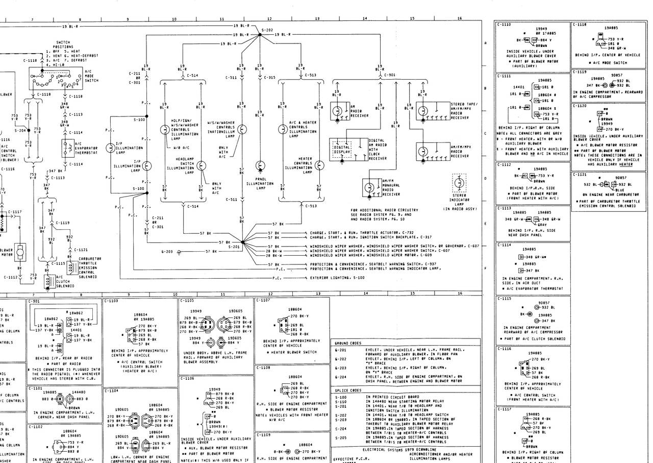

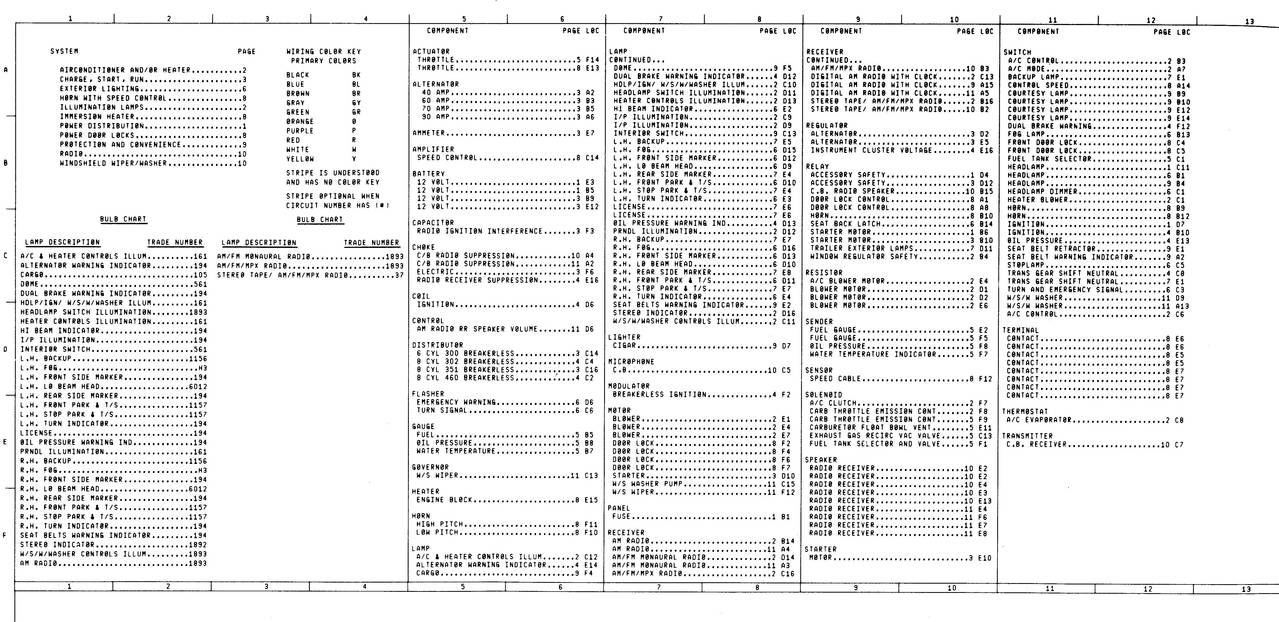

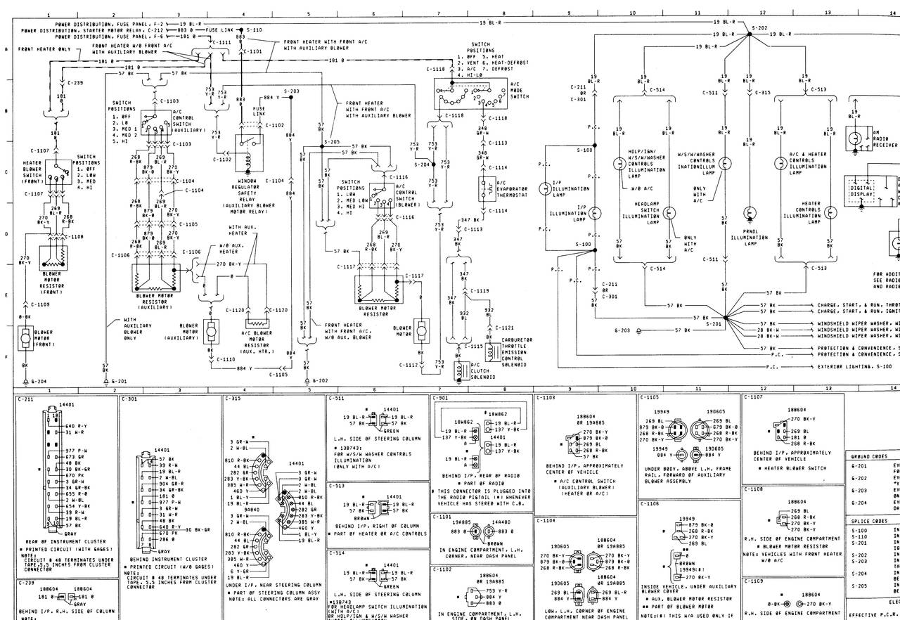

The comments about checking the sonnections, socket etc are valid....here is a copy of the 1979 wiring diagram, which I am sure will be the the same for the most part.
I haven't posted them yet partially due to not being able to stictch them as they are nearly 36'' wide....in any case...here you go:
Thanks so much for the info, Duncan. Just ordered some red LED's from Superbright, since the dash lights are red (easier for my peepers to see at night.). I ordered the 32* dispersion AND the 90* degree dispersion, since I'm not sure what kind of shield(if any) covers the bulb.
I'll start perusing the prints tonight at work, since I can print them out on 11 X 14, or bigger paper.
Much appreciated!
Anytime Doug....if they won't enlarge good enough just tell me and I can rescan at a higher resolution.
Duncan, the prints look VERY nice on 24" paper. :D Thanks again!
