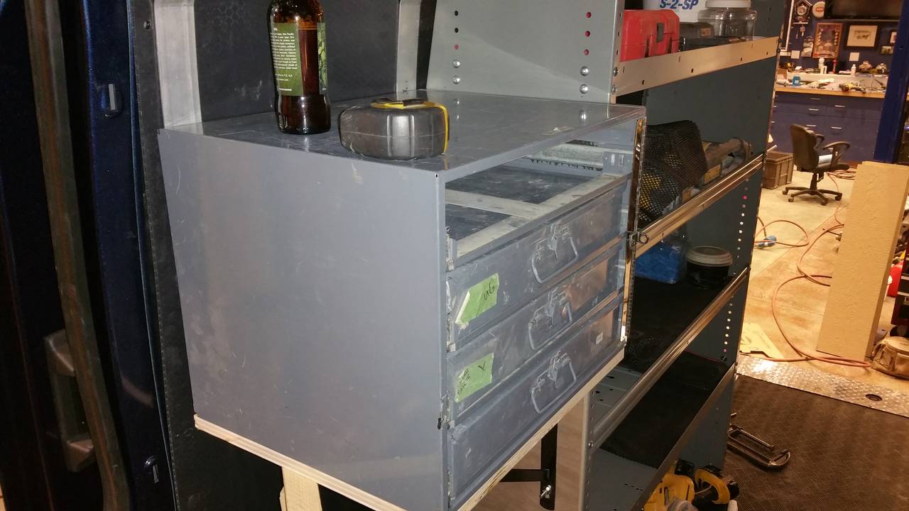

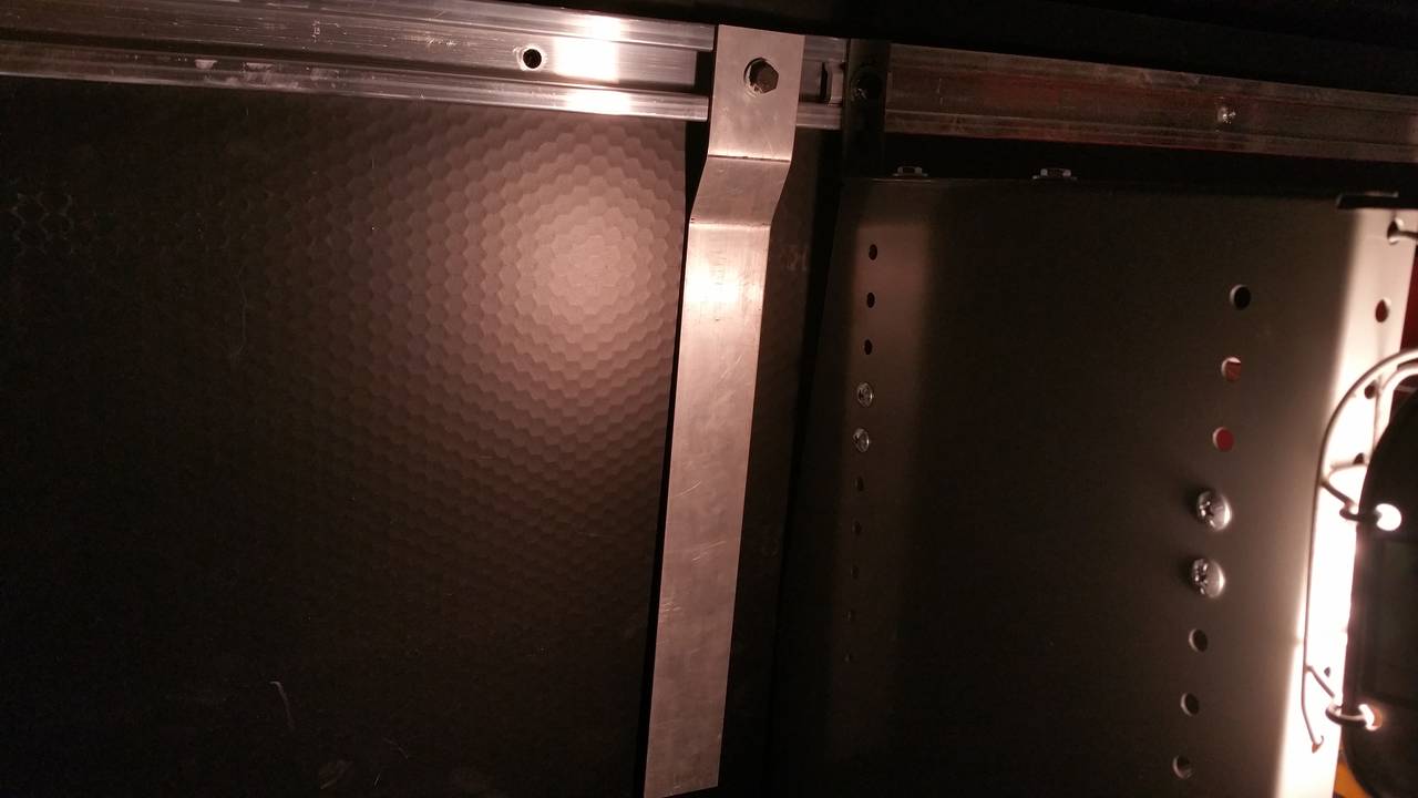

Did some work on the interior today, trying to reuse the Durham boxes we had in the 750.

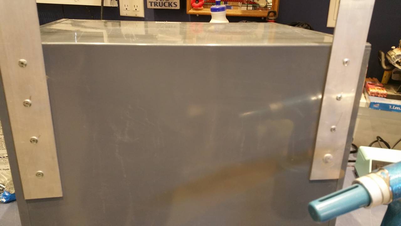

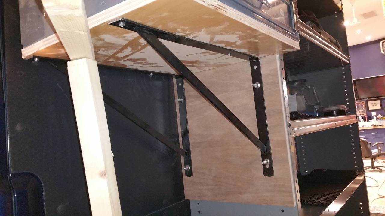

I sorely underestimated how strong the box carcass is...after I got it hung it was twisting with just it's own weight...think for simplicities sake I will use a piece of Maple plywood on the end as an upright.

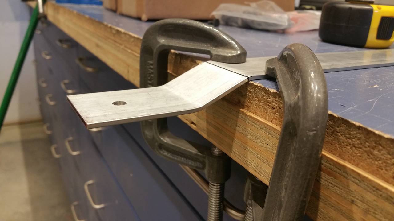

No press brake?...no problem :D

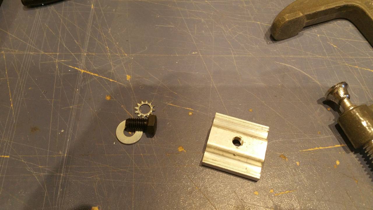

I didn't like the AL rivet, bottom right, so did the rest in steel.

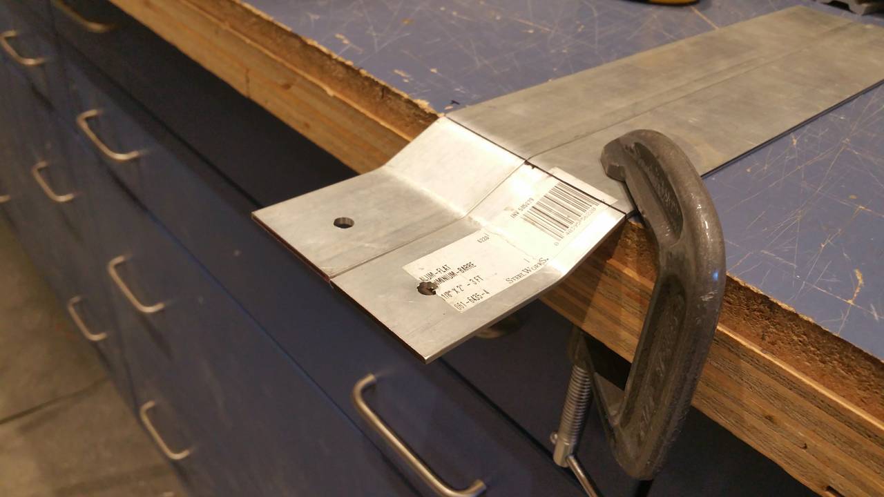

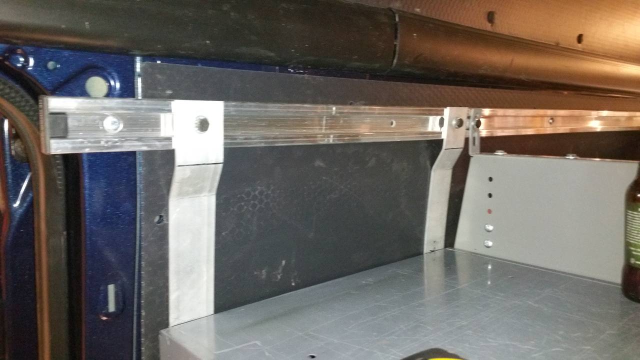

After the sagging, I used some backing underneath the cabinet and some on the shelf side...decided to save time and buy a couple of premade shelf brackets...seems 90 degrees in NA ain't 90 degrees in the China plant..:icon_mecker:

Dicked around with the idea of making a gable for the end for support...easiest thing will be to simply order another shelf end.
Won't see it for a couple of weeks so I cut a 2x2 and wedged it in...should be ok for now.
