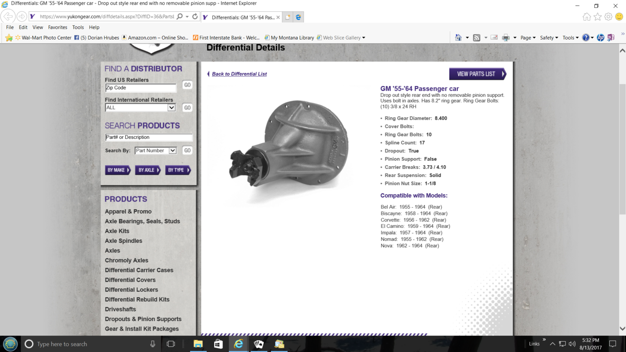

I'm needing to lose the granny gears and need help. Thetruck has been hot rodded many years ago... chevy 327 and power glide. Not clear about the rear end.

Late 60'\s, no. Early 60's, maybe. The weld tab that looks to still be there at the top on the back makes it a definite possibility. The suspension would have attached there. The lack of ribbing on the differential carrier is the thing that is throwing me off. May even be 50's.
Everything I am finding on the GM axles show a GM cast onto the carrier housing. Also, I am seeing that the 8" and 9" axles also had bolt out pinions, while the GM's did not, which again leans me towards this being a 50's - early 60's GM axle. No newer than 64 though.

Looks a whole lot like a 1955 (56, 57, others) Chevy BelAir rear end to me.

Is it worth working with? I need to gear up.
