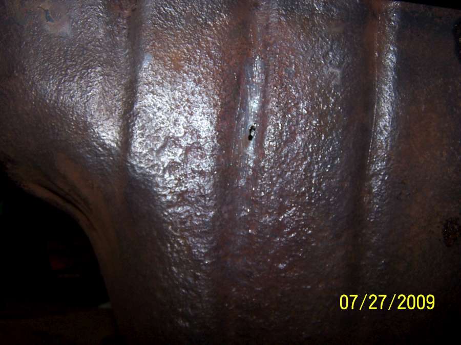

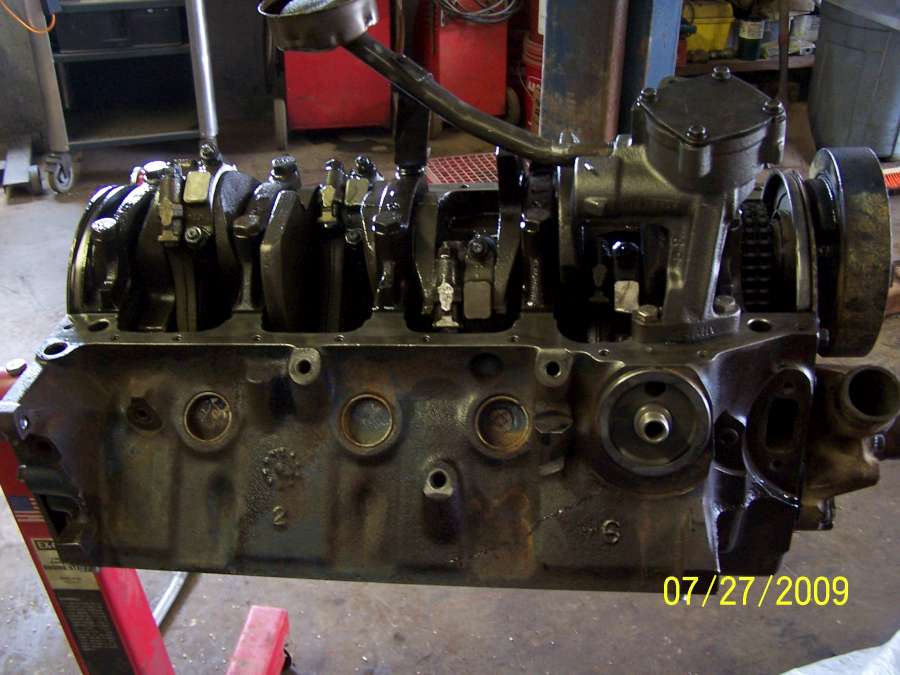

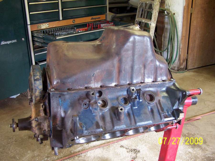

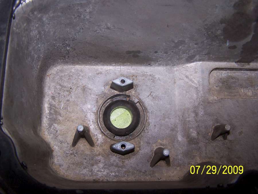

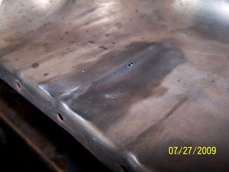

I'll have the heads tomorrow morning for sure I hope! I got the oil pump ready to go in when I noticed the pump shaft didn't have the locking retainer (or whatever you call it) on it. Luckily my machinist had a few kicking around. So after I went and got that I installed the pump. Started to clean up the pan and there it was ... a nice little hole... WFT am I ever going to get this motor together? This pan is freeeckin junk!!! As luck would have it the junk yard next door had a 400 setting under the bench, I pulled it off and went back at it. I think I might buy or barter with Brian and get that 400. I have another good set of 75 351C 2V heads so just maybe just maybe???
Should have it done tomorrow...
By the way it normally takes me about 5 to 6 hours to put one together, this one has been a nightmare. Something about having the customer buy the parts...!!

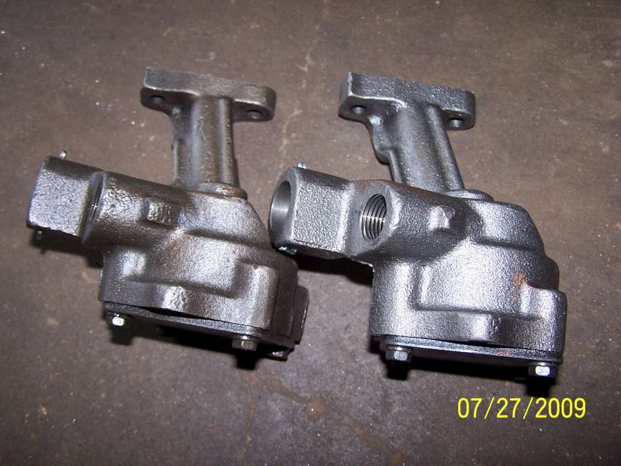

Though I would show the difference in a stock oil pump and a HV pump....
173
6
may just be me, but I don't see a difference other than the color..
Look at where the gears would be inside the housing... it most be 25% bigger.

I really don't like using them on a new rebuild where the clearances are tight, all it would do is push most of the oil around the pressure regulator (because it's got nowhere else to go) and create heat. But this build I am using Speed Pro 3/4 groove racing main bearings and the clearances are on the loose side so a little more volume won't hurt.

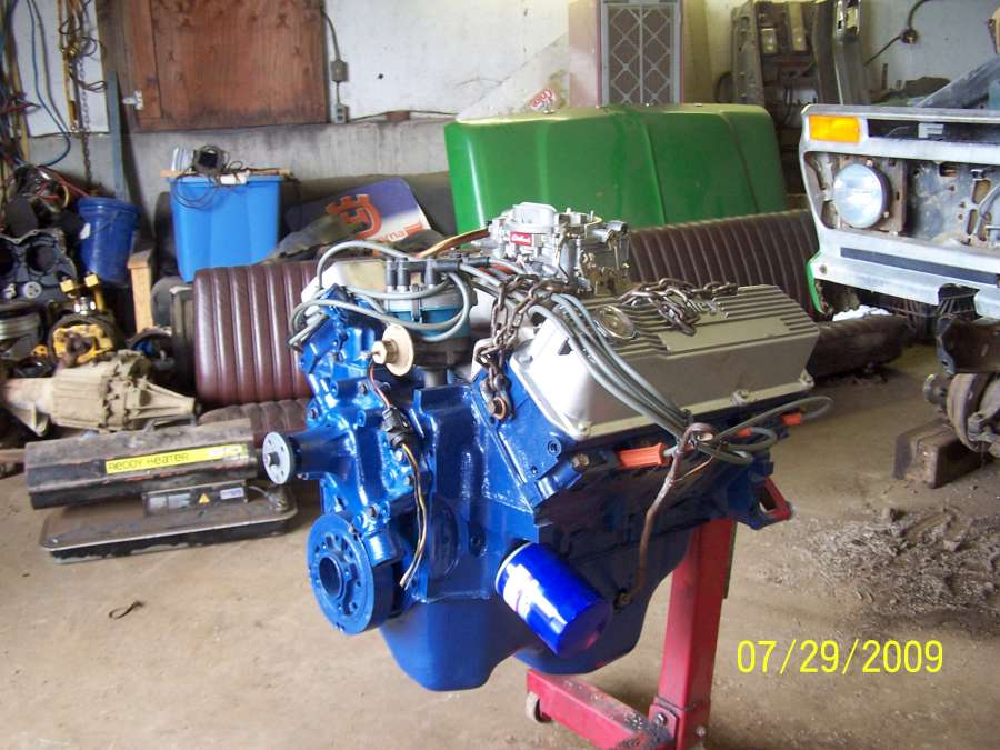

Got it together yesterday.......

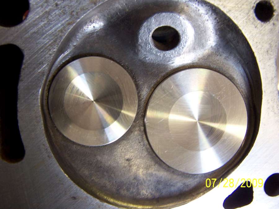

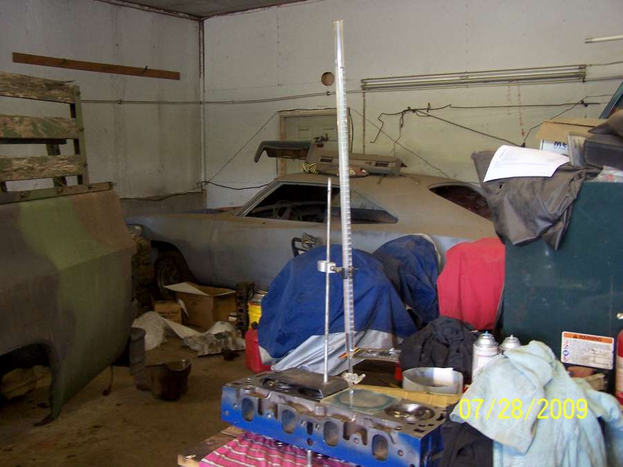

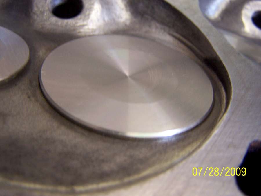

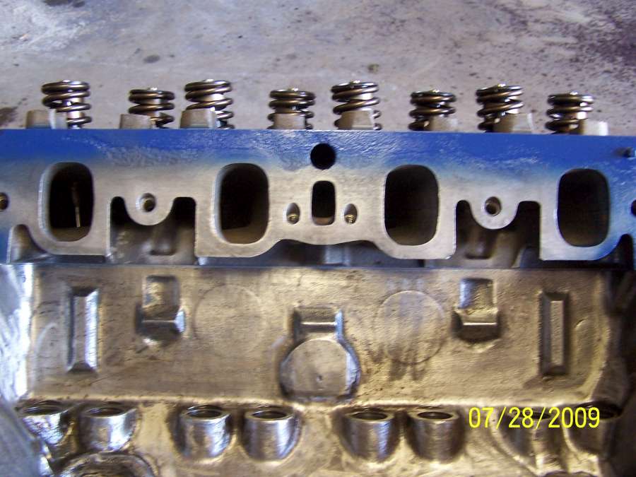

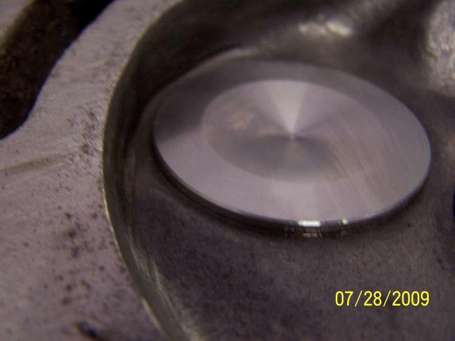

First thing I did was cc the chambers I checked 3 chambers and they were to my surprise 78cc...

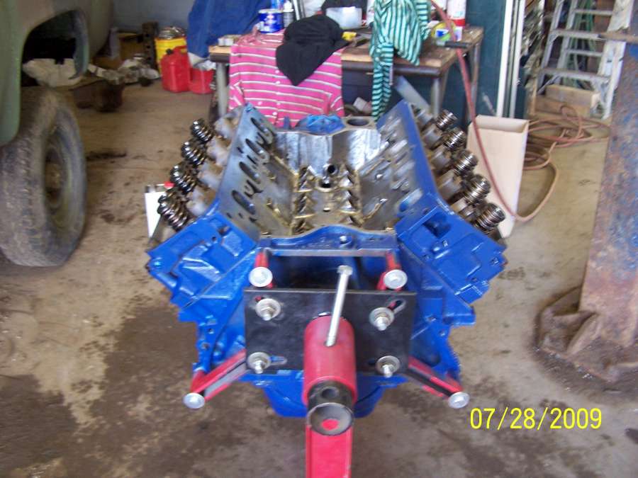

few pics of the un-shrouded valves

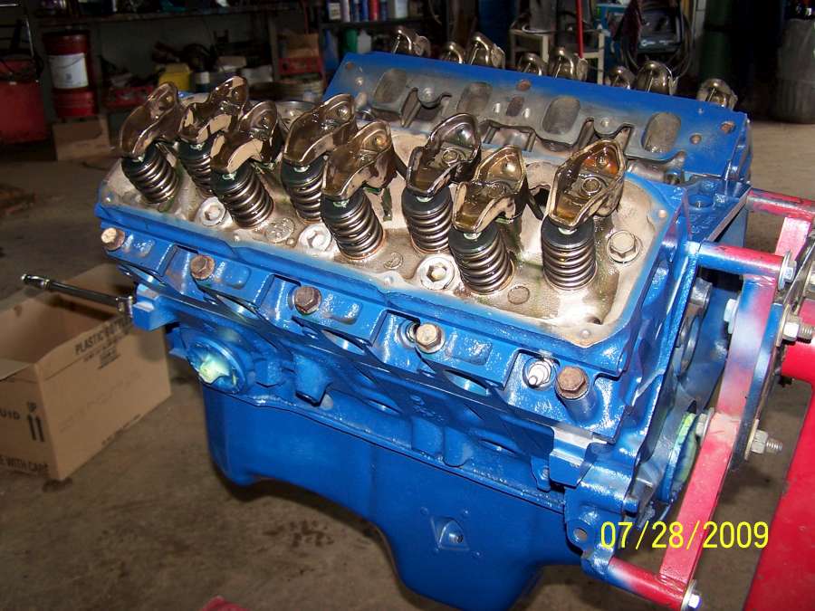

Next I bolted the heads on....
Then I installed the rockers... one thing that's bugging me is half oil deflectors that go under the bolts were broke so I didn't install them. Not sure if that's going to be a problem or not. Then I noticed the valve covers he bought don't have any baffles in them so I think I'm going to use the old tin ones.
All done, I have to pull the carb apart and clean it, it's been sitting awhile. Trying to talk him into a Holley, like to see a 700cfm or better on it.

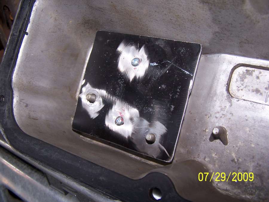

I got to it this morning making some baffles for the Holley valve covers that didn't have any. Found some old rocker panels in the corner of the shop and cut one up for the baffles.
Threaded the holes and with a little locktyte had some usable valve covers

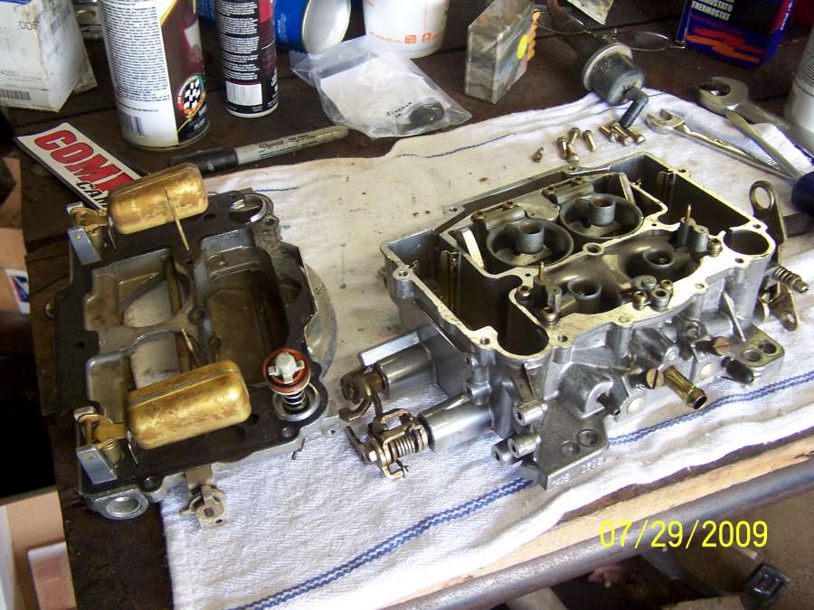

Next I cleaned out the Edelbrock 600.. had a bunch of dirt in it and the bottom of the accelerator pump bore was full too. got it all cleaned up and back on.
I wish he would spring for a Holley so I could tune it!!! I got a couple kicking around I might just let him use one for the mud run this Saturday.

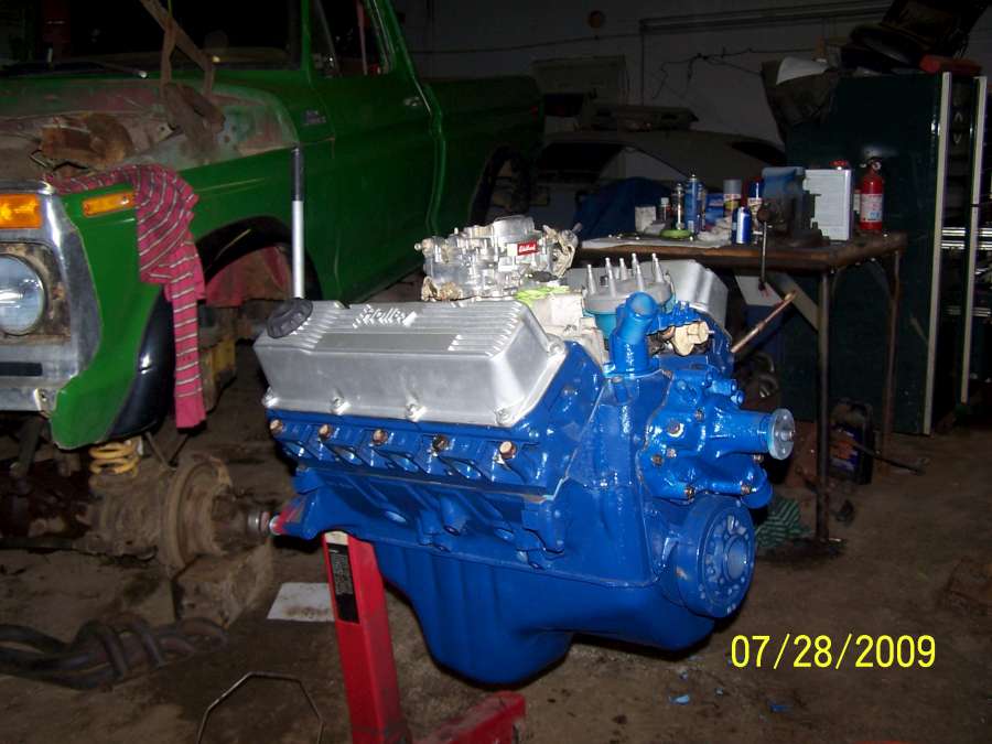

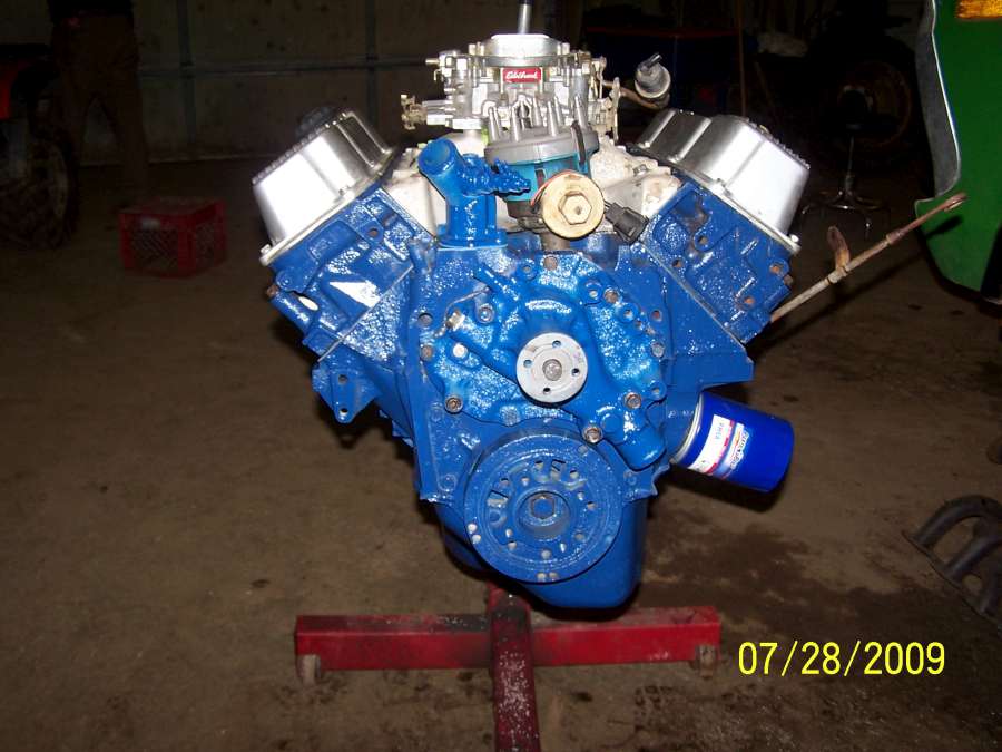

I got the HEI ignition wired up and working, the motor setting in the truck with the help from some of the boys in the shop. It'll be running tomorrow.

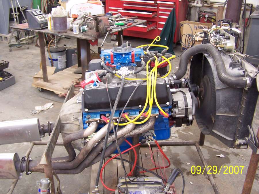

I wanted to use my engine stand so I could run it while braking in the cam but I couldn't find a junk big block C6 to cut up for the bellhousing. This is the stand I use for running engines before they go in the vehicle, makes it a lot easier to change a wiped out cam and lifter. When I built my Clevor shown on the stand running I had to tear it back apart and have it line bored... never put an engine together with out plastic-gauging the bearing, I was in a rush and learned a valuable lesson!
