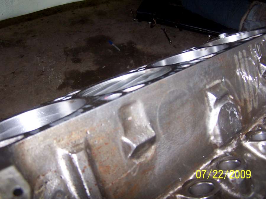

OK I got back at it the other day, still waiting on parts. I rechecked the ring gap and had to open the top ring from .023 to .026 the second ring was .014 so all is good there. Waiting for new HV oil pump and the heads.
check out the new pistons, they land right at 0 deck perfect that should up the compression.

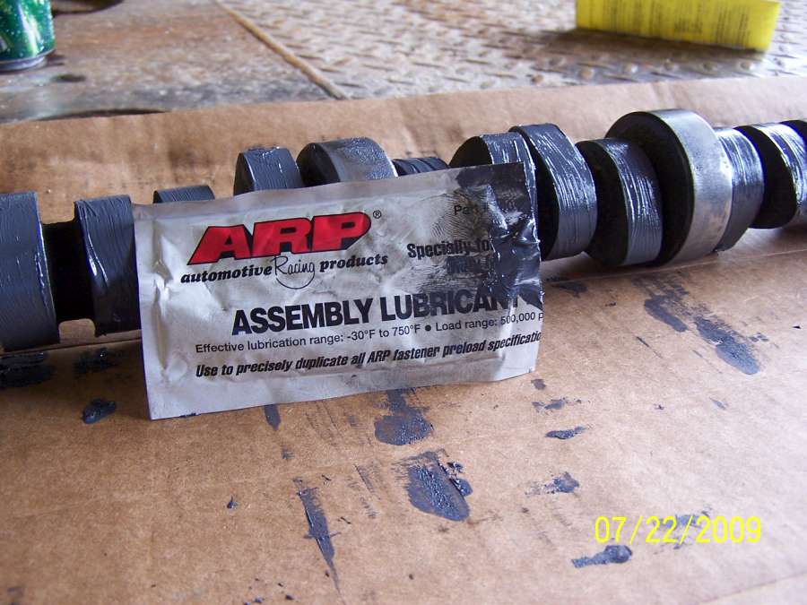

Got the cam, timing set, water pump installed... I use the ARP assembly lube on the cam, it's thick and stays where you put it. I'll put some on the bottom of the lifters as well.

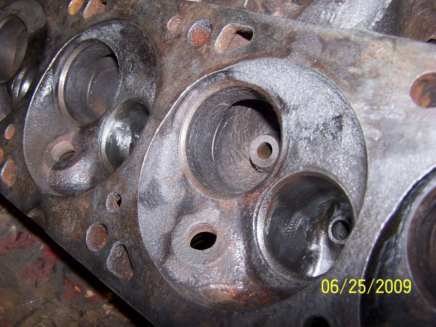

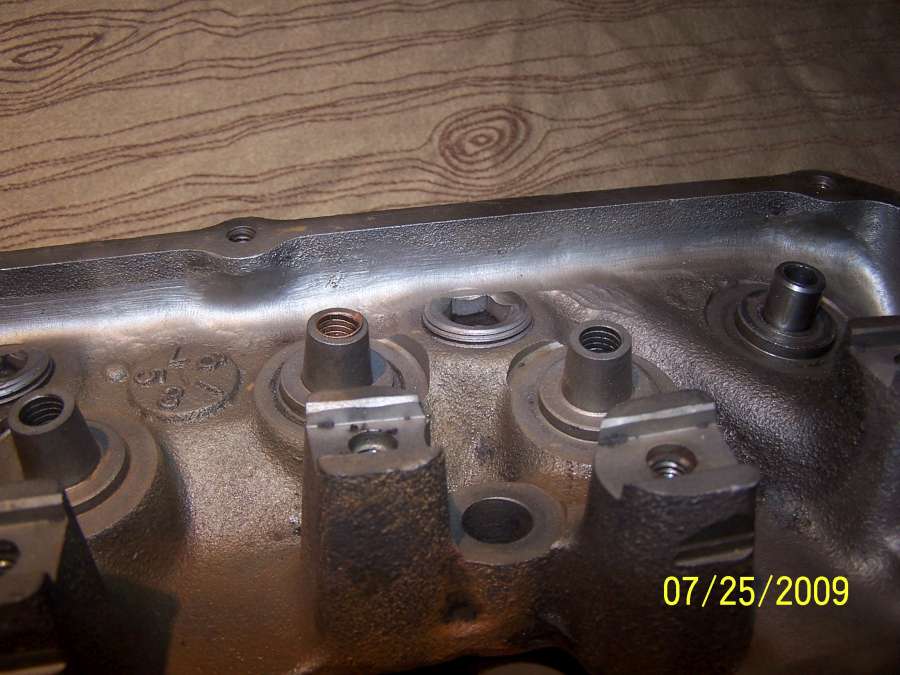

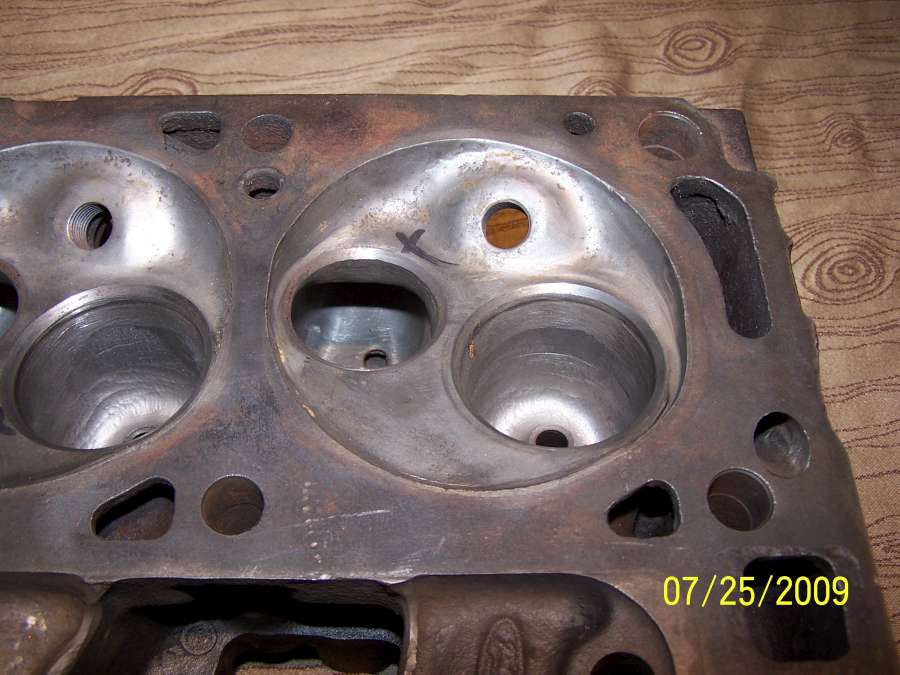

Ok I got the heads back from the shop, they needed 4 or 5 guides so I have to trim the guides back in the bowls.

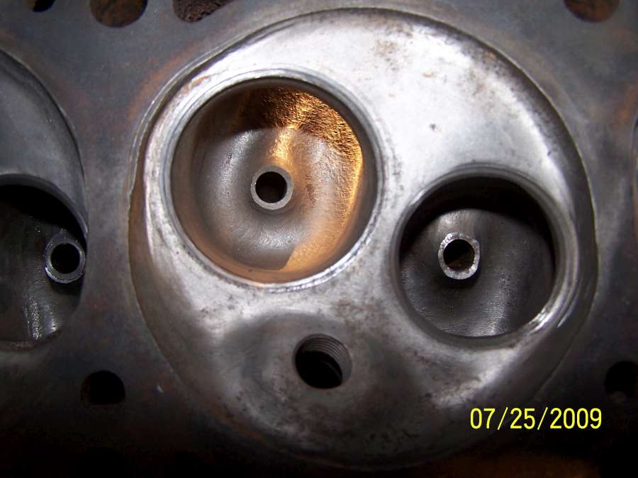

Here's a few pics of the heads after I started on the exhaust ports.

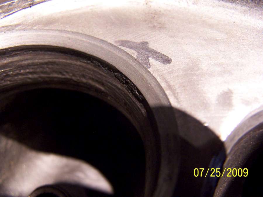

Notice the deep grooves in the chambers around the seats, if left as is it would create a bunch of turbulence coming in and going out.
This pics shows the groove free chamber around the seat

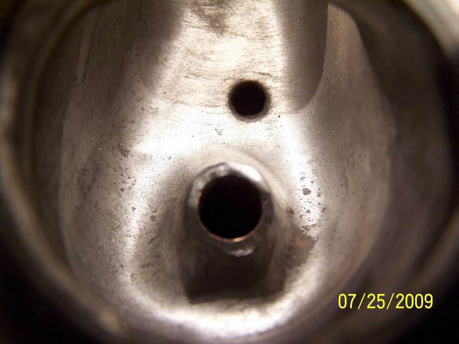

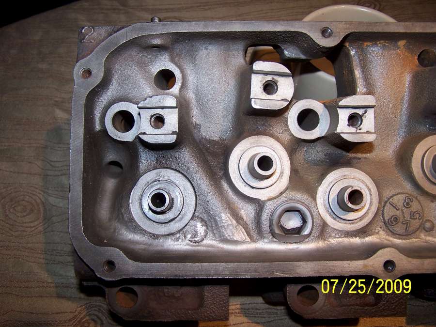

These pics show how I opened up the oil return path to the drain holes in the heads.

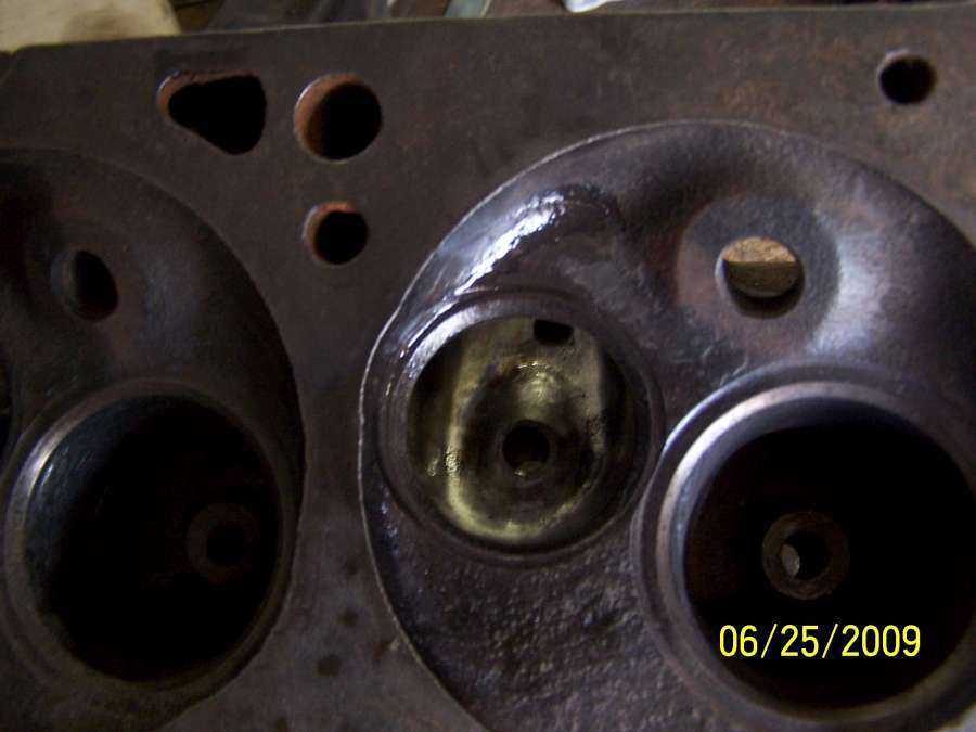

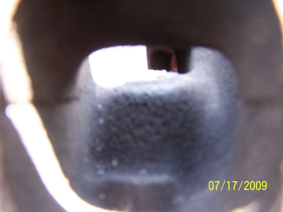

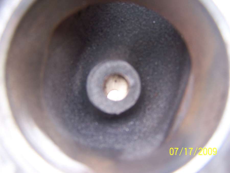

This is the D5 Exhaust post found on most 351M/400 it is very restrictive. The heads I used are 74 351C 2V heads they have a must better exhaust port.
D5 Exhaust Port

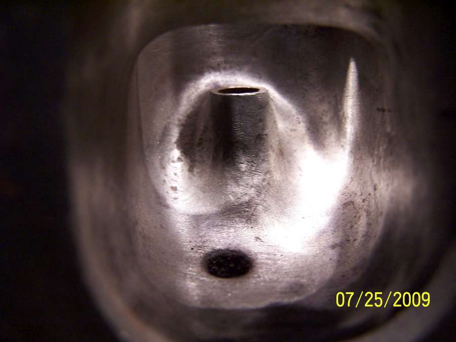

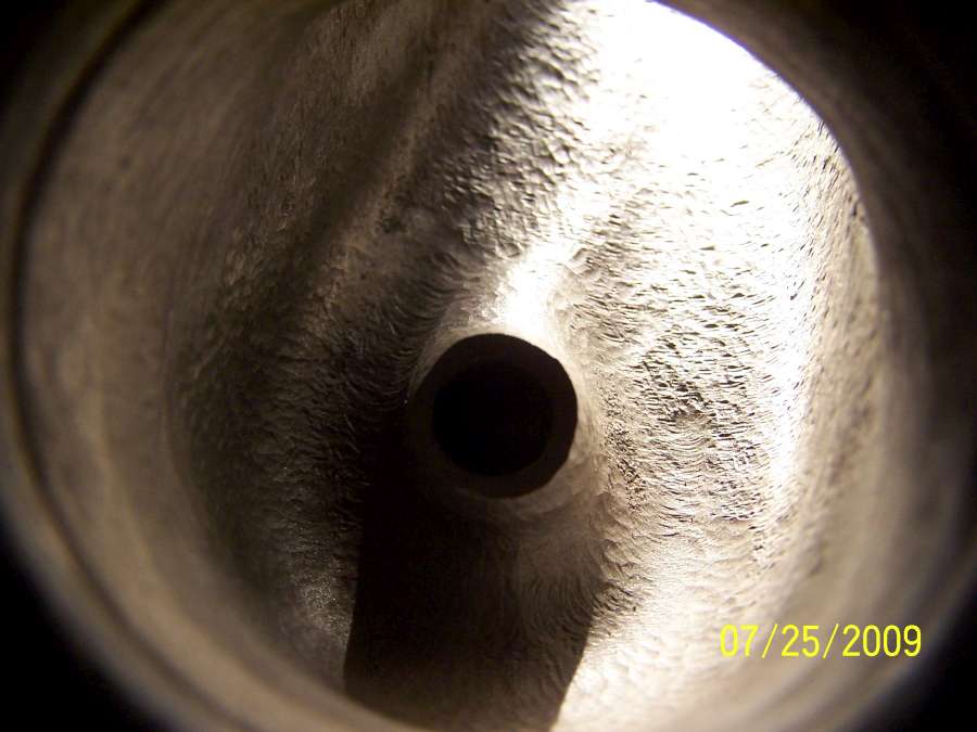

Here is the 351C 2V after some porting

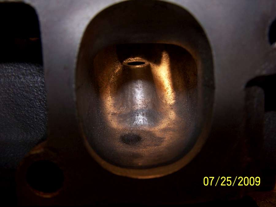

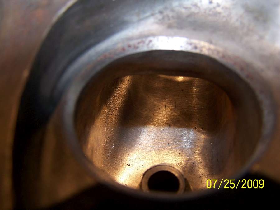

intake port bowl before
Intake port bowl after

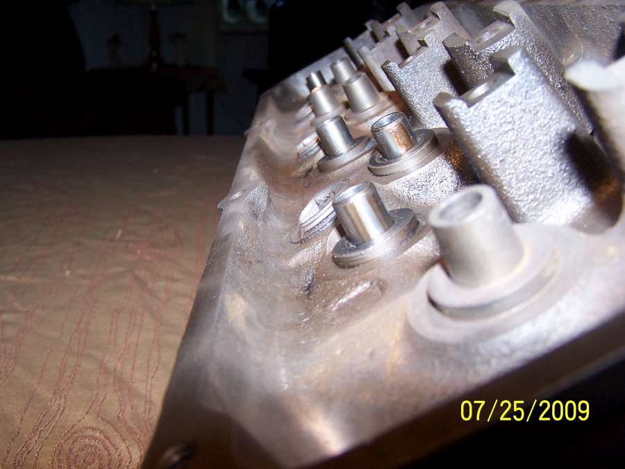

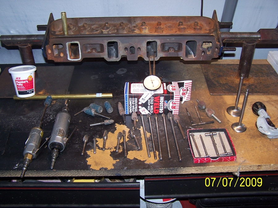

post a picture of the tools you usd
Here you go.. I've been doing it a while. I just started doing some 351W D0OE heads for my! mud truck... this time I got crazy and installed some brass tubes in the push rod holes so I could open the inlet as much as possible.
173

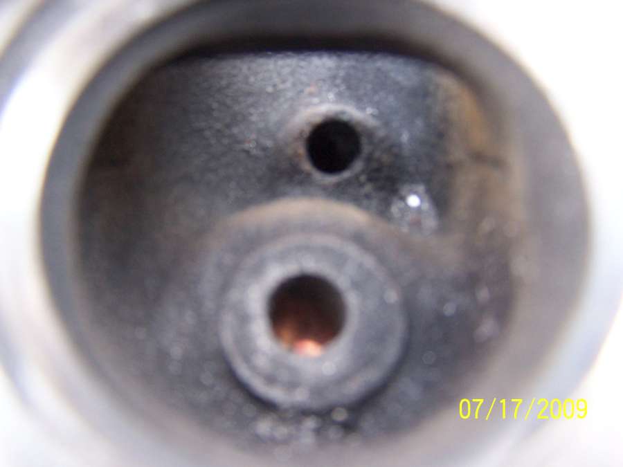

6
I use it to protect the inside of the brass tubing from filling up with JB Weld. I drilled the push rod holes to an even 9/16 diameter, half the hole is 9/16 and the other half is a little smaller. Once it's an even 9/16 I hone the hole with a ball hone to clean it. Then port the inlet to where it's just starting to brake through into the push rod hole evenly the all the way across.I clean every thing with some lacquer thinner then I mix up some JB Weld and cover the brass tube and the inside of the push rod hole, ball up some plumbers putty and fill the end of the brass tube with it. Push it through the hole and the plumbers putty keeps the JB Weld from getting inside the brass tubing. I read how to do this on a site somewhere I'll look for the link and post it for ya...
