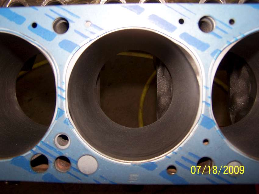

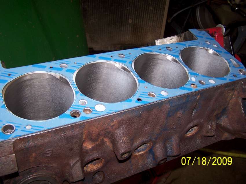

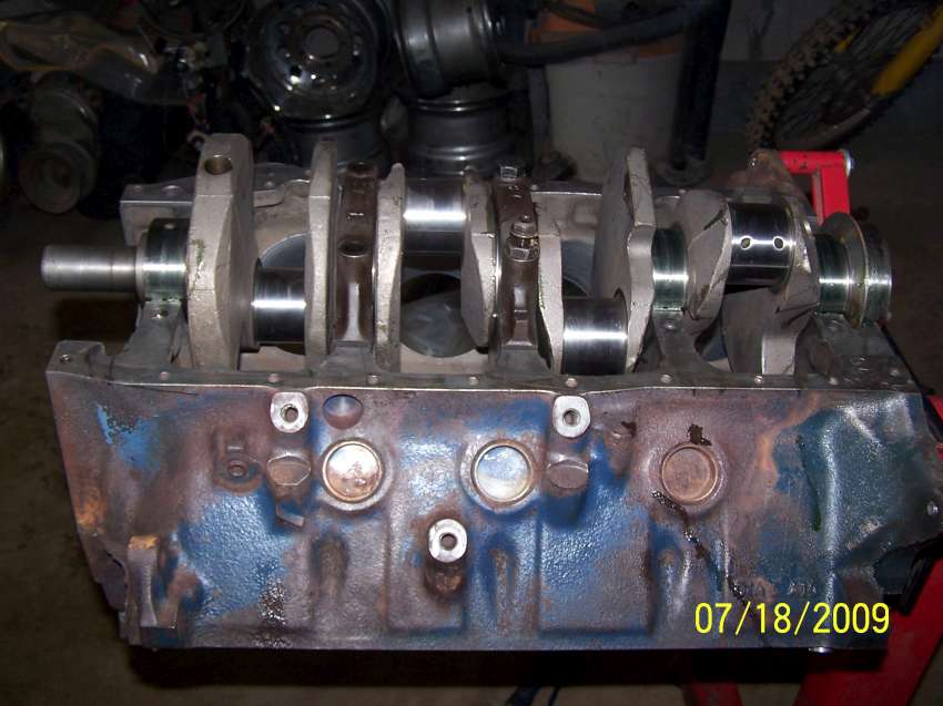

Well I got as far as putting the rings on the pistons and with my new thumb injury it will have to wait until I get to my other tool box so I can grab my ring expander... I got the block relieved for the intake valves and installed the crank. The ring gap was more than enough and the clearance on the mains were with in .001 to .003...
Look at the block where the gasket has the relief for the other bank were I didn't relieve it. You can see why I do this the incoming intake charge would slam right into the top of the block making all kinds of turbulence.
Here you can see that I stayed up higher than were the top ring stops at TDC.
Crank in
