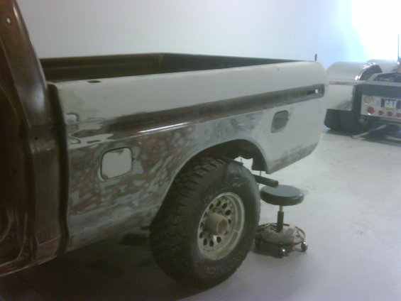

Maybe you can get as much of the filler out as possible and knock them out most of the way with a dolly. If it's still not quite smooth, use just a small dab of filler. I don't consider it cheating but a lot of other guys do... It could be from wear/tear on the truck. My dents are along the bed rail and from transportation of the bed.

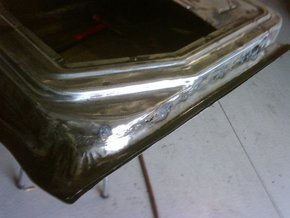

Well I haven't gotten into the body of the truck any further than the last pictures. I've been concentrating on getting the back doors in shape. The rear passenger door is the only issue of rust I had to deal with. Here's how it looks after todays work.

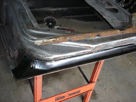

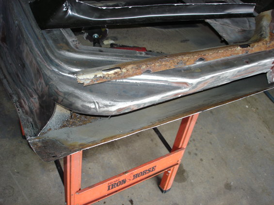

It was pretty rusty on the inside and I wasn't going to chop that much out but now I'm glad I did. I ordered some replacement panels from LMC. Spent most of today welding them in place. Still have to finish the lower lip.
I still have to roll the bottom edge over. I drilled some holes in the edge to make it look like a spot weld once it is rolled over.

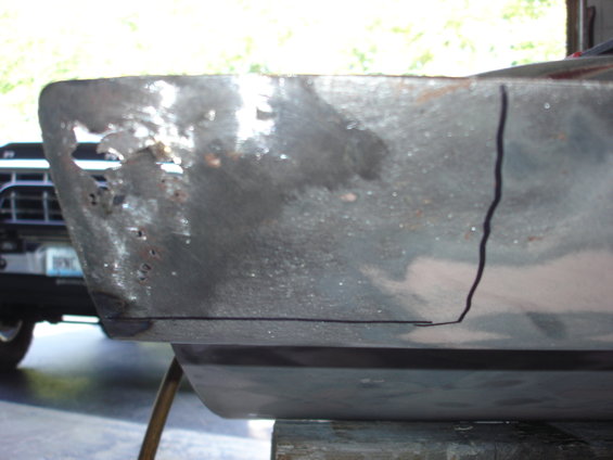

Here is what the outside used to look like. I was only going to take out at my black mark lines but also decided to get rid of all the rust so I ended up taking quite a bit more out.

Looks great ya done a good job. As for the bed in the other pics the one on the 72 is pretty much all bondo along the bedside top bottom and in the middle. Kinda strange since its been a farm truck.

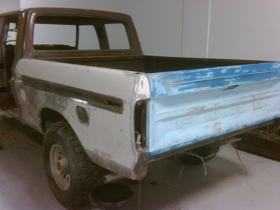

I started today on the bed. Took most of the feather fill off and some previous body work. There is no rust thru, some minor dents from a previous accident I presume so it will need a little work. I also got the interior ready for primer.

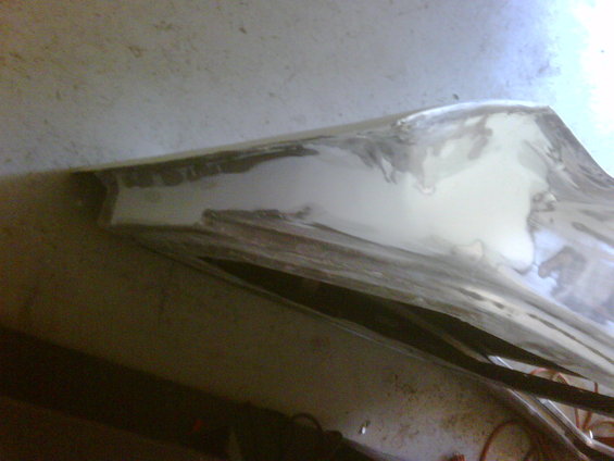

One layer of primer and one layer of paint on the T-gate. It sanded down pretty easy.
Inside of the door is done, still have some detail work to do on the outside but it sure beats the rust it had.

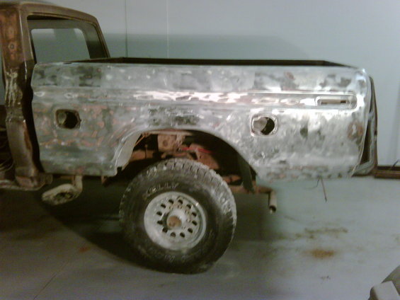

Ben the body work hasn't really started. Right now I am at the striping stages of getting all of the old paint off the box, still got most of the cab exterior to sand as well. I was only able to get the driver side partly complete, still more work on that and then I have to strighten some spots out. You can see just above the center of the wheel well it is pushed in a bit. I'll pull as much as I can so it is only a thin layer of bondo to straighten it out. I've got quite a bit to do yet for body work. There are still 2 holes in the roof I have to weld up.

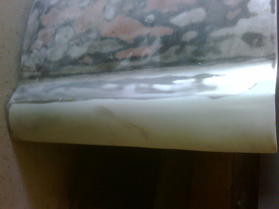

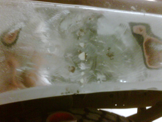

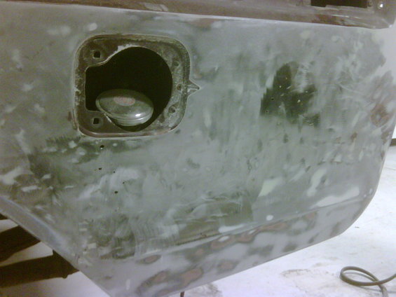

Curiosity got the best of me and I wanted to see what was hidden underneath that bondo. I was going to leave it but now I'm glad I didn't. It will require some work to get it straight but at least I'll have a piece of mind knowing what's underneath. I found some holes thru the metal, ended up welding them closed. Also the top of the bedside, above the dent, has some previous body work as well. I found some surface rust starting to form so I'm pretty happy that I took it all off. The wheel well is not rusted at all, just dented in.
How it sits now. Good thing for torches, all of the bed bolts including the 2 phillips head bolts came right out after a little heat on the nuts. Also had to unbolt the fifth wheel hitch.
