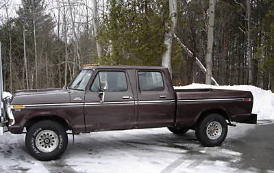

Finally got my crewcab!!

looks good! any ideas on what color its going to be in the end?

Right now I think it is going to be slate gray metallic. I have a nice black dash pad for it and a set of black XLT door panels for the front and rear. It should go together good with the gray.

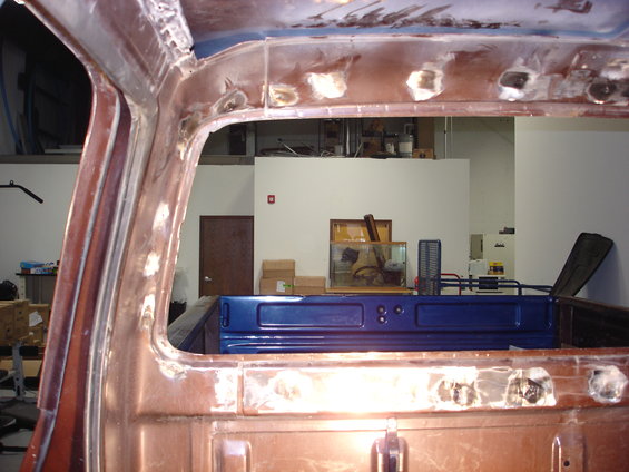

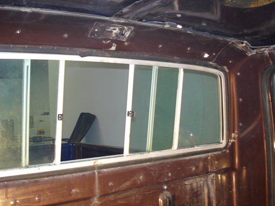

Well back at it. I had to weld all the holes shut from the screw in snaps that the PO had put in around the back window.

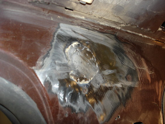

I also welded up this hole in the pillar.

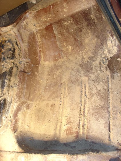

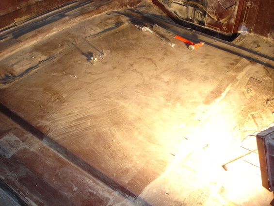

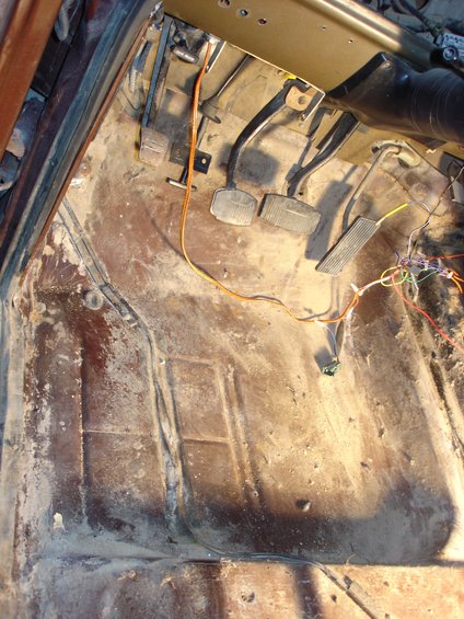

Ended up cleaning all of the floor with a gasket scraper. The floorboards are in great shape. No signs of rust anywhere.
Next is pull it out and get a garden hose and wash the remaining dirt out of the interior. I'm going to POR-15 the floorboards and then use Dynamat.

What a great project. Man those floors do look in good shape. Do you have much body work to do except for the minor ding/scratch repairs or is there some patch panel work to do?
Looks great. Do you know what the snaps would have been used for?

Buck there is a small spot of rust on the rear wheel well. From what I can tell with a magnet it is still metal so I don't believe it has been ever worked on before. The body is in great shape, aside from some roof dents and a few door dings it should be pretty simple. The driver door has a small area of rust on it. I'm undecided as to wether or not I want to use my NOS doors and fenders on this one or stick with what's on it.
73, I think somewhere in it's life this truck was pulled behind a camper. I'm guessing they must of made a cover that snapped on the back window to keep the sun out?

Thanks. This is the only pic I have at the moment from the aution. Ebay doesn't keep old auctions around for much anymore.
