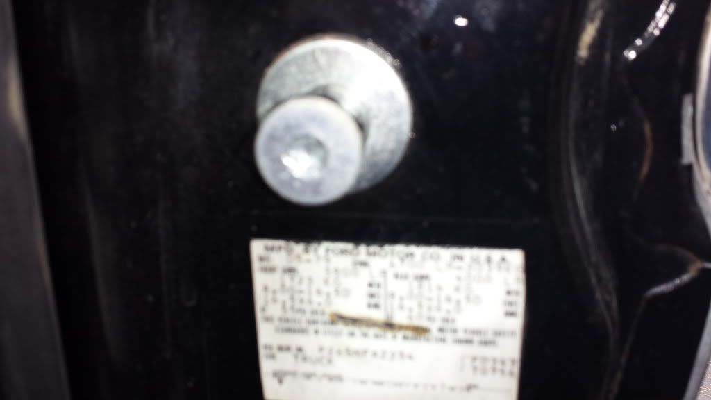

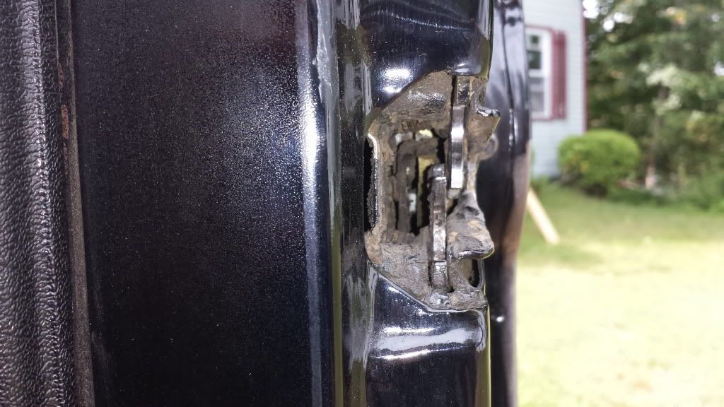

Awesome.....thanks for taking the time to give me the link....I stepped outside and took these and I'm beginning to wonder if that is in fact the problem because the striker bolts on them now look brand new. I manually tried latching and it worked just fine....I even looked at the latches and bolt while slowly shutting it and it looks aligned perfectly.

Your latch is fine, but both your stricker bolts plastic sleeve (that's what I call it) that goes around the stricker that makes the door latch nice and tight are worn down to the point of not working, hence the tape trying to build it up so the door latches properly. You can see what a new one looks like in the Napa link. I think new stricker bolts will solve your problem.

Those bolts wear fast if they, or the doors arent aligned

Replace the strikers, black tape was used to replace the plastic bushing. Get a new striker and close the latch around it before you install it in the door to see if there is excessive free play.
