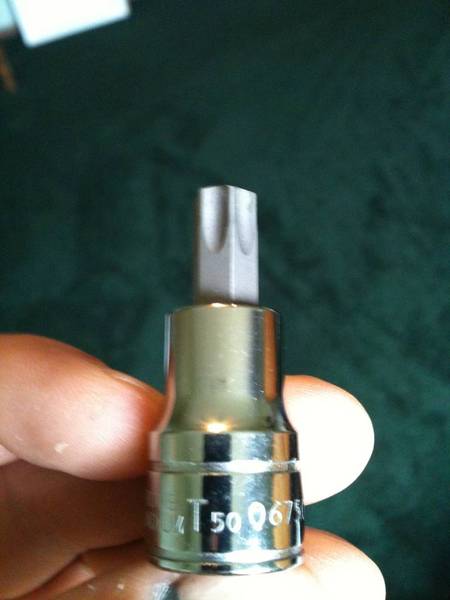

Ken, you should be using a torx bit for that striker. A hex key will wallow it out so it is no longer useable. I think the proper torx size is 45, 50, or 55. :)
