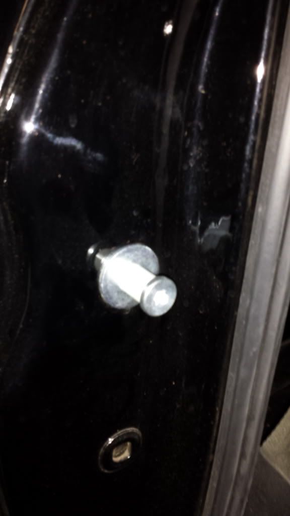

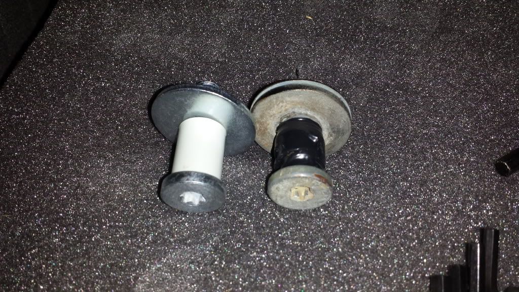

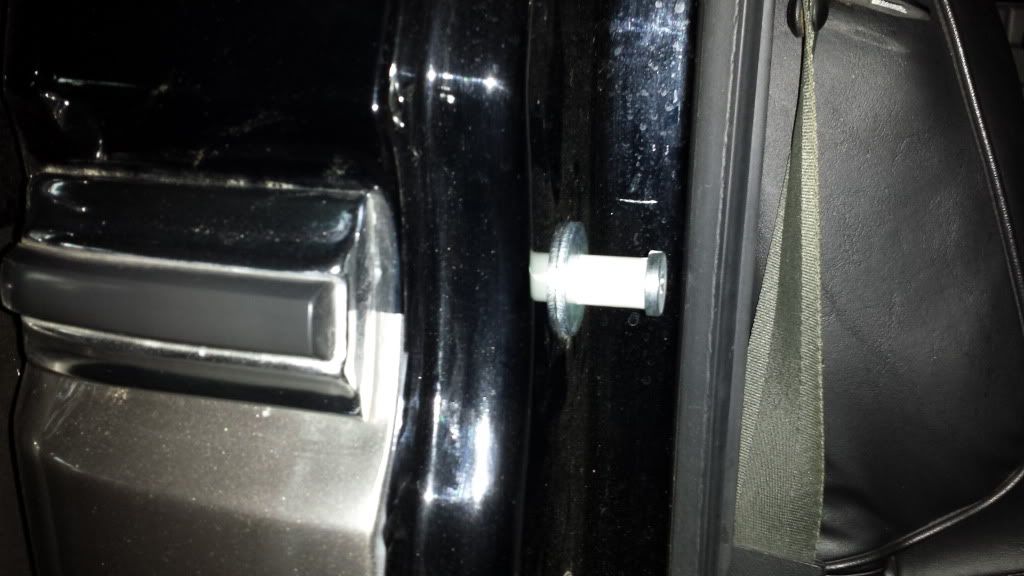

Ok, so I put the Doorman striker on yesterday and was pleasantly surprised by the results. It didn't shut as perfectly as the driver's side did, but you didn't have to darn near slam the thing worrying about the window breaking to shut it. Now you just have to give it a little more than just a little push and it shuts perfectly......I was checking the lines and the door seems to line up perfectly (not talking about it hanging, although it seems perfect there too) with the bed and front qaurter panel, so I'm not sure if I want to attempt to pull the striker out just a hair and see how it lines up or just leave it and my passengers will just have to push or pull a tad harder. I'm leaning towards leaving it as it's very functional and am just SUPER HAPPY I don't have to mess with the door hinges or latches.
The old with new electrical tape and NO bushing and the new doorman I bought for $8!

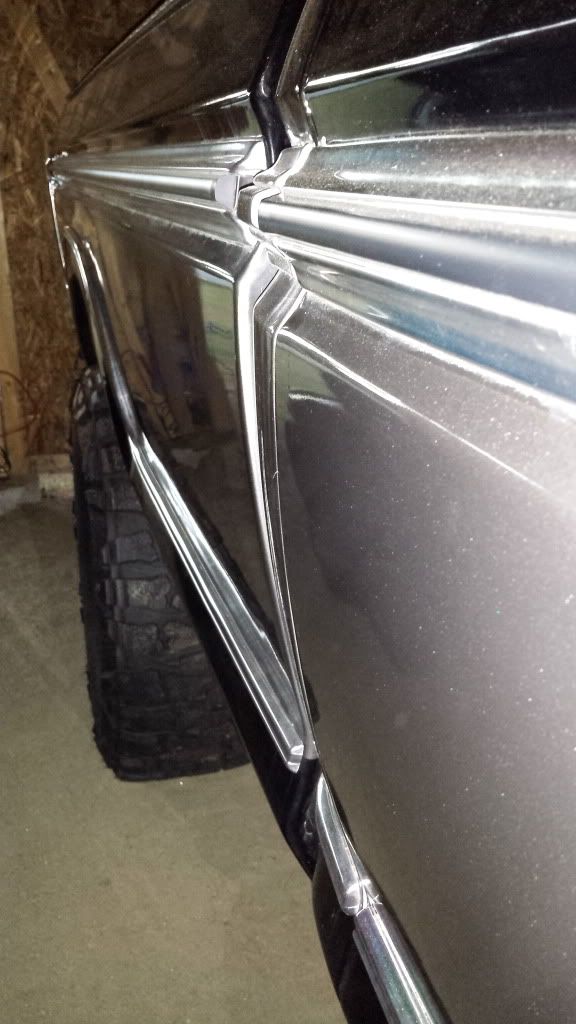

This is why I'm leary about messing with the striker, cause the panels match up darn near perfect....if I try to pull it out even 1/32 of an inch, there might be a lip.....it shuts good enough for me....not sure if anything can be changed in the latch, but I'm not even going to mess with it. I think it's good indefinitely now.
