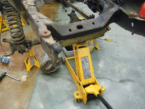

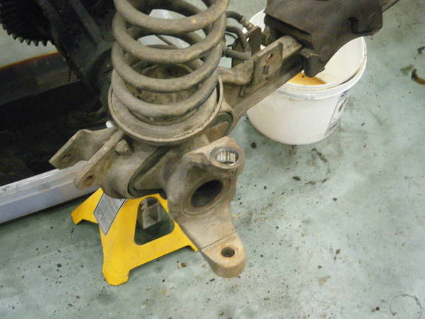

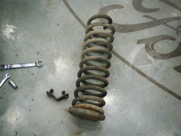

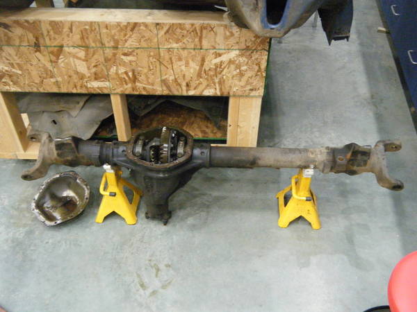

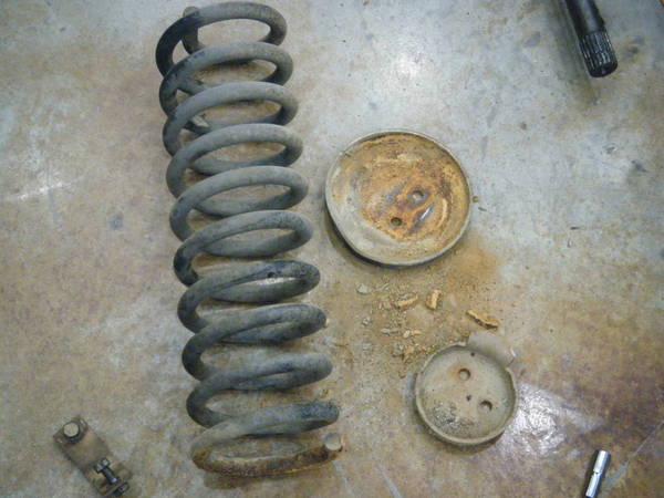

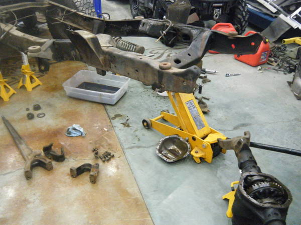

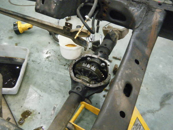

More progress....got the front axle and associated things removed, gotta go get a stamp set so I can ID left/right stuff. The bolts that hold the brackets on for the forward of axle shock were quite loose. There was some rust in the spring pad but nowhere near enough for it to be a concern.

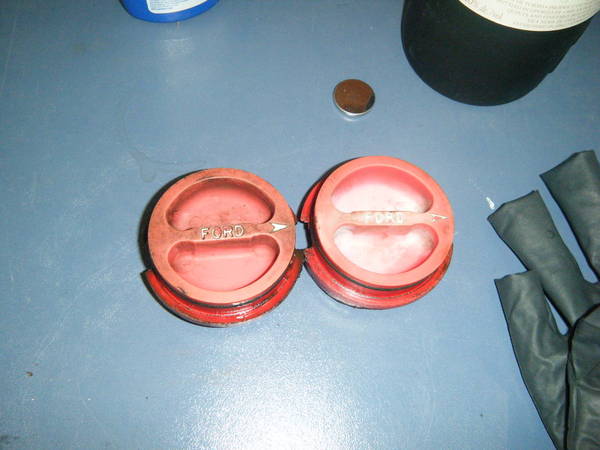

I'm hoping I can find some NOS or some in better condition than these hub actuators...the one is very faded...I might try soda blasting it.
The ol' custom piece of 4 x 4 for extra height :D

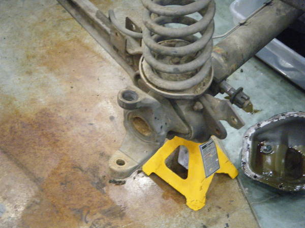

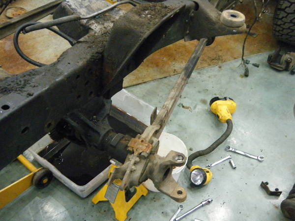

Passenger side out:
Drivers side:

There was a set of those NOS red dials on ebay, I think it was Wesley's, but it was started at $100 for the dials only. I bought a set of NOS D60 red dials for $35.

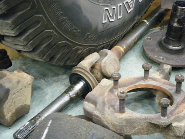

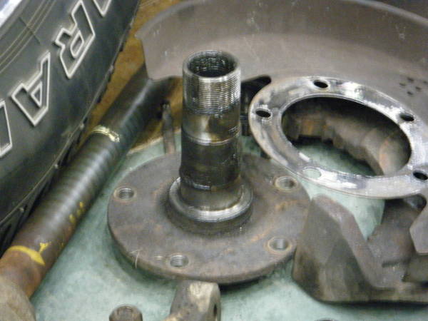

I'm quite D44 straight axle illiterate, so I have an easy question. Is there a joint at the end of the axle tube that connects to a really small shaft that allows turning of the wheels?

I would have no problem with $100 for the dials. And you are right about the reassembly...esp. given that I want to replace all bolts with zinc chromate ones and Stover nuts.
Yeah..the upper and lower ball joints go into the holes on the yolk...then there is a U/J between the two shafts..I'll snap a pic for you.

Thanks Duncan for clearing that up. I'm still new to 4x4 systems, and my TTB setup only came with the intermediate shaft that comes out of the carrier., so I had the slightest idea how it worked.
No sweat...and I will post up some pics for you here shortly

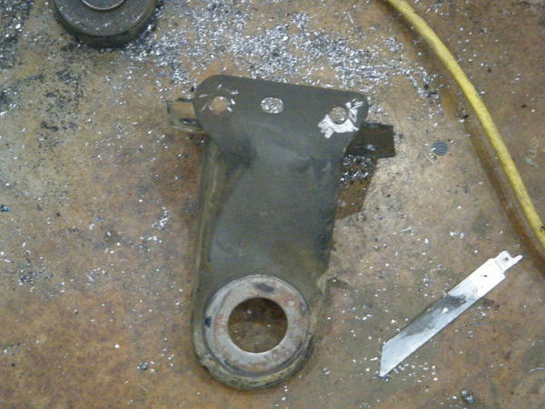

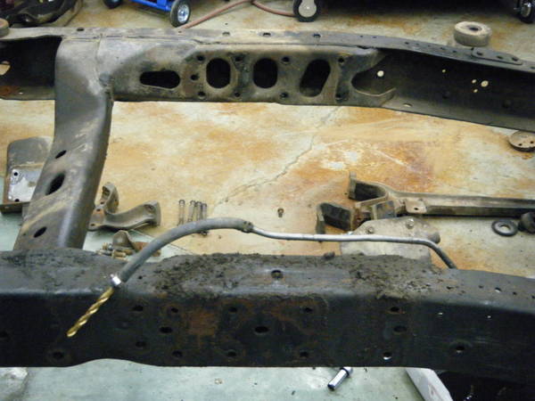

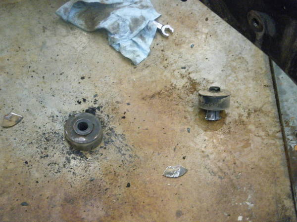

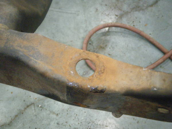

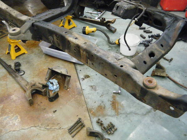

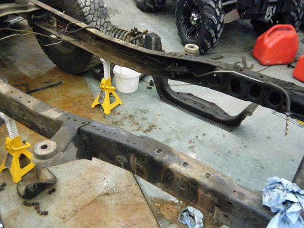

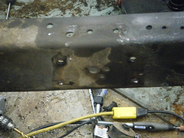

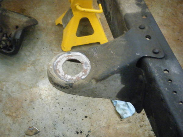

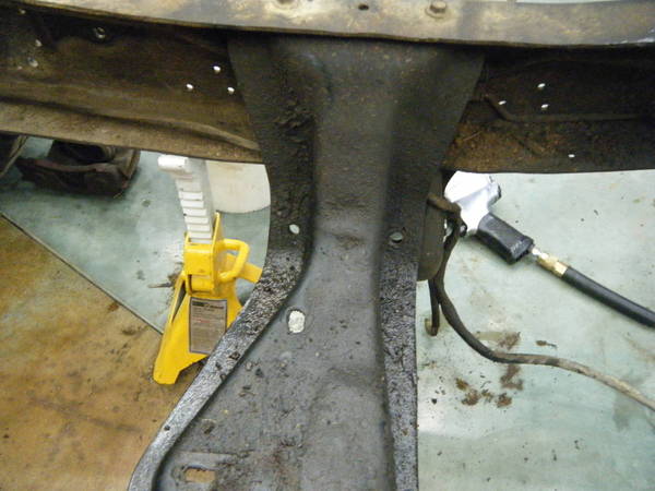

More progress..got the transmission crossmember off, cab and rad support bushings (which sucked hugely!)...then removed the rivits that held the cab support brackets on...what a friggin' chore...and I now have to build up two of the holes because what I thought was center of the rivit wasn't..grrrrr.
Not much left on the passenger side now.

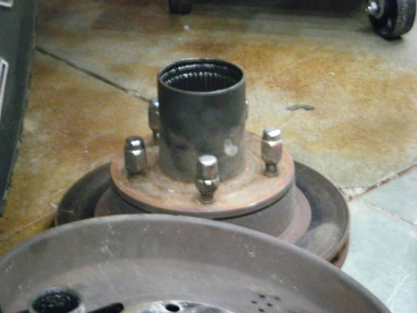

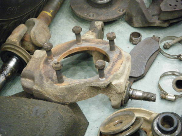

Shaun....ball joints slip into the holes on the yolk and the axle shaft slips through the center...then into the spindle, then the hub goes over that:
Spindle:
Hub:
Axle shaft with U/J

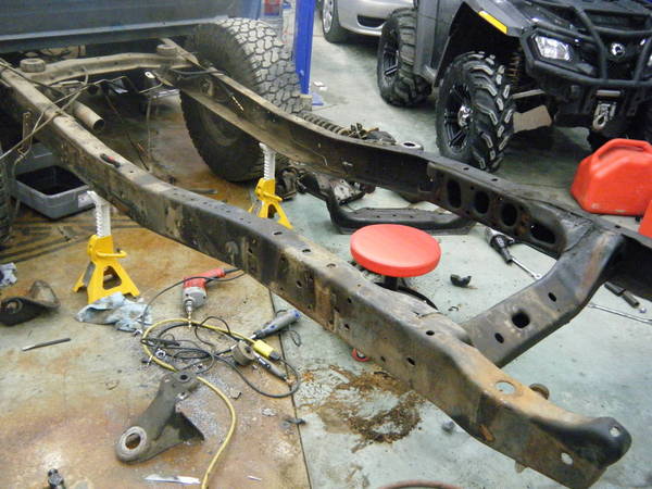

A lot more work is left...I am going to have to file/grind all the edges of the frame for powder coat, all of the small pieces are going to be glass blasted, need to get the frame checked for straightness then redo some of the welds at the front.
