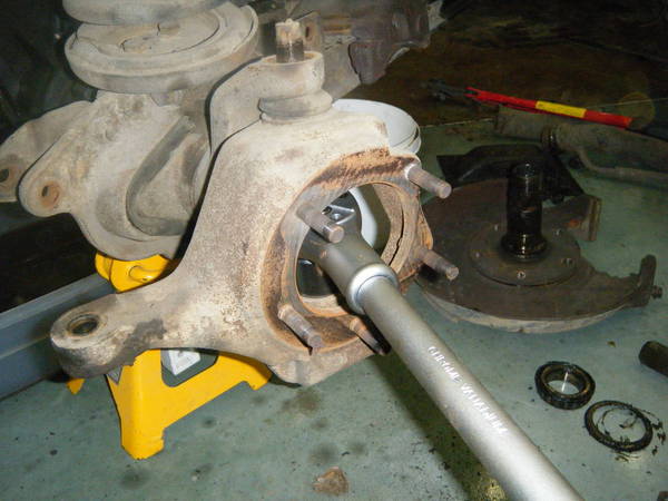

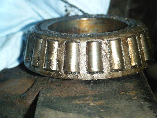

More progress today, went and picked up the hub socket. Found out later that I also needed another special tool to remove the nut that is on the upper ball joint, should have that tomorrow, parts place didn't have one but is bringing one in. No surprises in the hubs, bearings are Timken and show a little bit of wear.
Removed the hub:
Hub nut removal socket:

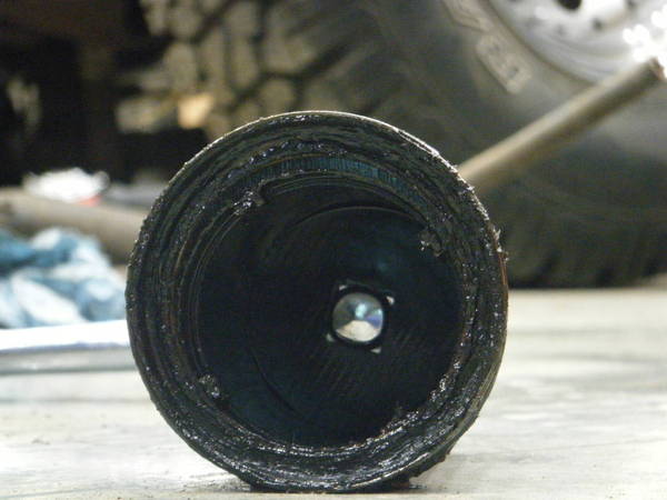

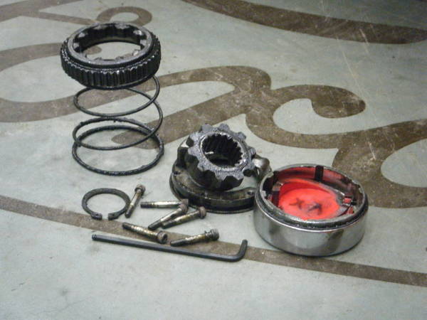

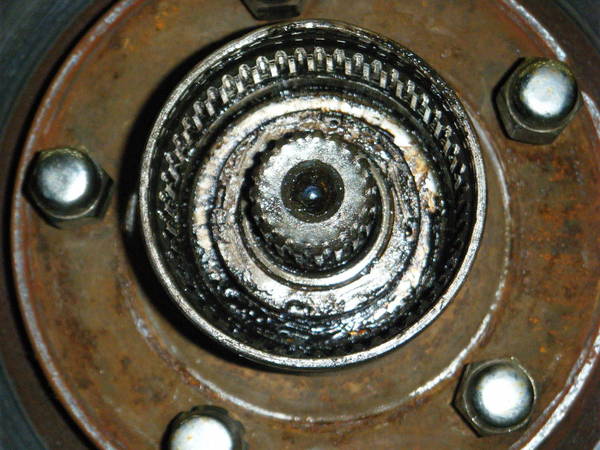

Inside of hub after free running hubs removed:

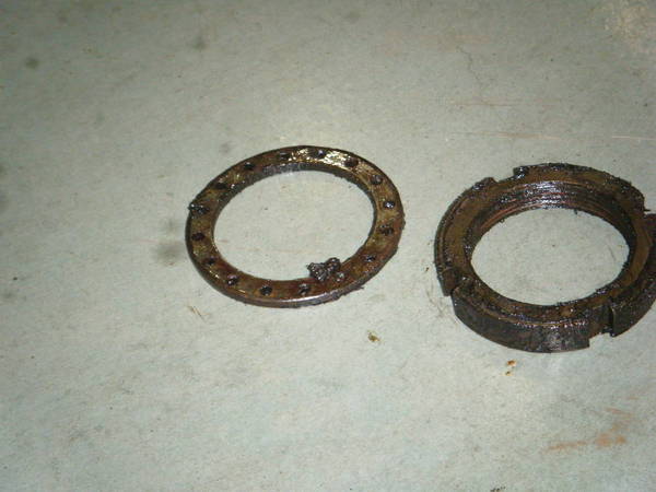

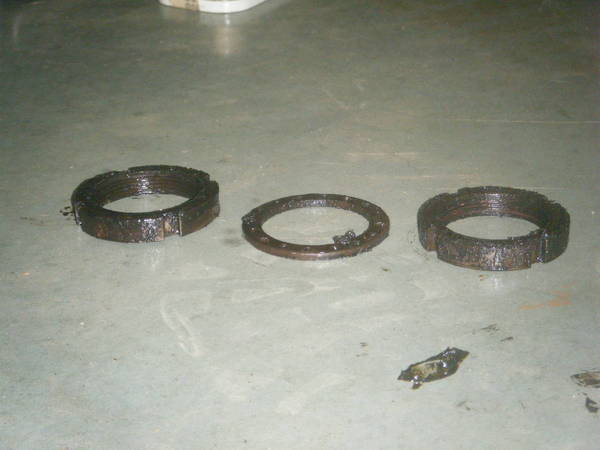

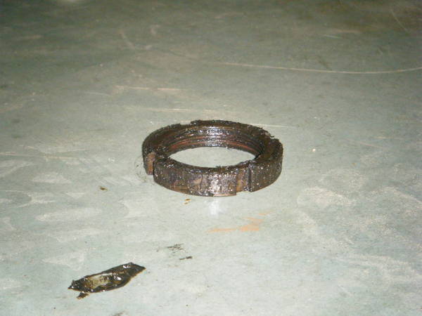

First nut off:
Then the washer:
Then another nut removed:

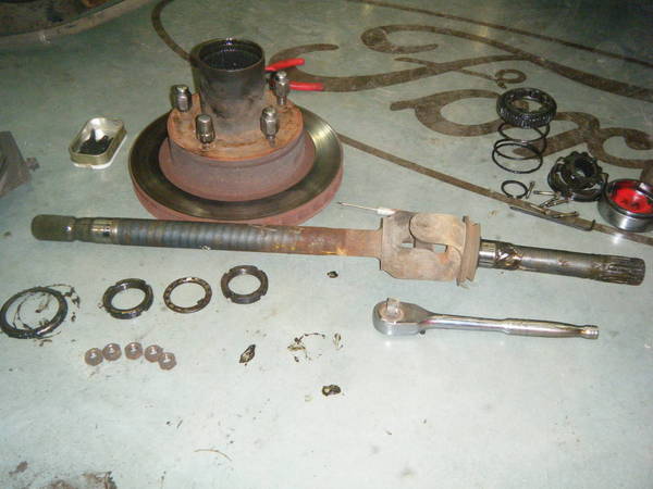

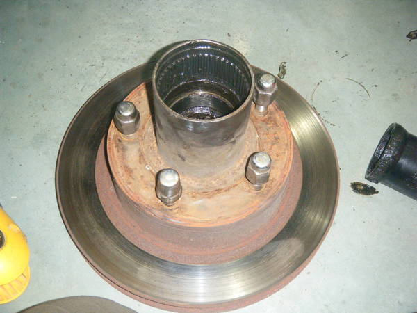

After that, popped the hub/rotor off:
Took the nuts off the knuckle studs and used a deadblow to loosen things:

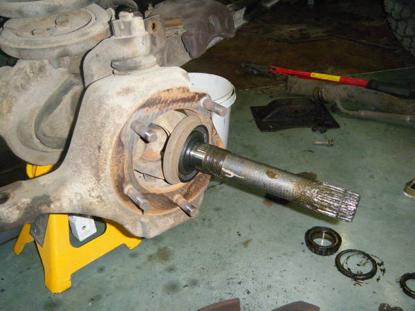

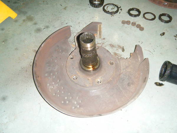

Left with this:

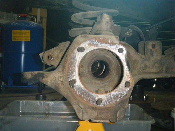

Axle shaft pops out:
Left with this:

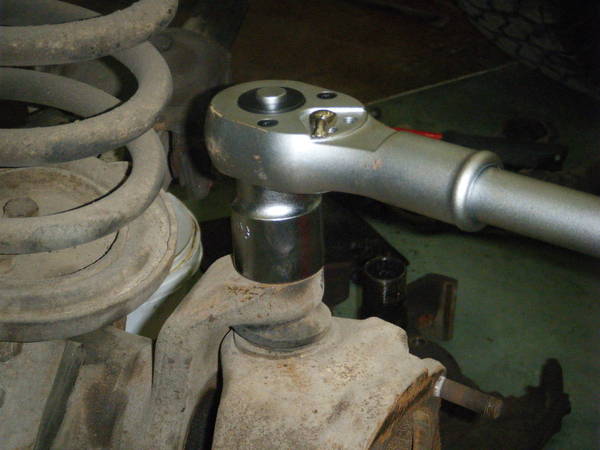

Top ball joint nut 1-5/16, I used a 3/4'' drive very easy to remove:
Bottom was 1 1/8", easy again with that much leverage:

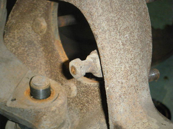

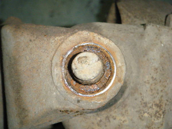

Here is where the other special socket is needed..upper ball joint:
Little bit of wear on the rollers:

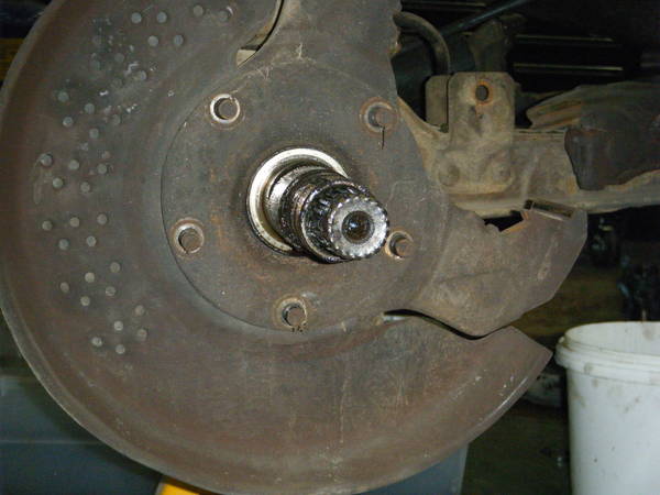

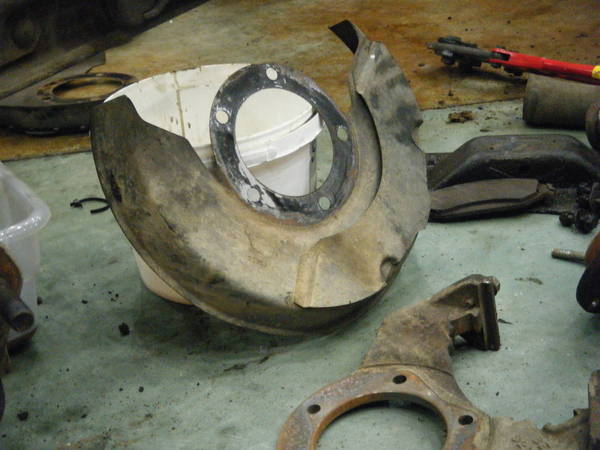

Not sure how I am going to blast the splashshield well enough to powder coat, might have to drill out the spotwelds and seperate:

Thanks Shaun, it was pretty straightforward, the last time I worked on one of these was probably 25+ years ago...the only thing that got me was that upper ball joint nut below the castellated nut. Don't think I will bother with the ring and pinion until I get the housing off the suspension.
