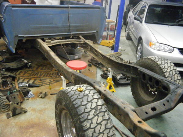

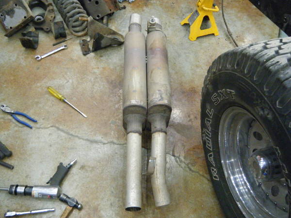

A little progress over the weekend, got the other cab mount off, I'm starting to hate those rivets. I see there are a pile more for other crossmembers and spring hangers. Mufflers were a whole lot heavier than I remember mufflers to be, but they were welded together so that didn't help.

Frame is getting barer:

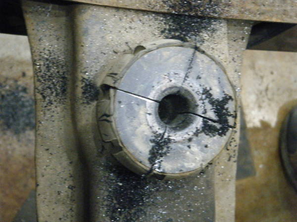

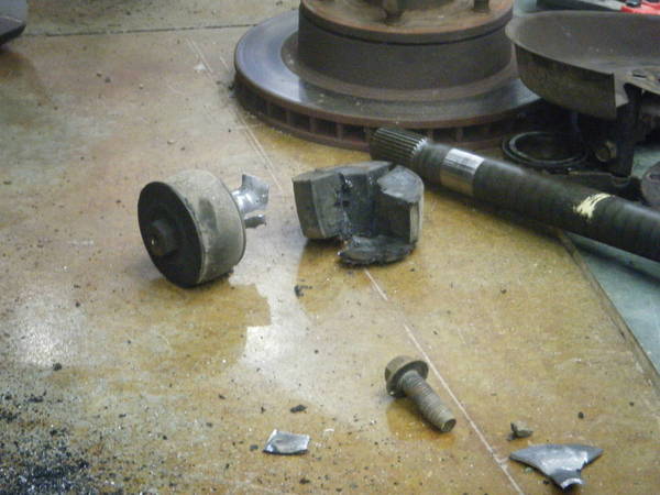

I have tried the air chisel...didn't do a damn thing, in fact...you can see it in one of the pics!
Yep, this is true! Buddy of mine and me put a 3" body lift on my previous 78 SC and the body bolts were a horrendous pain. He has every air tool known to mankind and in the end, we just took a torch to all of em. MUCH easier and since the rubber bushings were shot anyway, replaced those with polyurethanes
