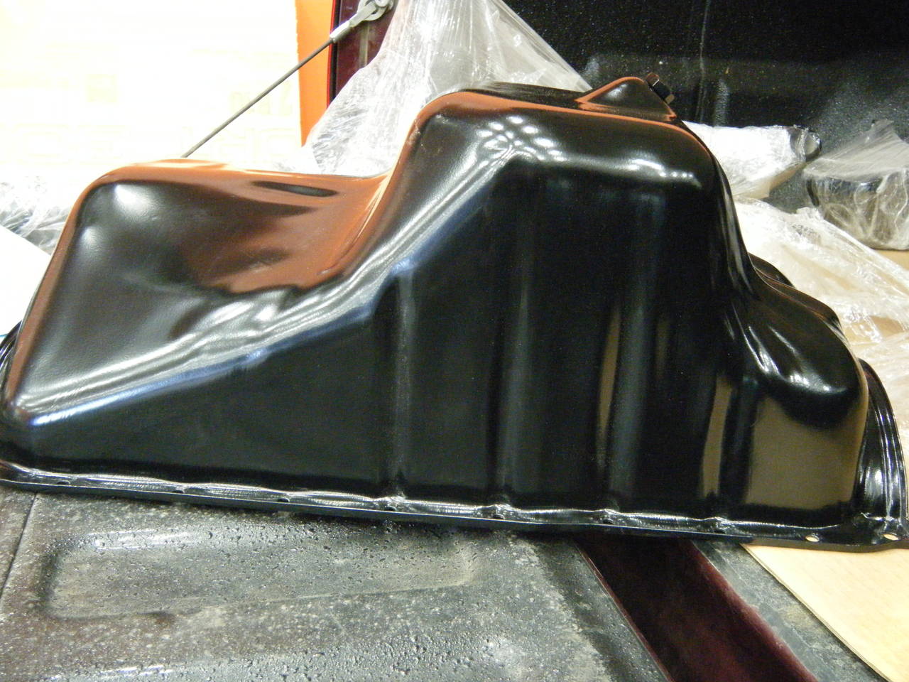

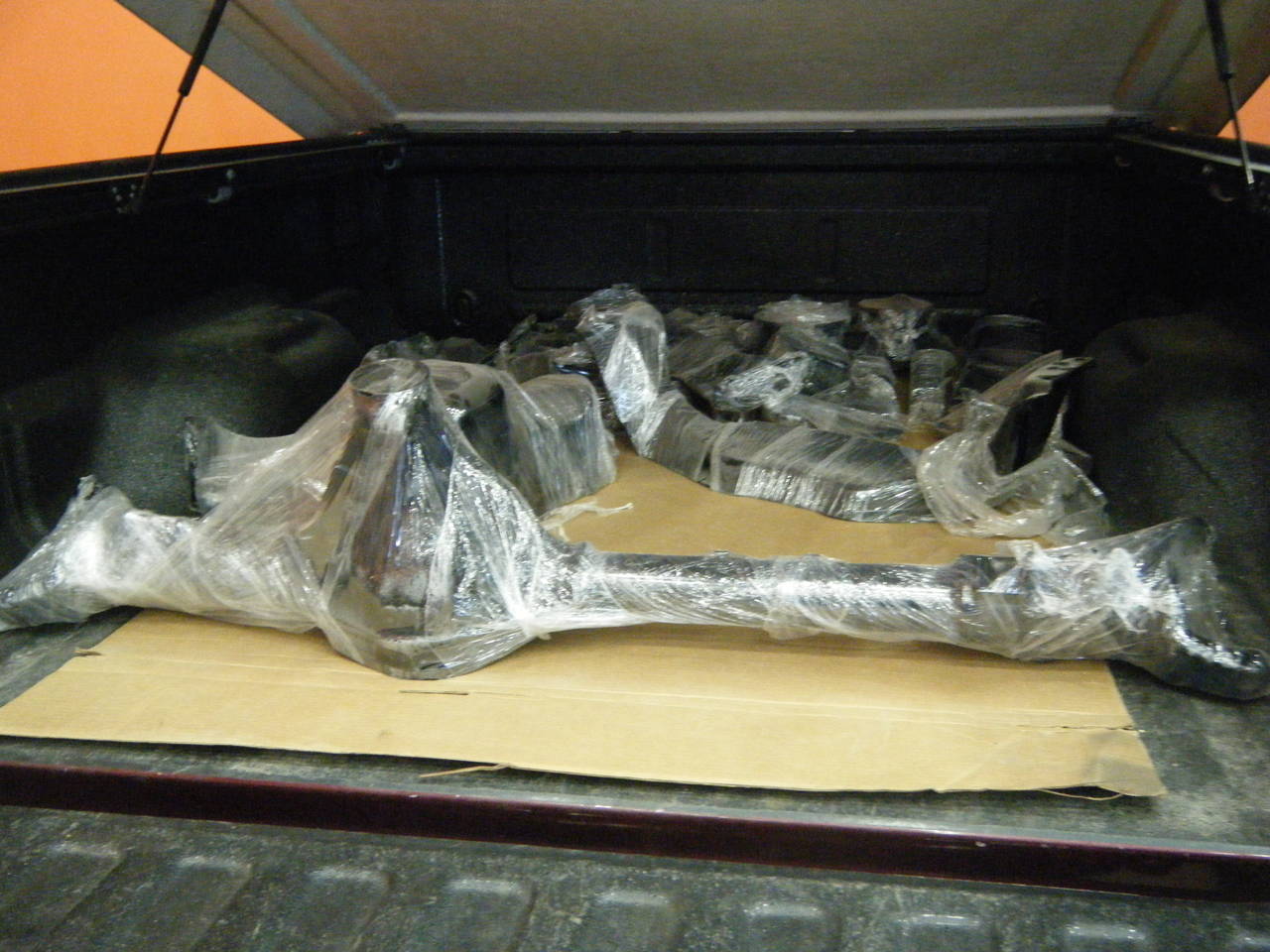

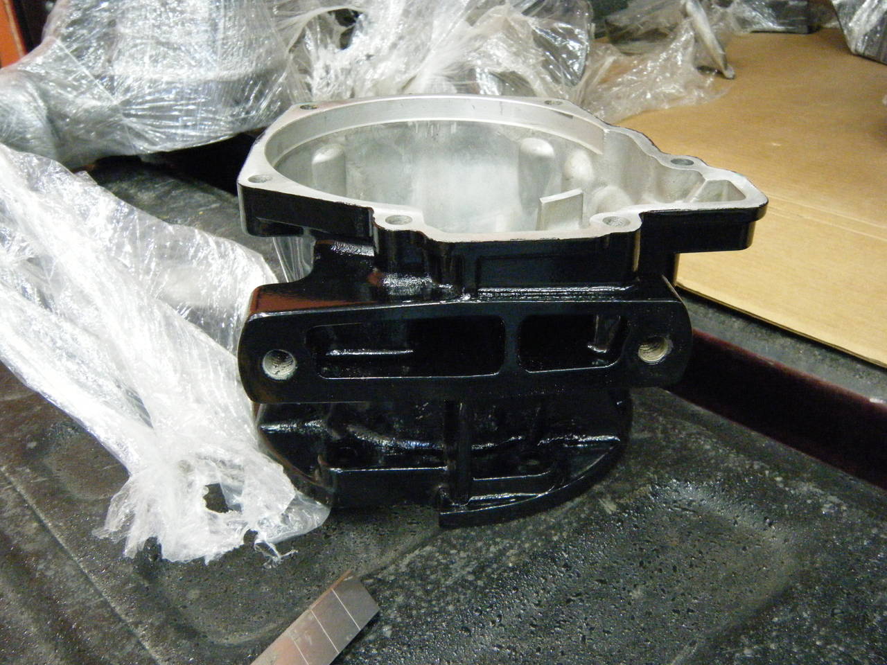

Went and picked stuff up today...very, very happy with the place and the job done! I dorked out and had them do the oilpan black and it should have been blue..:headbang: So that will have to be redone. I dropped off the transmission and transfer case housing.
Fingerprints and marks are just dust.
Oops....

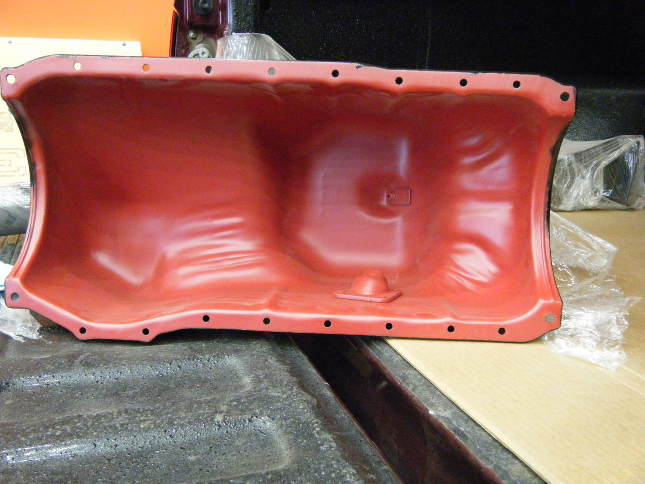

The dryfilm coating..amazing stuff, no oil will stick, all will return to the bottom. The inside of the transmission pan was done the same. I will be dryfilming the piston skirts, rods, crank etc.

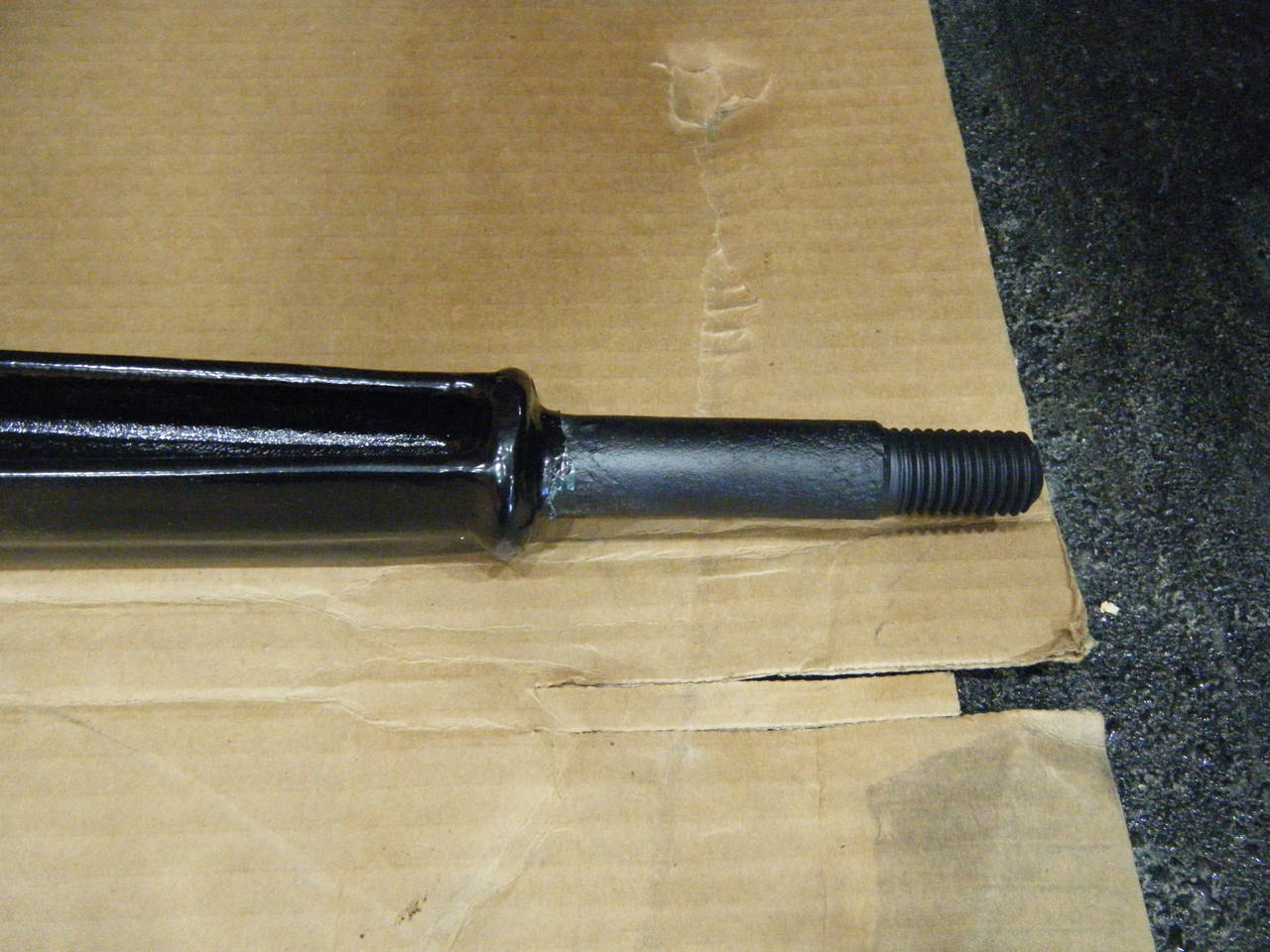

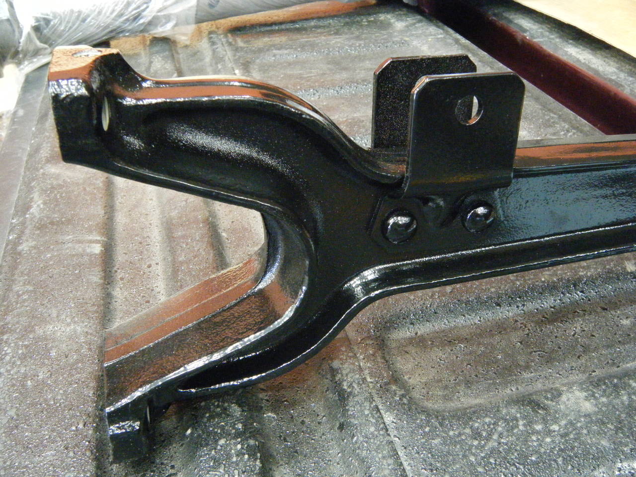

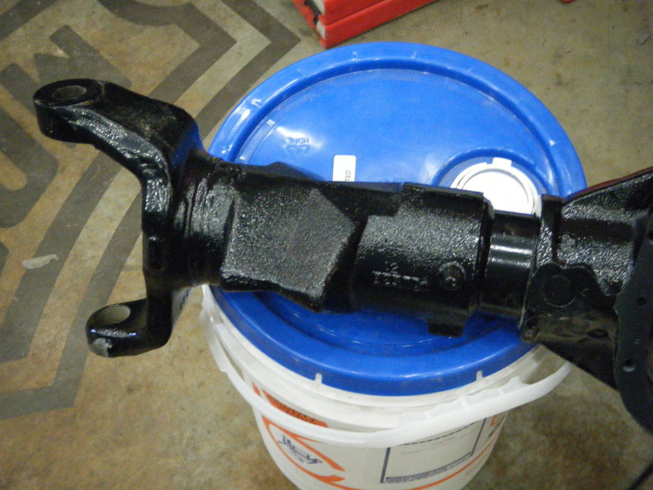

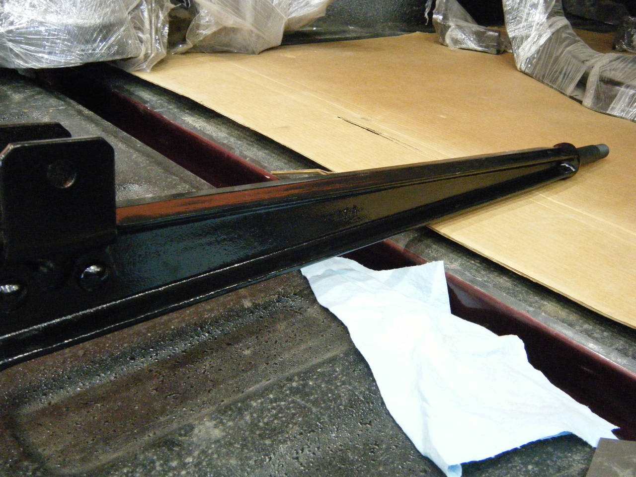

Radius arm with dryfilm on the threads and where the bushings go, rest of it is powder:

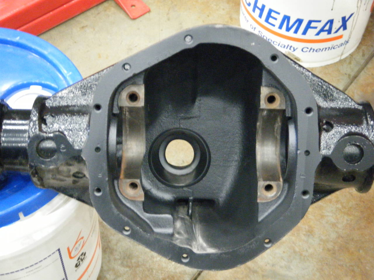

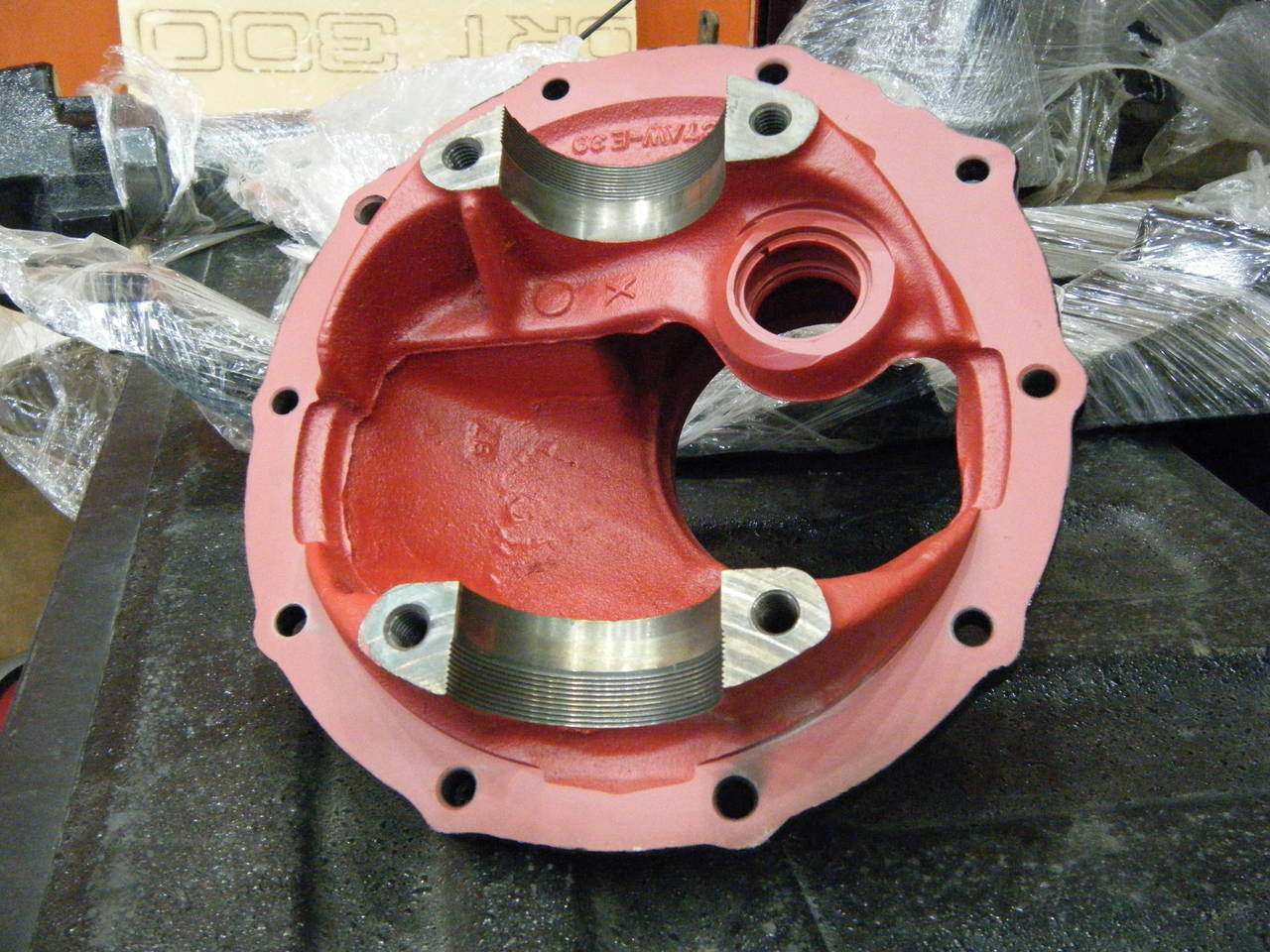

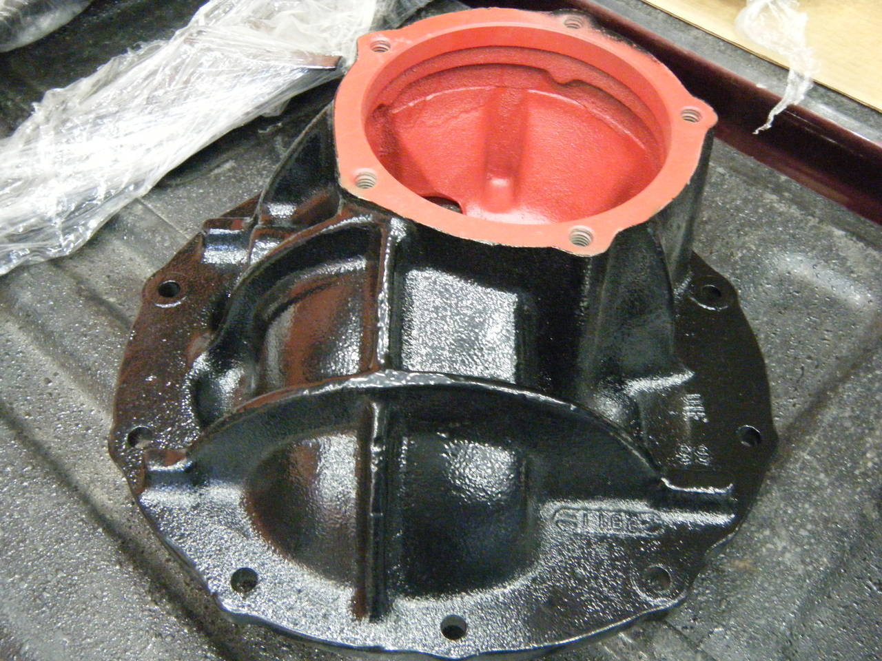

Powder and dryfilm (red) on the 3rd member:

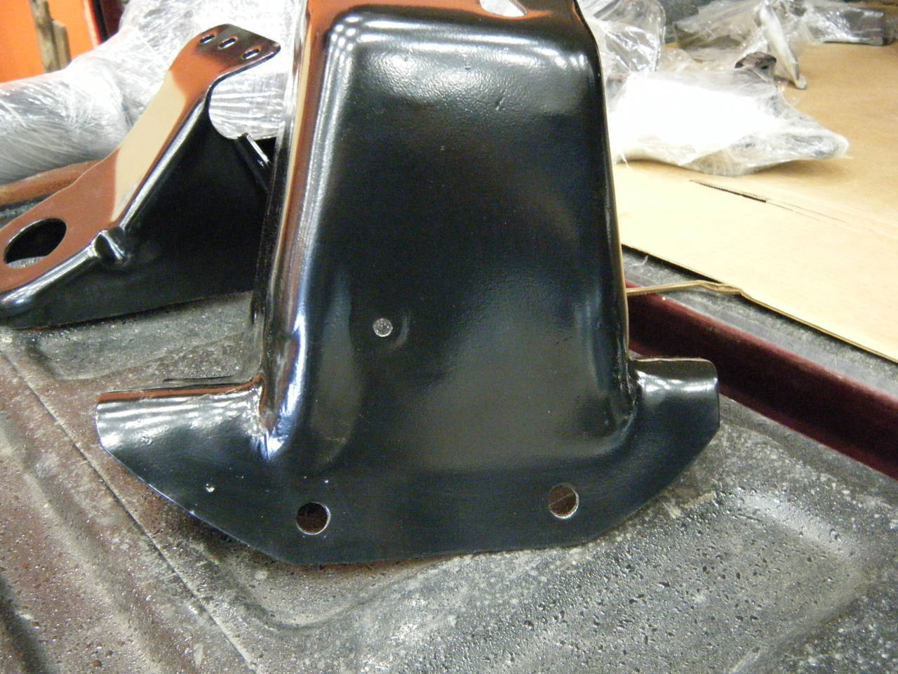

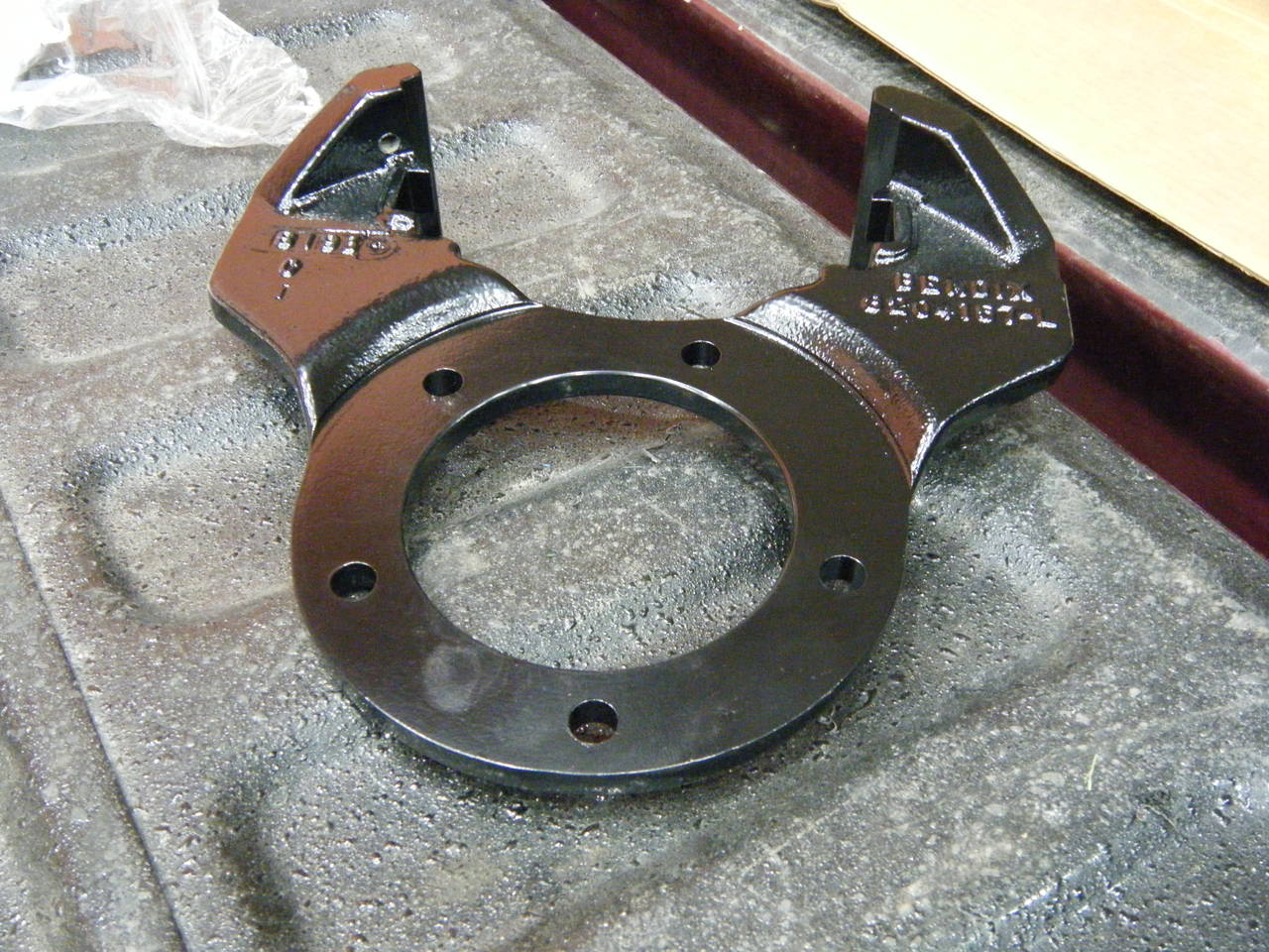

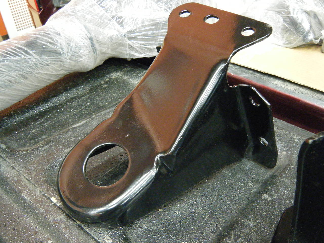

Edges of shock mount where I rounded it, the "P" is my stamp for ID purposes:

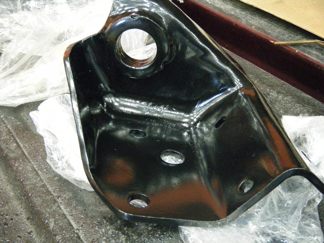

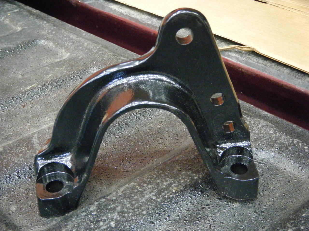

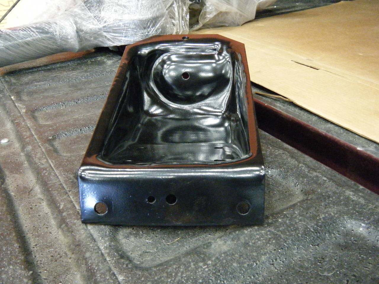

Spring mount:

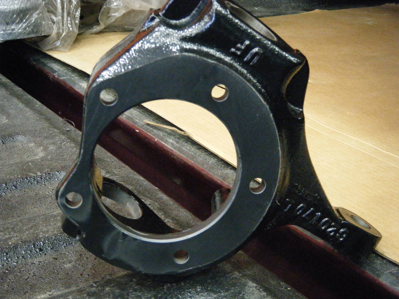

Knuckle with dryfilm on mating surface, powder elsewhere:

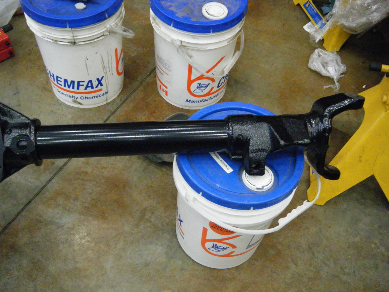

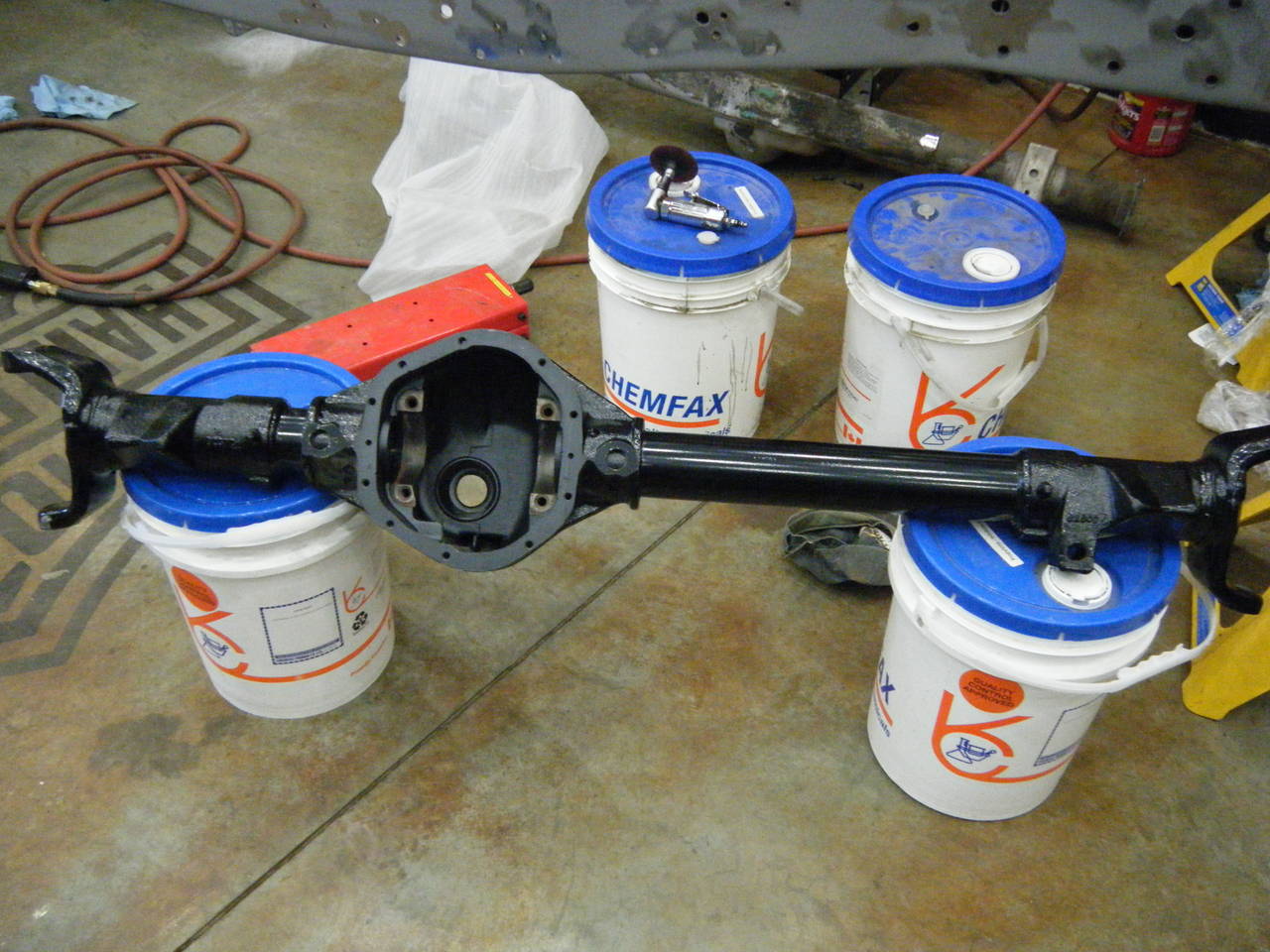

Interior and inside of tubes are dryfilmed:
