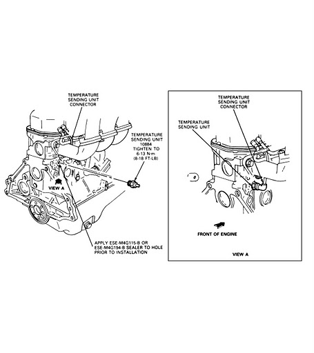

So the temp gauge is non-functional now. Worked at first, but now is definitely dead. Where the heck is it hiding? I only find the one at the thermostat for the computer. 4.9 six
dustybumpers
don't play well w others
3,291
188
In my own world
I'll look later today when I get back home. I remember it being in the head.....
8,021
396
That is where I would expect it. Hopefully not behind the intake.... I can't spot it on the clear side.
dustybumpers
3,291
188
In my own world
Yup. That's it.
I'll confirm with a picture when I get home
