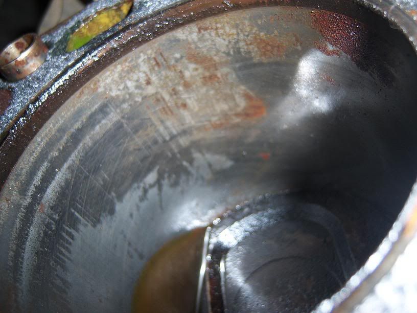

Here are some pics...
Ive been EXTREMELY Busy the past couple of weeks so its really hard for me to get around to the motor...
Im not sure about upgrades yet untill i see acually how much damage is done. it could be expensive. It could be not to bad. But who knows at this point...
This is the only bad spot i see.
Is that your #4 cyl on the passanger side? If so that was the same one that I blew. My piston broke off the rod like 3 months later.

Yea thats cylinder number 4 pass side. Others look ok but again some are at TDC or close to and i cant see the cylinder walls. Hoping the block is ok, crank is ok, i can re hone, get new rods, get everything balanced, new bearings, new rings, new piston?, new oil pump and pickup, new water pump, and go from there. Clean it up so it looks like a brand new motor.
But those are my hopes, and i wont get that lucky...

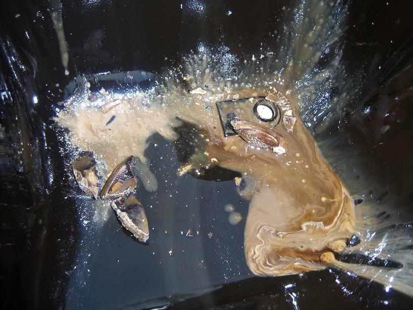

Well...
Shes out and about 70 percent apart.
Yea shes pretty messed up. Its late and i cant really do a good inspection but this is what i found....
Cylinder 4 (the one with the scrape marks in previous pics..
And someone put rocks in my oil pan!
Yea thats what mine looked like. Mine was worse. Id get reman, might be cheaper in the long run.

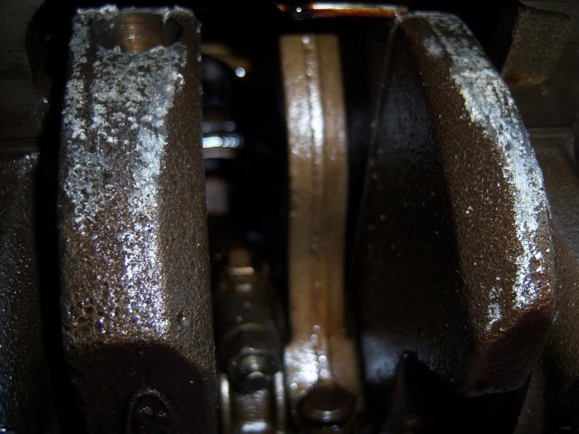

WOW :hammer: Those back two pistons and rods are so jacked up i cant even explain! Sister took off with my camera so i cant get pics right now...
You can see where my crank got tweeked and took out the bearings also. Not sure what i can do with this block but the cylinders dont look bad at all. I know i could get away with a hone.
